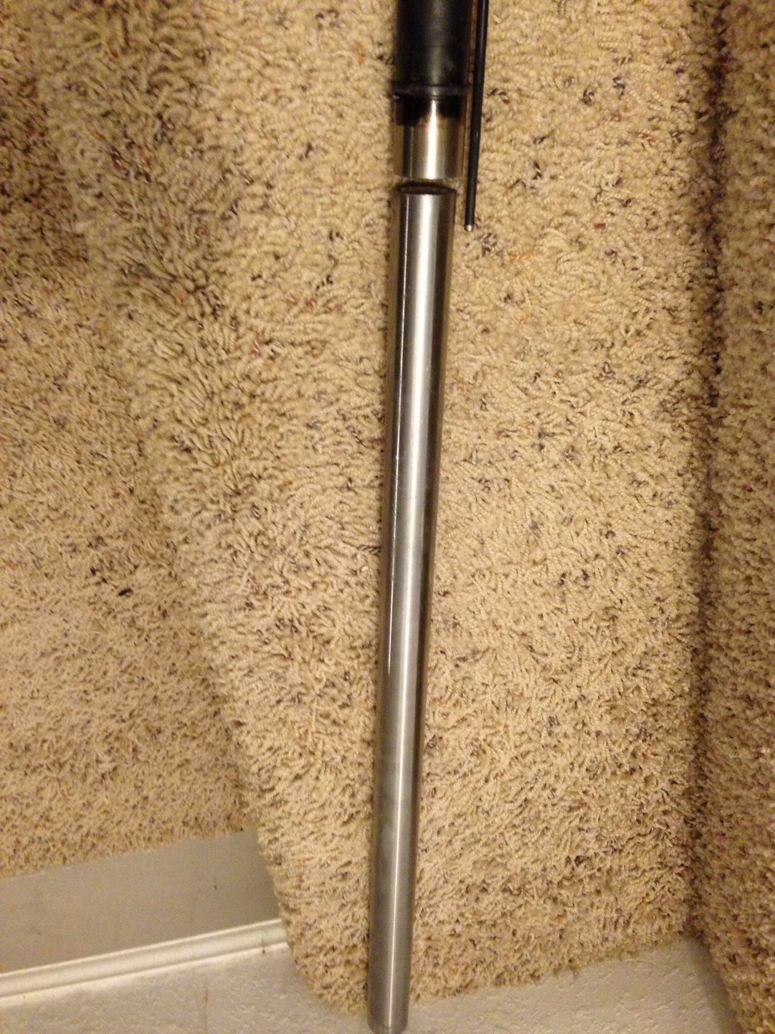

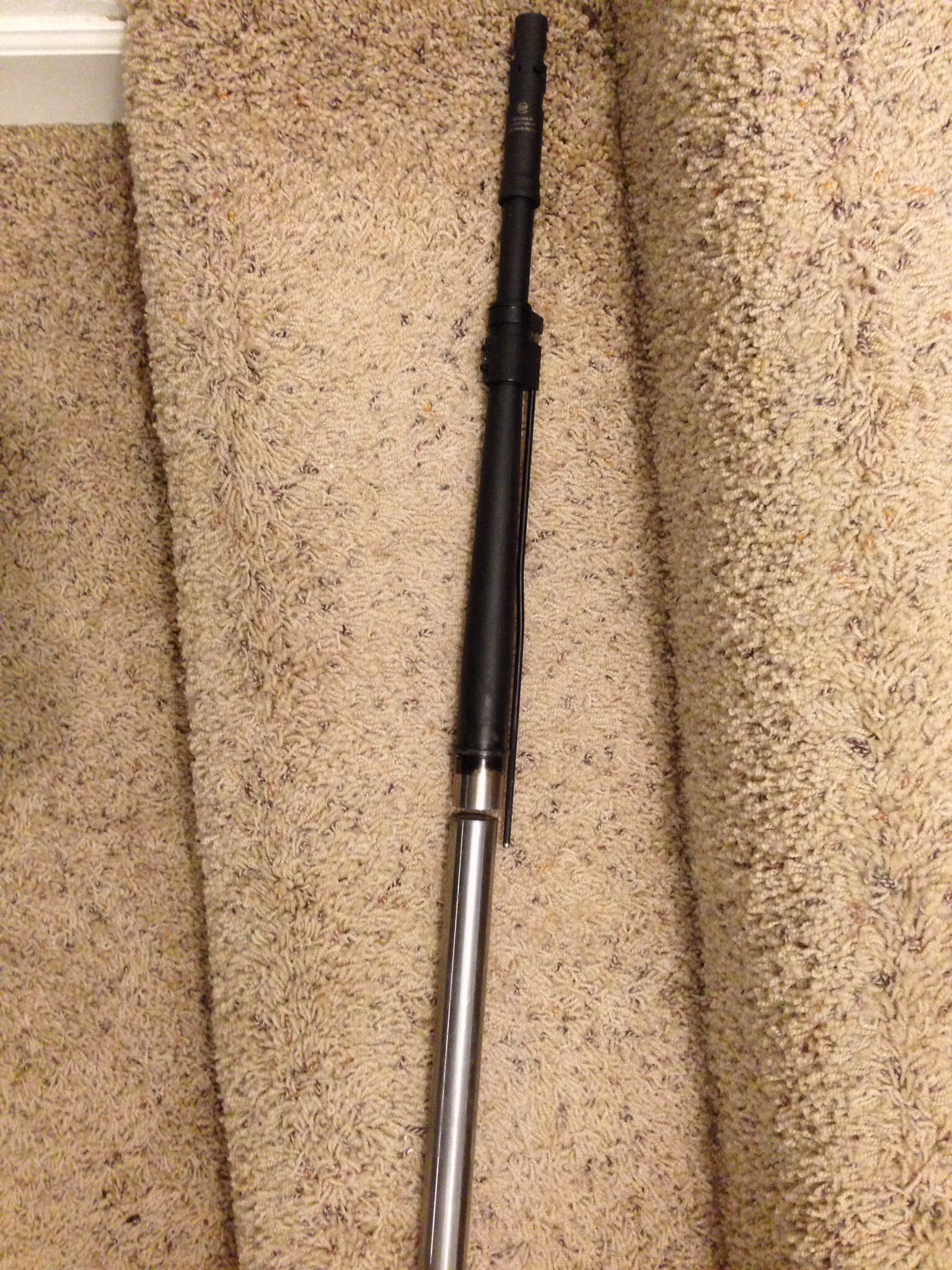

The cooling and heating trick should work well but you will also need something to tap or press out the barrel. I used a steel rod that was just a little smaller diameter than where the barrel fits into the receiver. You will want to make sure the flange is supported and flat so it will not crack when tapping or pressing the barrel out. I will be glad to loan the rod I used to you or anyone attempting a barrel removal. Just PM me your info and I will send it your way.
Also, when installing the new barrel I cooled the barrel in the freezer for about 45min and heated the upper receiver in the oven at 200 degrees F for about 30 min. This was not enough for an easy slip fit. It slid on about half way and then locked up like a SOB! I then had to use a rubber mallet to tap ....... ok beat the barrel into location. After that all went together fairly well. You may want to verify that your gas block fits correctly without contact before tightening all of the bolts in the hand guard.

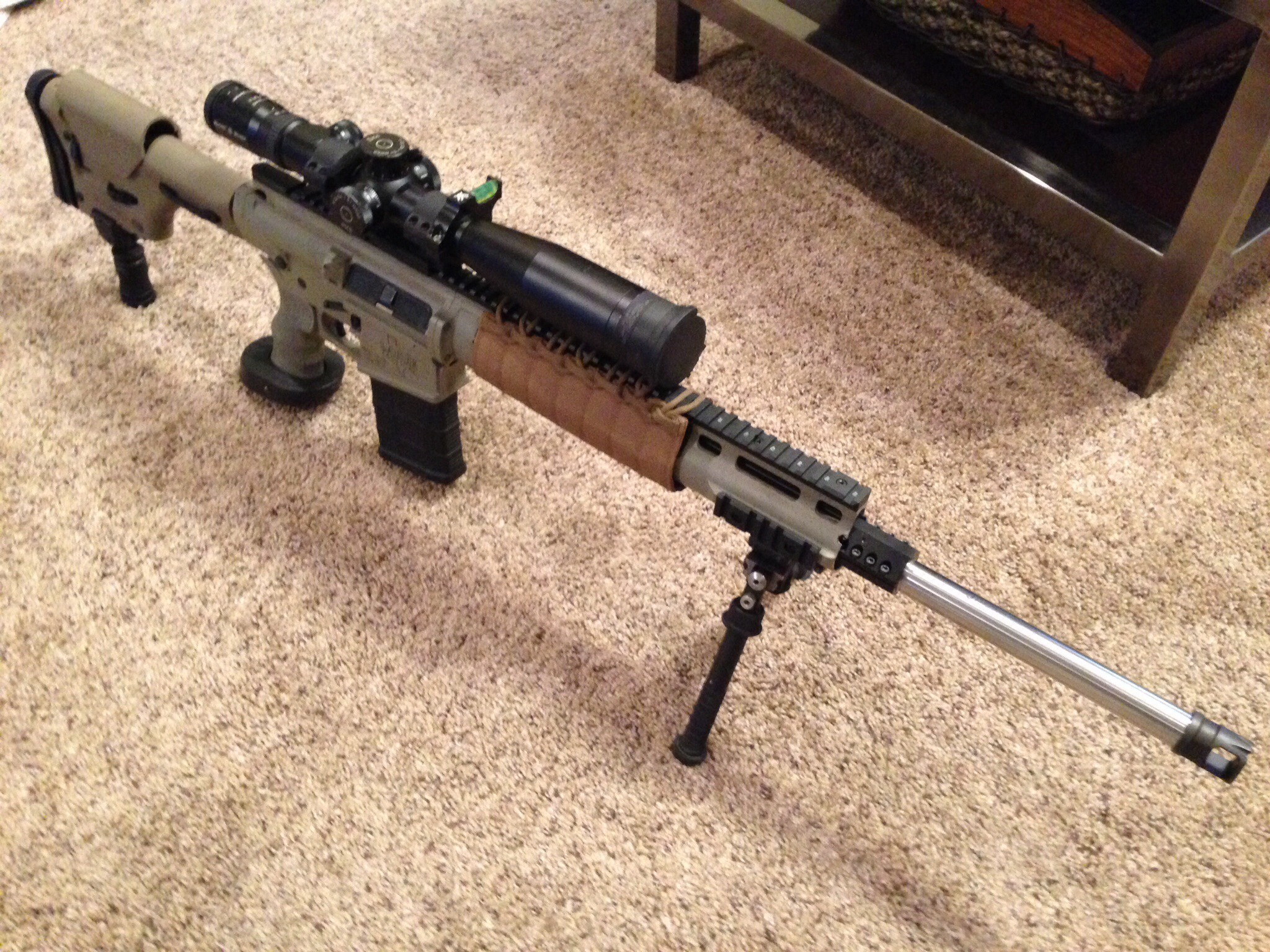

Pictures of the steel rod I used next to the barrel, one of the finished rifle and one of my first 5 shot group at 617 yds with it....... I'm loving the 6.5 Creedmoor!
