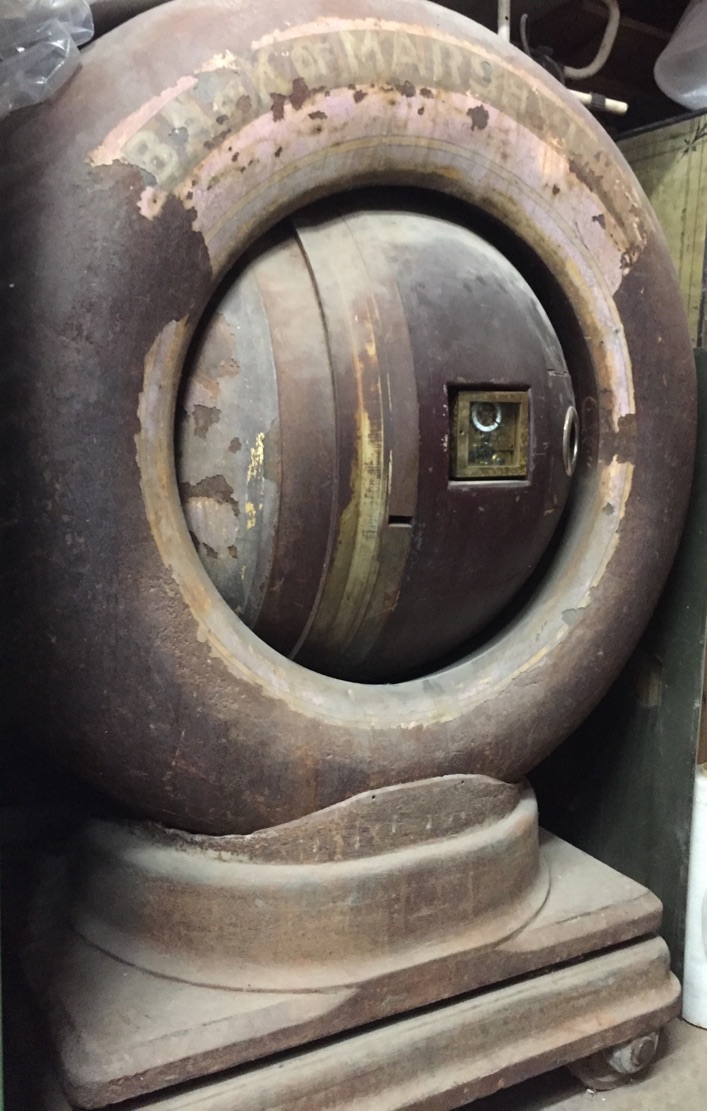

Ray says this cannonball safe is the most secure design in history for business safes. This is the smaller of the two he has, made in 1926, about 4 feet tall and something over 2.5 tons if I recall, and has storage capacity of a smallish desk drawer. You have to open the thing and turn that ball - feel the mass - to appreciate the precision in it. Listening to him talk about these old safes is like a non-shooting person listen to us go deep in the weeds about reloading.
