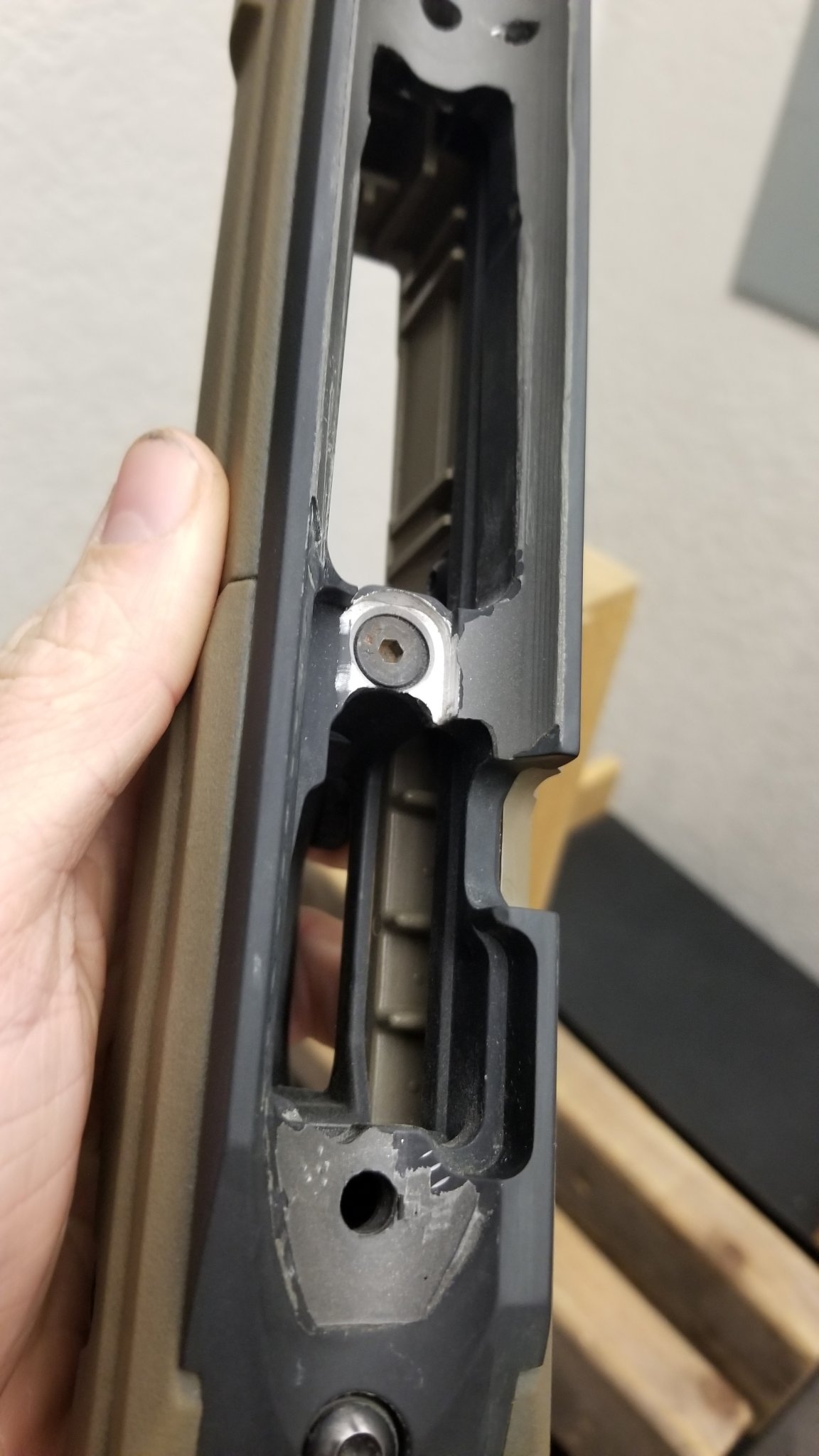

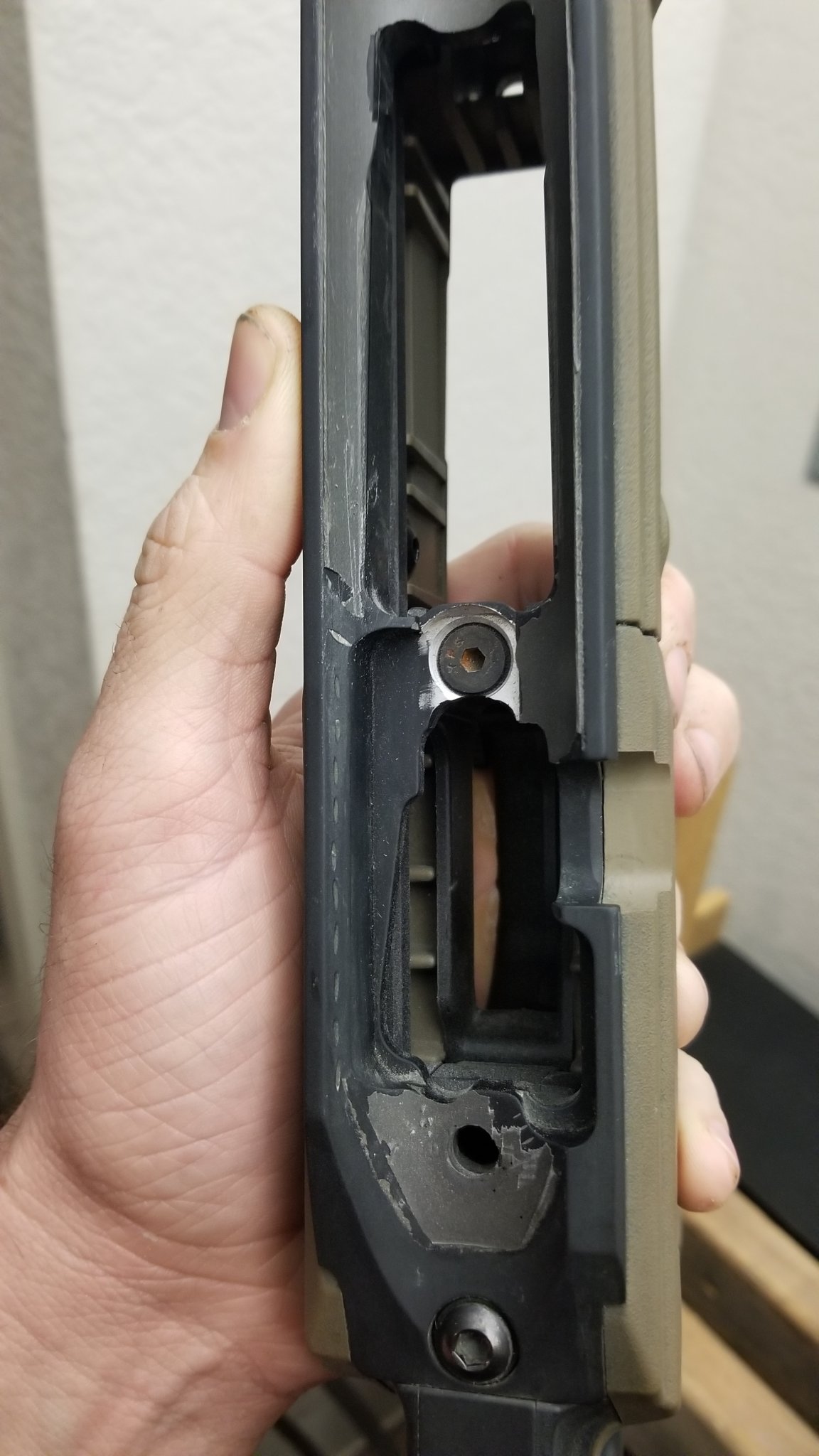

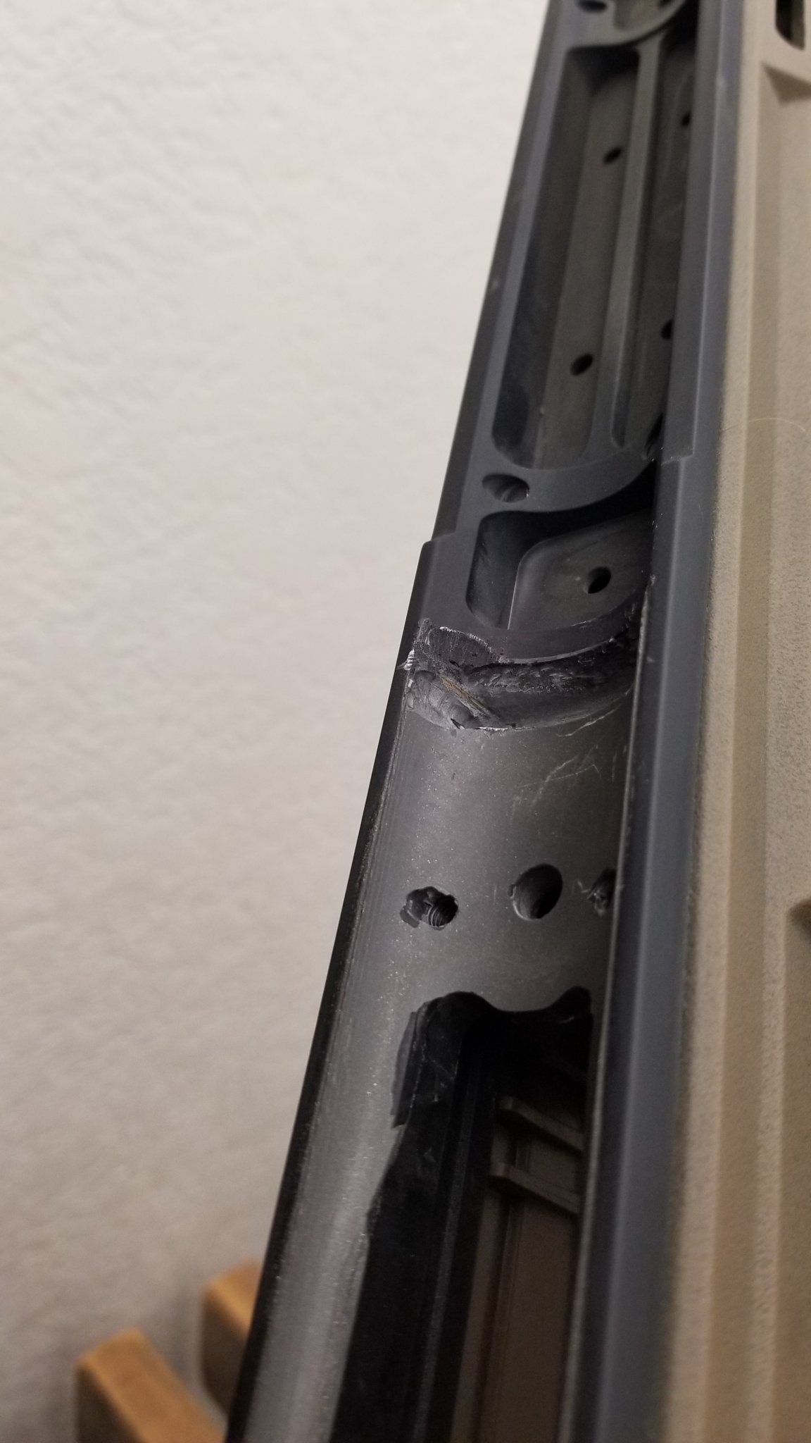

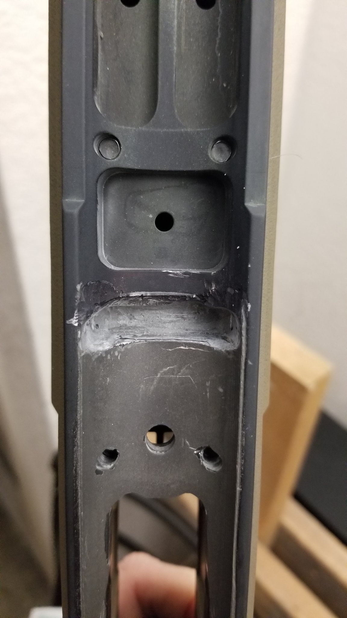

Bought this here, the level of damage amd the fact that it wasnt useable at all was not articulated properly..
I'm suck with it now, what do I do? How can you remove bedding like this from an aluminum chassis? Anyone have experience with this??

The heat gun, so far, sounds the best, I'm worried about the recoil lug area though. Its caked in there deep. Hopefully multiple passes and I'll be ok...
I'd REALLY like to avoid rebedding it. Zero clue why people bed chassis anyways
They bed them for a couple reasons.
1. Some you tube blow hole told them they needed to for a long range rifle, and they did it not looking for results, but so they could say it was bedded.
2. The action they had in it was not straight and would not shoot with out bedding.
I'm a little baffled on why one bed that stock as well.
If we're me, Dremel carbide round wheel and new skim bedding around lug if you take a little aluminum with the wheel.
