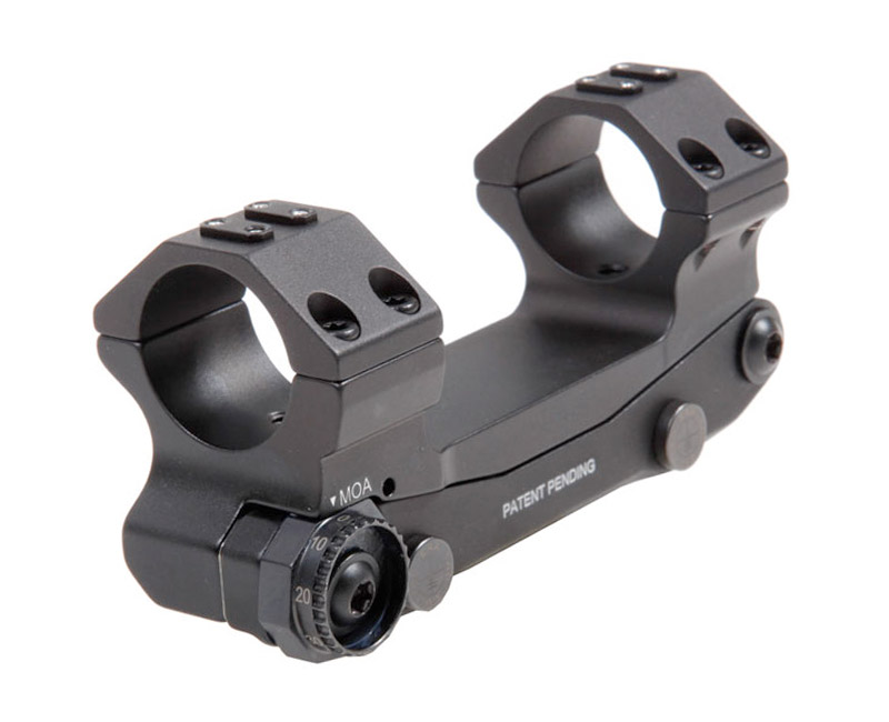

I've only ever seen them allow a couple options, usually 0,20,30 moa. which is fine for standard range stuff but if shooting ELR that isn't gonna cut it. Most guys want a 50-60 base minimum and some/ lots are running more to allow a zero offset that allows them to dial all the way to 2 miles. That being said that is an entirely different niche.
Adjustable MOA or MIL mounts:
0-70 MOA or 0-20 MIL
For my closer in rifles, I go with an integral 20 moa base and a 20 moa mount. That's going to get you close to bottoming out to zero at 100. On my 300 PRC with an M7xi I run the 20/20 and with the 28 mil max vertical the scope gives me, I barely get to zero with my 40 moa total - 50 moa wouldn't be possible. At 40, I max out at about 2100 yards by dialing, give or take, depending on conditions. Unfortunately, the reticle isn't a great holdover reticle, so going farther is problematic.
Many scopes have 30 mil max elevation (-15 to +15 mil), and a select few go up to 34. For 30, you can barely get 50 moa and still zero at 100.
Long story short, if you go 40 moa total between base and mount, you can mount pretty much any scope you want and still zero at 100. At 50 moa total, you have some minor limitations, and at 60, you'd have quite a few that would be ruled out. That's why I like to not limit myself by going too far with an integral base. Go relatively small (20) and make up the rest with a mount. You can always go up or down on the mount.
Yes if going to run a big rail you need to know how much elevation you have in the scope. I currently running a 50 moa rail and zero at 100 yards. I was referencing @SeekingNorth saying you should be able to choose the angle on an integral rail when no one offers that. Yes there is the adjustable bases but those aren't always an ideal solution.
