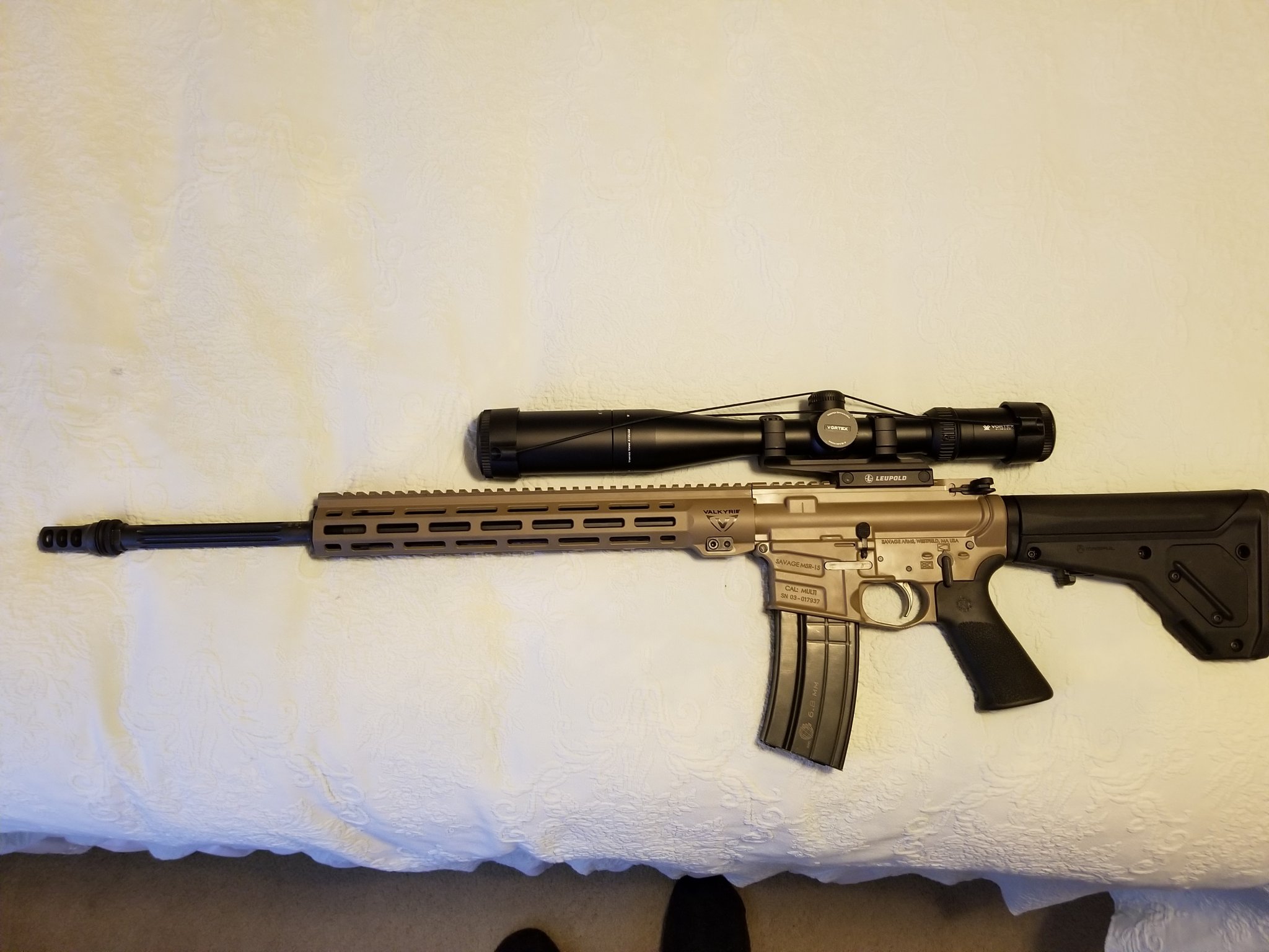

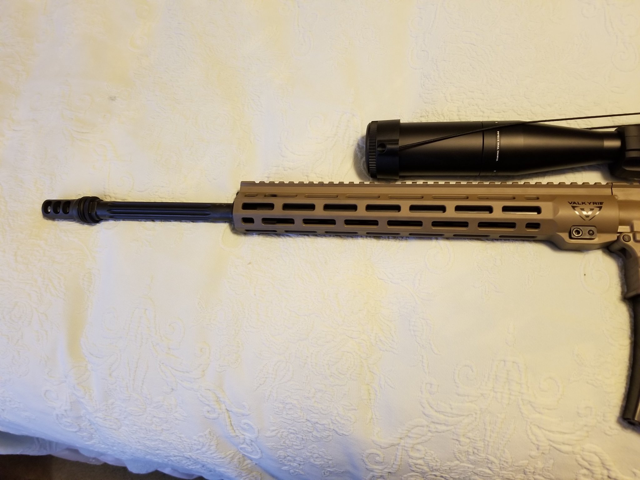

I got the new Faxon match barrel installed and it looks great. It's a 20in heavy fluted 1:6.5 twist. The barrel nut on the savage is proprietary to Savage but a Remington action wrench fits it [very tight). I had to change the gas block and tube as well. The savage gas system is around 12in long, not rifle length like the new barrel. I have not been to the range with the new setup but will keep you posted on performance.

I got the new Faxon match barrel installed and it looks great. It's a 20in heavy fluted 1:6.5 twist. The barrel nut on the savage is proprietary to Savage but a Remington action wrench fits it [very tight). I had to change the gas block and tube as well. The savage gas system is around 12in long, not rifle length like the new barrel. I have not been to the range with the new setup but will keep you posted on performance.View attachment 7005414View attachment 7005415
