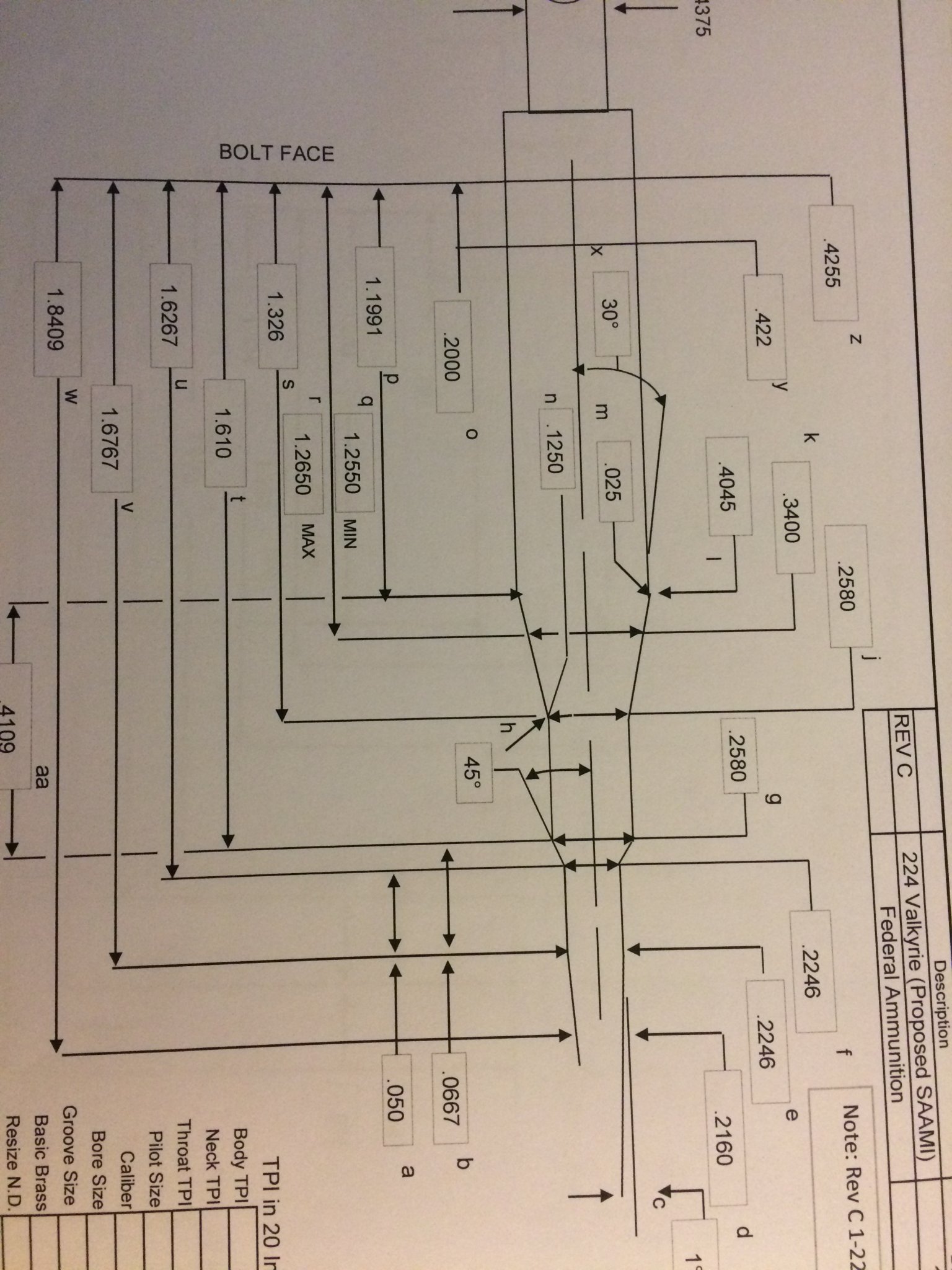

This is the correct reamer drawing that matches the SAAMI spec drawing. It's pretty easy to check your chamber. Don't wait for someone to prove it to you check it yourself. The 1.6767 dimension is the distance from the base to the start of the freebore. Take a .224" diameter inspection pin. Cut it in half, 1" long. stick it in a Hornady OAL gauge. Measure from the front of the inspection pin to the base and there's your number.
Can you provide evidence of this? I’ve not heard anything official that readers were out of spec. Although I did receive a short chambered barrel.
Official? Like a press release? uh...no. Some times old smiths/wildcatters find stuff before these new out of school big company inganeers do. Up until now everyone has been blaming Federals ammo. A few engineers at Federal know about the reamers as of last week. Just wait and watch it'll all come out.
ETA- The reamers in question have a longer freebore which usually means less pressure and would likely NOT be the cause of blowing primers. Blown primers can be a few things, excess pressure, too much headspace or a barrel that is WAY over gassed or a combination of those 3. In the case of being over-gassed If the carrier starts to move to the rear and unlocks the bolt while the bullet is still in the bore the pressure is high and the case is stuck to the chamber walls due to the pressure. The case has not had time to shrink back down. The bolt moves away from the case and the pressure inside the case pushes the primer out.
Constructor, thank you for your valuable information. I purchased a pathfinder barrel from airborne arms. I have a freebore of 1.8175 meaning my case overall length with a 90g smk would have to be 2.3215 to touch the lands. Obviously this is out of spec. I reached out to them and they informed me they do not use PTG reamers. They aren’t saying what blanks or reamers they are using but I assume it’s a Manson.
Now I’m curious, who does an out of spec ream job fall back on?
The barrel maker, who ever reamed the barrel. They should have checked the reamer for accuracy before using it.
The reamer grinder should have checked their work before shipping it out but highly unlikely the tool maker will pay the barrel maker for bad barrels.
To some this right or wrong freebore will not make any difference, if they are happy with the performance of the barrel.
....I'm probably like most of the general consumers in that I'd prefer that whatever brand of barrel I use will perform as touted with the heavy projectiles it was developed around, most especially the off the shelf offerings. Although I do reload, I'm at the age now where convenience has become more of a priority than before. My re-posting of the info discovered on the 224Valkyrie forum was not intended to disparage any barrel maker, distributor or reseller, it was to provide newly discovered information that the general consumer could use in their buying decision. The greater majority of the market is comprised of those that rely on off the shelf products, primarily because they really have no choice due to a lack of technical knowledge and expertise. When a source that DOES have the technical acumen (Constructor) identifies a problem and shares that info, the general consumer can benefit from it, even those involved in the supply chain can benefit from it as not all within the supply chain are involved in the complete process of the final end product (completed barrel).
You got a good barrel, happy for you....your barrel isn't performing, here is info you can use to investigate as a possible factor, you haven't bought a barrel yet, here is additional info to add to your research to make a decision.

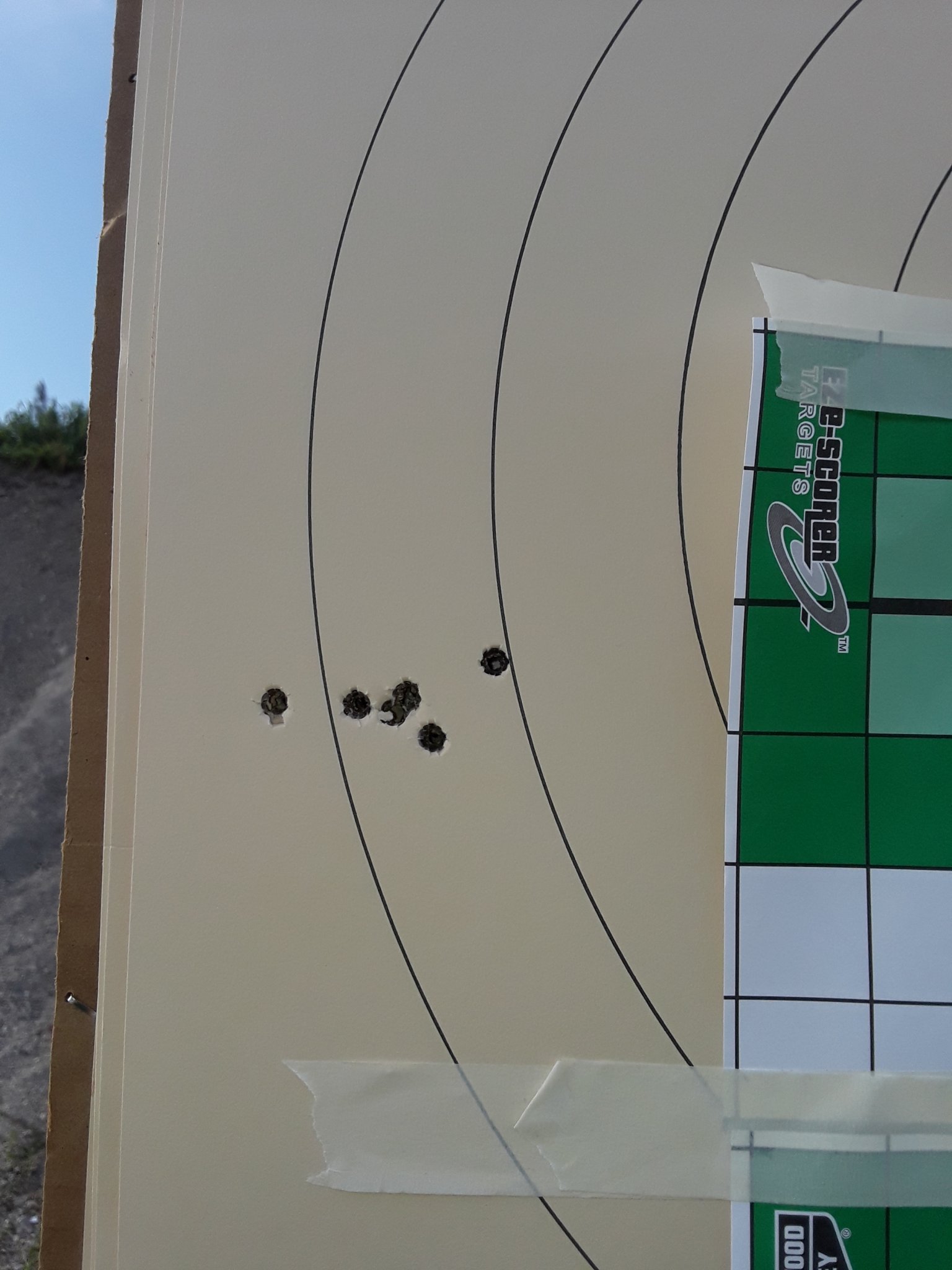

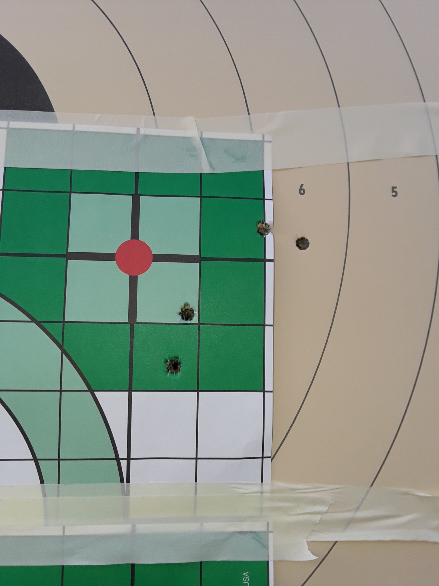

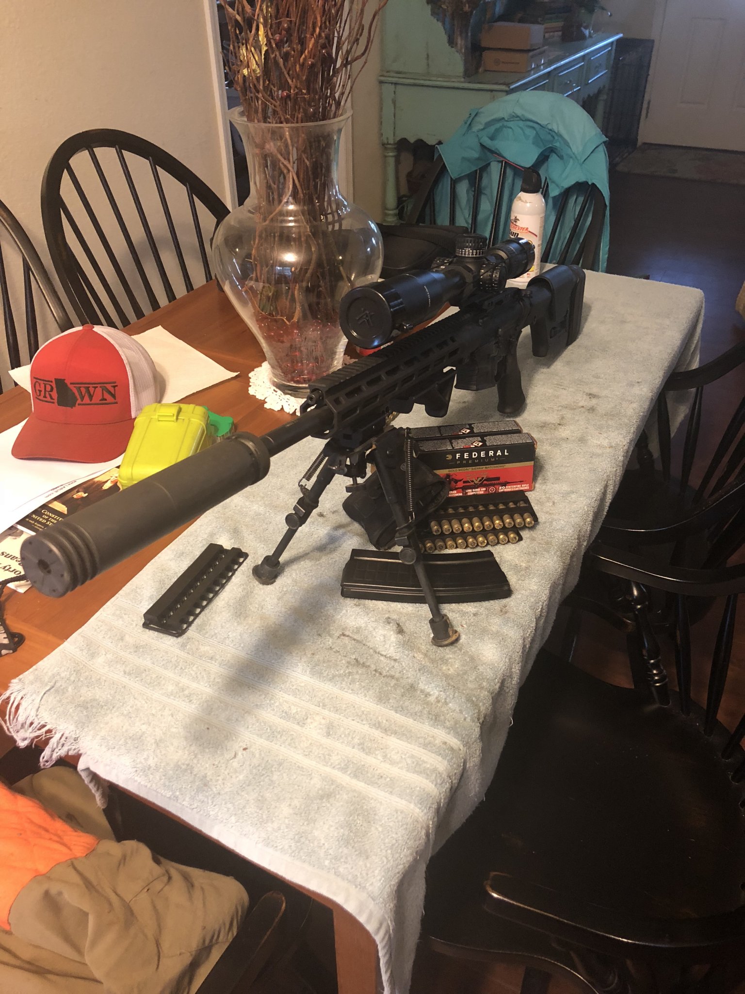

Hey everyone, new to the forum, but I've been reading on here for a little while and figured I'd see if I could get some help with a problem I've been having with this new round. Shooting the .224 Valkyrie 90 grain Sierra MatchKing factory loads, I have found that about 15% of the rounds I fire are blowing or dropping primers. Its been frustrating in the sense that I've gone through about 180 rounds trying to properly fix the problem. With that being said I've run about 120 rounds of the Federal Fusion 90 grains through the rifle as well. I'm going to give everyone the specs on the rifle, as well as the true data that I've gathered from my last attempt to fix the issue and see if maybe anyone can help diagnose the issue I'm having...
Specs:
Savage MSR Recon .224 Valkyrie
18" Barrel 1/7 twist
Gun is completely stock except for a Silencerco Omega suppressor, and a Magpul PRS Gen III stock
Ammo
.224 Valkyrie Federal Gold Metal Match 90 gr Sierra MK
Box says 2700 FPS (I believe a 24" test barrel)
True data
Zeroing Weather was 71.6 degrees F, 52% humidity, 154 ft. Altitude, BP 30.233
Line of sight angle 4.1 degrees
BC .563 G1
sight height 2.75"
drop at 200 .5" high
zero approx 214 yards
drop at 302 -8.15"
drop at 402 -14.9"
my math puts the muzzle velocity at 2908 fps, and please by all means check me
I've done some reading in some articles that are showing close to 2800 fps out of these particular rounds, but nothing quite to what I can figure on mine without current access to a chronograph, so I was especially particular when gathering these figures, in fact all 5 rounds fired at 400 yards had exactly the same drop to less that 1/10 of an inch. I have the adjustable gas block set 1/2 turn up from the rifle short-stroking. Before anybody asks, the drops are within an inch of each other without the suppressor. In my very limited opening I think its a timing issue, as in the bolt trying to open before the cartridge has been able to turn loose all the way, and I'll include some pictures of the brass at the bottom.
Aside from these issues, that I'm hoping the fine folks here on this forum can help me work out, I'm extremely happy so far with the gun, especially being a stock gun. The trigger is great, and I've consistently shot sub .MOA groups with it out to 520 yards so far. I'd have stretched it much further by now had it not been for the occasional malfunction due to a loose primer. I've sent the last box of ammo back to Federal to be tested for pressure and muzzle velocity to make sure its not an ammo issue. I'm considering trying a heavier buffer to start with to try to slow the bolt opening just a hair to begin with, let me know what you guys think, and thanks...

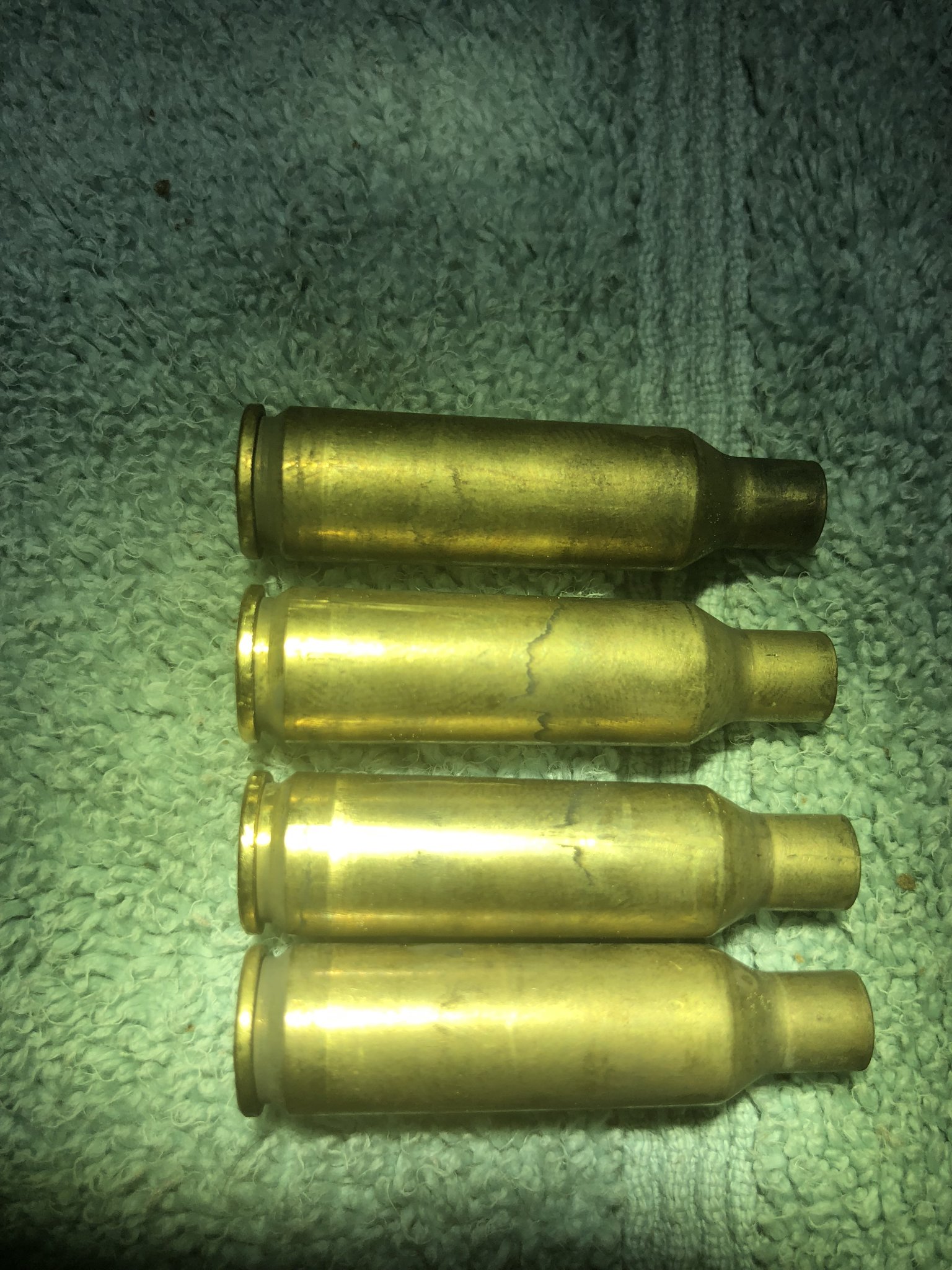

Pictures
Brass

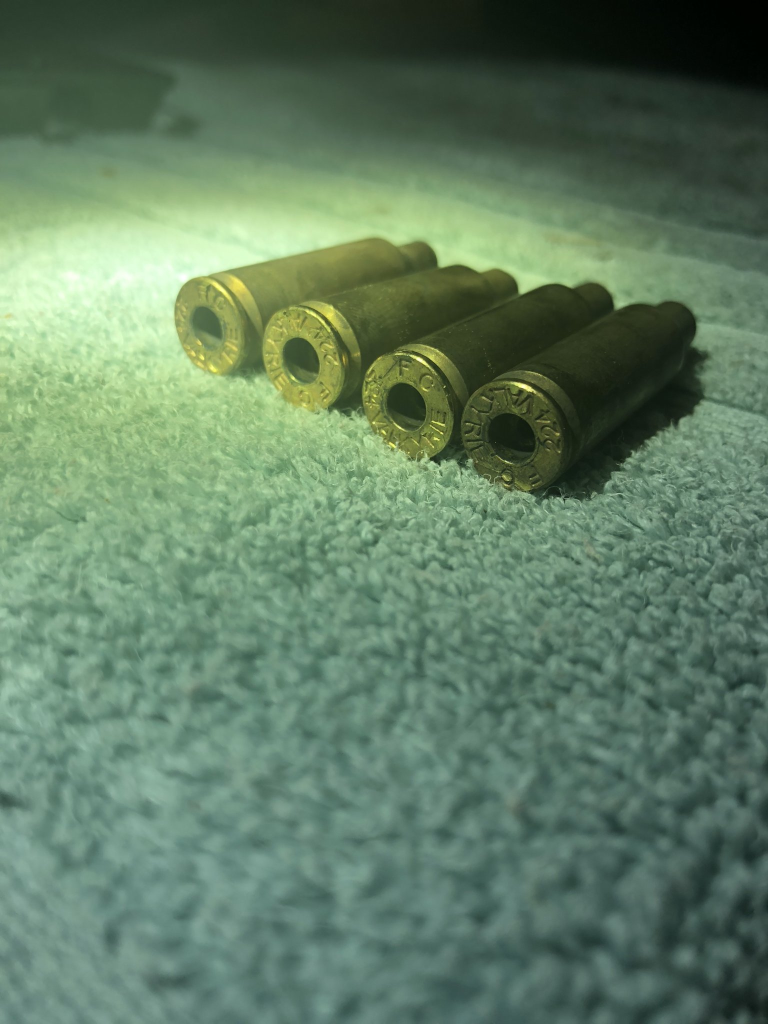

I just came from the range shooting my new savage msr lrp .224 valkerie. Using AE 75gr fmj and blowing primers really bad. Had to stop due to primer lodged in the bolt. Shot almost 20 rnds when this happened. I have some faderal 600gr nosler br to try but I'm not sure if this is an ammunition problem or a defect in the rifle. I have some hornady on order and will try it as well.
Did you adjust your gas valve to compensate for the suppressor and ammo you are using ? Check the Savage attachment on this thread. I don't think the 1 : 7 Twist Barrel can handle anything more than 90 grains without suffering accuracy issues.
Had same problem with my MSR I sent it back to Savage. They told me there is a problem with the barrels and they gave me the option of another rifle or a refund.

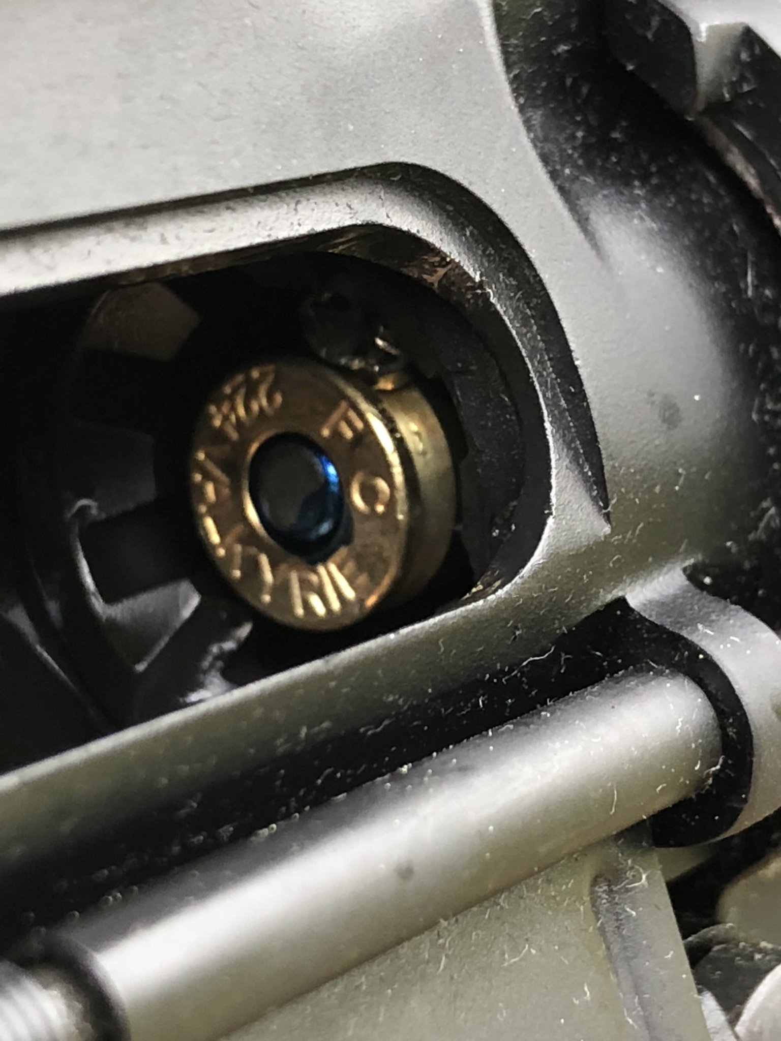

I got my first 224 Valkyrie Savage rifle back in the end of Jan fired 10 rounds had 3 primers out, Called federal and shipped it all back on feb 8th because they thought it might be a ammo issue plus sent all my boxes of ammo, they got it made a decision that it's something in the chamber, so off to savage it went. They received it and I got a new rifle sent with no explanation from Savage what went wrong at the end part of April, fired the new one 2 weeks ago and 2 out of 8 primers came out. So the 2nd rifle is back at Savage and haven't heard anything yet on what we are going to do yet so I called two days ago the rifle has been there for 2 weeks and they are waiting on a gunsmith to look at it! Needless to say I'm in the customer service biz and I'm not very happy right now. Good thing I have a 22 nosler that works! Maybe I should have waited to get bugs worked out?
I feel your pain! My new MSR is back at savage. Took it to the range the first time and started blowing primers Had a primer jammed in the bolt carrier and had to use a hammer and rod to open the bolt. Savage says they have a fix but are waiting on parts. They wouldn't say what parts they were waiting for. If this doesn't get fixed in a timely manner this will be my last savage!
Is Savage still selling the rifles, or pulling them all back for recall? I'd be pissed if I were an unsuspecting buyer and drop a grand on a rifle they knew had problems, then having to send it in and not be able to use it this summer. Some guys don't do forum searching before buying, they just expect new rifles to work.

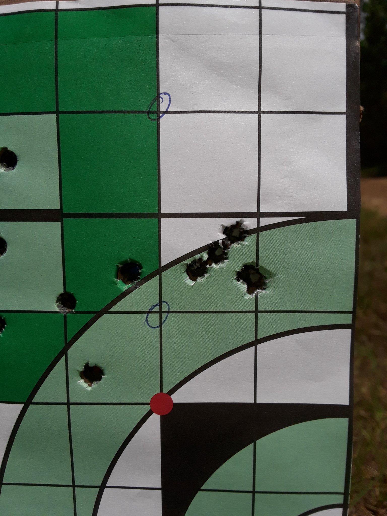

As a bit of a follow up, I’ve had the Savage out to the range again, the 2nd time since Savage fixed it. Still shooting smooth. Shot several groups of five with the 75 grain fmj. Once again, no more primer issues. Group size was in the 1-2 MOA range at 100 yards. Not too bad I suppose. Especially since this is my first AR/MSR and I’m not used to shooting it yet. I’m sure my groups will tighten up with more practice. I’m also starting to price out reloading equipment...
