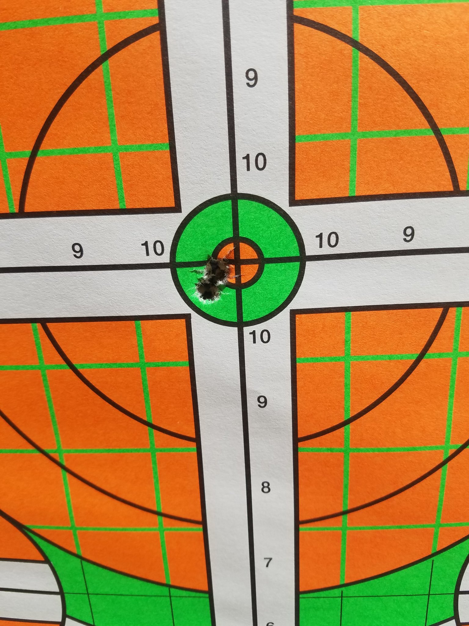

    Mounted my 1st suppressor and fired the rifle this morning. 7.75 MOA shift straight down. This is a 9" Ti TOMB mount can on a 24" Proof C.F. barrel. So far accuracy is identical to shooting without the can , but the POI shift seems like a ton compared to what I've read about others experience.
    Should I give a shit or just carry on ? This rifle will be suppressed exclusively.
    Once the shift was accounted for the accuracy is there , about a 3/8ths group at 100 . I got the rifle in a trade and the previous owner fired hundreds of rounds suppressed without any issues so I don't think it's a threading problem.
    Took the can off , dialed 7.75 MOA down and fired a group.

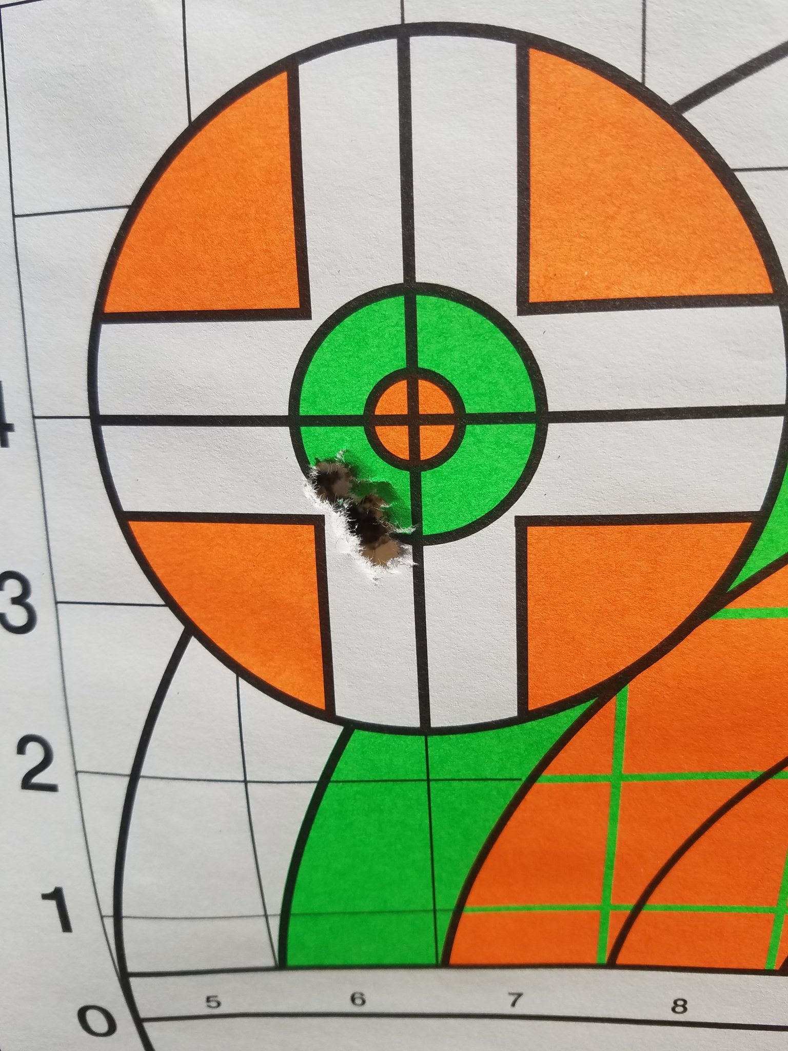

    Put the can back on , dialed 7.75 MOA up and fired another 3 rounds.

    This rifle will be suppressed full time, any reason I shouldn't just finalize my suppressed zero and rock on ?
    Other than zeroing a little higher and to the right, it looks like you’re gonna be fine
    I have an older GemTech HALO, it has a consistent 3 MOA down, 3 MOA right POI shift. Doesn't matter how I mount it, or what rifle it's on. I just dial the shift and rock on.
    Do CF barrel tend have of more POI shift for some reason? Not saying it does, but didn't know if others may have a similar or different experience with their CF barrels.
    To me, that seems like a lot correction. My cans and rifles are mostly Thunderbeast and AI's with heavier steel barrels. Correction might be .5-1.0" at 100 (or none ).
    So I googled and found this thread:
    My only misadventure was when a gunsmith didn't properly thread a can and there was a lite endcap strike. Unlike yours, my 2 or 3 rounds didn't group and barrel was cut and re-threaded elsewhere.
    I think there's a bore rod you can probably use to check concentrically to the bore, as others said, it's probably fine, just a curiosity.
    Had a friend whose AI/MC was timed by a shop with a larger than necessary shim, which caused accuracy issues (brake didn't seat properly). shim replaced. Again, your groups don't suffer.
    I fired about 75 rounds over the weekend. A few to verify zero and the rest from 400-1120 yards . Accuracy was great, my only misses were blown wind calls .
    The shift does seem excessive, but everything else is going as it should at this point.
    may be the carbon fiber barrel. I run an Omega on my christensen carbon 300wm and experience about a 2moa shift. But, like others have said, I never use the rifle without the can, so the shift isn't really anything I'm worried about.
