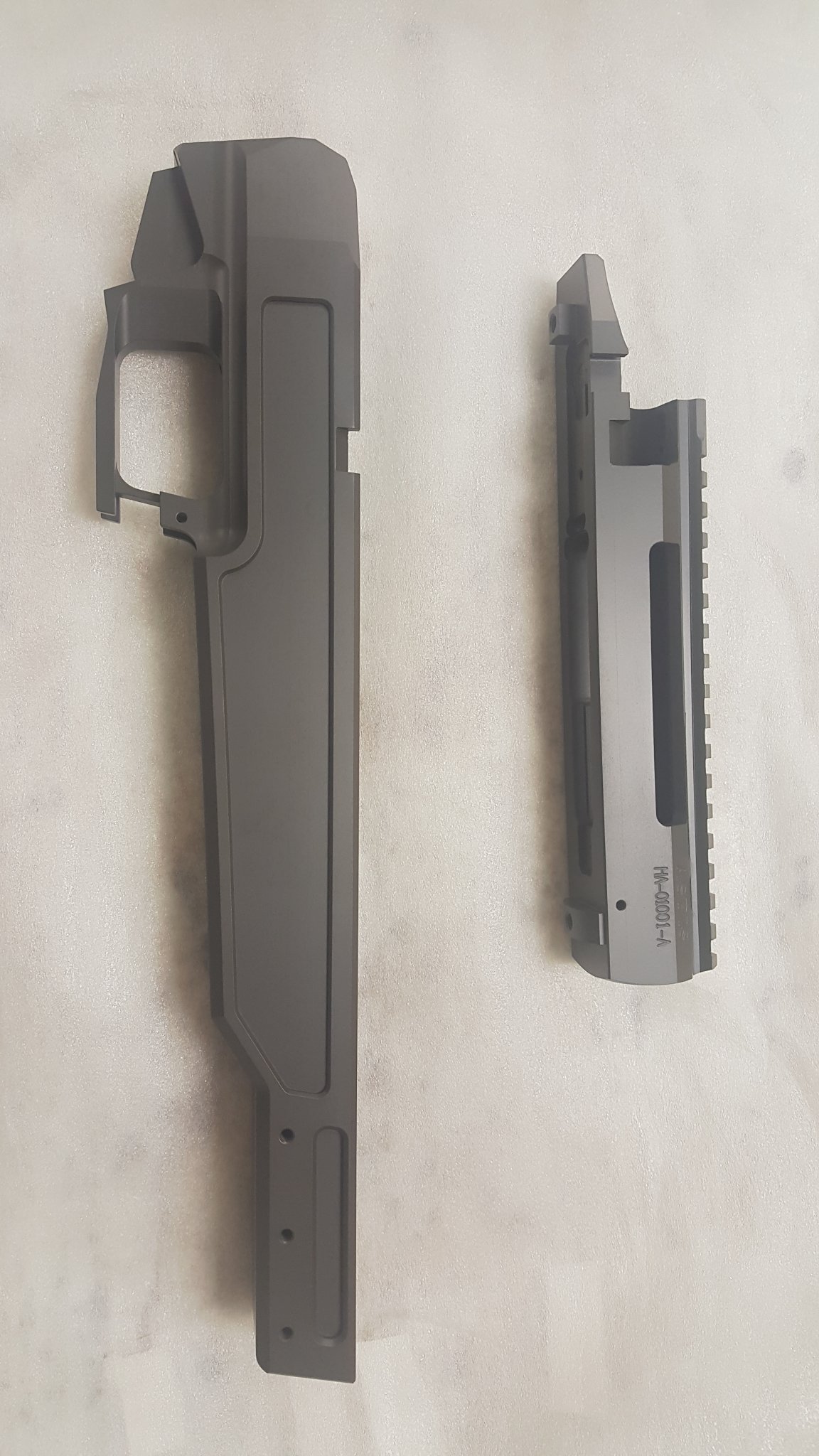

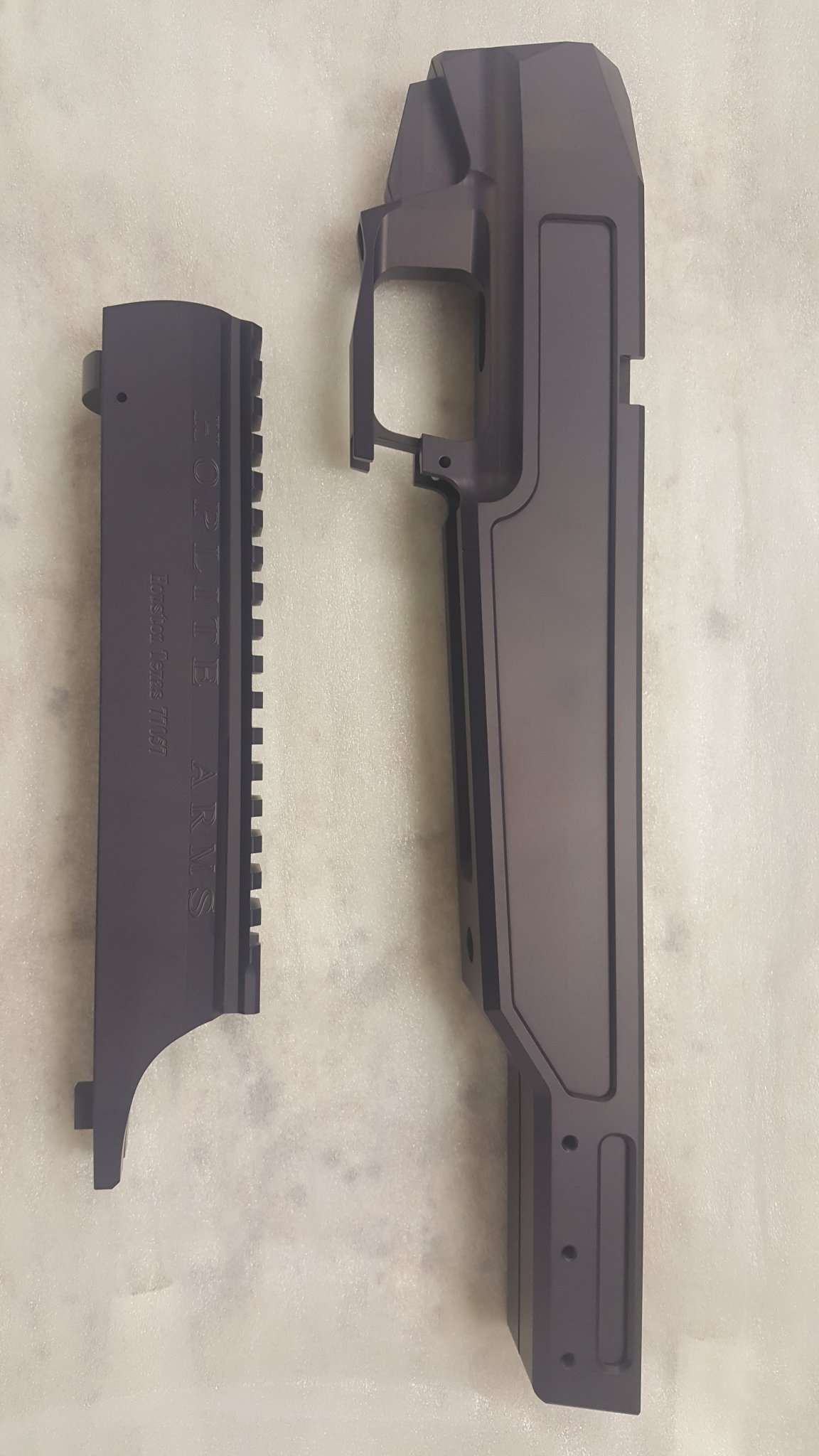

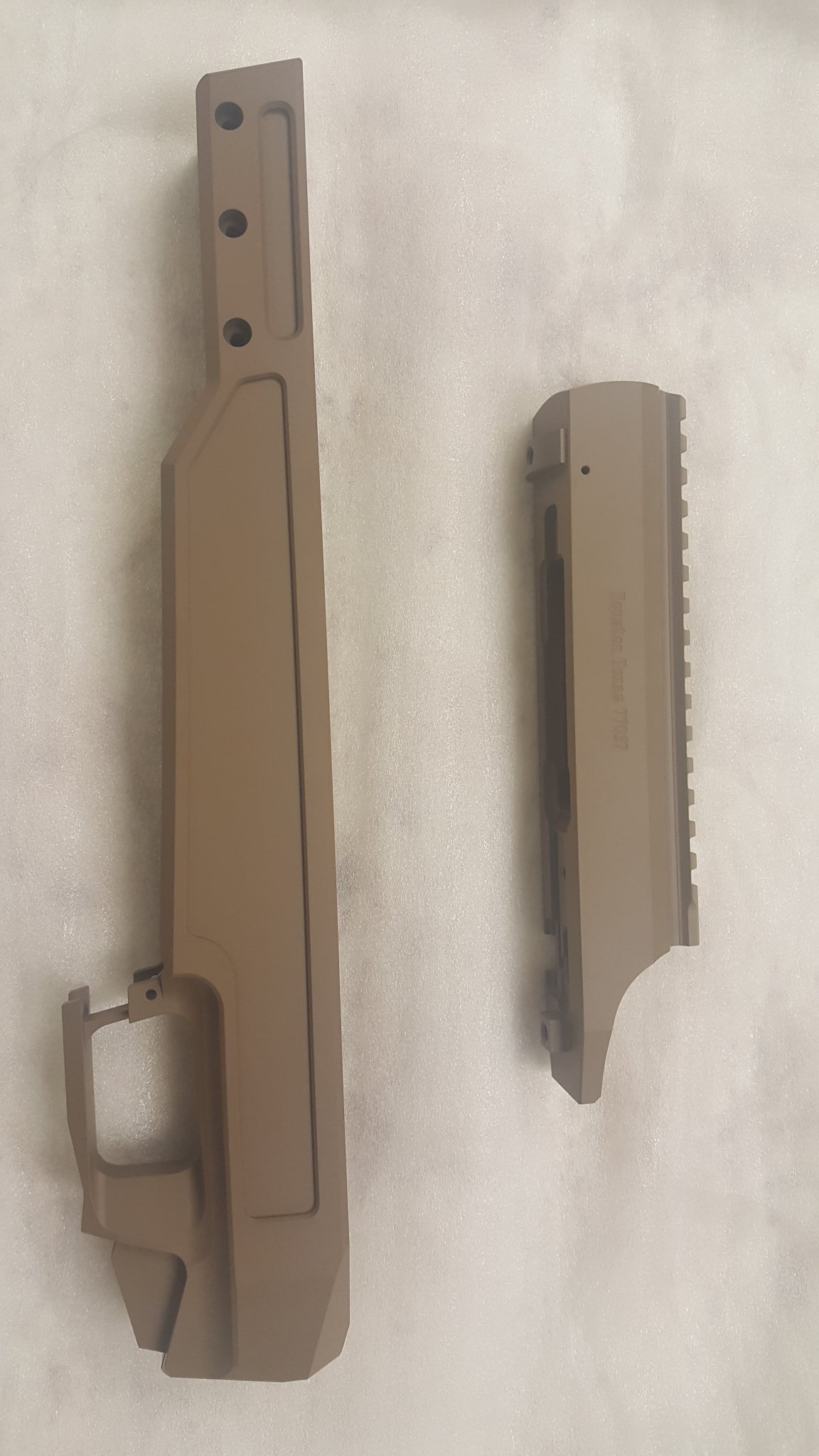

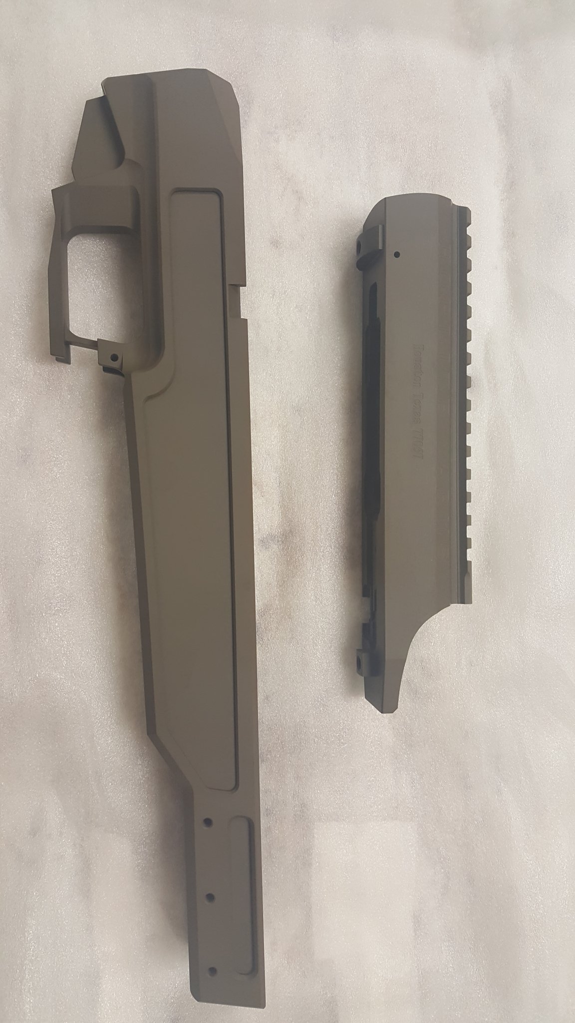

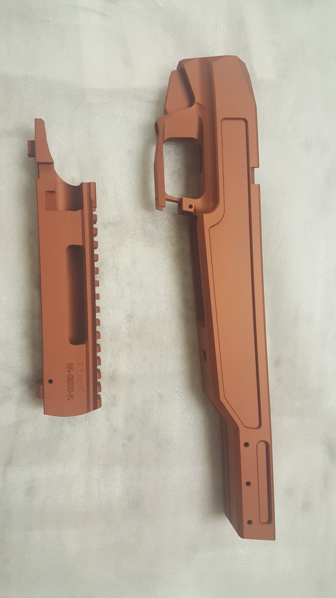

Hoping to get the call from Birdsong tomorrow that my coated products are ready.
They have lots of different colors and variations of colors than listed on their website and since I told Wally to basically "surprise" me with color, color schemes and color combinations......I cannot wait to see what he come up with.

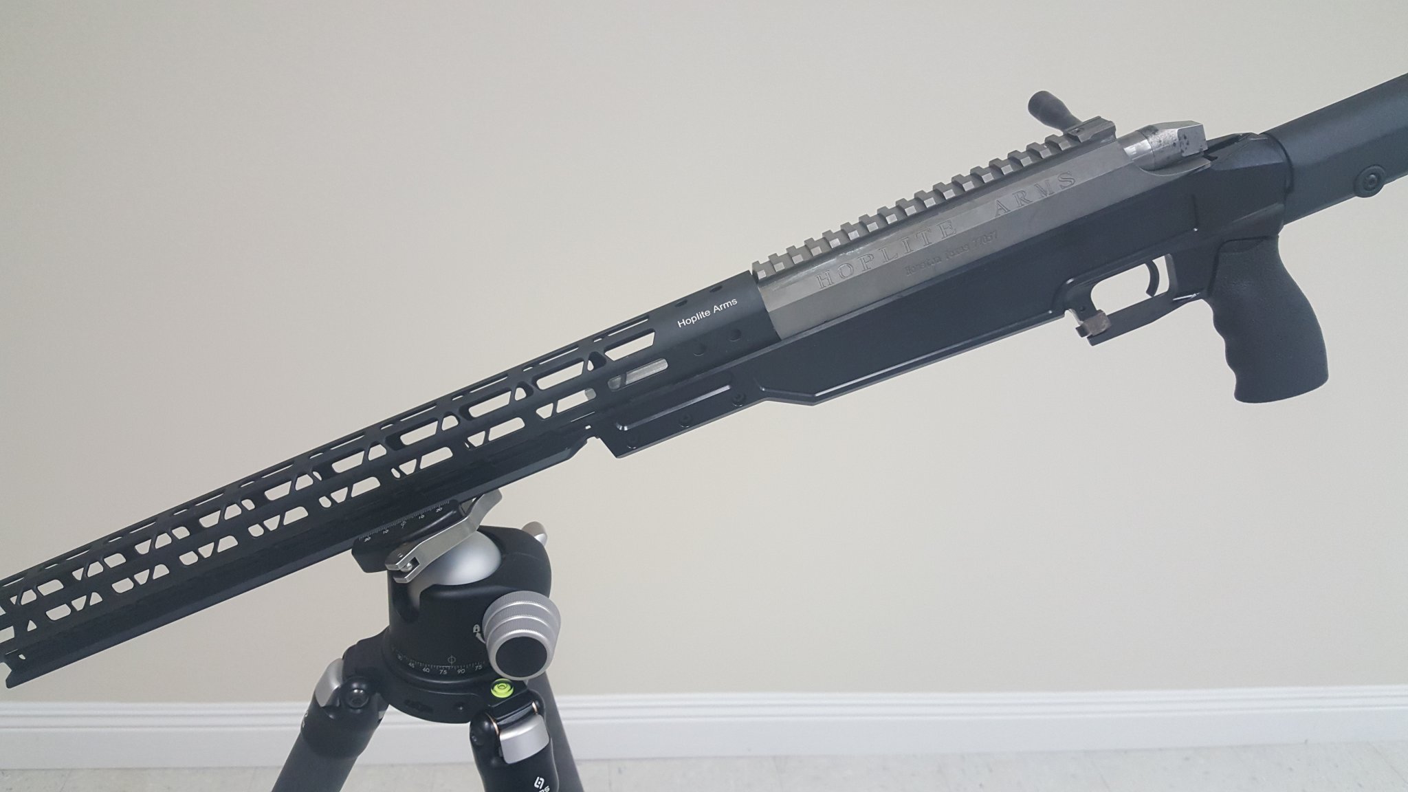

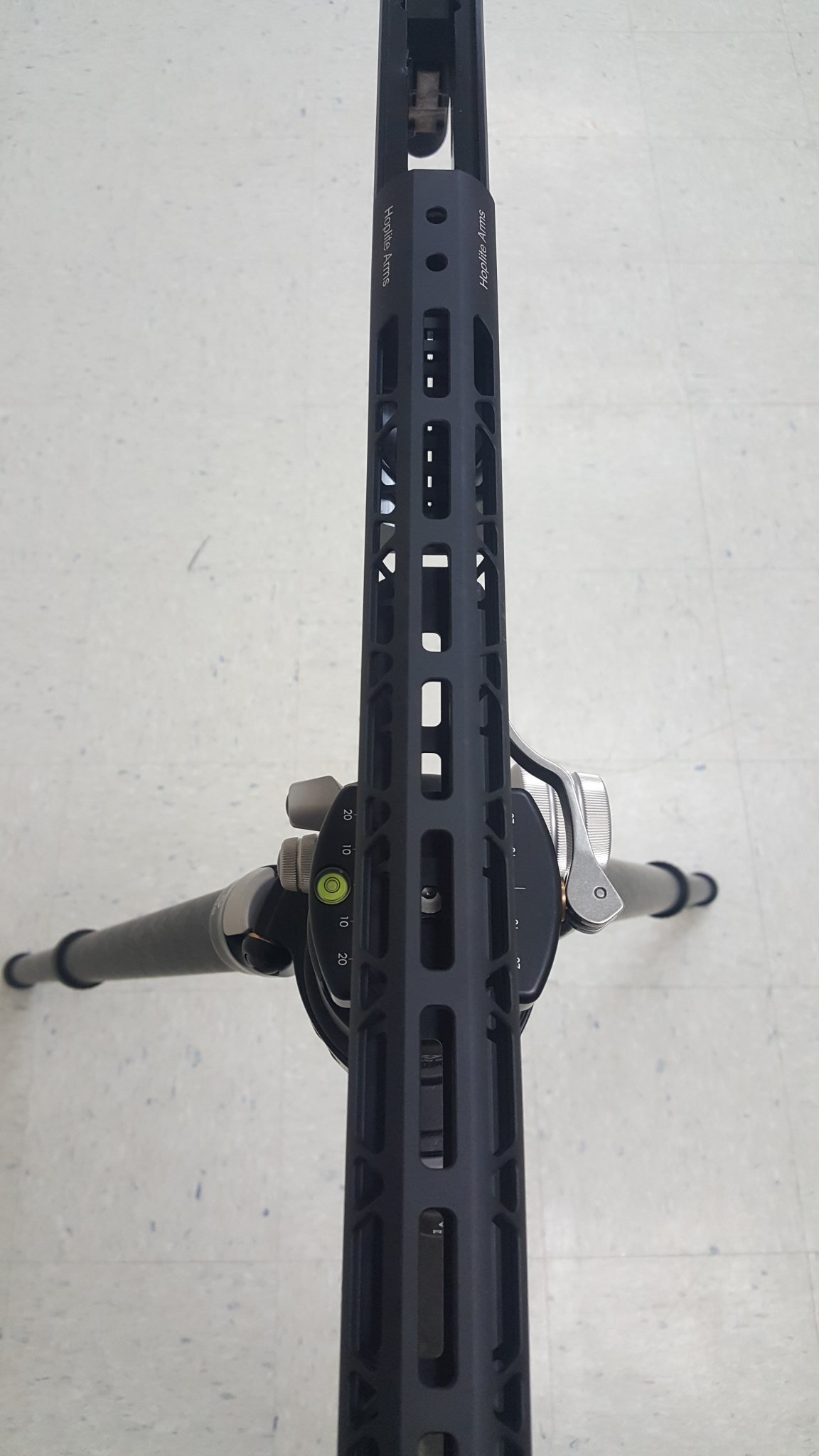

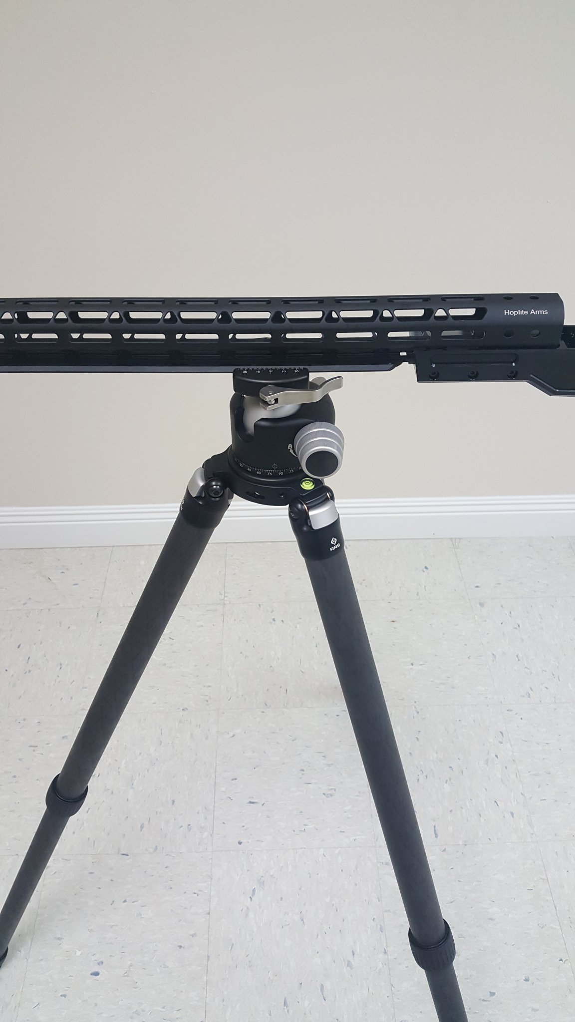

Hi,

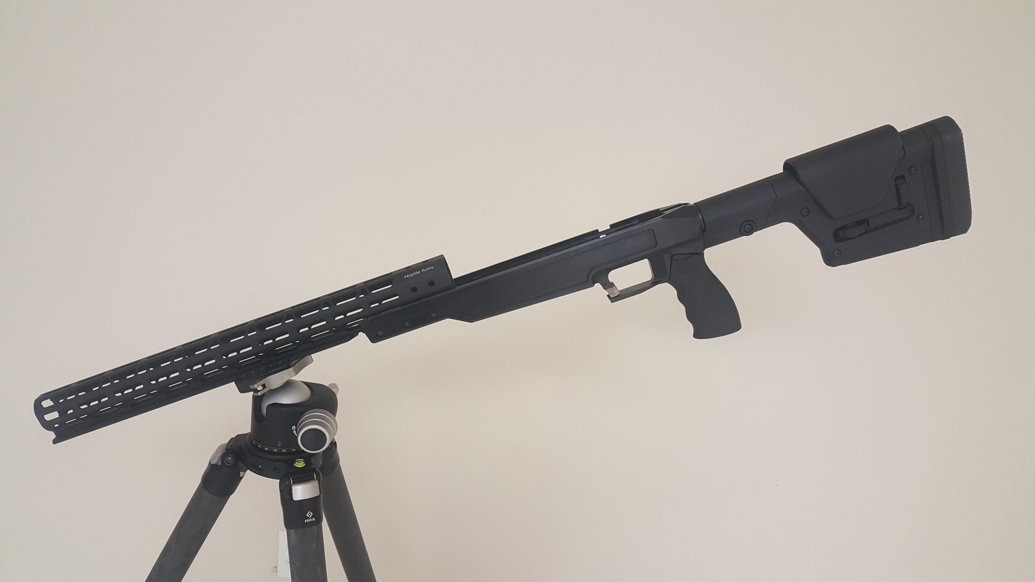

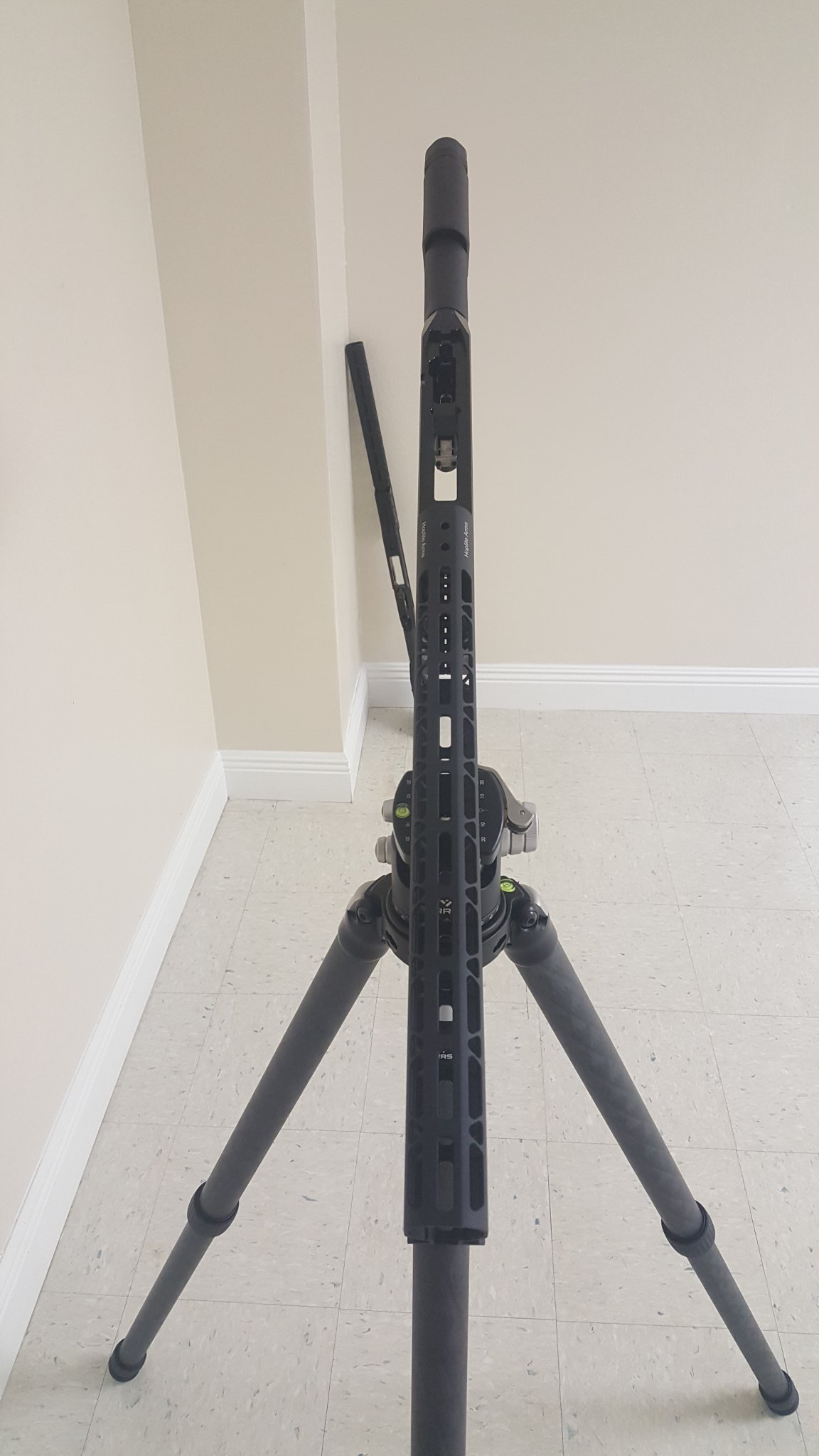

My new RRS tripod and ballhead arrived today from @Praeger and decided to check fit of our handguard....great!!!

Hi,
That might be one of the best write-ups and information about Birdsong coating on the www.
We are doing the entire receiver, bolt assembly, breech cylinder, trigger, etc etc all the way down to pins, springs and screws. Inside and Out.

I’m thinking copperhead or gray if the rest is black.
