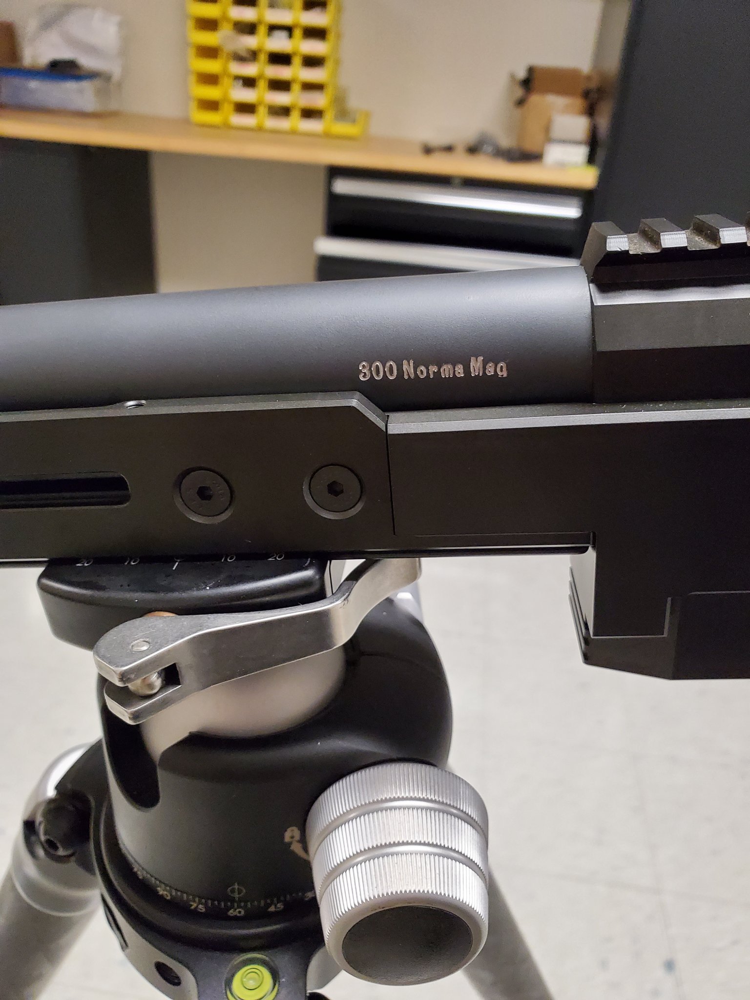

New bartlein alloy in 300NM.
Sincerely,
Theis

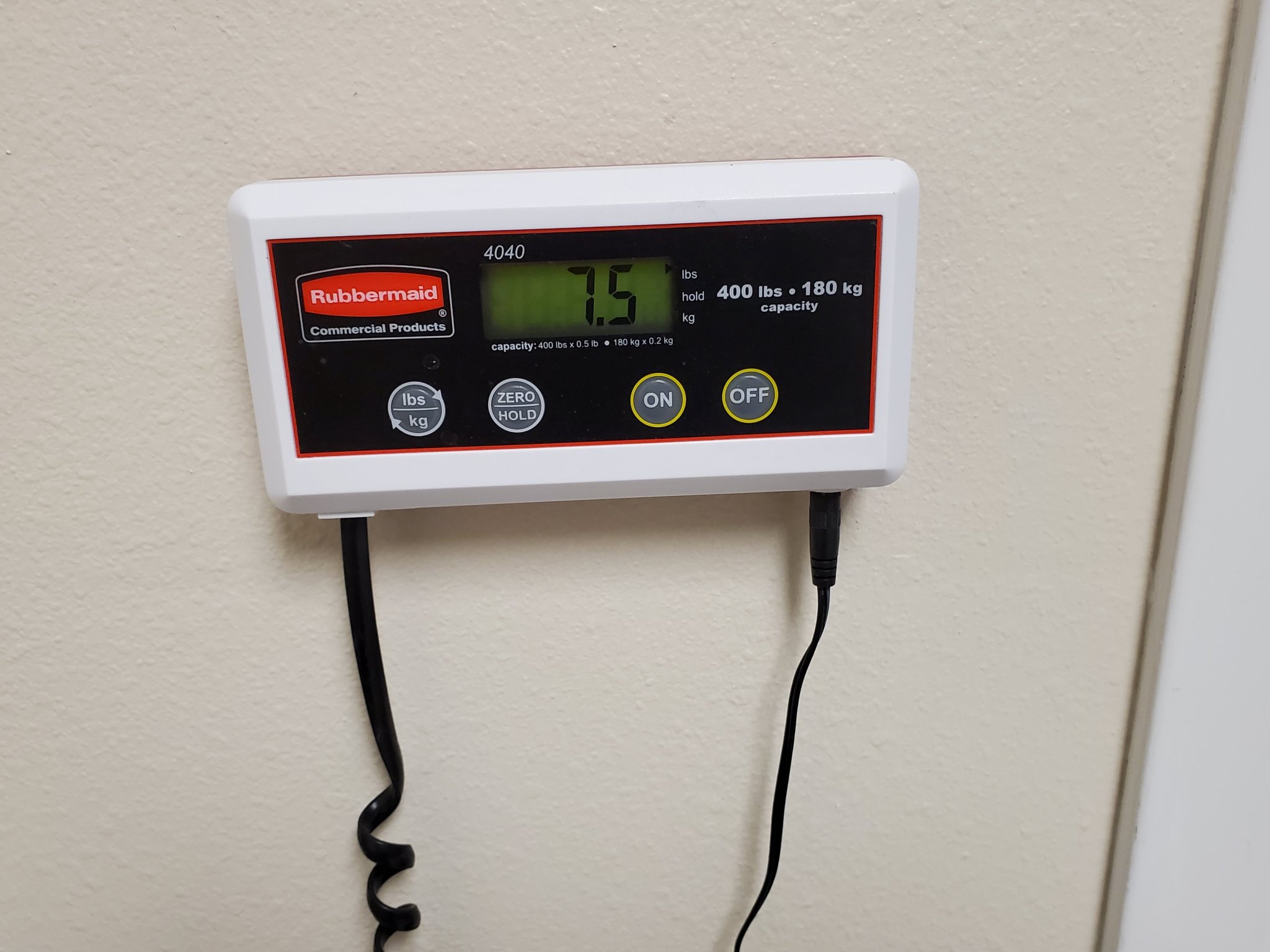

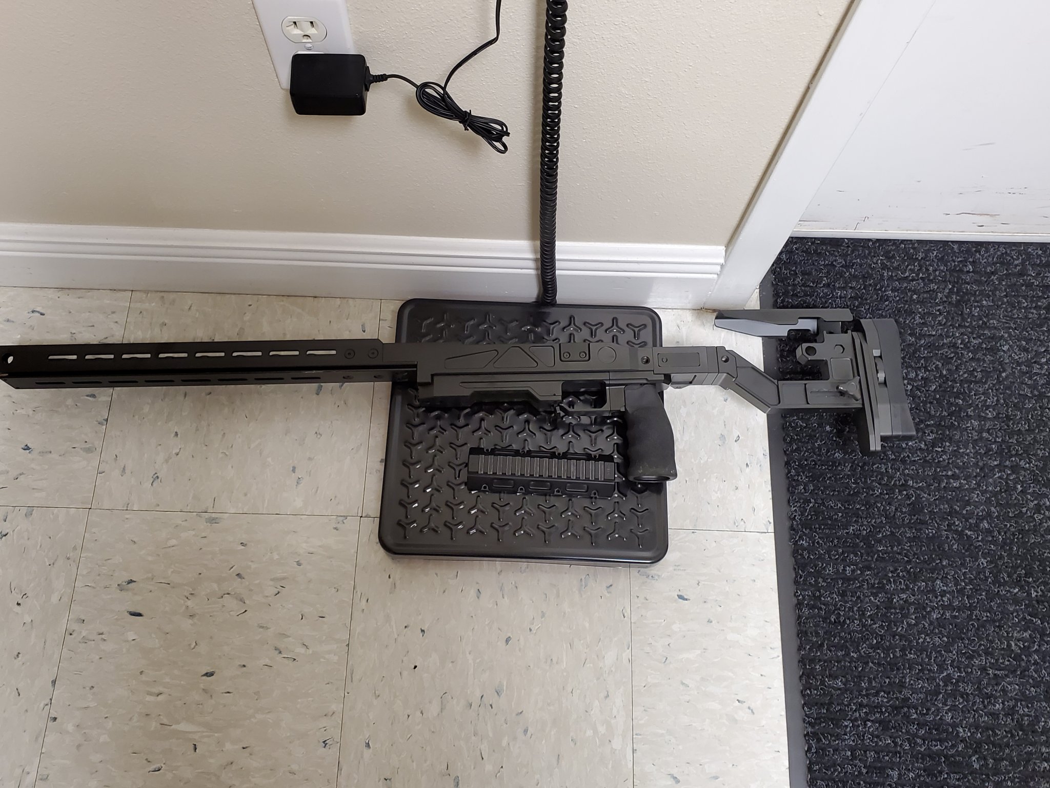

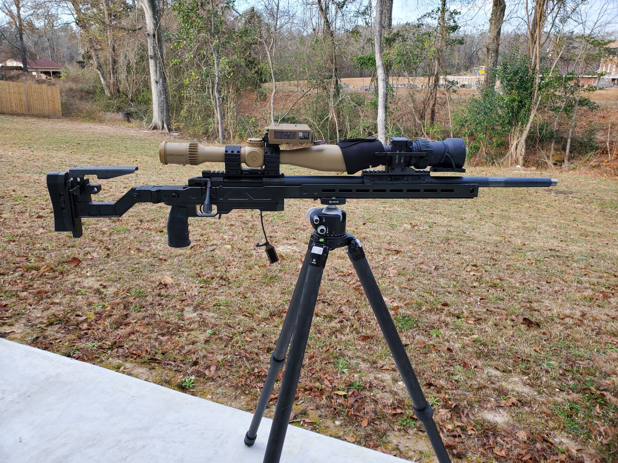

What is the weight of the current chassis with the nv bridge?
Hi,
Here is weight for you as requested.
Sincerely,
Theis

Hi,
Sincerely,
Theis

Heavier than I thought it would be. Is most of the extra weight in the buttstock? Where is the balance point of the assembled rifle balance?
By the time the rifles that will be more dependent on balance (short action), I’m sure they will have changed enough that the weight/balance on this rifle likely won’t be indicative of further and/or SA rifles.

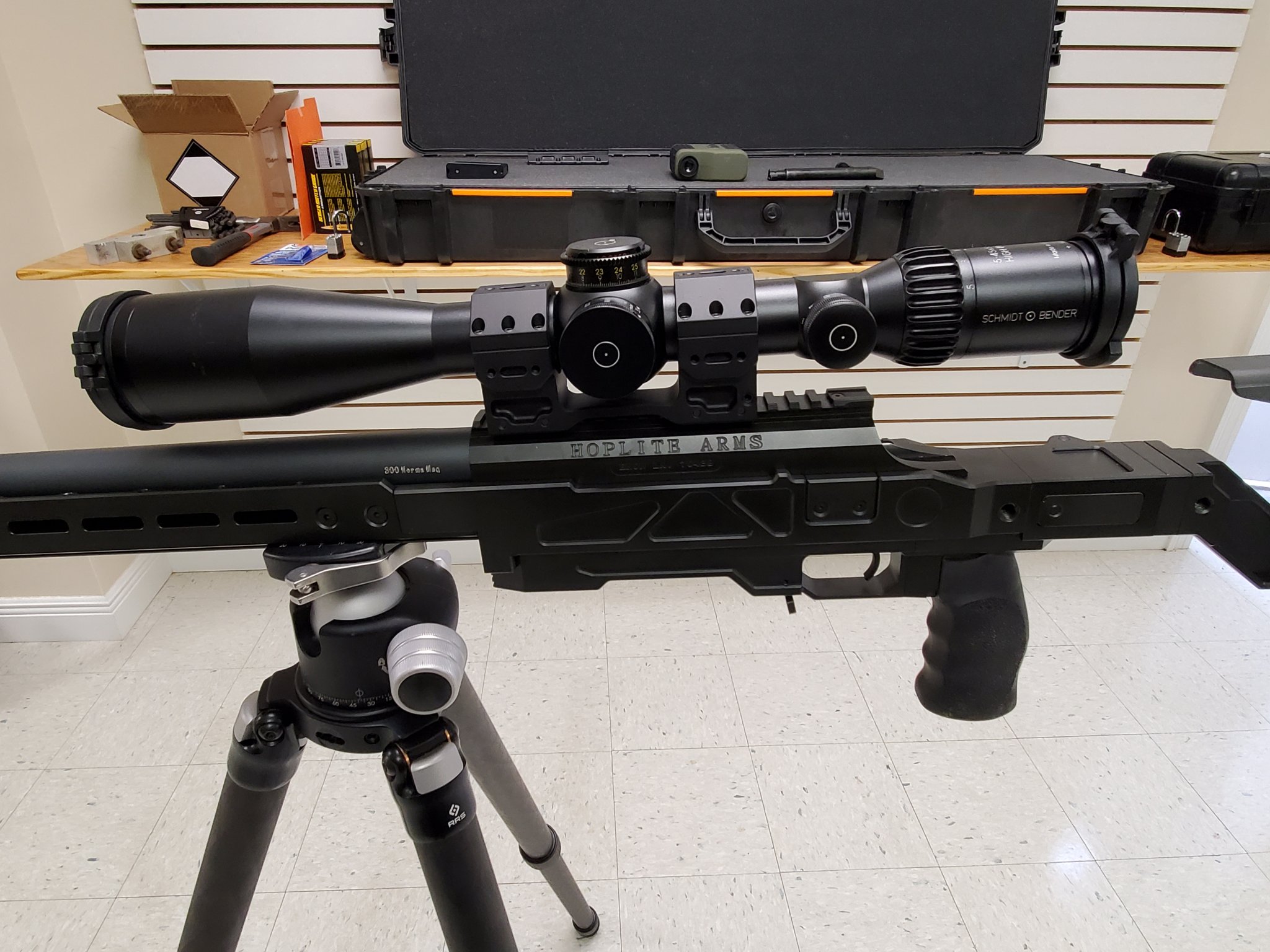

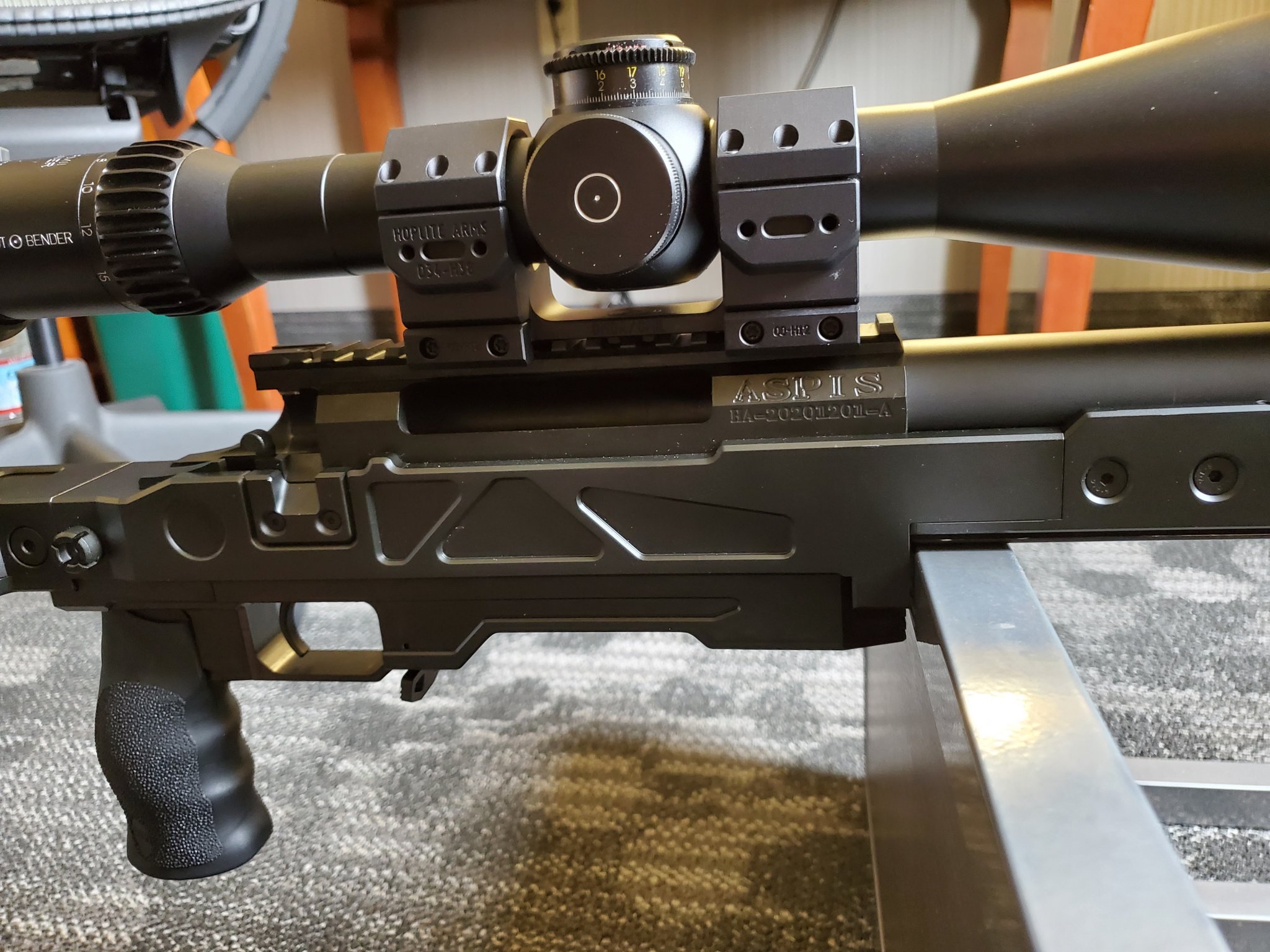

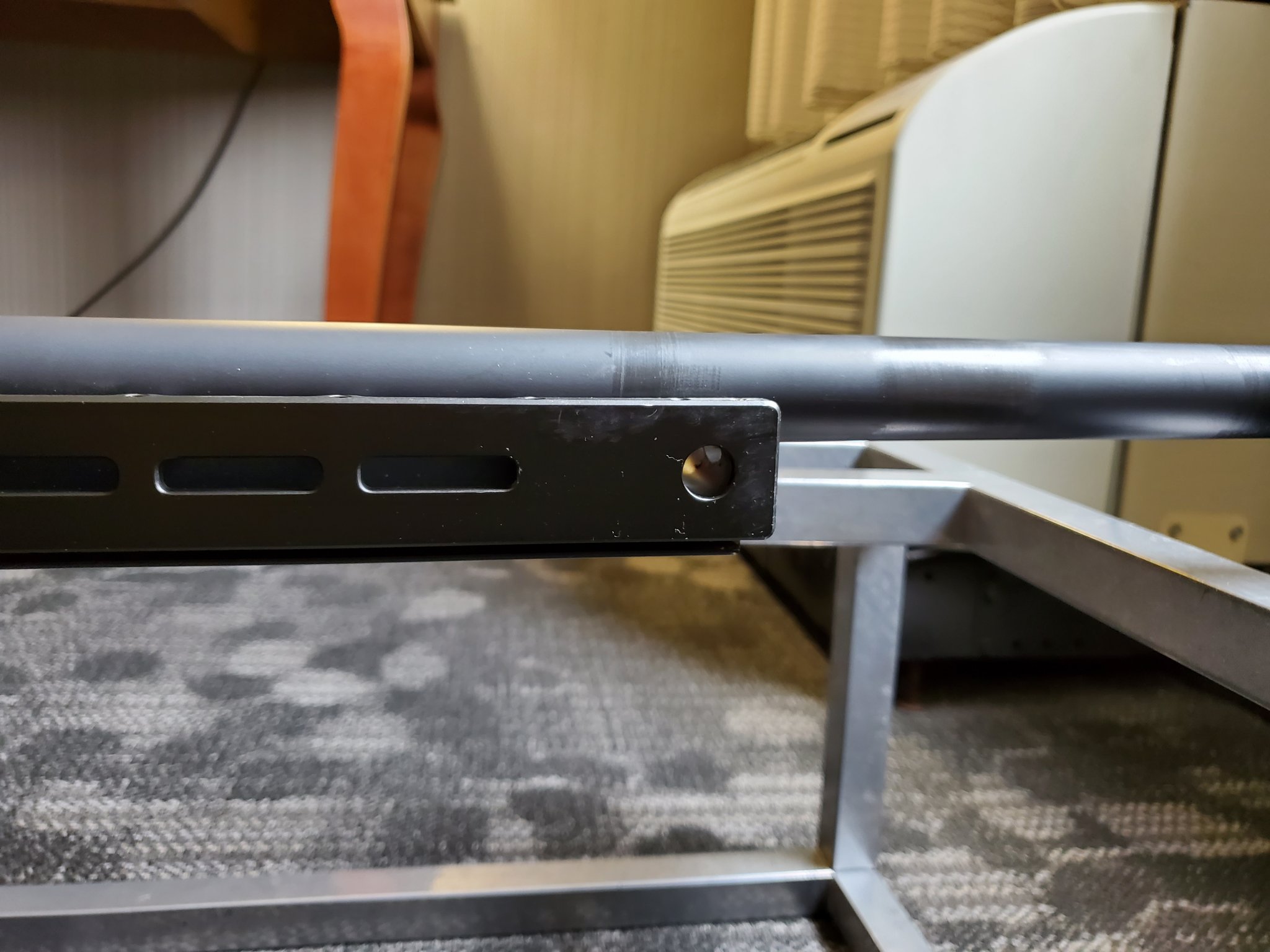

Heavier than I thought it would be. Is most of the extra weight in the buttstock? Where is the balance point of the assembled rifle?
Hi,
The Apsis with its 27" MTU contour barrel actually balances about half in in front of "barricade" stop on the front side of the center section depending on how wide a surface it is being balanced on.
Due to the low centerline of the barreled action in the chassis and the fact the forend is 18" worth of 7075 instead of 16" or shorter..the rifle holds and feels well.
Edited to add..Pics from my current hotel room while waiting on rest of crew to arrive.

Hi,
View attachment 7534543View attachment 7534544

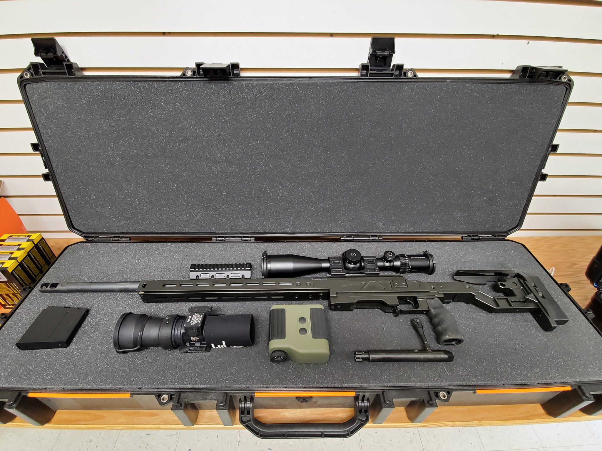

Hi,
Brief (because on my phone lol) update from this past week's testing.
1 issue.. In 5 damn minutes an independent .mil guy managed to decock the bolt while cycling it open. He was not use to running a 3 lug action so as he was pulling bolt back he was ham fisting the bolt to get handle to "feel" like it was in his muscle memory location..so in doing so he found the knotched ramp to remove bolt from receiver, lol.
Solution.. Will be making the bolt release part a non spring loaded and ramped piece...will make knurled knob hard set screw with half turn threads to raise/lower the bolt stop.
2 issue...We had 1 model of a berger ammunition have failure to fire but another model from same manufacturer fired no problem.
Solution.. Will be measuring all the 230gr berger ammunition.
3 issue.. We found inconsistent ejection.
Solution.. Ordering custom spec'd plunger springs.
