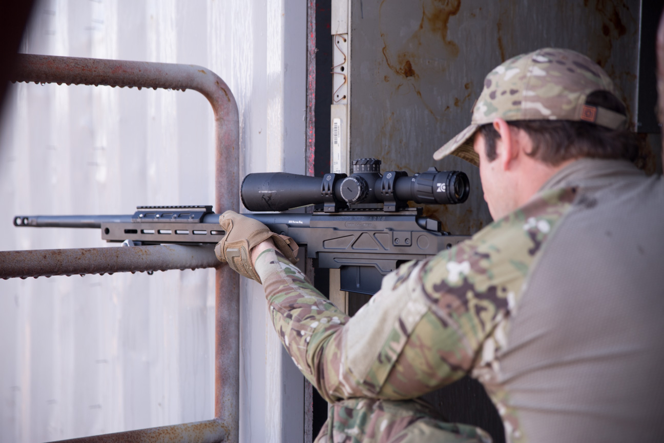

He can't put a work of art on that wet and rusty metal bar!! Hand that man a Game Changer! LOL
Rifle is just another tool.
Also, photo ops are photo ops. It doesn’t look as cool when you’re 8ft back into a room in the shadow where you should be and not outside on cool looking handrail.
Must have some lighting or something I looks a lot better than just sunlight.
They dragged some dude around holding a light.
Nay, mere mortals, the beauteous light that bathes this weapon system from above comes not from some dirty shuffling pheasant, but from Apollo, the most beautiful Greek god, and god of light and of the Sun, of truth, prophecy, poetry and more.
Here’s another angle with different frame rate.
I didn’t have a proper rear bag, just a fortune cookie. With proper rear bag, I’d expect a bit better recoil management.
Hi,
That angle really highlights just how much "control" the shooter focuses into the rifle and how little the rifle moves under said "control".

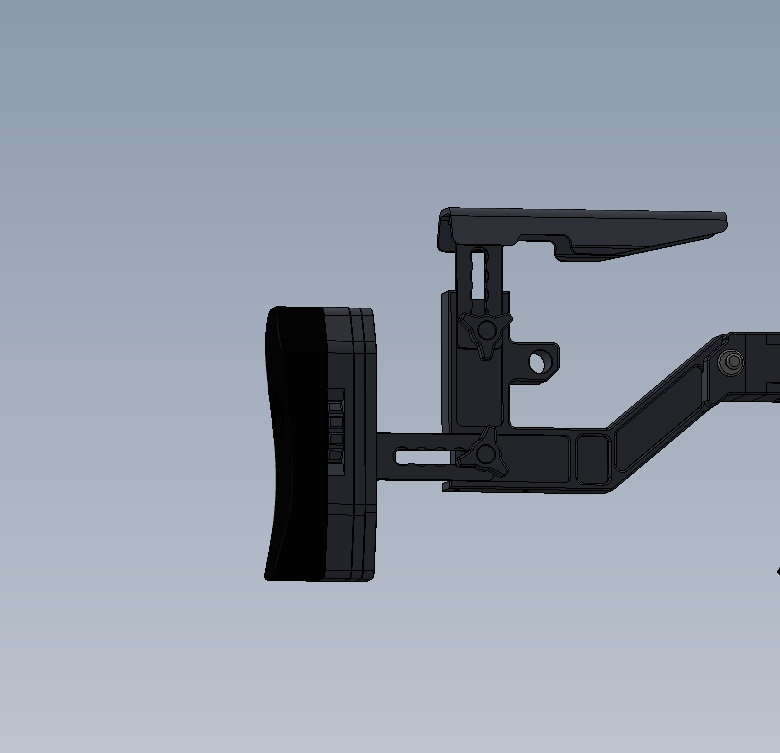

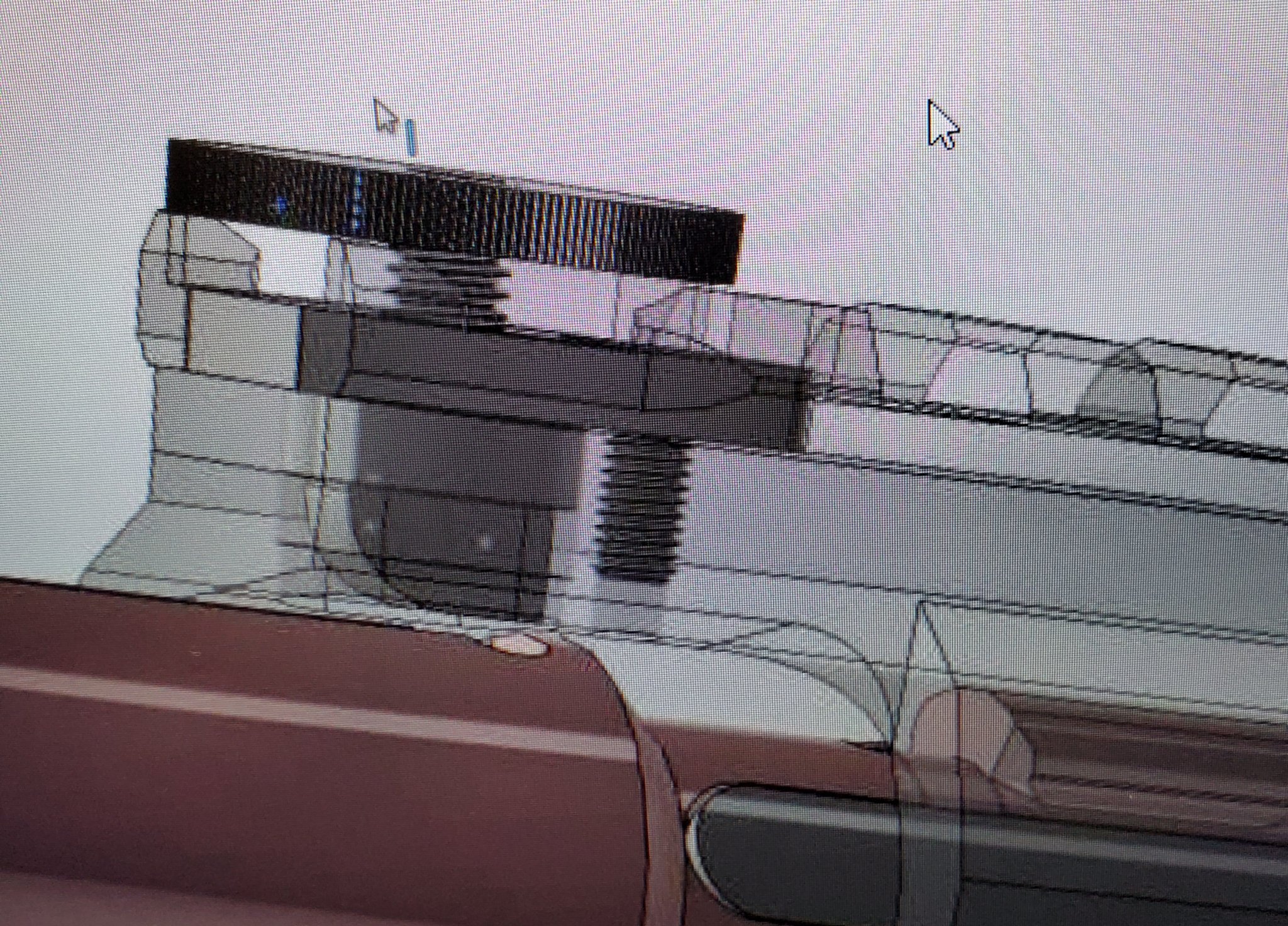

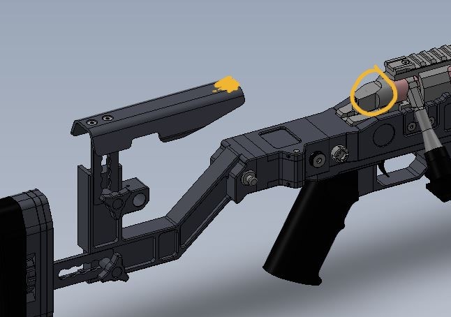

Hi,
Adding "enclosed" tracks to the adjustment bracket areas so that when you loosen the knob to make adjustments the brackets themselves do not flop around along with making the brackets themselves slightly thicker.
Pretty much the only thing left of the original version is the center section itself BUT even that was dimensionally changed to accommodate the forend...
Sincerely,
Theis

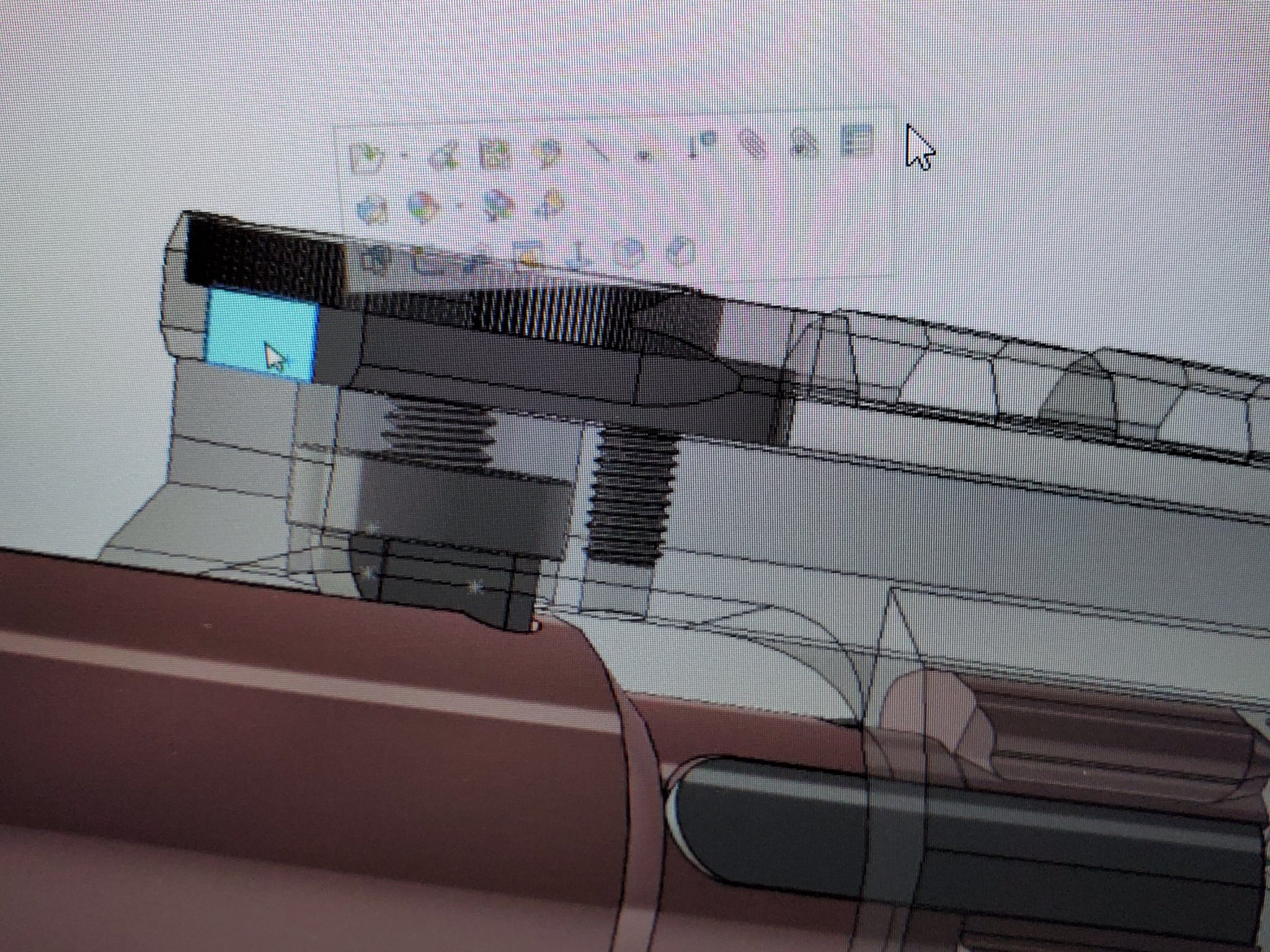

Hi,
Bolt removal issue should be resolved with this simple redesign.
Bolt Guide in Down position.
Bolt Guide in Up Position
Bolt removal component from top.
Bolt body "notched ramp" to line up with bolt guide has been removed. So there is no way to accidentally line the stars up for bolt removal while operating the bolt.
Interior tracks for the adjustment brackets on chassis.
Sincerely,
Theis

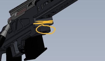

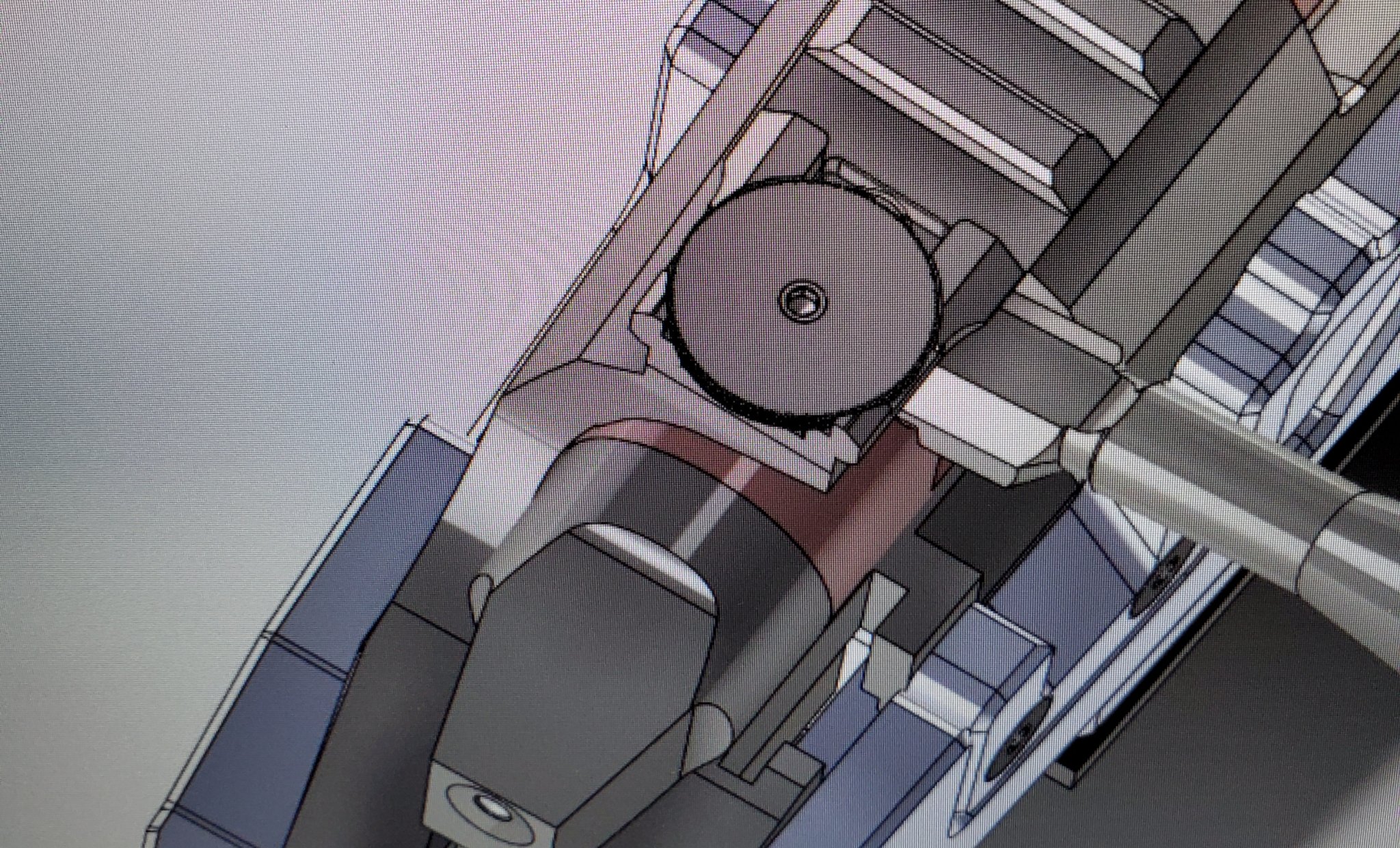

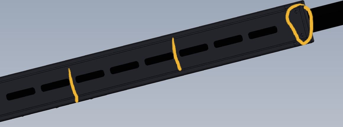

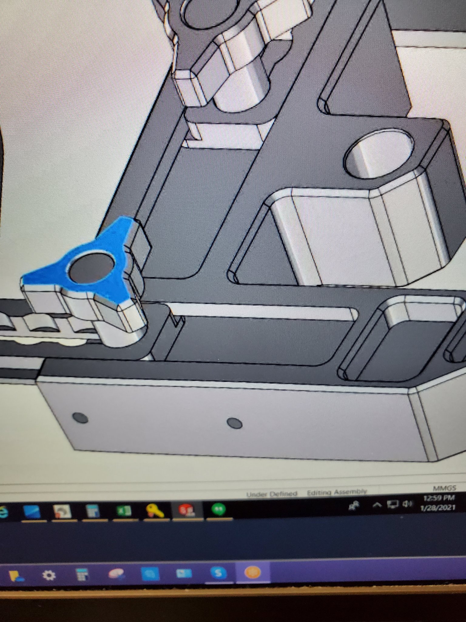

Here are prime examples of my artistic capabilities, lol....This is what I sent to Engineering this morning, haha...literally like 15 minutes ago, lol
Note To Engineering:
Serrations in the circle need to be put onto the piece directly above it.
Scallop the cheek piece where I have it highlighted to allow the circled piece to fit through it so even if cheek piece is all the way down the bolt can still be removed.
The rail stop screw holes in the circle...place same holes where I have the lines.
Sincerely,
Theis

Hi,
@gayguns
Sincerely,
Theis
I would love to get sketches this helpful from my management, FWIW
Reactions: Tchitcherine
Hi,
For some reason my Engineering guys do not seem to mind my 3D modeling abilities, lol.
QC guys on the other hand........They pretty much have panic stricken anxiety attacks when I tell them to standby for update to process control policy.
Sincerely,
Theis
