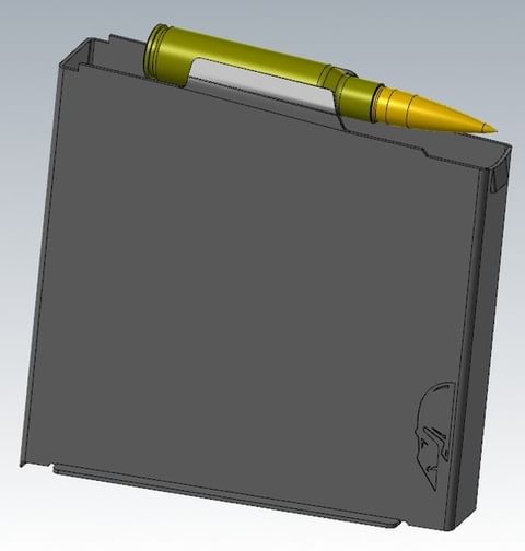

So earlier in the thread you were demanding to be able to shoot solids from mag length in that 300nm.
why not just make bigger mags? This isn’t a plug and play LEGO system like everything else, why not use proprietary mags?
Hi,
I haven't changed that for the mag length monos, lolol
Just made it doable with short action cartridges via the above magazine design.
Sincerely,
Theis
Reactions: lash
Hi,
Sincerely,
Theis
So when you get into the bigger rounds such as 300nm and 338lm just seeing if there was any thought process to not just making a longer mag for them?

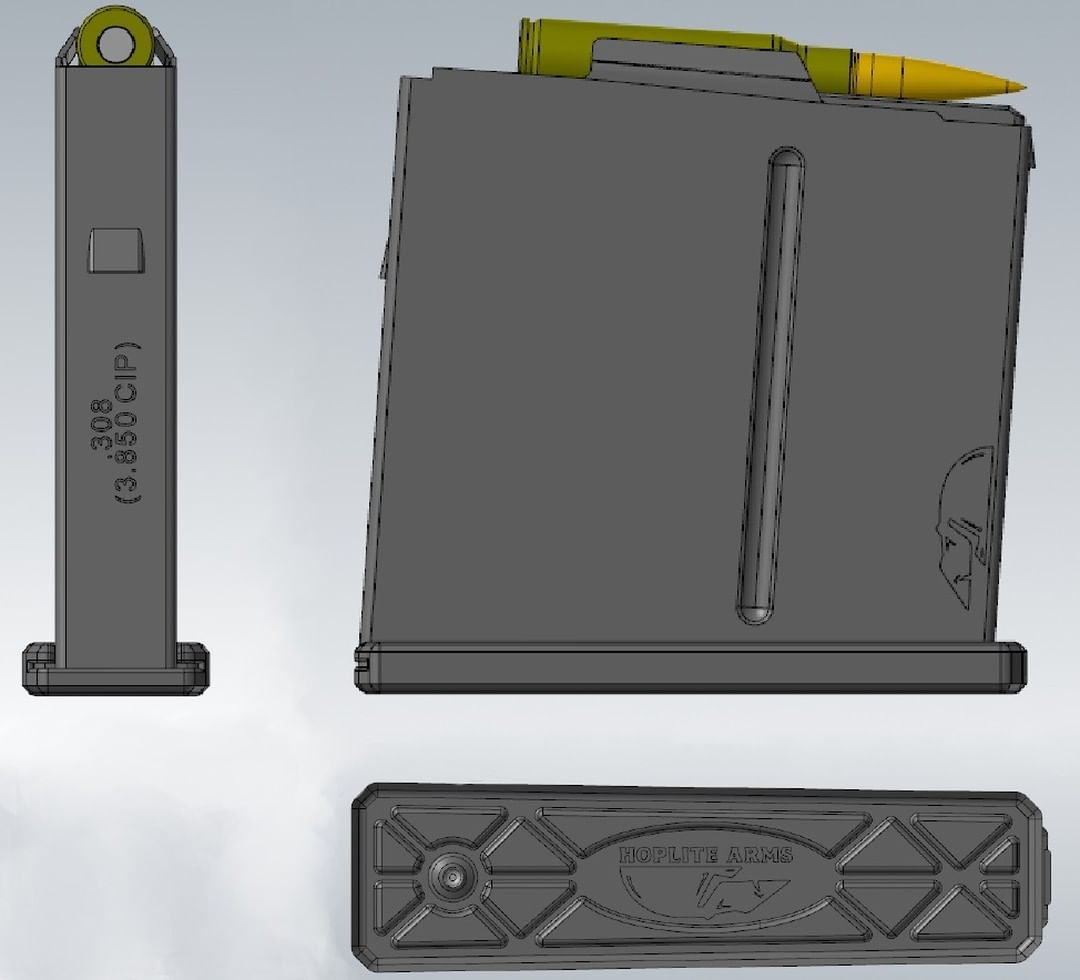

Hi,
CIP Length Lapua Magnum magazine exterior with 3.1" COAL interior and feed lip geometry for short action cartridges.
Spacer and follower design in works, lolol
Then standard magnum interior and feed lip geometry with same exterior magazine dimensions.....
Sincerely,
Theis
Looks good,
Surprised that it hasn't been done before as I think its a great idea (y)
design is already patent pending im guessing
Hi,
Along with the spacer and follower design.
Sincerely,
Theis

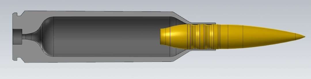

Hi,
Still participating in the marathon, lololol... one step at a time while begging and crossing all fingers for coating update today!!!
30 Leonidas-----Will not chamber in normal 300NM chambers just in case some idiot ever tries to shoot one in his Savage.
Pay no attention to the projectile, lol....it is just a space filler.
As soon as we prove out the 15-5PH printed cases in normal 300NM then we will get these made for testing.
3.850" CIP magazine converted for short action cartridges.
Sincerely,
Theis
