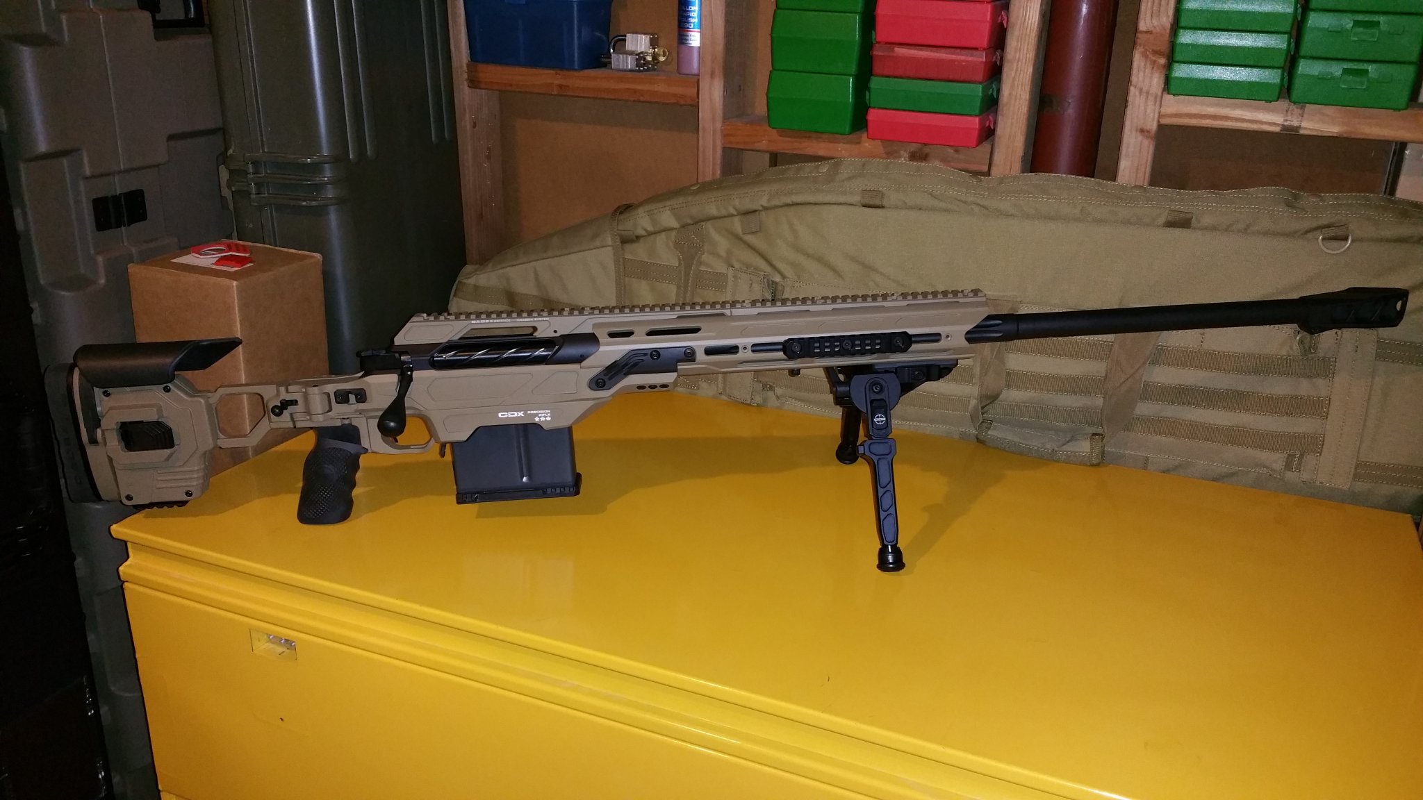

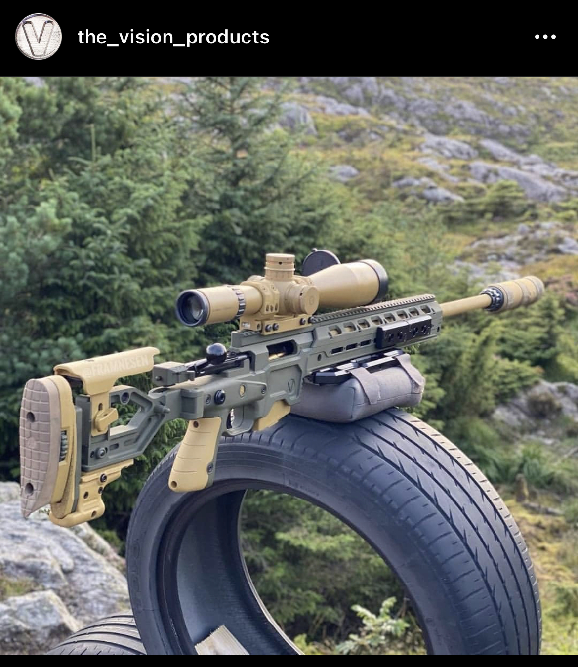

im having a dilemma...lol
i know im choosing a "cool" color for my chassis
but what am i dong with the action and barrel?
keep the action/bolt barrel black or paint that too
any opinions
I like the contrast between different chassi and receiver/barrel colors. I have a few rifles like that and think they have a great look to them.
But, worse come to worse.... You can always hit it with some rattle can treatment!

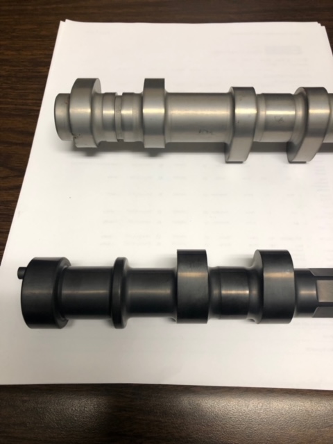

Hi,
So I have been travelling the past couple days and you guys are running rampant with no supervision, lololol
OK so in regards to all the color, treatment abc, treatment xyz, etc etc....let me lay some more transparency out for you to assist with your potential decision making and give you a glimpse of what we have been doing the past week or so since having electricity restored and waiting for barrels.
OK so onto the transparency lesson....
A pure nitrided part with no post operation oxidation layer is always the top color while the bottom color is with the post operation oxidation layer completed.
More to come this weekend as we talk to the gentlemen in California that is pretty much responsible for nitriding being to the advanced level of utilization of today.
A post Oxide layer is not the best surface for paint or cerakote type coating as it does not adhere to the oxide layer very well. So whether you all know it or not...if you have ever received a nitrided product that is the color of bottom picture and sent it off for cerakote or such...that oxide layer was removed and the part was brought back down to the pure nitrided color of top picture :)
Sincerely,
Theis
At least with ion nitriding, there’s the black layer (Fe3O4), white layer (Fe_x N_y), diffusion zone (iron, chromium, etc. nitrides and carbides), and substrate (steel). Nothing sticks to either the black layer (corrosion-resistant) or the white layer (extremely hard); the surface energy is damn near zero. (Both layers are microns thick.)
The top image looks like it’s actually blasted back to the diffusion zone (which is extremely tough and slightly harder than the substrate, and millimeters thick), which does have enough surface energy for stuff to stick to, while still providing 99% of the mechanical benefits.
NASA PRC2004 (on rev D as of last year) is a great process for lots of things. Paint primer isn’t one of them :p
Things might be different for the assorted ferritic nitrocarburizing processes, but the broad results are so similar that I can’t see why adhesion would be.
Sincerely,
Theis
