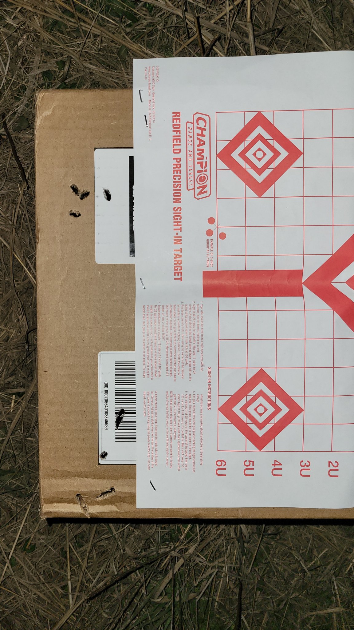

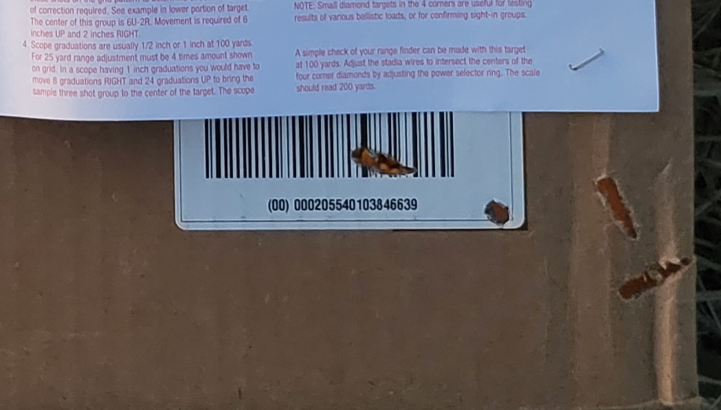

I know this is a somewhat older thread, but are people still seeing these 147 ELD-M fail in flight?
These were 5 shot groups at 350m loaded with 147 eldms I shot this last spring during load development. They would shoot .5 moa groups at 100m and then blow up or destabilize between 300-400m.
I decided they weren't worth the trouble. It seems like it might be a lot to lot kind of issue. Hornady told me they hadn't heard about this before, which seems, unlikely.
Correct. Should have clarified that the statement from hornady is an outright lie. Unless they fired the entire staff that knows about it and hired the janitors as customer service reps
Just making sure. I didn't pursue it further with them and sold the rest of the bullets at a loss.

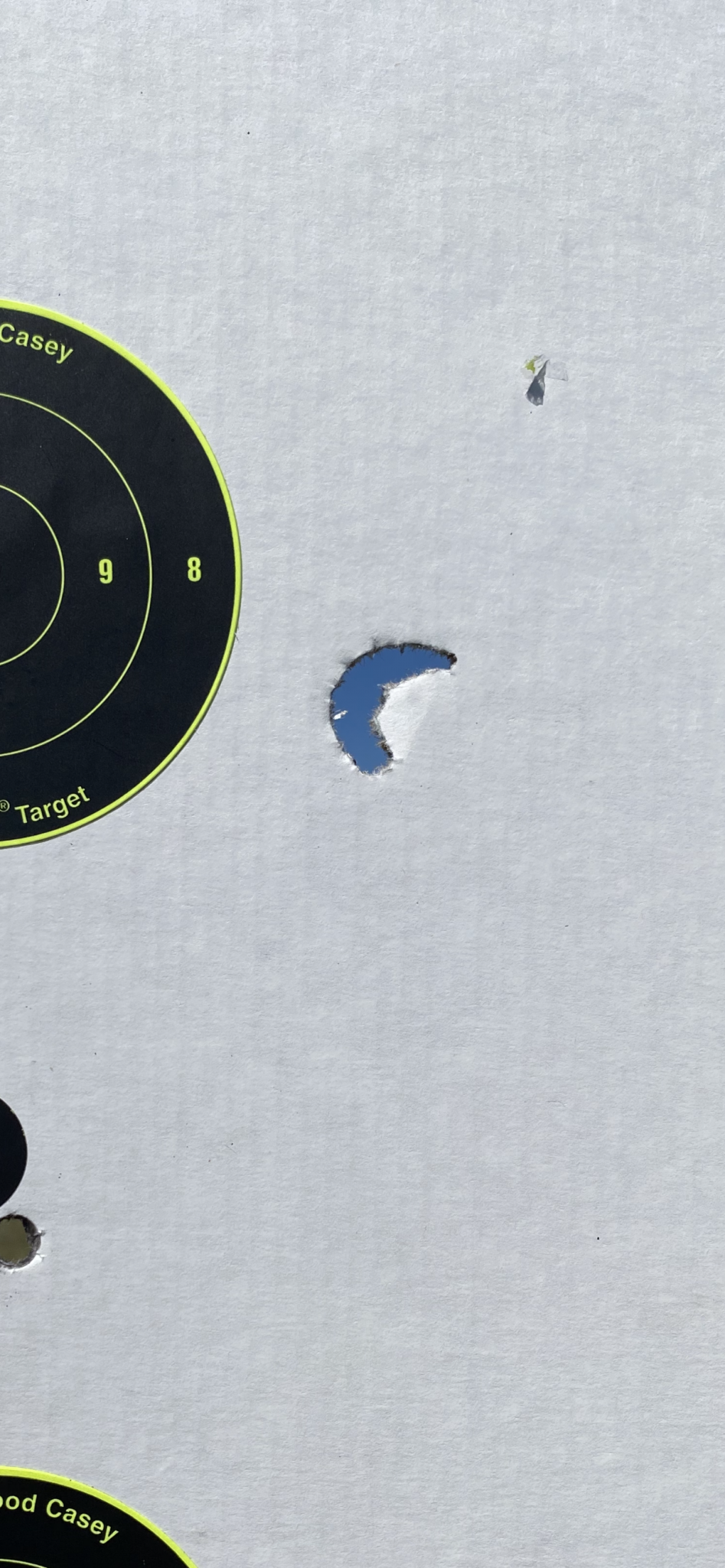

Searched for 147 ELDM jacket separation or bullets blowing up/coming apart down range on here and one dead thread with 7 posts about the 147 and another on the 180 ELDMs.
Over the past 2 weeks i've talked to at least 15 people who have experienced both factory Hornady 6.5PRC and reloads using 147gr ELDM bullets coming apart between 40 and 150 yards down range.
June 13/14th and 20/21st I had back to back matches. The NF ELR outside of casper and SnipersHide Cup in eastern Washington. I planned on shooting factory 300PRC 225ELDM for the ELR and factory 6.5PRC for the hide cup. Normally I would reload but I bought a house just before the covid bullshit and i've been putting in new flooring. I haven't even unpacked my reloading equipment. I had time to prep and test the 300PRC which was showing good results, I didn't bother testing the 6.5PRC because I was going to shoot the same lot and barrel that I shot at the NF ELR last year and had zero issue.
At the NF match, the factory 300 worked pretty well, yet one of the guys in my squad (Steve) was going to shoot factory Hornady 6.5prc. During zero, he got 5 round on target which grouped around 1-1.5 inches. Pretty horrible really considering last year that same rifle with the same lot of ammo was shooting 1/2 inch. He asked me to zero his rifle to double check he wasn't just screwing something up majorly. I got behind the rifle, double checked turrets were zeroed, picked a fresh shoot-n-see and broke a shot. Nothing. I had @NoLegs24 get behind me and watch over top to look for anything out of the ordinary. Second shot I took, I watched a banana appear about 6 inches away from point of aim and I hear laughing behind me as he said there was a white puff around 40 yards down range.
I passed the target around to a few people at the match and multiple people spoke up saying they have either experienced the same thing themselves with the 147gr ELDM or they know of some who has had the same issue.
Luckily we drove to Wyoming and most of us brought 2 guns. Steve was able to use a 6x47 which he got some hits at 1400 with.
After the match, we drove home and because the SH cup requires short action calibers, I swapped to my 6.5PRC barrel (Bartlein 5r - 1:8) and had a bunch of factory hornady. It worked great last year so I figured it would be fine this year as well. Fast forward to thursday and we flew out to Spokane. Pulled my rifle out to check zero since I didn't even have a chance to shoot between getting home from Wyoming and flying to Spokane.
Fuck me, wouldn't group for shit and bullets were blowing up just past the 100 yard line.
Here is a link to the video of it blowing up. set playback speed to .25 and quality as high as can go and you will see them pop then impact the dirt
