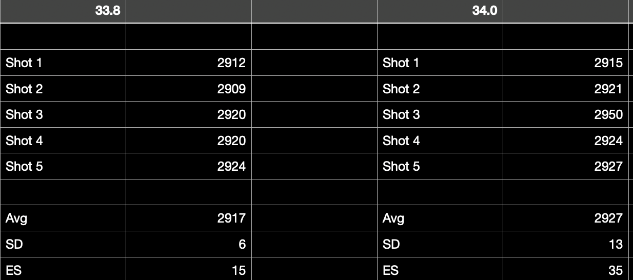

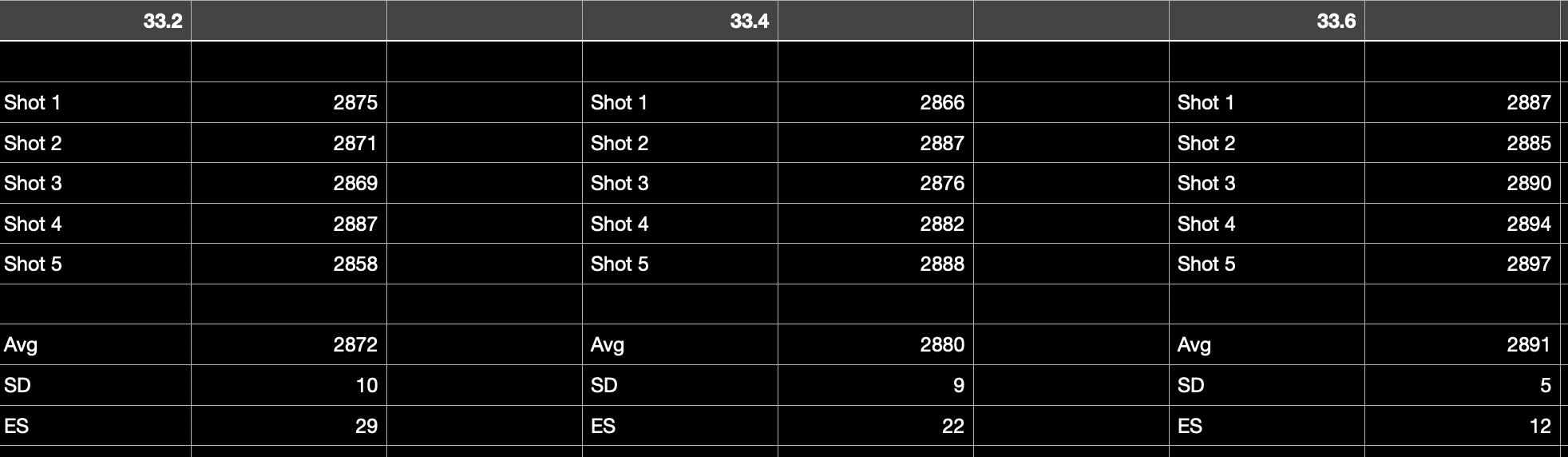

Most people aren't able to even produce data that is worthwhile. For example in the pics I'm attaching, there is the chrono numbers for 5 shots on 5 different charge weights of powder. Which is a very common method people use for load development. It seems fairly clear that two of those charge weights are better than the other.
However, all 5 of those charge weights have the exact same Standard Deviation over a 100 shot sample. The 5 shot velocities were chosen at random from each 100 shot string. So, in reality, all 5 charge weights perform the *exact* same. However, the "data" collected via a common load development method shows otherwise.
This means that we are now using incorrect data before we even move into seating depth, tuners, harmonics....etc, etc.
