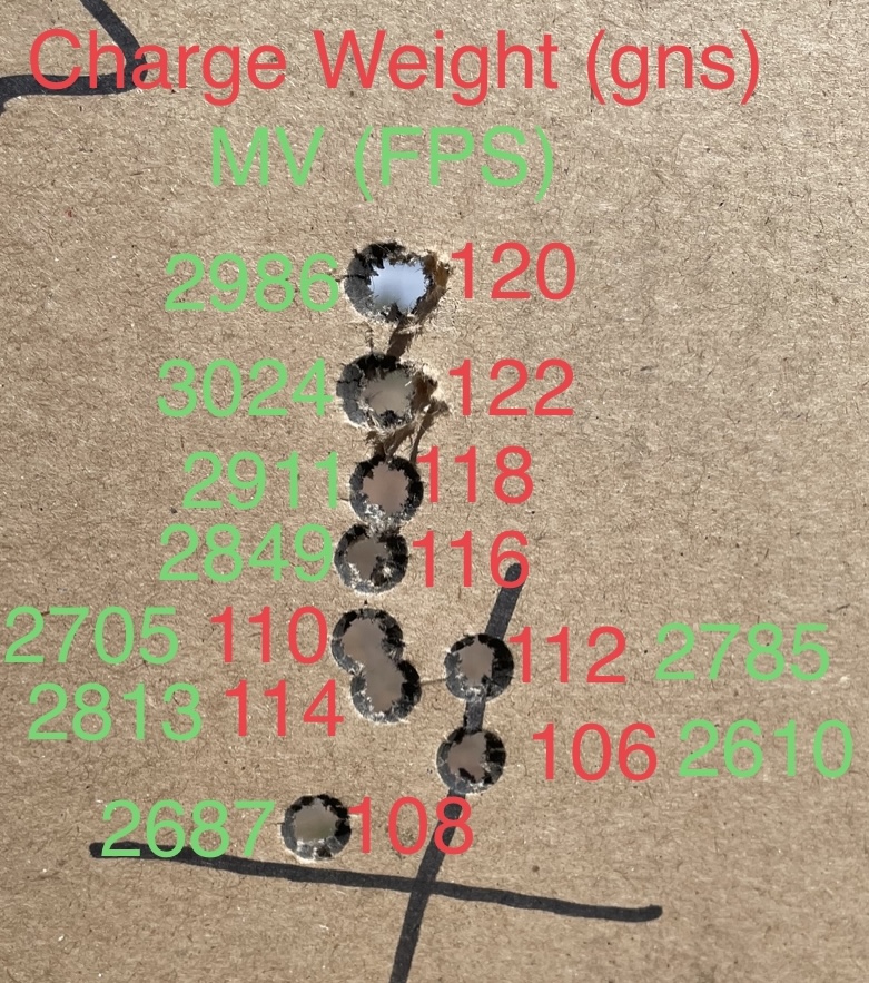

Here is a fallacy. The image below is at 150yds. One would believe that 110-114gns is a group node. Except, that person has no idea where the actual distribution of the group and MV would cluster when a larger sample is taken at each charge weight.
Exactly I agree , that is why plotting each shot is so important . When I speak of one shot it is not to find a node , it is to find a trend which can clearly be seen as to barrel movement . Those bullets should only be dropping a fraction of what is on the target , and 110 -114 is where the barrel has a slight upswing or is dispersion so look at the extremes and the trend is more clear . Repeat this if you suspect 110-114 is dispersion , if it repeats it is barrel movement .
I don’t recall anything about that image being repeatable for 110-114. The group dispersion just happened to overlap in that pressure test. In this case, no one typically uses a 33XC with 300gn bullets at those low velocities. But maybe there was something to it because it did group “better” at slower velocities. I switched to a 37XC and would need to revisit the 33XC.
So if your groups showed vertical in a ladder test, what would be the next step? Add/subtract weight or turn tuner so the same ladder shows less vertical?
