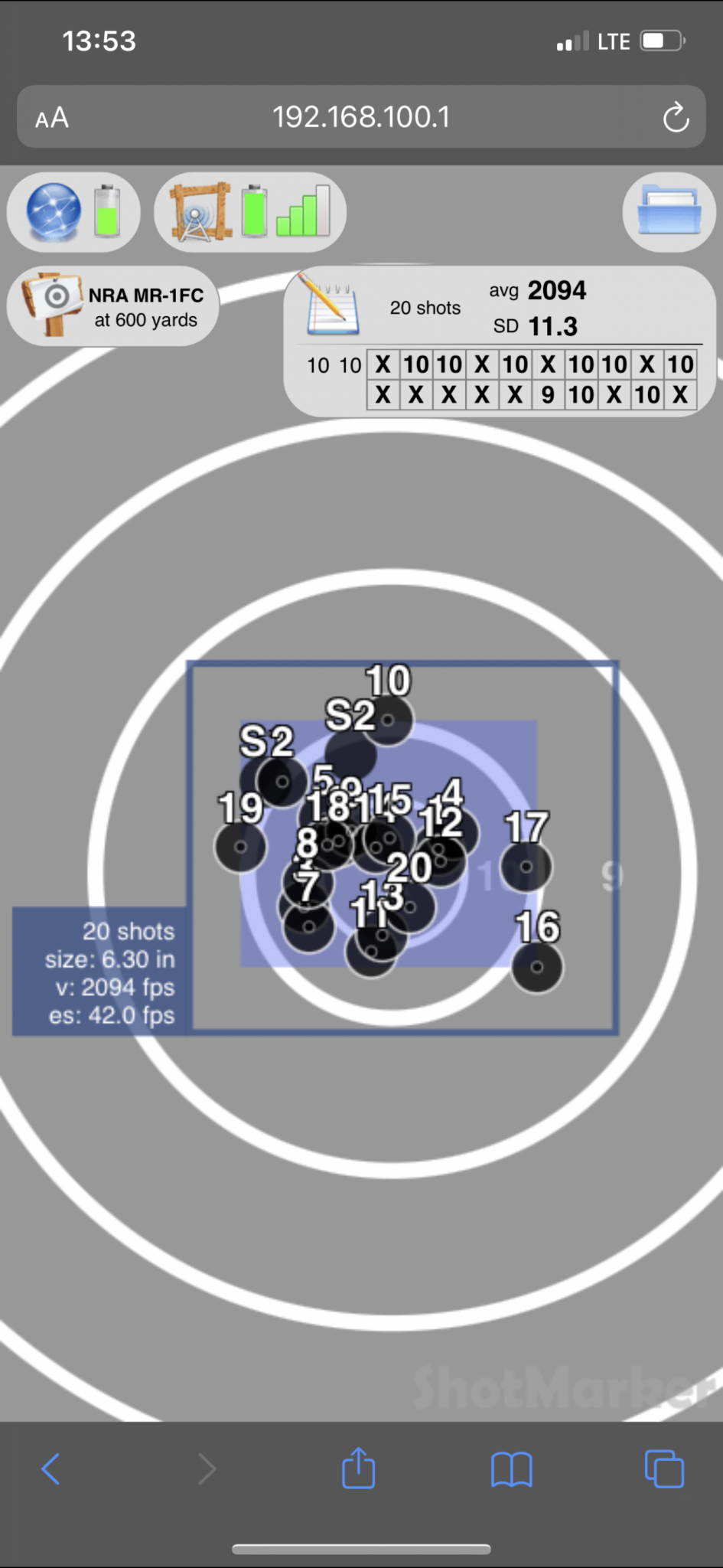

Tuners work and I use the ezell . You guys claim no one could test them enough to work yet all the top shooters in f class and benchrest use one?? How is that possible?
Check my math. 1 MOA = 1.045 in @ 100 yd.
So, at 600 yds, 1 MOA= 6.27 in. and 6.3 > 6.27.
6.3/6.2 =1.005 MOA.
Probably not noticable. So, the tuner made it a 1 MOA gun (or do we want to consider the .005, as well, since minute details matter)?
6.3/6.2 =1.005 MOA.

You misunderstand me. Those are not my targets. I was asking about the math. Or has someone changed the definition of 1 MOA = 1.045 inches?
And no, I do not have a 110 shooting 1/4 MOA nor was I implying anything other than questioning the effect of the tuner.
And that is why I said to check my math.
Did I make a mistake with the math? If so, what was my mistake?

What could explain how bullet convergence works?
Once the bullet leaves the barrel, it seems like the consistency of the projectiles themselves and the consistency of the muzzle velocities would be the primary factors
Now before the bullet leaves the barrel?
Is what “bullet convergence” is referring to the angle of the barrel at the time the bullet exits?
What a concept
@timintx "has the technology".
What a concept
Yes , a slower bullet is aimed higher by the barrel , and a faster bullet is aimed lower by the barrel. Meaning the barrel has a upward lateral velocity at the time of exit .
Reactions: Tokay444
Yes , a slower bullet is aimed higher by the barrel , and a faster bullet is aimed lower by the barrel. Meaning the barrel has an upward lateral velocity at the time of exit .
Is there a way to “tune” the rifle such that the opposite would be true or does what you described always happen for you?
The effect of the barrel moving downward is quite common on most every rifle and will cause exaggerated vertical dispersion so that it’s even with small ES the dispersion is large. To get the barrel moving up takes specialized weighting and offsets at least for a wide window .
It’s quite common, until you’re actually observing for it. Then it doesn’t happen. Like the double slit experiment.
