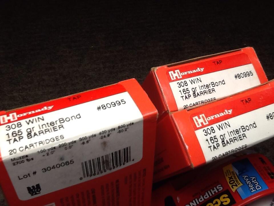

I've found my rifle (Rem 700 .308) shoots the most accurate with 168 A-Max's loaded with 44.0 gr of Varget. I get around .5 MOA with them. A SWAT friend of mine gave me 3 boxes of 165 gr interbond TAP ammo to try out for myself. He said their team is switching to Winchester something or other and that they didn't like the TAP stuff.
I shot them and was getting groups around 2 MOA with them so I'd have to agree with him.

According to Hornady's site they don't make a 165grn Interbond TAP load. They make a 165grn Interbond Superformance load and that might be what you had and with the Superformance powder it is hit or miss with different rifles. My team mate's .308 shoots about 3/8 MOA with the Superformance 178s but mine is like 1.5 MOA.

That said you can't expect the same accuracy from a hunting bullet as a match bullet like the 168 AMAX.

Are these the Superformance ones then?
