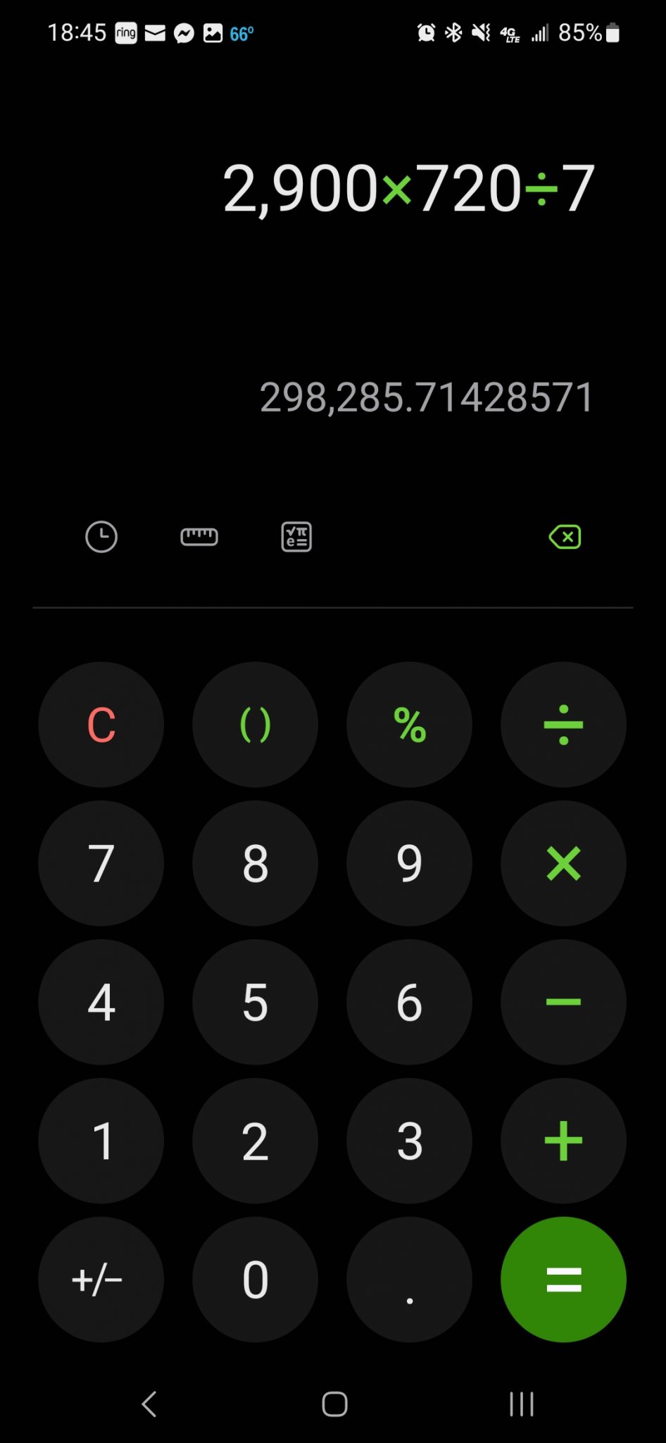

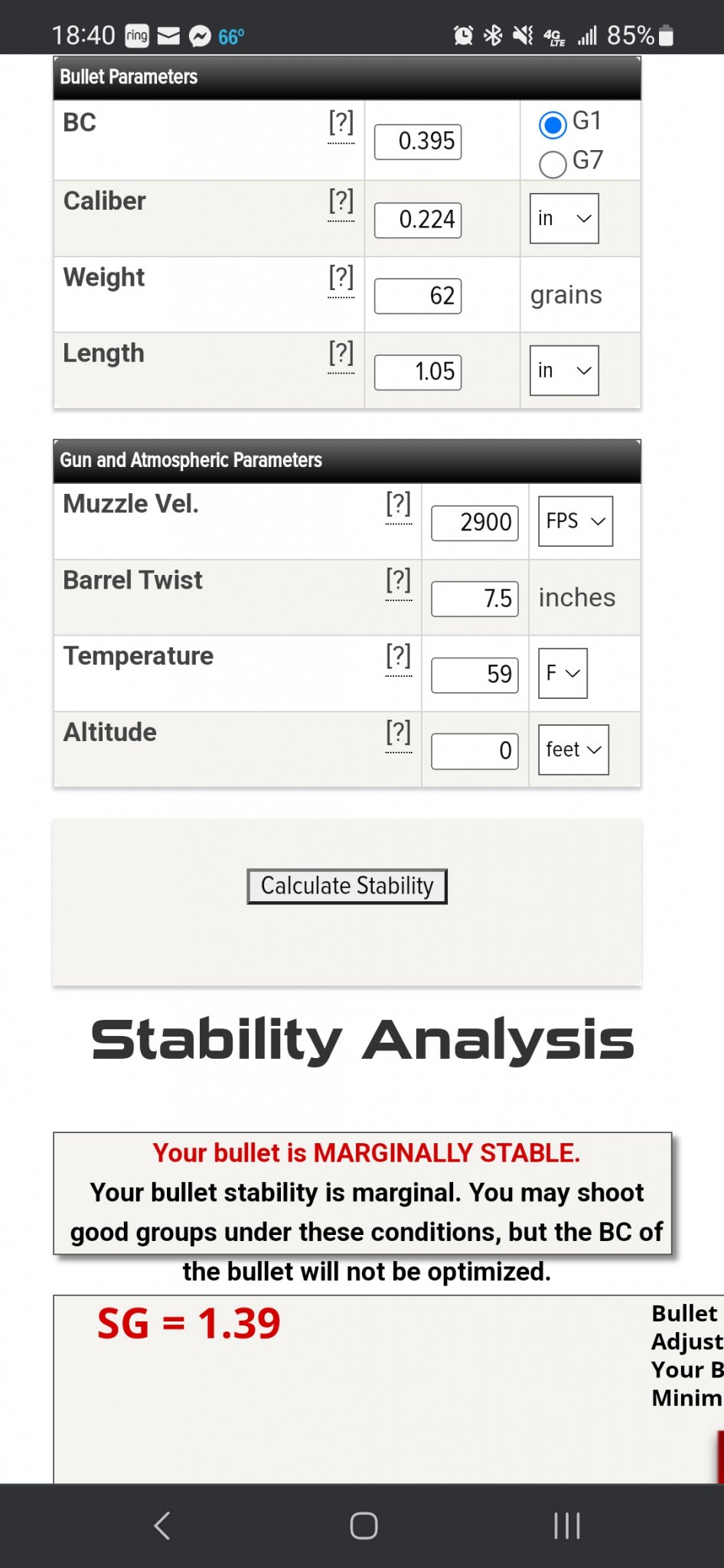

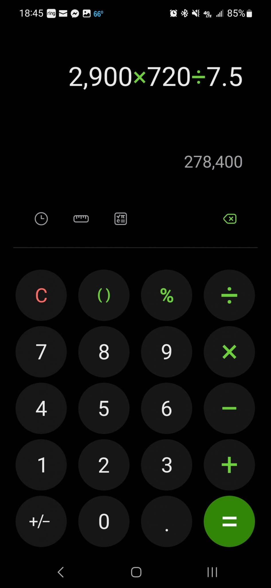

Push them fast enough and they will stabilize in a slower twist.
ehh.... ehh.
Sometimes maybe. In many cases SG actually increases with lower MV and decreases with higher MV because of the extra drag force. The velocity term in the total drag equation gets squared so even if you see incremental decreases in Cd as you go faster, the net drag increases a LOT and any angle of attack makes things want to go sideways in a hurry. Usually ends up that from Mach 0.8-3.5 you see a little bit of walk in SG numbers, but changing twist rate an inch or two you see huge steps in SG numbers.
Reactions: JAS-SH and Sigma
mmmm . . . No.
It’s largely Internet Commando myth that bullet stability increases with increasing barrel length. Technically, the gyroscopic stability factor does increase with increased barrel length, however the amount that it increases is miniscule and lost in the noise of other variables.
As an example, the 55 grain bullet in M193 will have a gyroscopic stability factor of approximately 4.25 when fired from a 14.5” Colt M4 barrel. When the same M193 round is fired from the 5.75” longer barrel of the 20” Colt A2 barrel, the gyroscopic stability factor of the 55 grain bullet only increases to approximately 4.27.
While the increased RPM due to the faster velocity will act to increase the bullet stability, the increased velocity also “increases the force applied to the nose of the bullet at the center of pressure and strengthens the overturning aerodynamic torque which actually makes the bullet less stable.”* These two opposing dynamics are the reason for the miniscule increase in gyroscopic stability factor.
