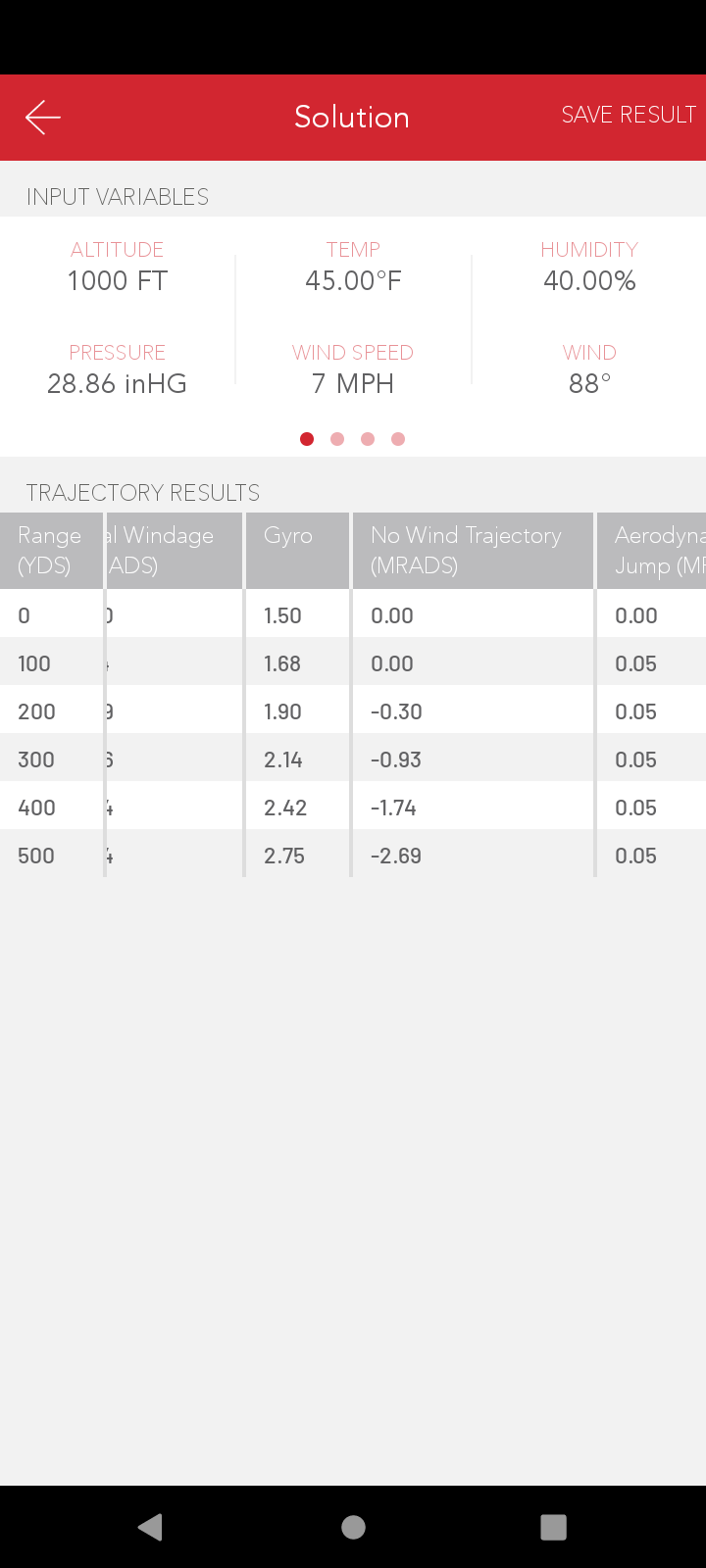

Because you seem to be in the know, and I don’t know how, would it be possible for you to run a stability for the 62 eldvt out of an 8 twist at 2950 in say sub 1000ft density altitude?
I had one errant round on my 10 shot test group, looks like I went off path and entered paper at an angle, 2” off the remaining decent 9 rounds.
@Ledzep
What muzzle device?
Gyro should be good. Any bullet in the 4 dof Library you can run the calc and in table view it shows you gyro.
