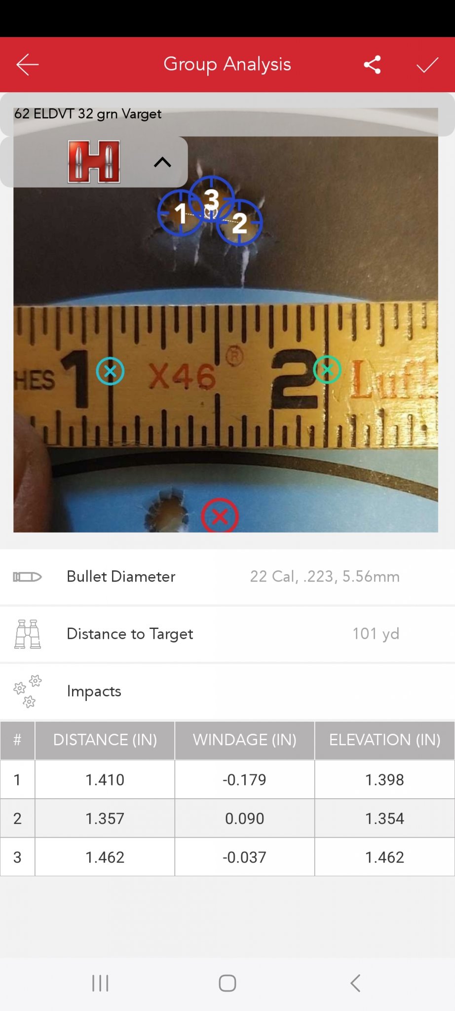

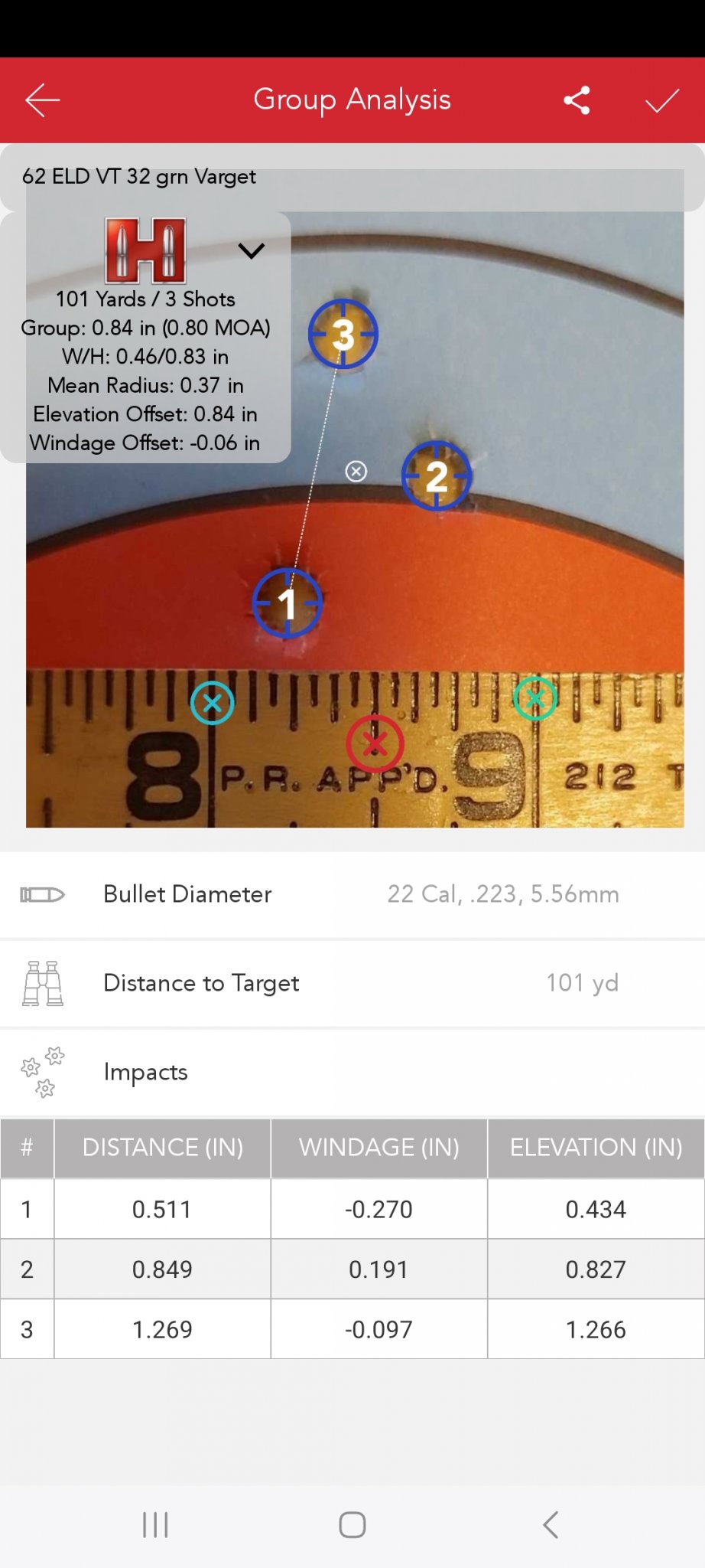

22-250 32 grns Varget Rem 9 1/2 PPU brass. Tikka T3X lite, Tikka vertical grip, Mountain Tactical bottom metal.

"Too few samples", yes exactly. I was trying different powders, I have a larger sample size (20 rds) to try with Varget for the next range trip. All are loaded the same as above. I'm hoping the next 20 stay under 1 moa. That would work for my needs. I don’t believe in "flyers" with jacketed bullets.

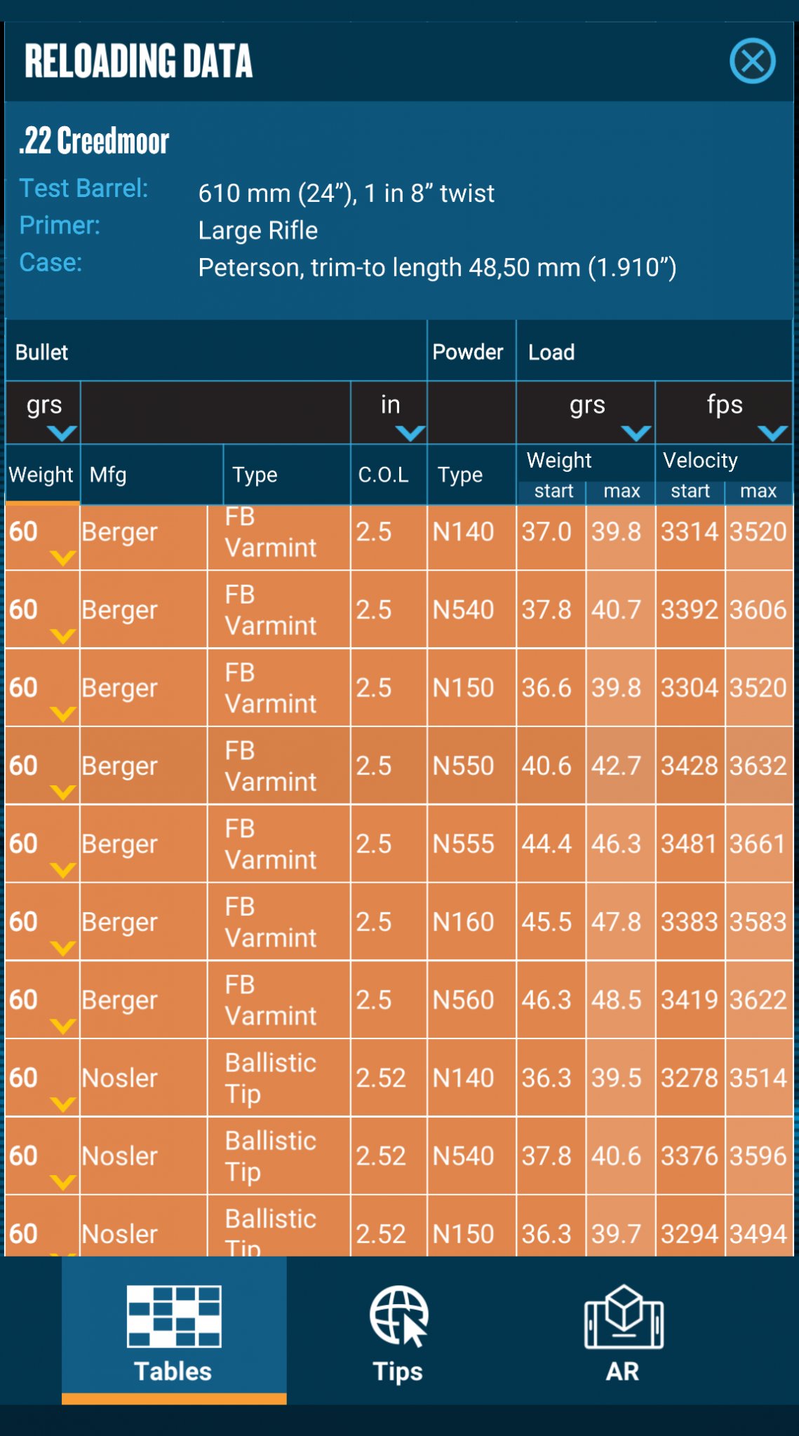

Just in case this is helpful to someone wondering what powders to try and ball park where to start in the 22Creedmoor… I have already tried N550 and it’s running 3300 from my 20 inch.
I know it’s not exact bullet but at least it’s pressure tested and better than someone’s load off the internet

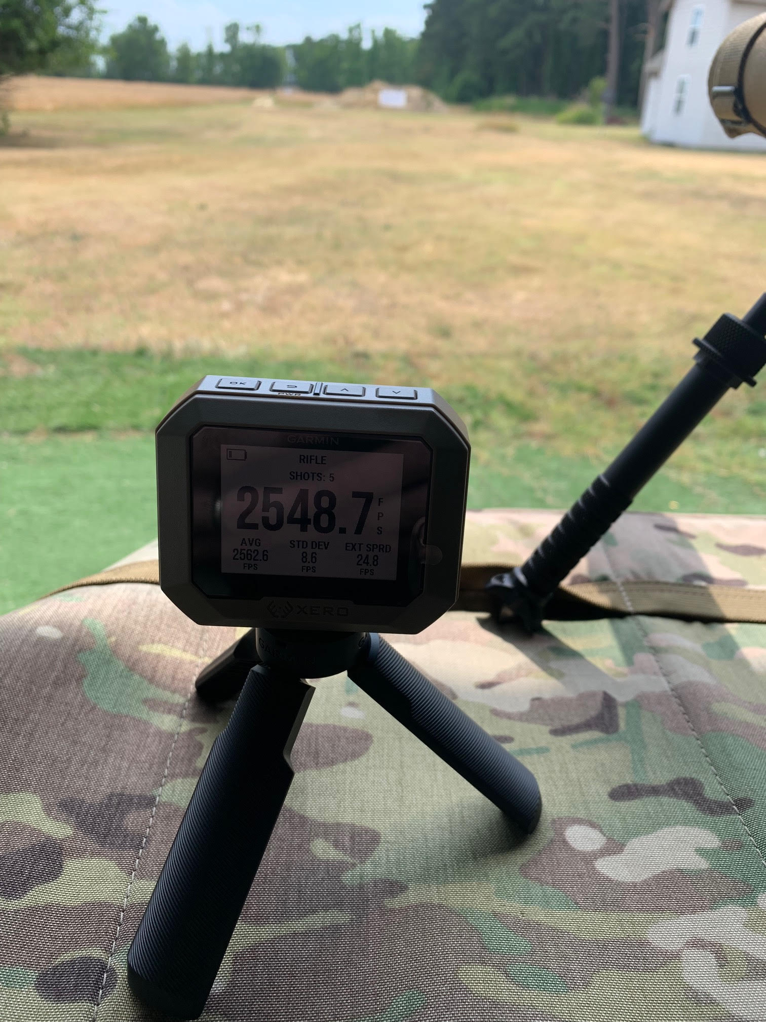

So far I've tried these in a AR10 8 twist 16" Larue barrel loaded 2.860 oal Lever in virgin MAI (Norma) brass & cci#34's
It was 96 degrees when I shot this and had no pressure signs on that load.
Why the hell is there no load data for Lever in 308?? GRT predicts this load gets complete burn in this 16" barrel, fill % is good, SD is good, top end forgiveness is good. I don't get it, maybe it's less predictable with non mag primers 🤷‍♂️
Next time out I'll back the Lever load down to 2520 fps range & give Vit N540 a try.
These are longer than the 176 A-tips so powder cap is limiting in an AR and why I first tried with Lever, but damn. I am impressed with this bullet.
RL 15.5 would be my first choice but just cant fit enough in there at AR mag length. I'll give Vit N540 a try next.
FYI - These were the blems I was shooting. Have 800 non blems sitting here ready to load.

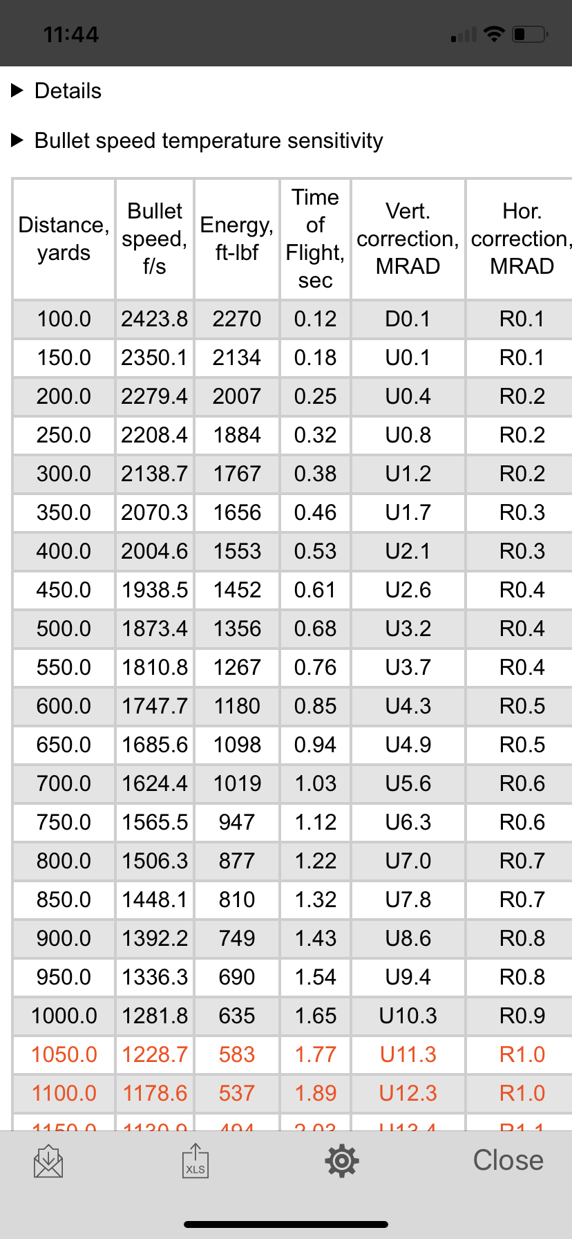

They hit about .1 mil high at 500y with .289 G7 plugged in Strelok Pro. At 500Y 3.1 mil hit dead nuts. Very impressive bullet here.
I know that was a max or slightly over max load, however I'm still trying to wrap my head around a 16" 308 that stays Supersonic to 1000y with a 170 class bullet.

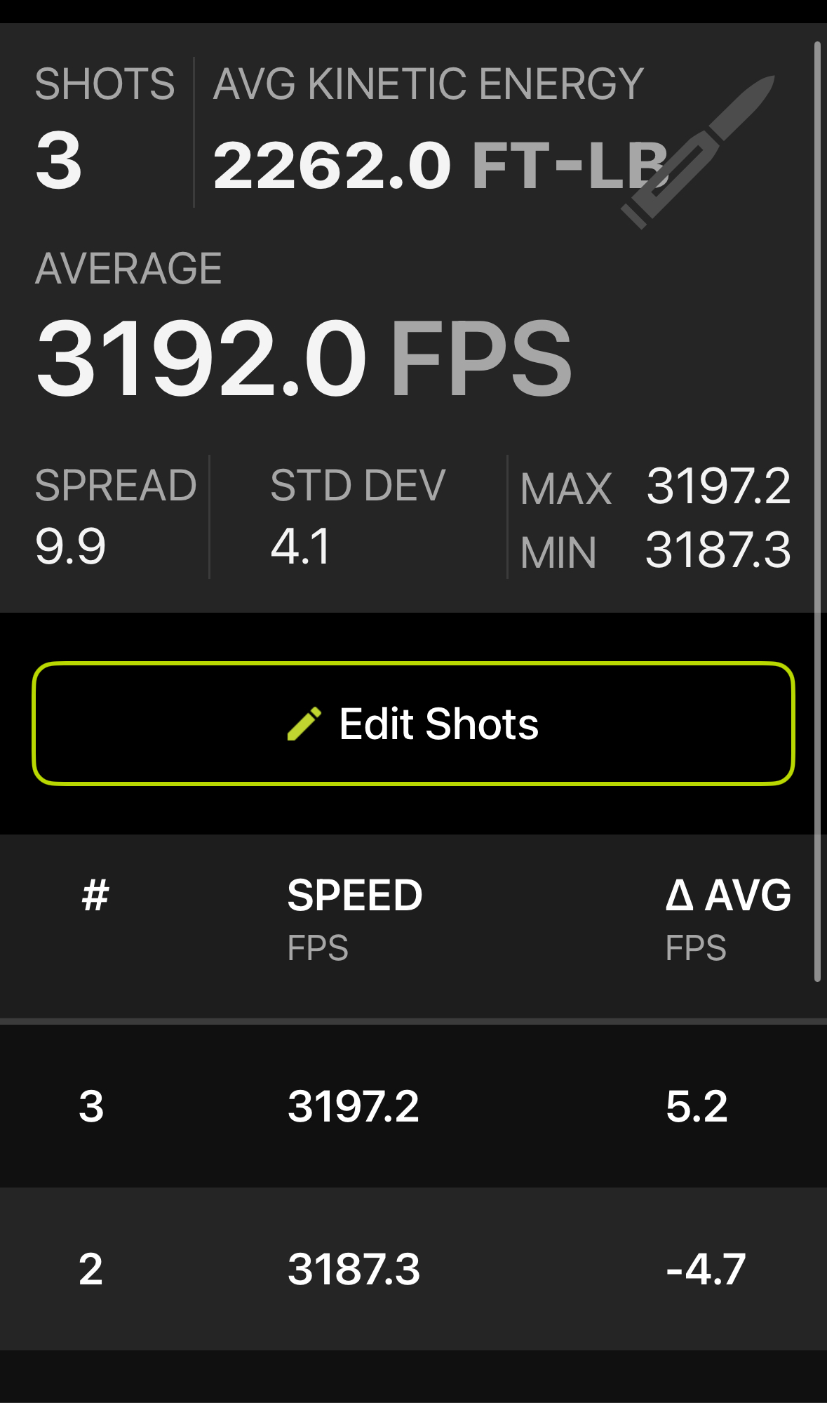

33 rounds over my Garmin. Min 3180. Max 3250. Avg 3203. ES 71. SD 19.3. Group sizes varied pretty good. Best group sizes were 60 thou, 80 thou, and 110 thou off land. 90 was ok to hunt with but nothing to write home about either. Will post pics here in a little bit. Will update when my brass prep is normal and I will probably run at 60k off. Not going to adjust charge weight unless it’s still giving bad numbers when neck tension is consistent.
Obviously, work up to above book max. Or dont. It’s your face on the line.
