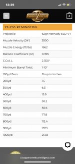

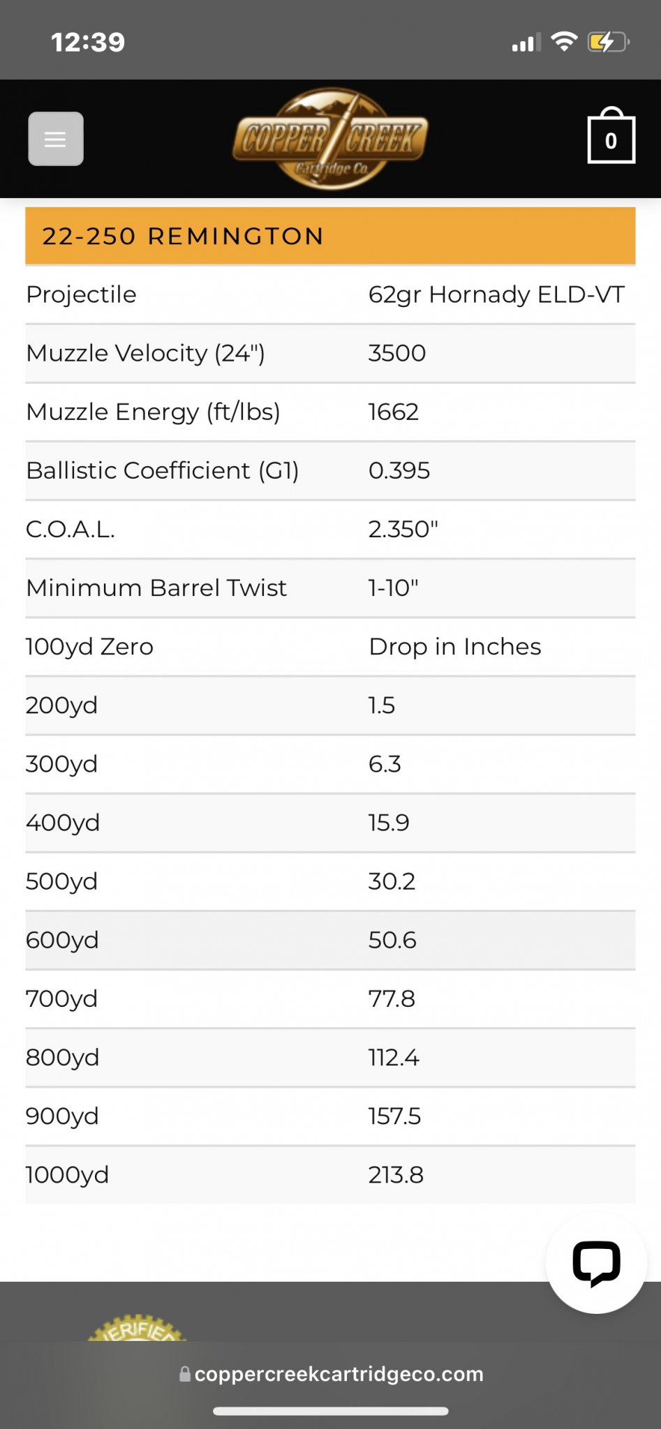

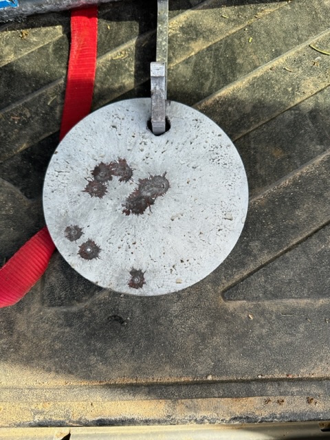

Have you tried these in 22-250 yet? Wanting to try them in my bolt gun 22-250. But I have a 10”twist. Prefit barrel soon will be an 8 twist.
Haven’t gotten ahold of any yet as I keep missing the releases. It’s getting towards the end of my shooting season so I probably won’t get a chance to work on them until later this year.
I tried one load of the 62 grain eld vt in my 22-250 tikka. Got about 3350 fps with a middle of the road charge of superformance. They will work for my intended every day coyote rifle.

Awesome! My 250 is a 10 twist. I’m hoping they’ll still shoot
They will not work well at all in that 10.
I ran them for a short time in a 22creed 9 twist they did well for about 100 rounds and then never could get them to go again. Will try again with an 8 twist. Have heard similar issues
I guess I will find out. I found this from another site saying minimum 1-10” twist for 22-250. There’s only one way to find out
