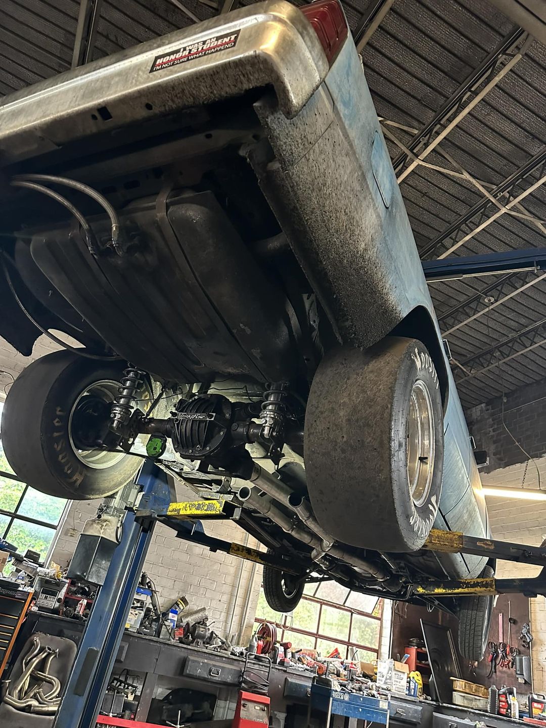

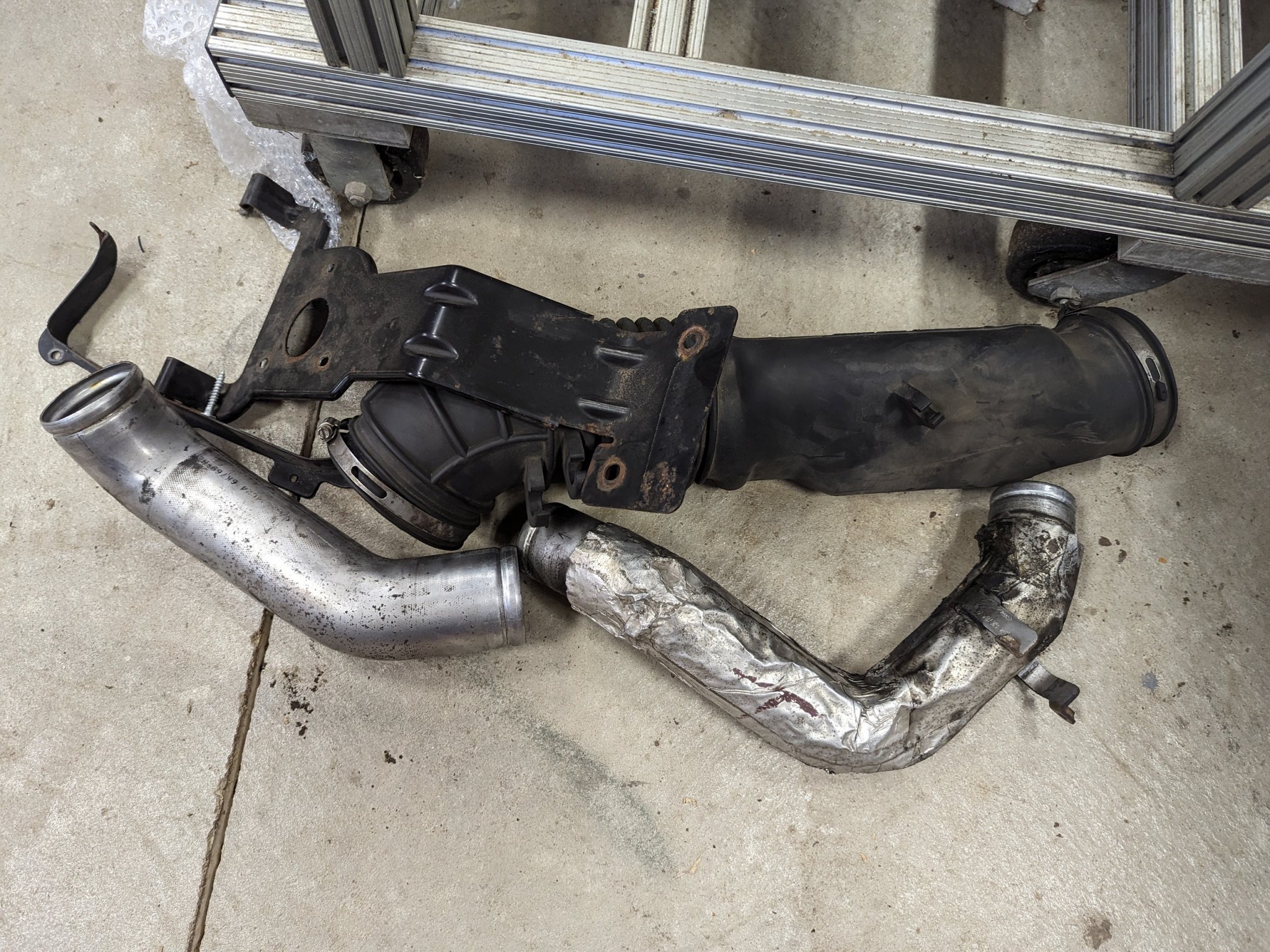

The last motor:
A juiced-up 6 liter that lasted for 6 passes. (lol) To make it work, we left with around 12-15 percent throttle input. That, coupled with 20 degrees of timing pulled out at the hit with it ramped back in over 1.2 seconds got us to a 1.23 60' on a no-prep, pour-your-own-puddle, surface.
Eric would bring just up to the 2-step with the T brake on and hold it. When he sent it, he'd roll into the throttle and try to gauge it to where he had the accelerator pedal pegged as he lost sight of the tree in his peripheral vision.
The idea we are going to try on this one is to bleed off boost via a gate controlled with a CO2 solenoid. It's been done by some other folks with success, so we're not really reinventing anything. The blower has a port on the side (covered) that makes it pretty easy to plumb into. I'm also having the transmission gone through along with a new converter. It was way, way too tight.
The good: the ZL1 is back on the road and running relatively strong. Oil consumption is way down, and it's moving a lot of air due to the better heads, ported blower, and bigger crank pulley.
The bad: I saw some stuff in the motor when the heads came off that made me think it's not going to last forever. Specifically, the bores have a bit of scuffing; not surprising considering its history of road course flogging, but concerning in that it doesn't suggest a long and happy future at even higher power levels. So I've dragged my spare LSA block from the pole barn and started collecting parts for a build. I picked up an offset-ground L8T crank (from the current 6.6L truck engine) from Mast:

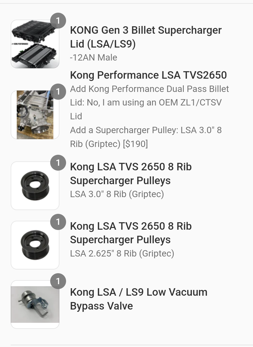

The plan is to top this off with a Kong TVS2650 blower. The little 1.9L stock unit has a bit more left to offer, but won't be able to fully utilize the potential of the new bottom end.

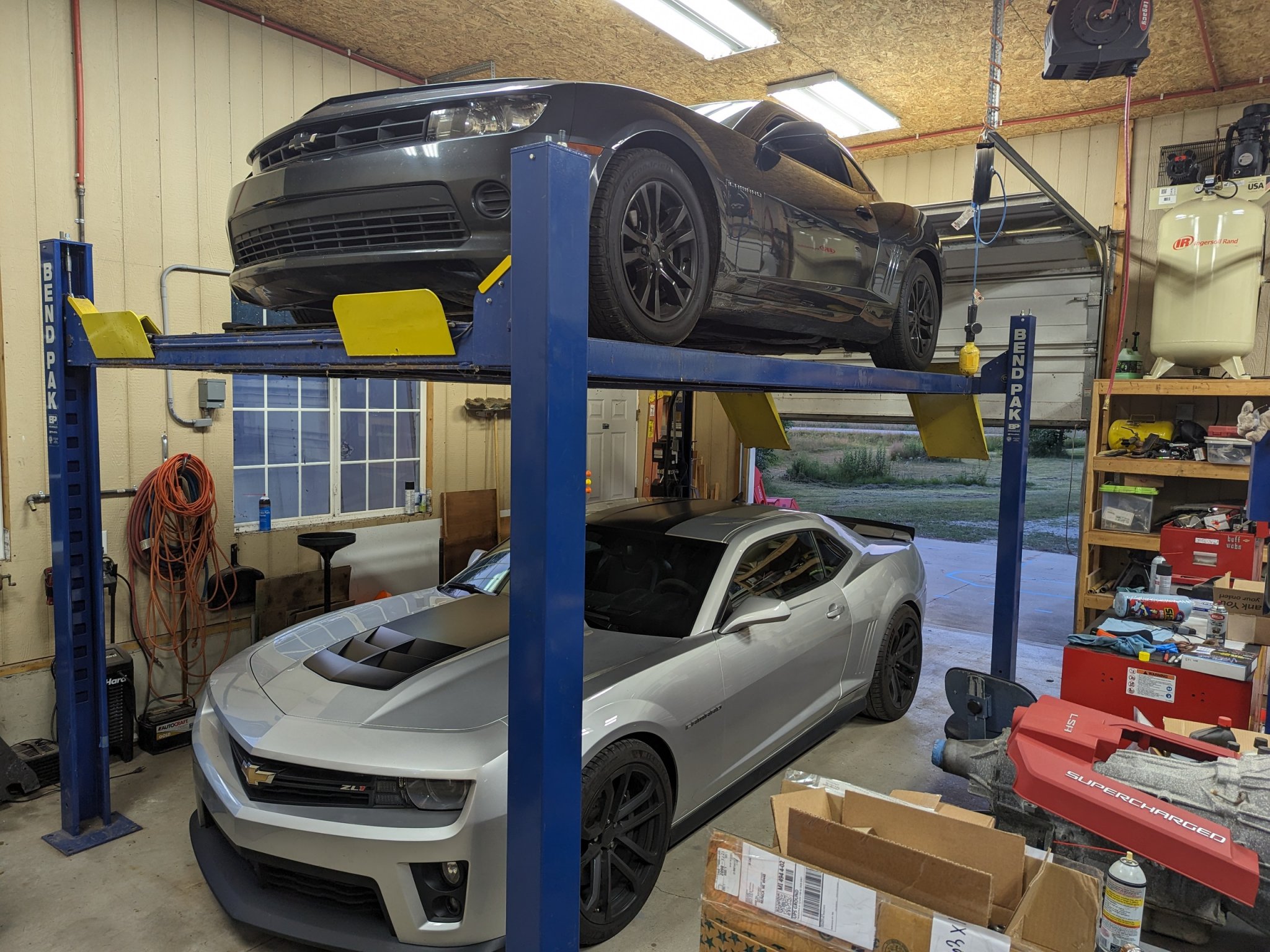

By stacking Camaros in the garage, I feel like redneck status has been achieved.

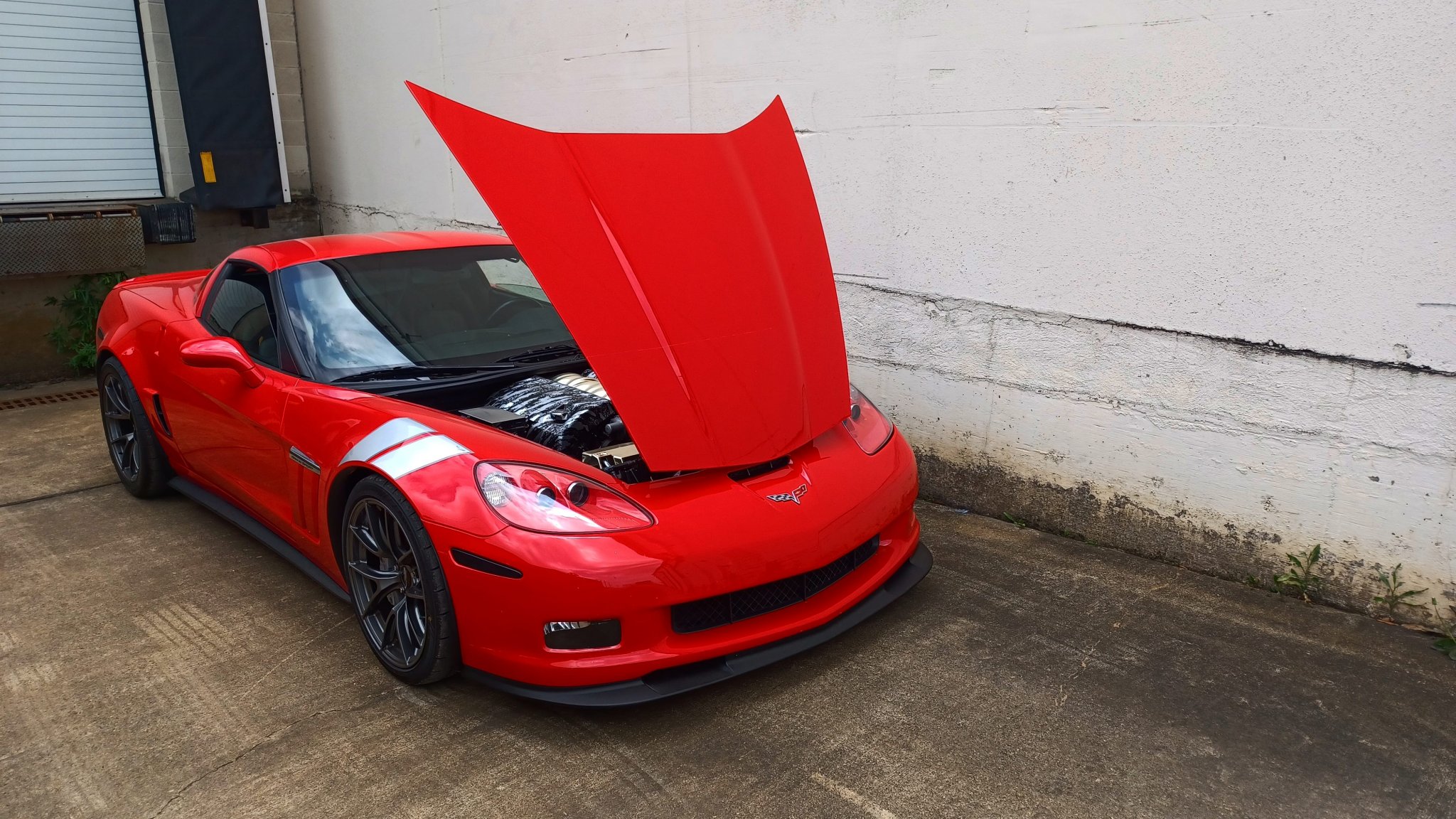

It's proven to be tough in forced induction applications, it takes the same 8-bolt flywheel as the LSA, and the stroke is a bit friendlier than the more typical 4" aftermarket crank in stock blocks. Wiseco makes pistons that fit; they're on order and expected to arrive around Halloween, and will provide a comp ratio around 10.2:1 depending upon the heads. Got some Boostline rods to connect the two. The block just needs to get punched out 0.005", and hopefully the short block will come together on a dark winter night. I haven't yet decided if I'll run the CNC LS9 heads that are currently on the car, or a set of WCCH LSA heads that are sitting on a shelf; they flow similarly but have a few cc difference in chamber volume.
Someone in the thread mentioned a "trunk tank" (ice water reservoir in the trunk), and I think that's in the future. I want to set it up so that I'm pumping glycol thru the heat exchangers up front and have a four-way valve to bypass the tank when not in use, so that's going to take a bit more work than the typical install.
Everyone I see with the supercharged LT's end up adding a meth kit and air/water intercooler to help keep IAT's down. Either that or just switching the car over to run methanol instead of gas/e85.
Depends on the goals and equipment. Trying to make four-digit power on the little 1.7L LT4 blower long enough for a 50-150 MPH pull requires some band-aids. I hoping that the big Kong 2650 blower is efficient enough and the fancy dual-brick lid is effective enough to avoid these other measures.
*If* I were to go down the methanol injection route, it'd require something better than the typical agricultural pump + solenoid valve system such as those from AEM or Snow. Holley looks to have a decent setup but it'd require some additional hardware to integrate it with a factory ECM.

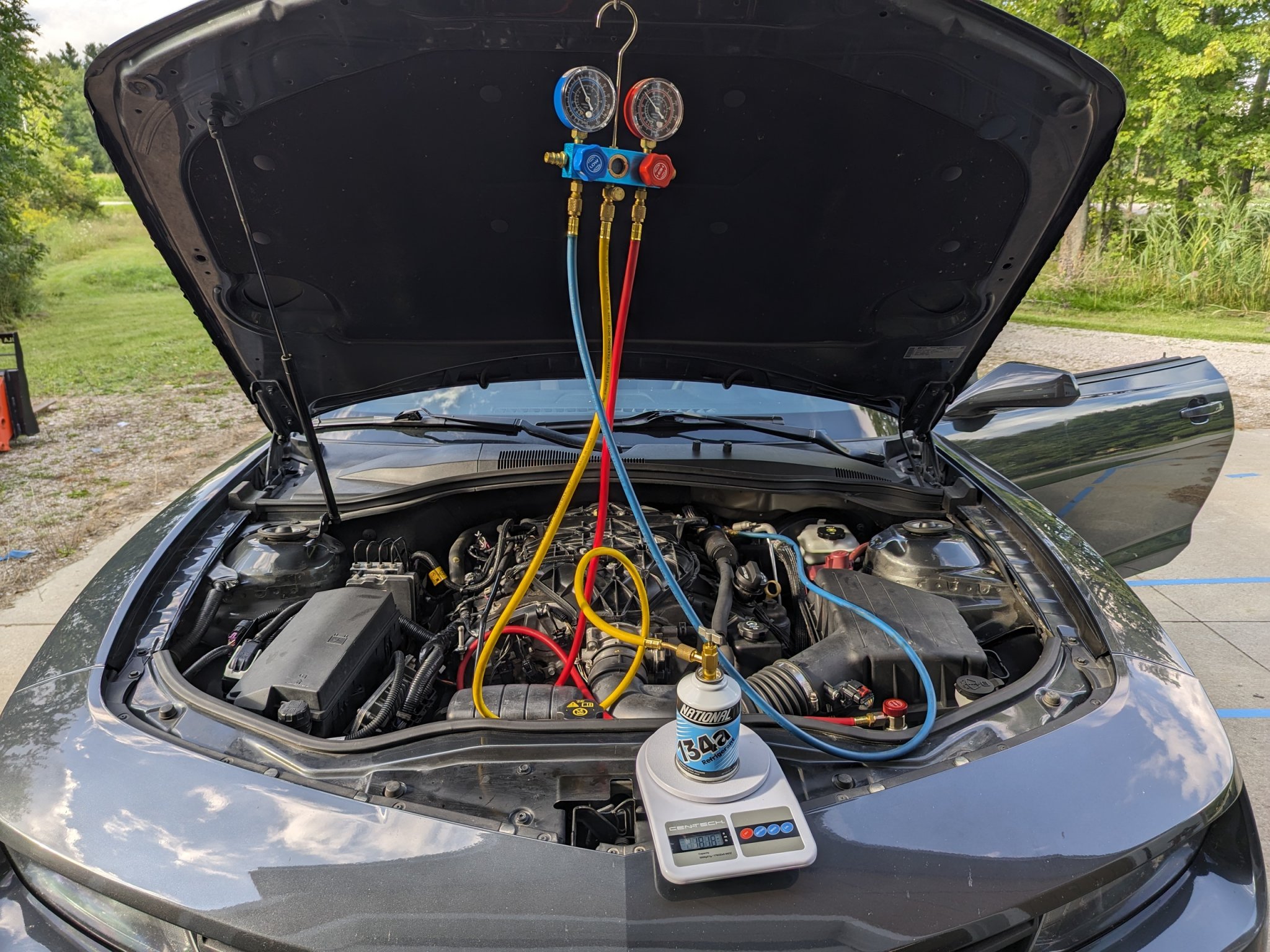

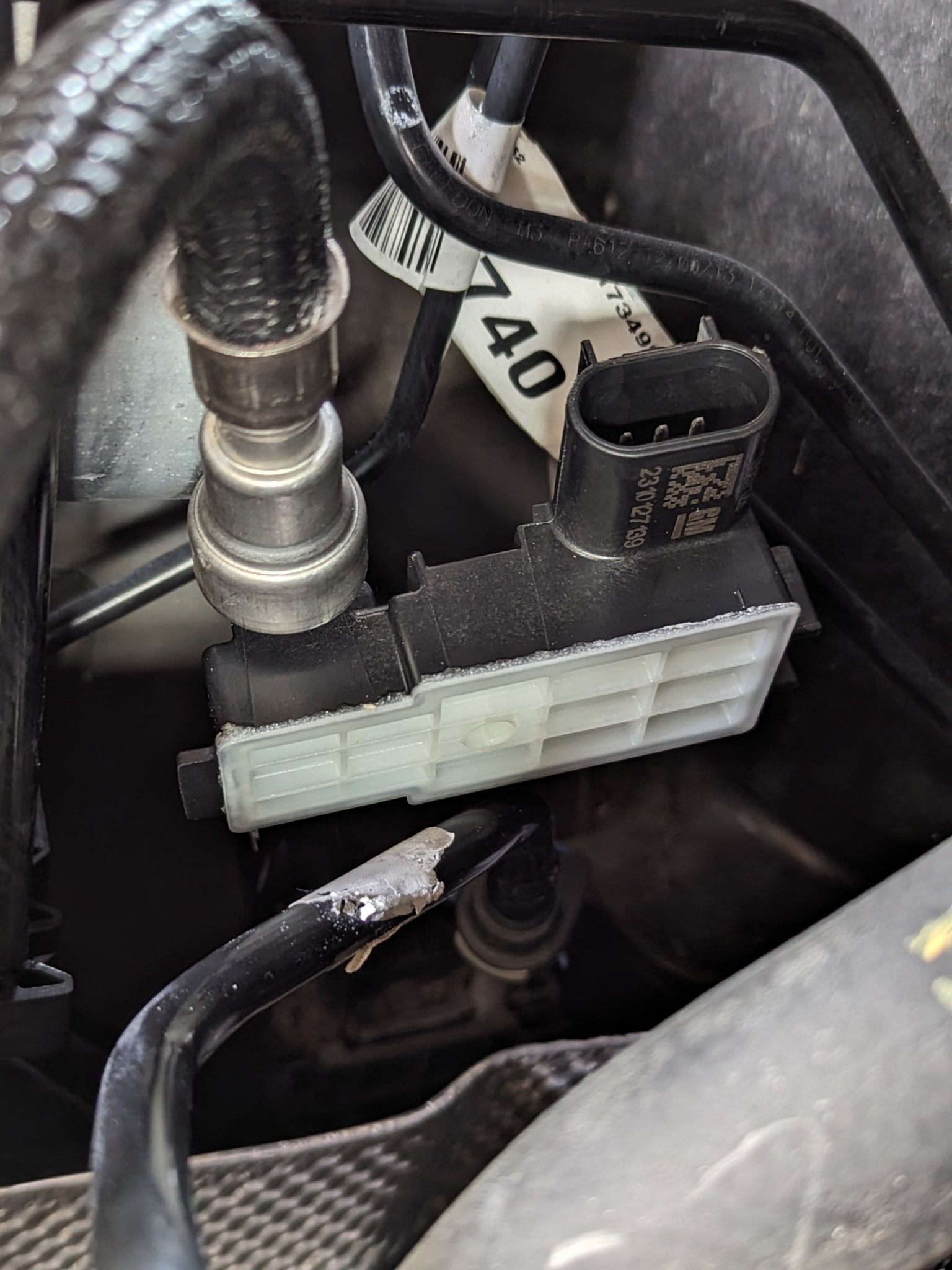

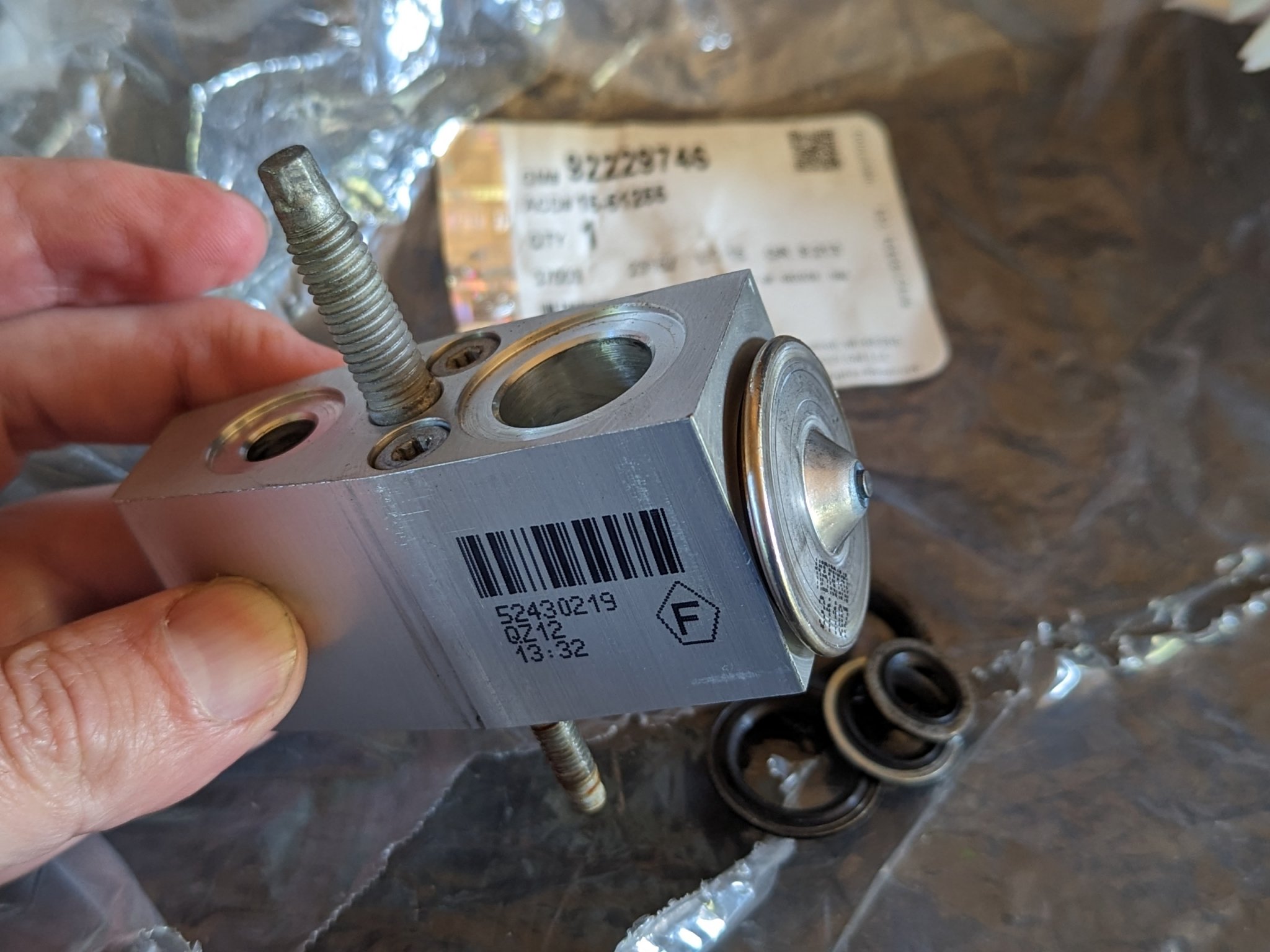

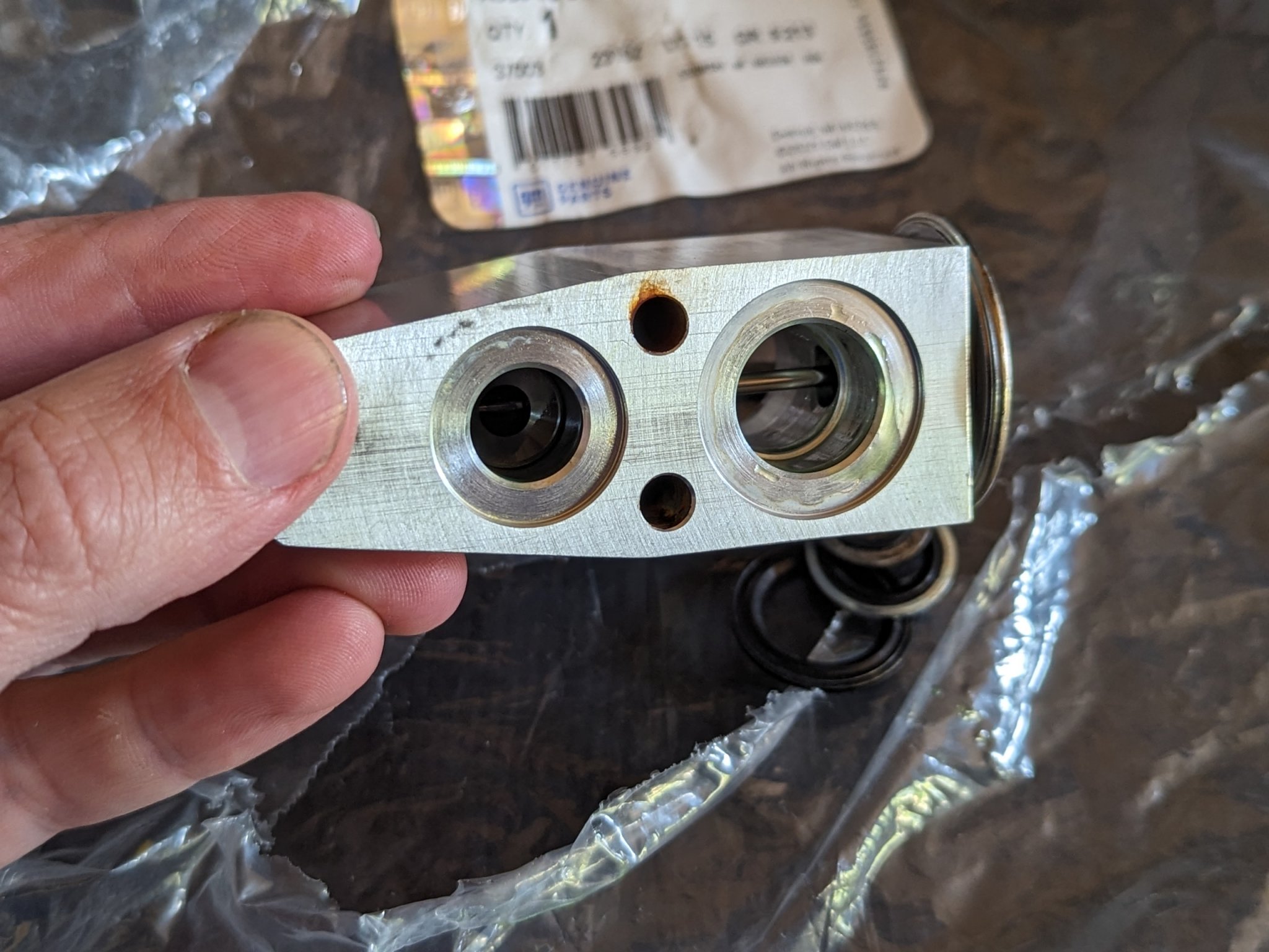

Installed a new thermal expansion valve in the little V6 Camaro yesterday:
Didn't see anything wrong with the old part once it was removed, but the compressor was hitting the high pressure limit at about 450 PSI(!) and so it's a pretty safe assumption that something was wrong with it. Blows cold with a new part installed so apparently the diagnosis was correct.

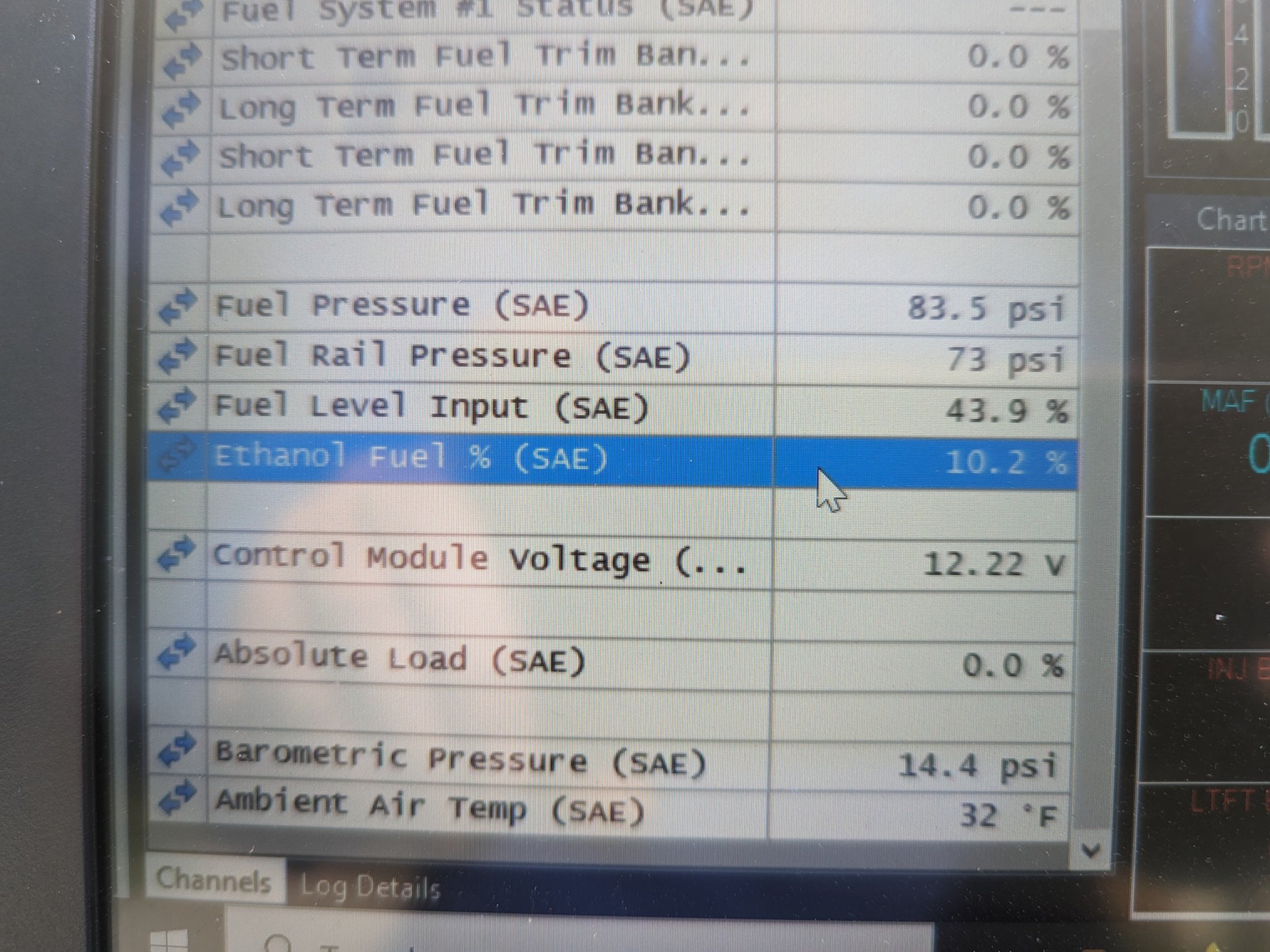

Also got a DSX flex fuel sensor kit installed.
Used HP Tuners to flip a few settings, copied over the ethanol timing table from a 2014 Impala calibration, and now I'm ready to call myself a professional tuner.
View attachment 8213960View attachment 8213961View attachment 8213962
Also got a DSX flex fuel sensor kit installed.View attachment 8213963View attachment 8213964

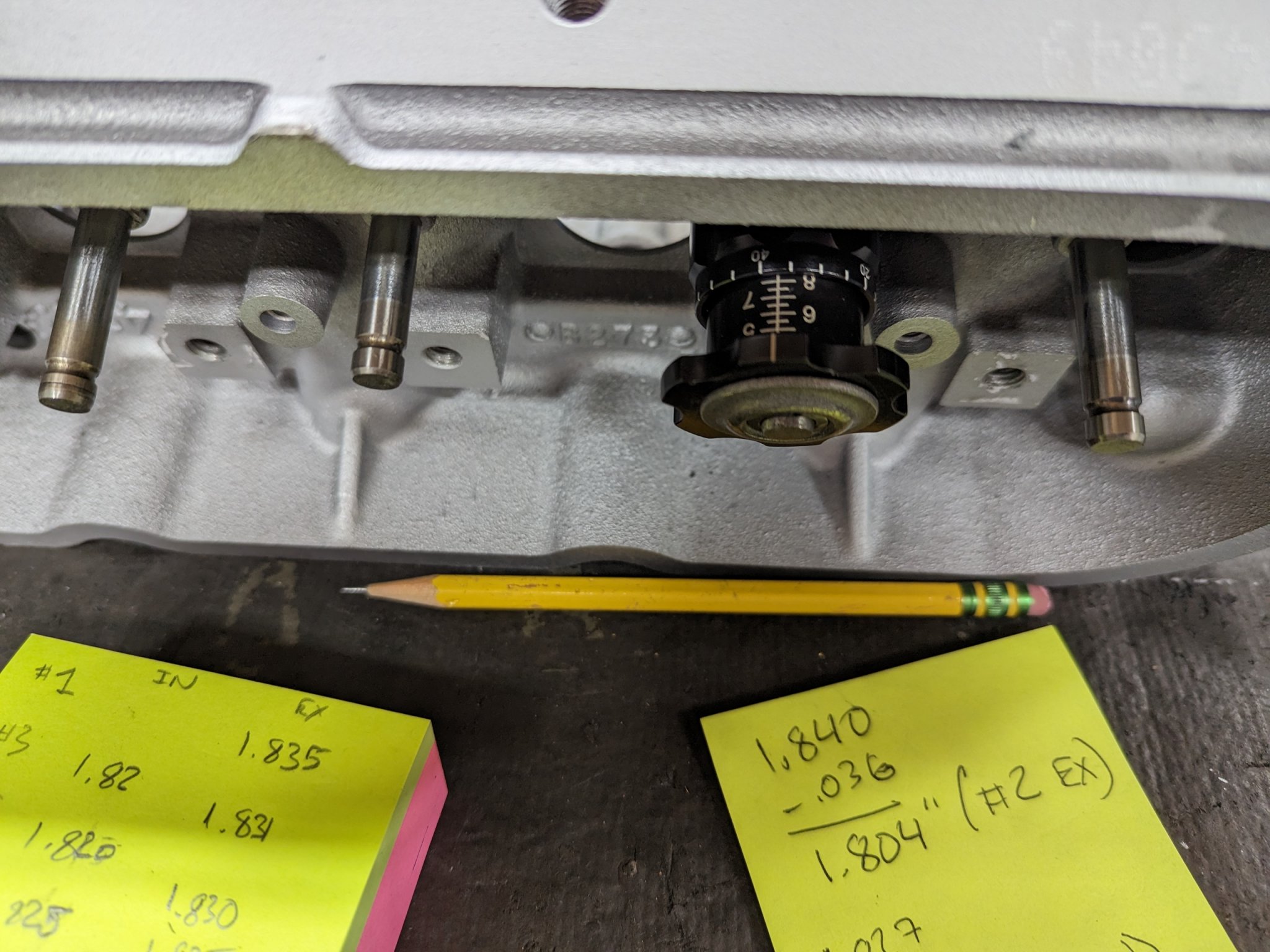

Top right in the number two hole

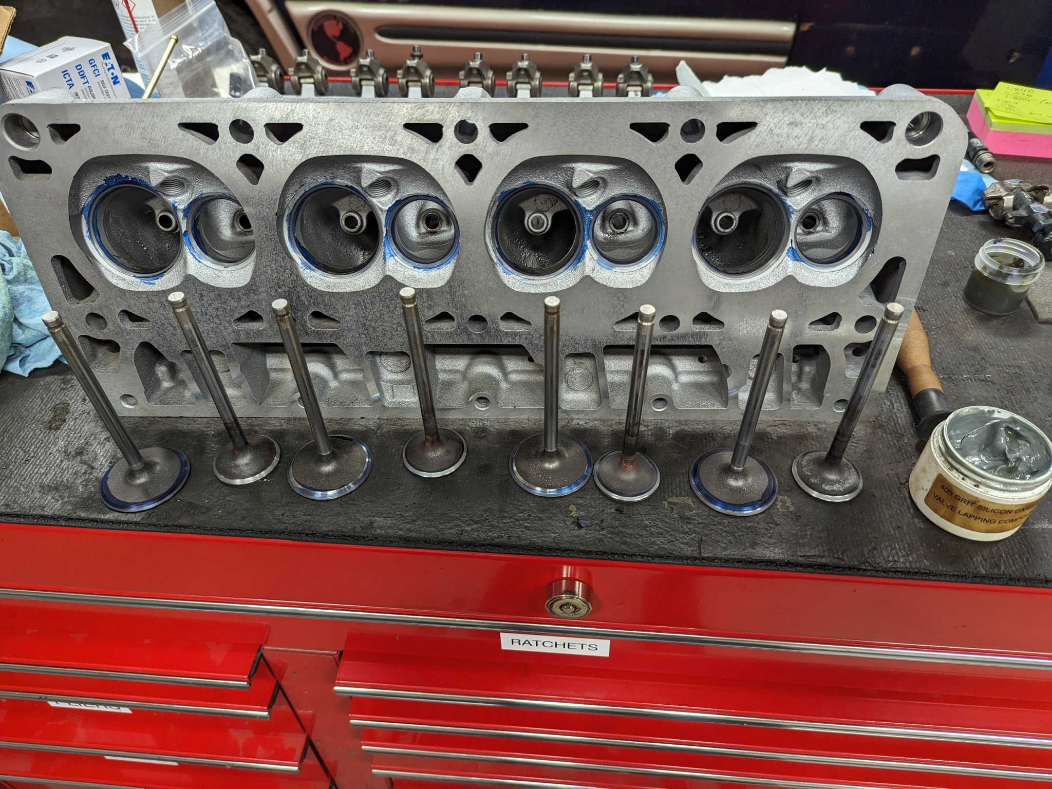

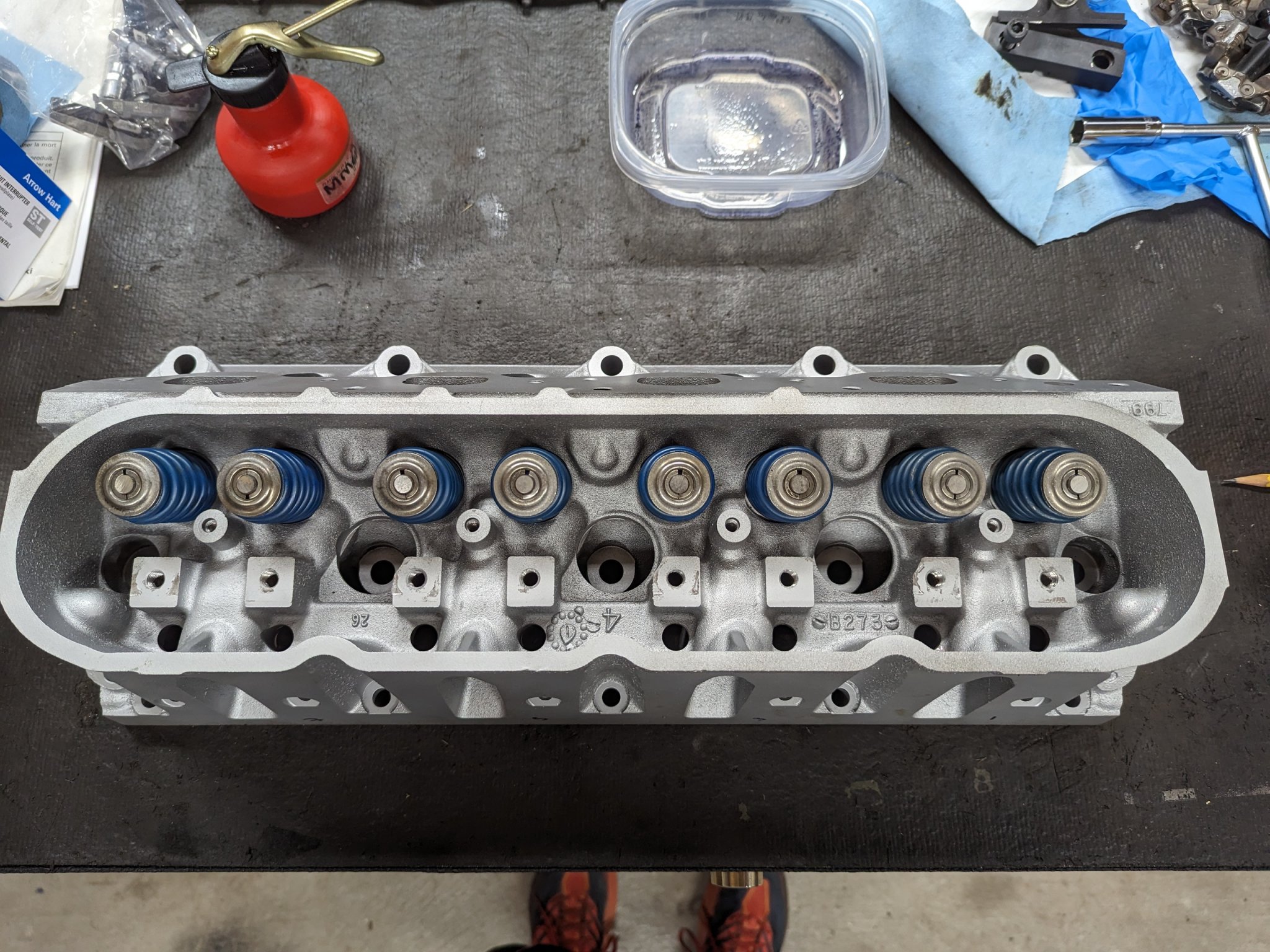

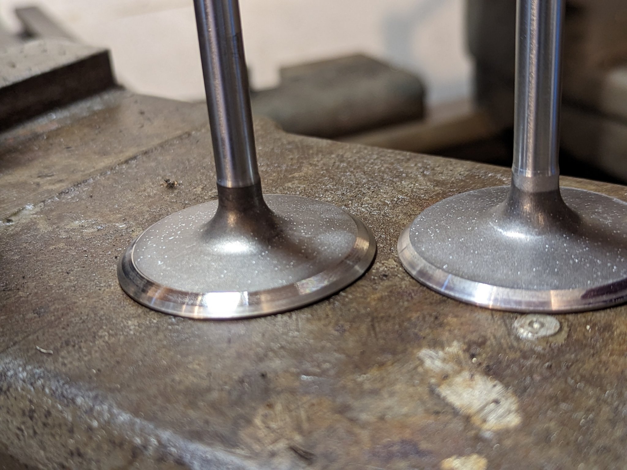

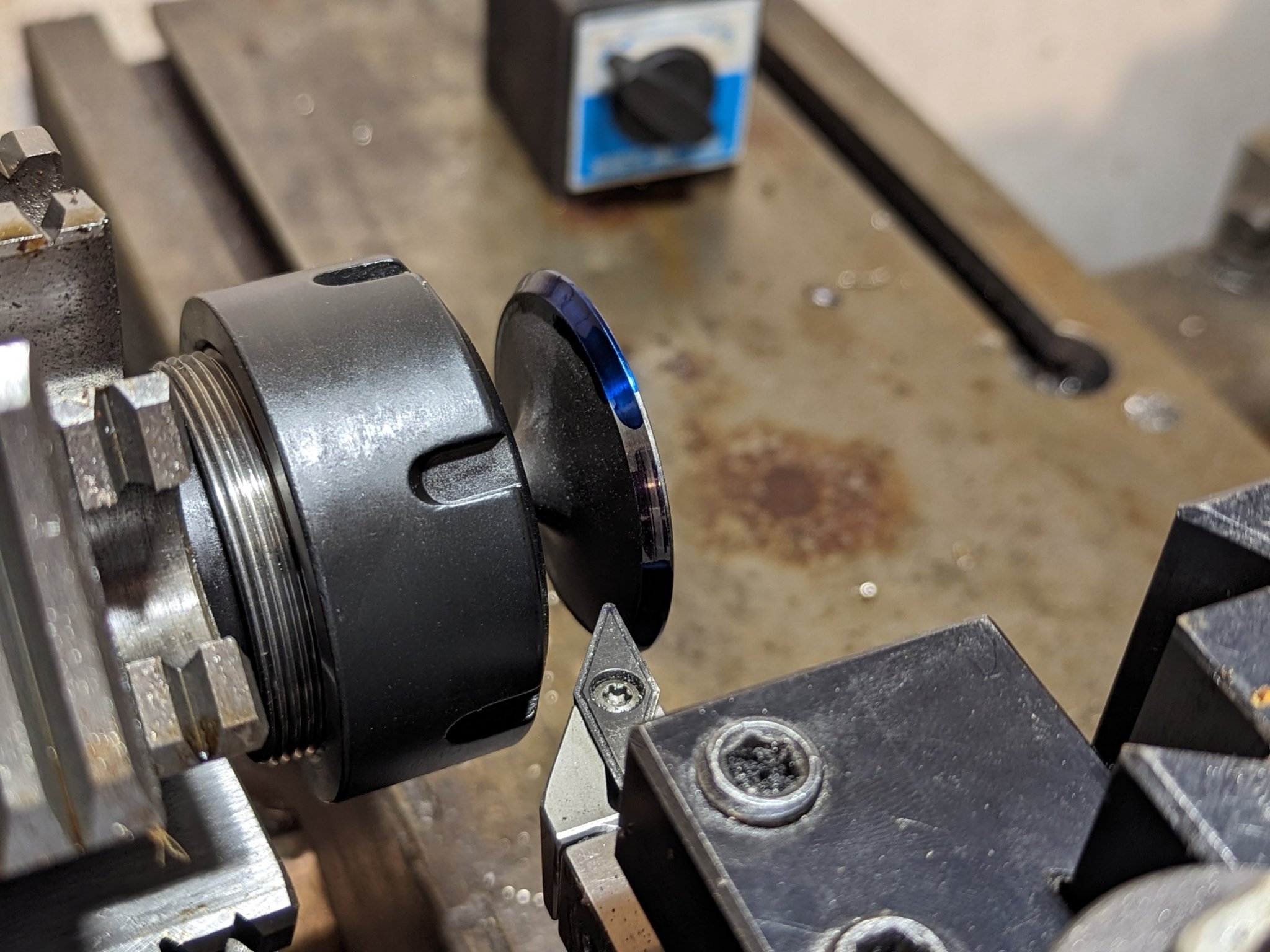

Going through the heads that I picked up for the LQ4 that I'm swapping into my '96 Impala SS. Can you even call yourself a DIY mechanic if you're not performing your own intake valve backcuts?
This is by no means a full-effort build - it's just a cruiser - but the single-angle valve cut offended me for some reason.
View attachment 8217262View attachment 8217266View attachment 8217261View attachment 8217267View attachment 8217259View attachment 8217258

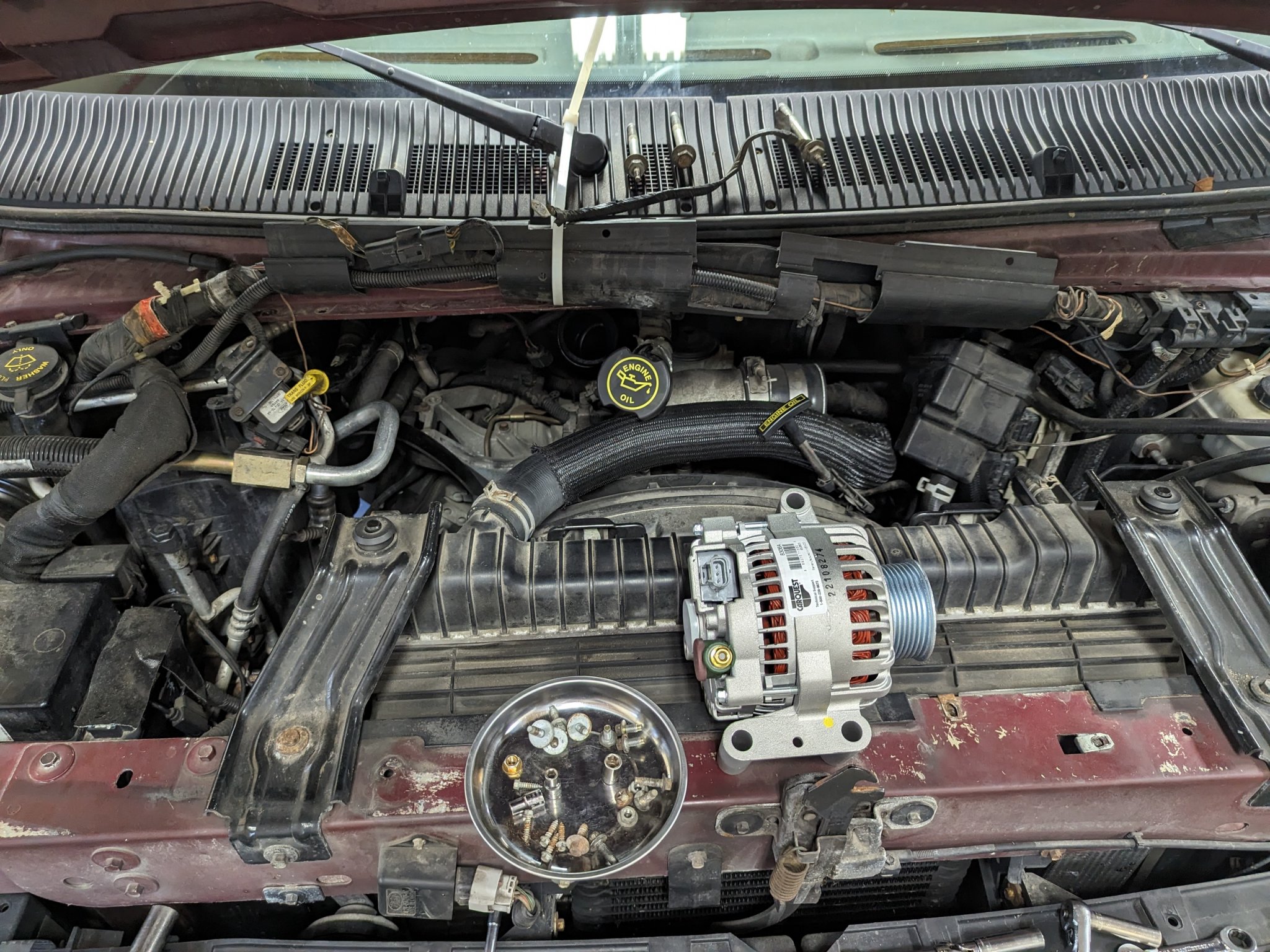

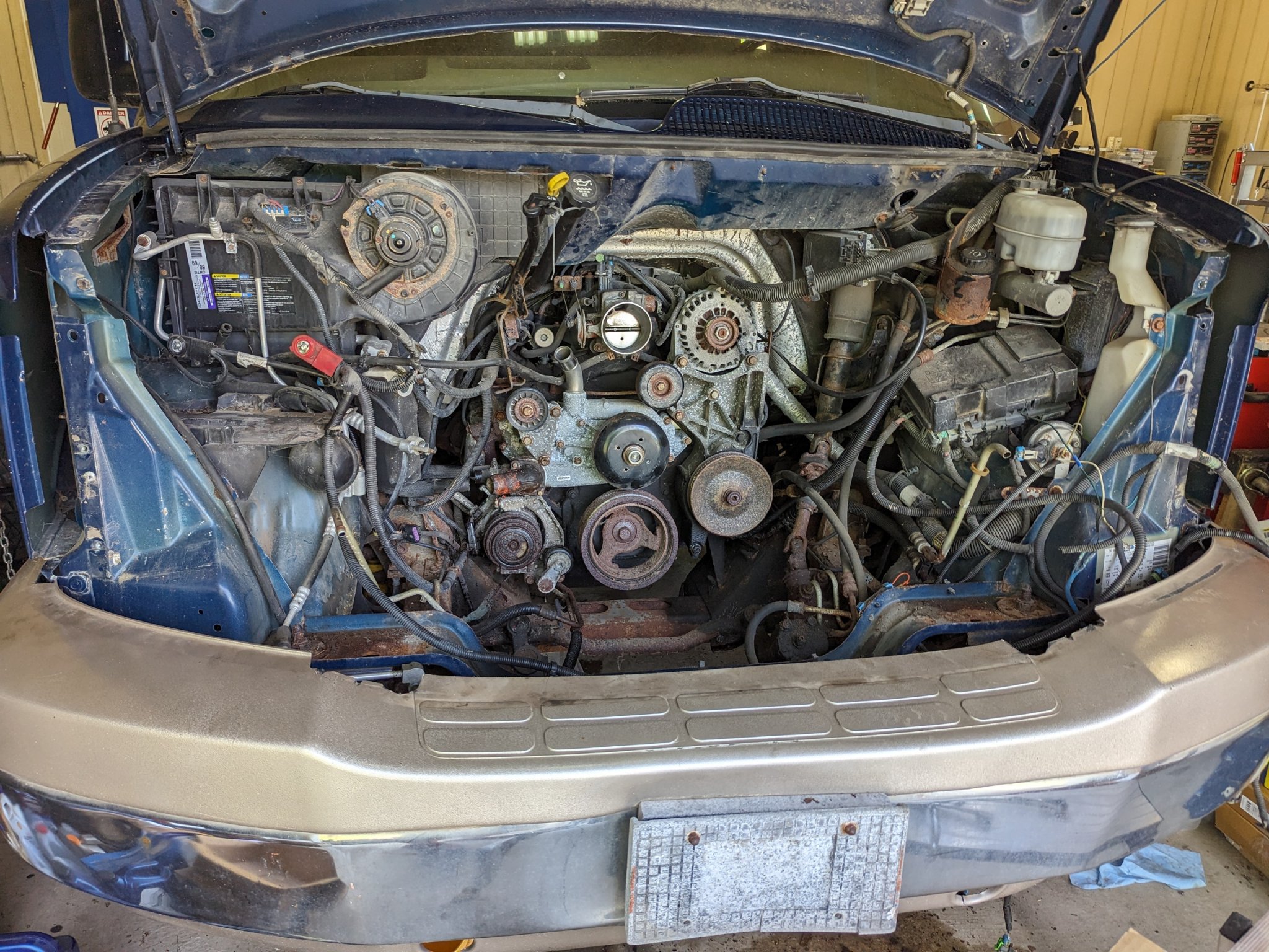

I forgot how much it sucked to yank engines from vans:
Hoping to have this done tomorrow so I can free up that shop stall.

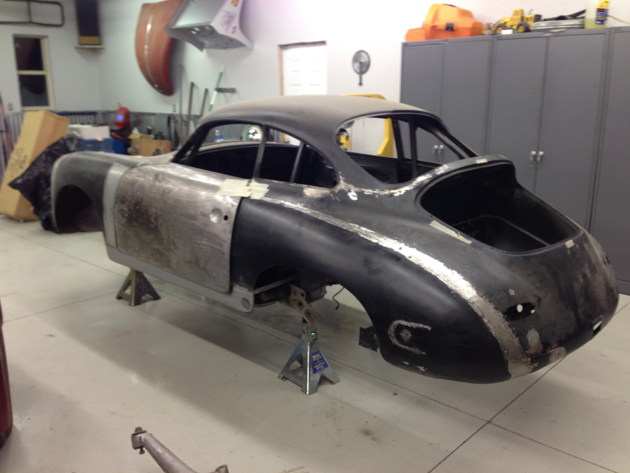

Those 944 rear ends are pretty cool tho. I have a 1964 Porsche 356 that has been modified with a welded in 944 IRS set up. They were going to take it to Bonniville to attempt a record , not sure what class, but they lost interest and I ended up with the project. Long way to go but should be fun.
I have a donor 911 3.0 liter and 915 trans to stuff in it. 😎

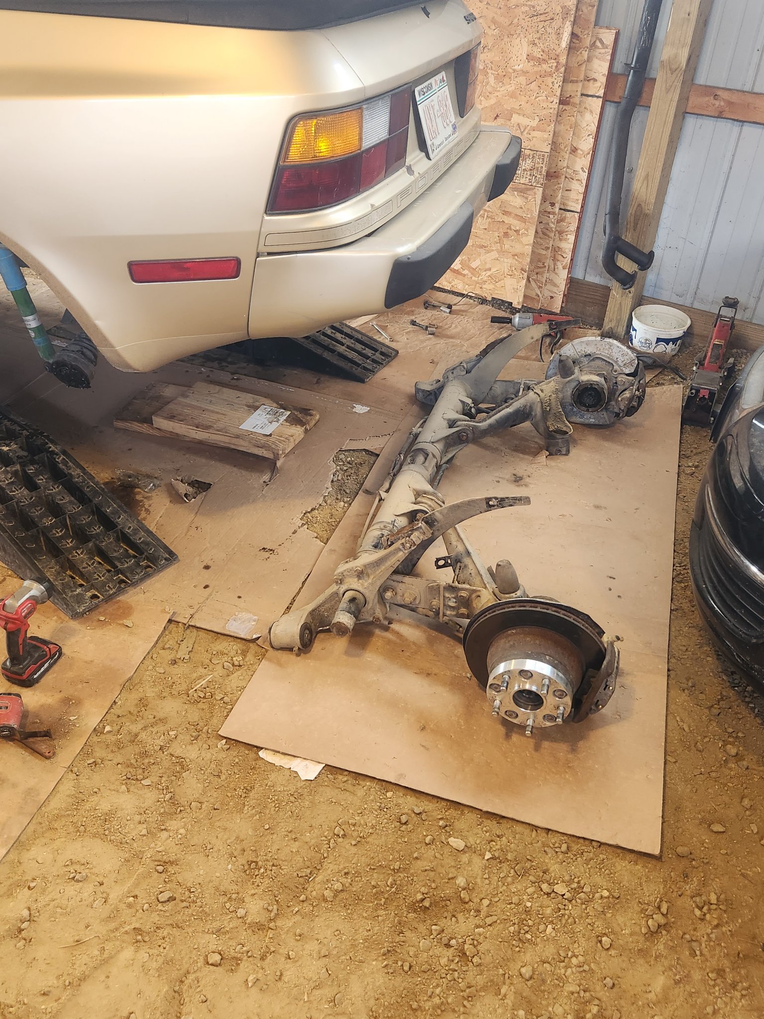

I have a donor 911 3.0 liter and 915 trans to stuff in it. 😎View attachment 8219982
That's gonna be a cool project. How different is the 356 rear end from a 944? The 944 suspension is essentially out of a Super Beetle, and 356/early 911's have a ton of shared Beetle DNA so I would've guessed they were pretty close already.
The 356's run a swing axle rear suspension with a torsion bar set up rather than IRS with torsion bars....so yeah kinda similar.
They completely cut out the old torsion housing and fabricated in the 944 which is wider so "pie" cutting the rear body at the fender and adding about an inch was needed. A lot of metal work had to be done back there.
