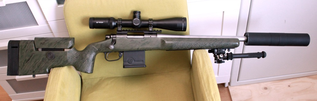

    I had to go back and look at old notes and in a thread I did about the rifle/caliber back in 2015.
    Im sorry to say that I dont have any records of the accutal dope used, I will say from memory that 6-8" groups was hard to keep at 300 meters with the subsonics. And to my surprise the furthest I ever shot with the supersonic loads (155 grain scenar) was acctually 515 meters at a competition, I scored 3/6 hits at that stage.
    Heres what the rifle looked like before it was parted out and traded for another rebuilt R700 in 6.5x47 Lapua.
    Reactions: Centurion123

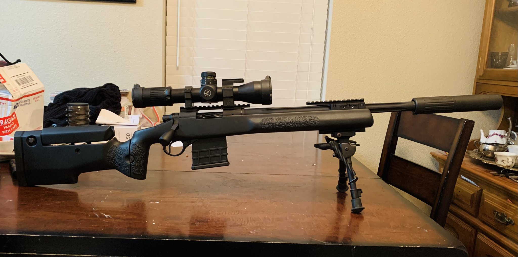

    I’ve shot a 6.5x47 Lapua for the past 9 years, and absolutely love the cartridge.
    My 300 AAC is similar in to yours. 16” rem700, suppressor, but manners folding stock. I’m optimistic, but it will be what it be when the Bullets hit the paper. 🤙🏽
