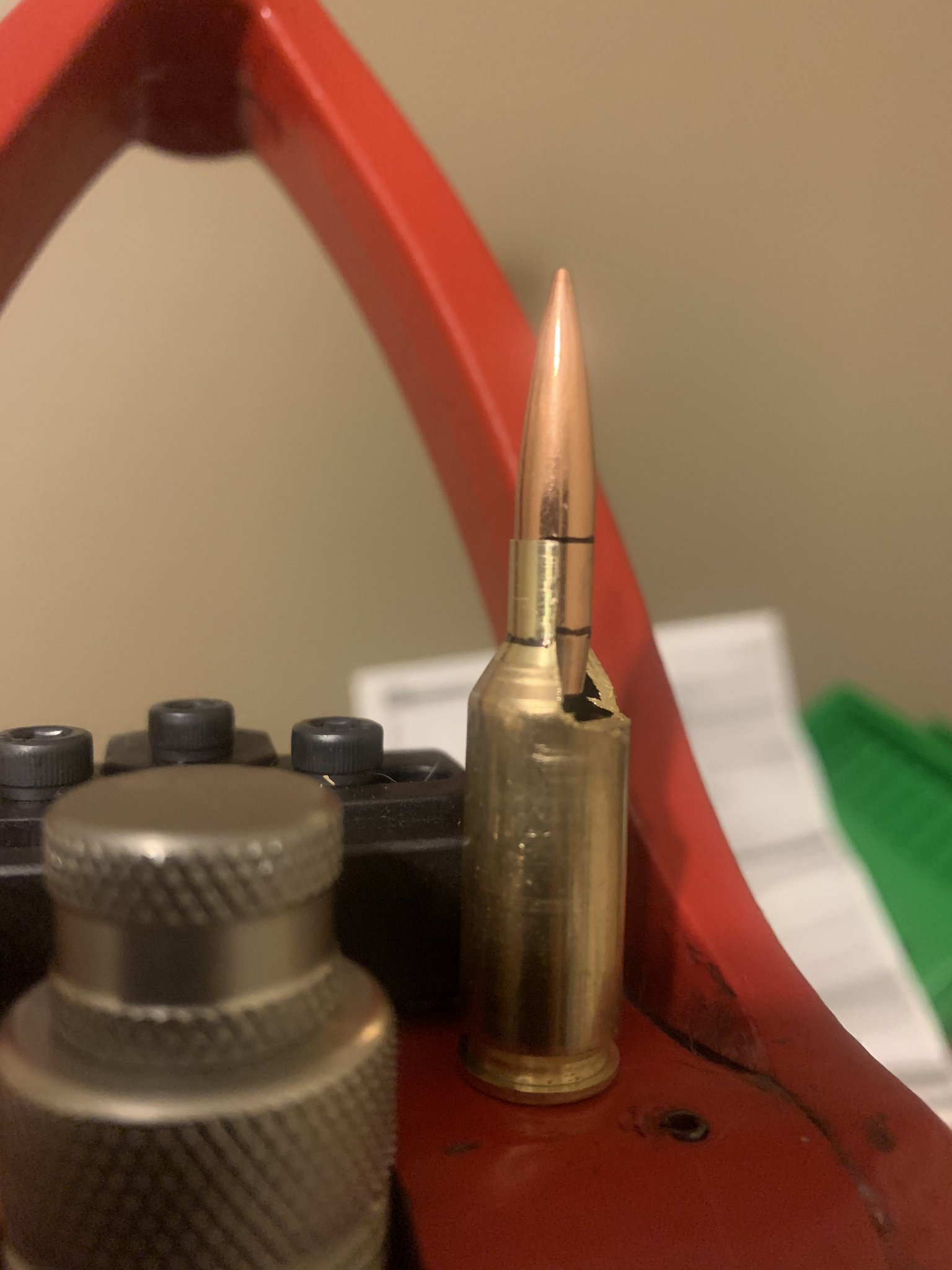

    .22br with 85.5 Bergers (pictured) and will also be trying 88eld.
    Mocking up some dummy rounds for smith to throat for the freebore.
    How much bearing surface in the neck is ideal?
    Photo also includes about 30gr varget for reference (yes, I cut the case empty first and then dropped powder).
    Reactions: Steel head

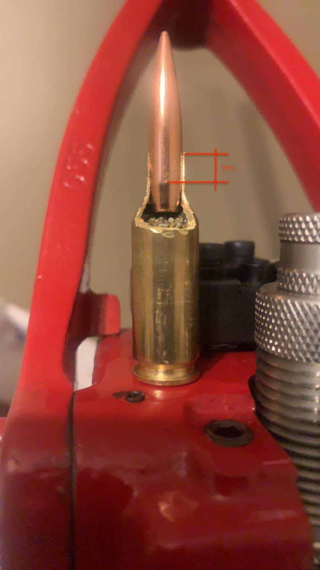

    So, here’s what I’ve come up with.
    Boat tail junction just above the neck shoulder junction. Bearing surface in neck is ~ +/- .230
    BTO with hornady comparator is 1.770
    Think I’m gonna go with that, epoxy a few in and send to smith for chamber.
