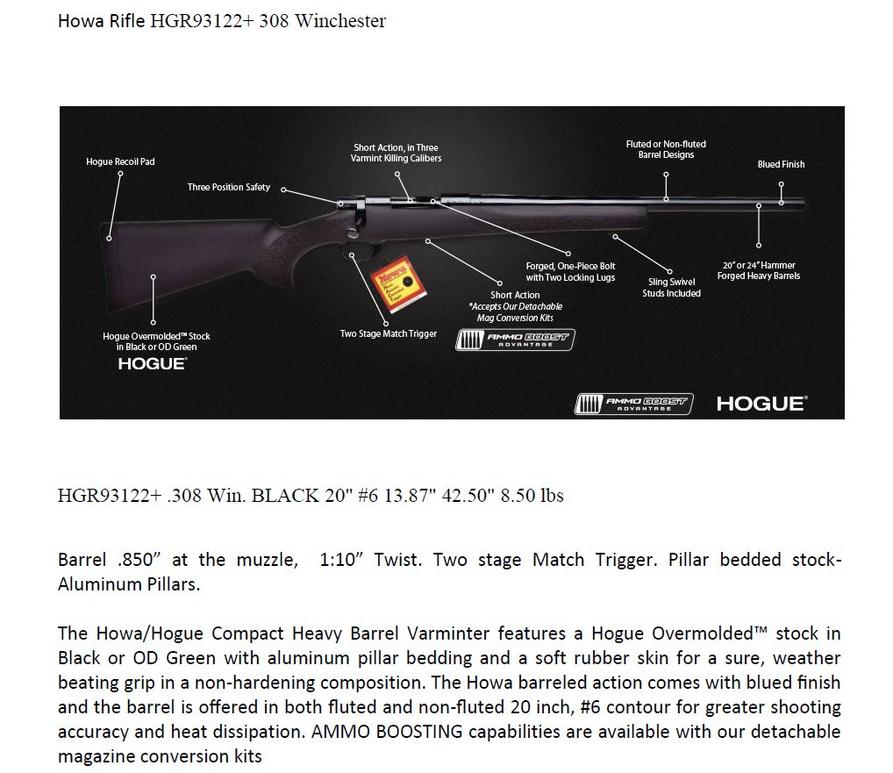

Fairlane.....Are you sure that your barrel is 1/12? I am almost positive that all Howa .308s are 1/10. Look here:
Legacy Sports - Barreled Actions
I have one of these in the varmint profile, and so far it has been an excellent shooter if I do my job. Not to jump around in the thread subject, but does anyone know where one can find the best deal on the bell and carlson tactical stock for these. I've searched the internets, and am having a heck of a time finding one.
The barreled actions can be ordered with a 1/10. However the assembled rifles in the hogue stocks with scope pkg are 1/12. Why? I have no clue! Unless this has very recently changed this is how they have been for quite some time.
I've been through this on the rate of twist question before I bought my Howa. If the gun was built in 2010 or later....it will likely have a 1:10 twist for .308. ( The earlier guns were 1:12). The very latest guns with the HACT trigger will almost certainly have the 1:10 twist. When in doubt , ferret out Andy McCormick at Legacy International, VP Sales / Marketing and ask based on serial number.
