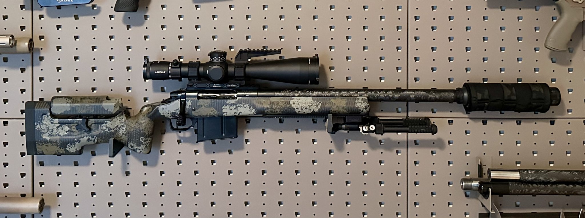

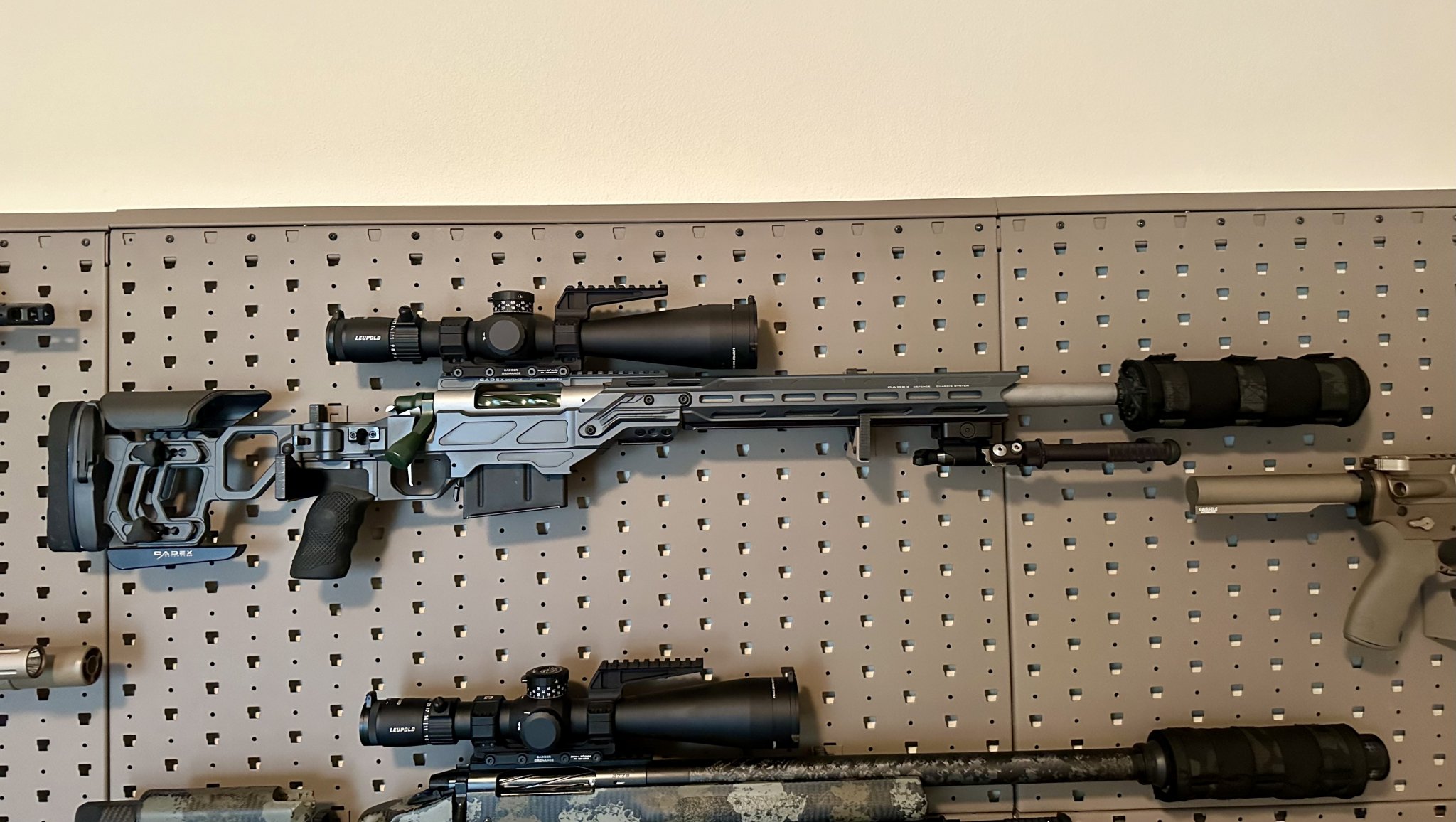

My main hunting rifle is a custom 7 SAUM that I screwed together. It’s on a short action origin and I shoot thw 180 hybrid targets from it. They’re seated at the neck shoulder junction. A warm load of 4831sc pushes them at 2930 from a 24 inch tube. I like it a lot. The only thing I’d change is a shorter barrel for use with a can.
Short barrels with cans are cool

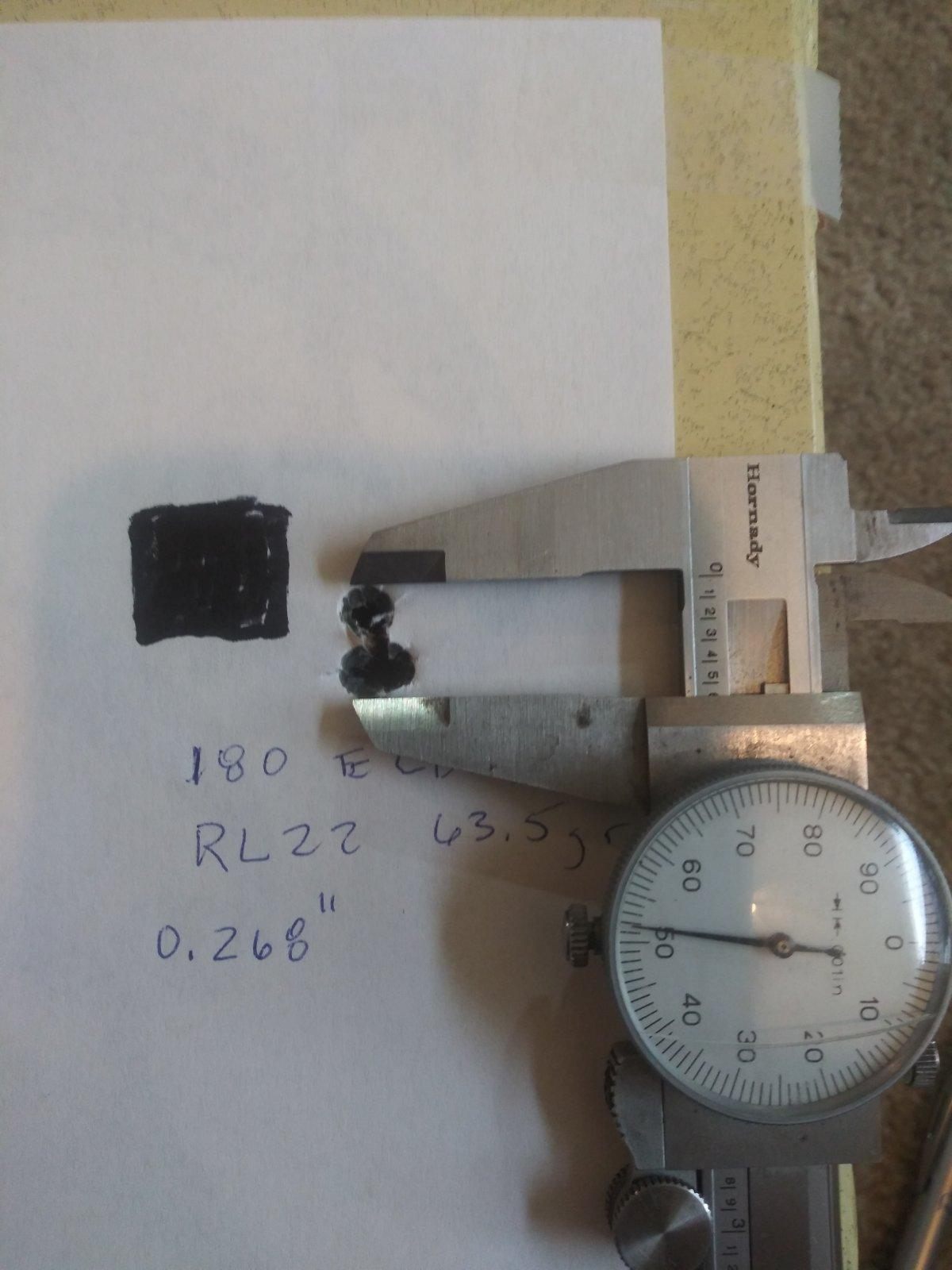

20” 7 mag. I have zero interest in pushing it to max pressure and cannot suggest a prc over this enough - literally not one single benefit to the mag over the PRC.
As soon as this is shot out, it's becoming a 7 or 300 PRC - the 7 is nice on recoil and seeing shots, but that 215 on a target (or a miss) is unmistakable.

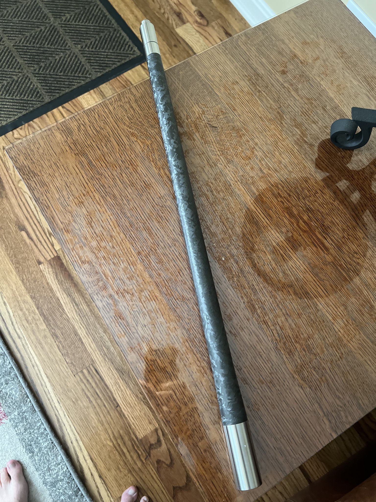

You guys convinced me to make the change from 7mmRM to 7PRC. My smith says his Manson reamer has a slightly wide base and no extraction or sizing issues
Got my proof 24” sendero 1:8.4 yesterday
Defiance AnTi-X in production (long action)
Going to go with MDT HNT26 or XLR folder, probably the former just because I like the looks of it better
Leupold VX5HD 3-15x44 that I have on hand
TBAC Magnus-S-RR can bc I’m going to need some recoil mitigation
Comments or thoughts welcome

Comment: socks should be required for pictures
I'll be interested to hear from you how loud the suppressor is with the RR on the end of it. With a barrel/suppressor that long you may feel like you're carrying around a pole for vaulting over creeks, depending on how thick the trees/brush are where you hunt.
The stock is a folder so knock off 10” when it’s folded on the pack (https://www.snipershide.com/shootin...6-ounce-carbon-fiber-hunting-chassis.7062586/)
Will probably carry w/o the can too
It was between this and a 22” barrel. Firstly, there are no 22” in stock and I can’t afford a 6 month wait for this build. Second, you lose 30 fps per inch of barrel - not a big deal, but this cartridge is optimized around a 26” barrel and I’ll be using H1000 unless it doesn’t work, then H4831 - and they need length to burn and achieve good speed. Third, the weight savings of the CFB are proportionally less with a shorter barrel because the shank/muzzle stays the same as you go shorter - you just remove the CFB on the center. Last, as long as the rig does not stick above the top of the pack (https://exomtngear.com/products/k4-5000-pack-system?variant=44187691909427#specs) with the stock folded, the length of it is immaterial. The pack is about 3 feet high which which means I’m good with the suppressor removed. Of course it takes time to screw on the can, but it also takes time to takeoff the pack, remove the rifle, unfold the stock, remove any scope cover, build a shooting position, acquire the target, await Range information from your spotter, dial for the shot, etc..
TBAC publishes numbers for all the MAGNUS cans on their website; for this can, the shooters ear dB is just shy of 140 and the recoil reduction is 65% (300 Win Mag) compared to 8% with an Ultra7 (which I already have). If you go with an Ultra 5” K can you get ZERO recoil reduction and minimal sound reduction so I see no point in that. You could go with the Magnus-K-RR with a brake, but then you are in the mid 140s with decibels, get a little less recoil reduction, and only save 2.3 ounces and 1.5” - so you’re paying a lot of money for a can, but not receiving the main functionality of the can. Personally I need recoil reduction on a magnum so it’s either hearing pro and a brake and scaring the whole mountainside away with the first shot, or suppress it and take most of the beating from recoil. I think 140 dB is enough to not cause hearing damage/flinching for hunting and the recoil reduction is superb so it’s the best of both worlds. If I don’t have time to screw the can on, it just means one pound of dead weight in the pack, and I take the hit to my hearing for that shot. https://thunderbeastarms.com/img/Poster_2024_magnus.png
I’m really tempted by the Magnus-K-RR. Will have to see.
Everything is a compromise.
