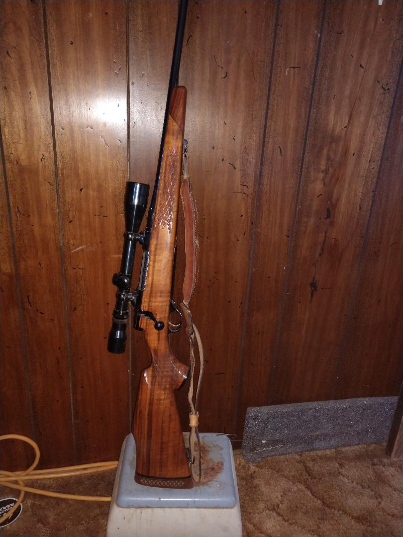

    I have no experience with the other calibers mentioned but am very partial to my 7 Remmy mag since parking my .30-06 as my go to deer rifle
    It just flat pins these western muley's to the ground.
    Nothing special firearm wise other than handed down from my dad.
