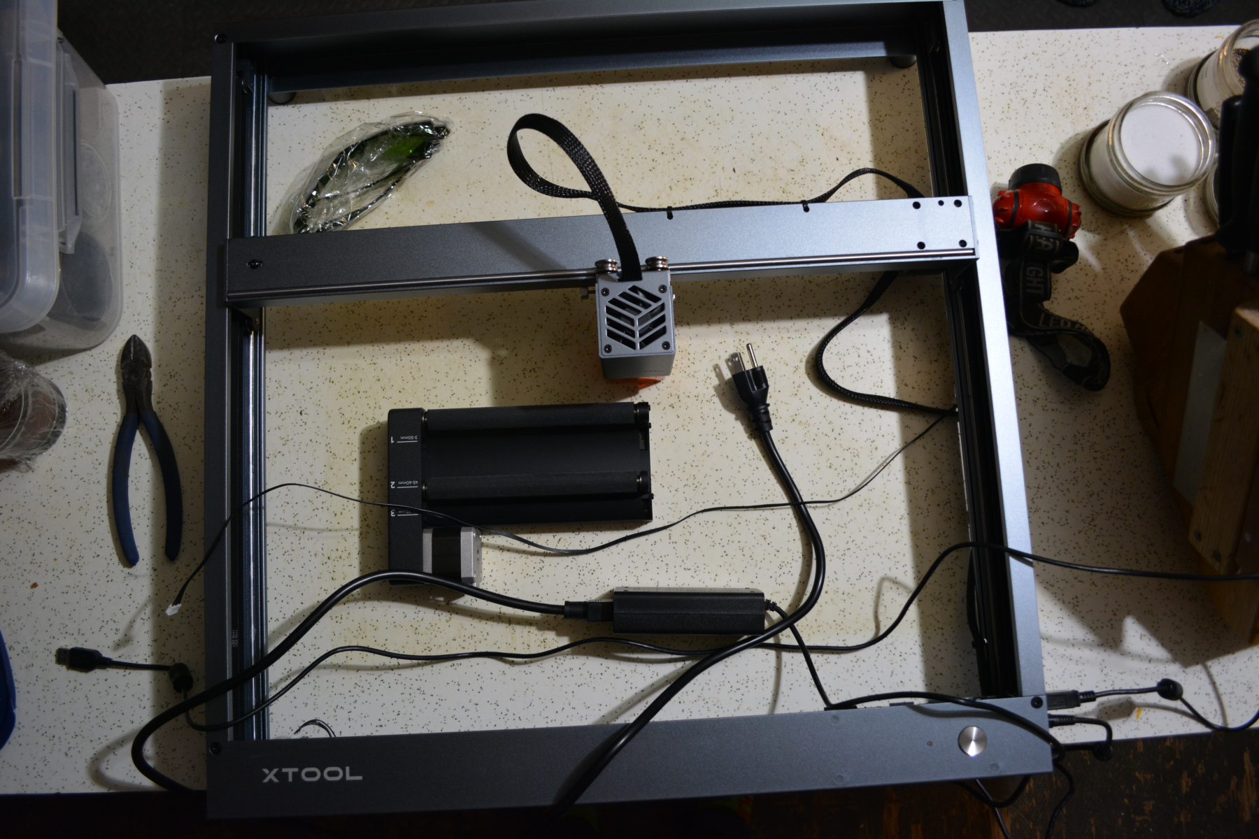

We need an update…
It's here, we've set it up. Are using it. Are going through a HECK of a learning curve. All that we had intended to get done "for Christmas" and whatnot has been held back.
Smarter Every Day, sure. But then everything seems to reset while sleeping and it's a 'learn it all over again' each day. NOT recommended. (TBI's that is)
