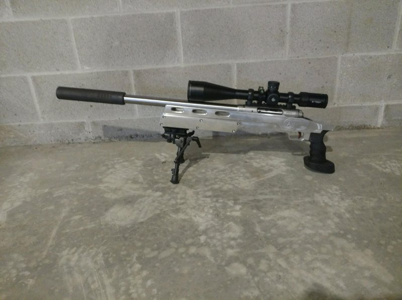

Talk with Joe Updike at Accurate Rifle Systems and he should be able to make you a stock that would work.
Thanks for the input. I know I can find a stock that will work, I was just wondering if there was a chassis that would work.
