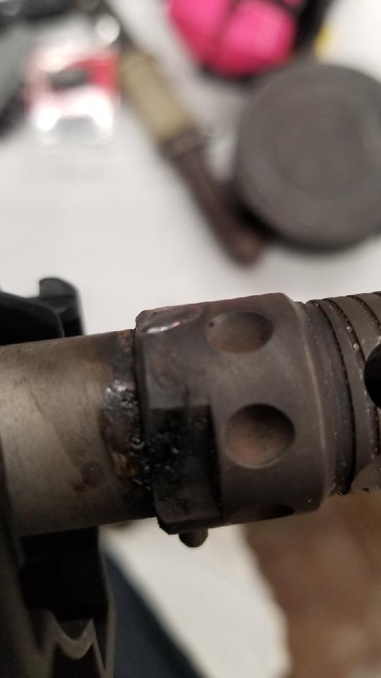

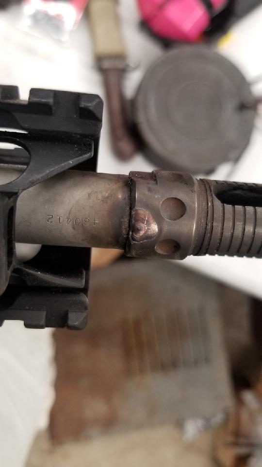

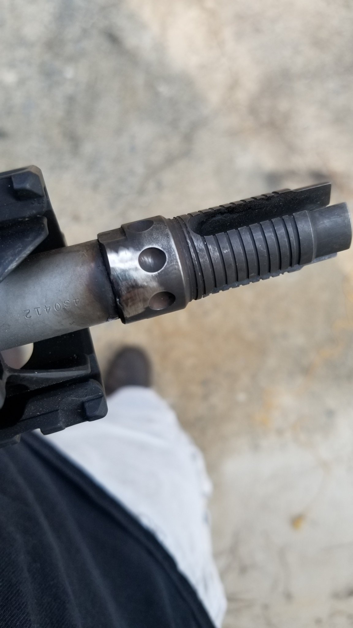

So there is a local guy who came recommended, has good reviews etc. to do a pin and weld job. Below is the end result on my brand new Noveske Afghan Stainless barrel. Not sure if it's totally ruined yet, going to try and get a bore scope in it a look for sugaring and discoloring inside the barrel.

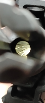

I put about 30 rounds through it, it's holding accuracy thankfully but the integrity of the Barrel is what has me worried now.
There was some excess rocksett glue that dripped from the barrel threads when I had dropped it off to him. He claims a lot of the dark spots near the muzzle device are just burned rocksett.
The only photos I have of the inside are with my phone, luckily no holes or visible bubbling.

Pinning and welding is such a barbaric procedure to begin with. That shit looks downright horrible.
The pin/weld jobs done well that I have seen barely look like anything was done at all.
Sucks, man - sorry that happened to you.
Maybe grab another Noveske or similar quality 14.5” barrel, make him pay for it but install it yourself.
ETA: he also owes you a KAC muzzle device and your $$$ back.

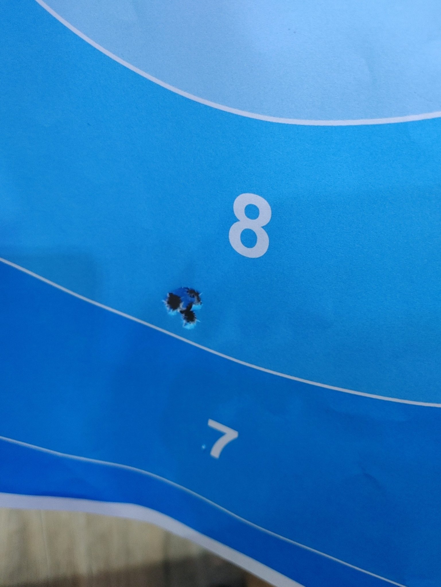

This was a group using AE 223 at 25 yards, so the accuracy seems to be okay. What are you guys thoughts on this? Do you think it could only be some cosmetic damage on the outside or should the whole thing be thrown away?
I don’t really feel 25 yards tells you much. If I am doing my math right, triple the size of that group for 100. But even that doesn't tell the “flight” and stability story. Shoot it at 100 and see how it does.
Noted. I'll try some 100-200 yard groups over the weekend.

Oh, he welded the pin through the bottom gas port so that's out of the question 😭. I don't shoot suppressed but yea.
He may be a nice guy and a gunsmith but he sure as hell isn't a welder, and should know his limits. If he is as cordial as you're saying he should be willing to replace all your shit he broke. Doesn't matter if it shoots or not, that's not a pin/weld. That's a booger that can't be fixed unless the brake and barrel are replaced, that's assuming he did it right and drilled the pin into the barrel threads a little.
He owes you the following:
1) New Noveske Afghan SS barrel
2) New Knights Armament 5.56 QDC brake
3) Reimbursement of funds paid for his shit work
Others may see it differently but that's what I feel would make me whole if I was in your shoes.
I think he just hit it with a mig. If he tig welded that thing he has no clue. I do think a lot of the black is the crusted up rockset, which if he had a clue would have all been cleaned up before welding. Like someone else noted welding dirty metal. In all honesty it’s probably totally fine and will have zero effects on your barrel besides the cosmetic blunder you will have to always look at unless he takes care of it.

Well, sanding or something would be better than that crap, but no, the good ones do it and you can't even tell it was done. Ive watched my buddy to it at his gun shop many times, and it's a very quick small thing. That guy obviously doesn't know what he's doing, he went at least twice at it with an actual bead. Amature hour stuff right there.
Very poor work..... BUT- clean the shit off of it, polish it, put some coating or paint on it and shoot it is probably the best plan. What did he charge you to do it? With zero prep and the end product it couldn't have been more than a few bucks-- and you are thinking that he will buy you a new barrel and flash hider? Good luck with that one.
Not saying it's right but in a situation like this- well- remember the Jim Carrey rant in Liar Liar? Usually pretty sage advice.
Agree it's just messy. 90% of that is poor work practices (not cleaning enough, not protecting nearby materials, etc), but it's a small weld that isn't outside the norm for un-cleaned-up welds, so doesn't look (with what can be seen) like it would damage anything.
But that he also fucked up the other 10%, not cleaning it up after is crazy. I'd ask if he wants to fix it as above (get the parts, someone else does it), but if not then file it all clean and refinish it (or have a friend you trust with sandpaper and hand files do it).
And yeah, if you won't publicize it broad, DO share this work with all local friends so they know to at least watch out closely, use caution with what he's brought if he's the only choice locally. I know there are fewer all the time, and some regions have poor choices in smiths so there can be limits to choice.
If he welded your gas block pin then he owes you a barrel, muzzle device, and gas block. If he doesn't want to pay up, destroy his reputation. Welding a gas block pin is retarded. Post his name here so no one else has to go through what you went through. It's a public duty.
Ok, so he went full bubba.
My initial thoughts were "he's just doing this quick and cheap under the impression you were doing the finish work".
Now it's more like "he left it to the apprentice that started Monday, and he wants to leave to drink beer but was told this needed done today".

...why the fuck is he putting rockset on a muzzle brake he is welding on?....
fuck, a pin and weld is one of the easiest gunsmithing job you can do.....put brake on, drill through brake and slightly into barrel, drop in pin, quick zap with a tig torch (usually dont even need filler).....done.
even with rockset, you should not be putting enough heat into it to burn it
if your pin weld doesnt look like this...your smith is a fucking hack.
