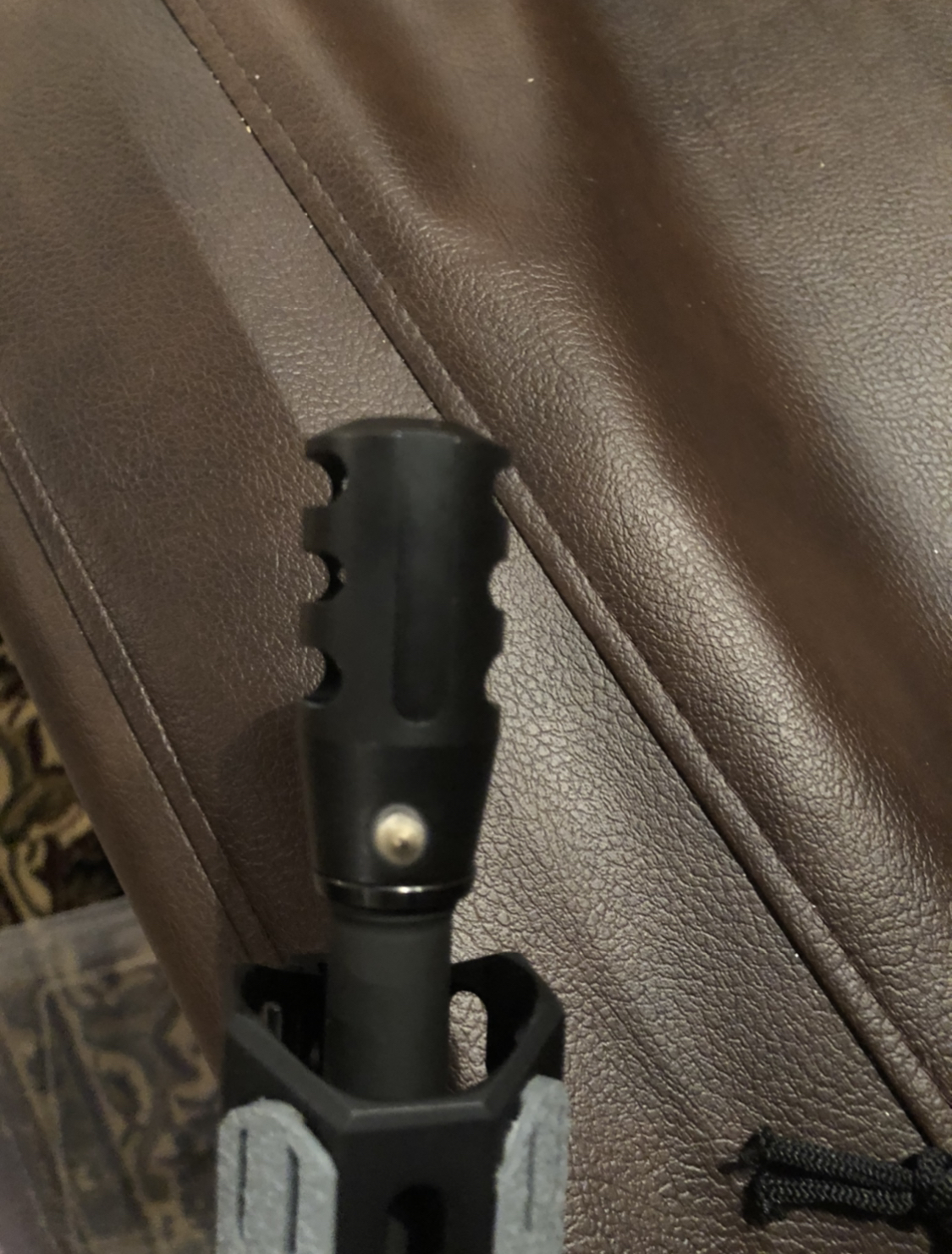

I trusted the local gunsmith for my pin and weld
This is like you brought your car to a body shop for a paint job and they used a mop to paint it.

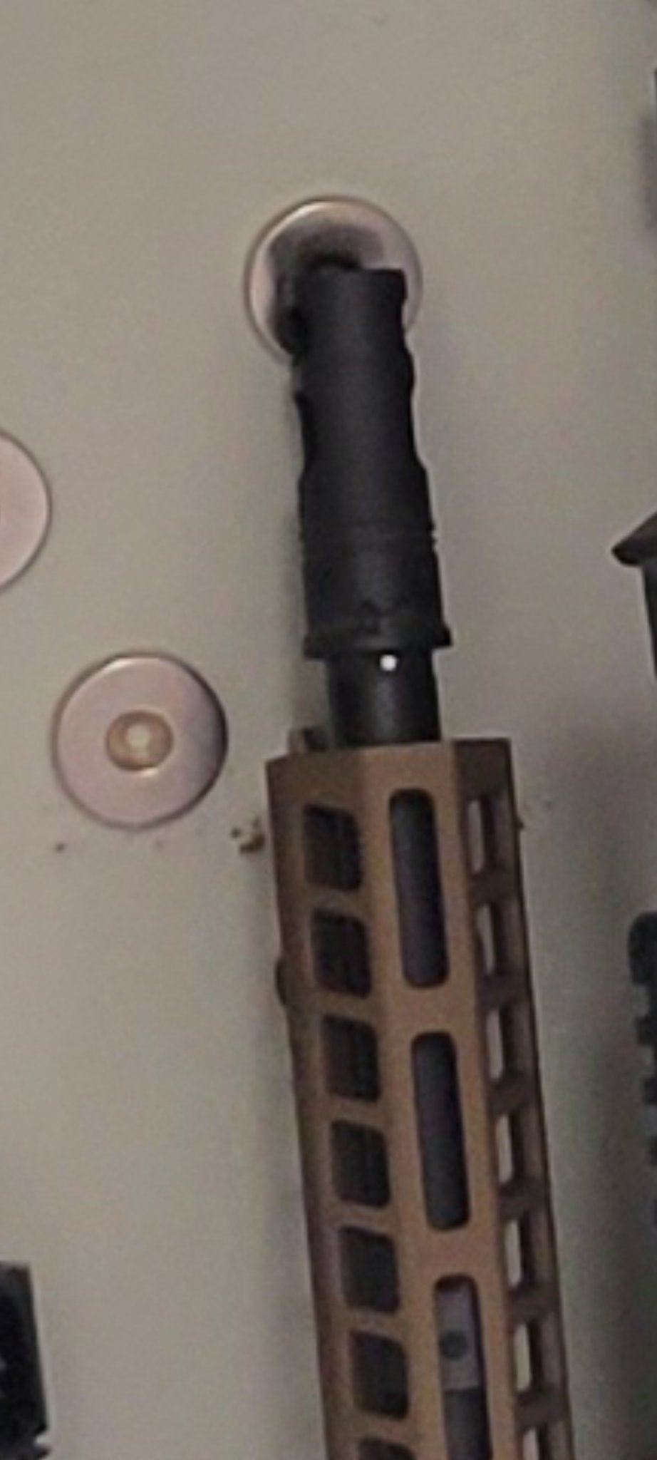

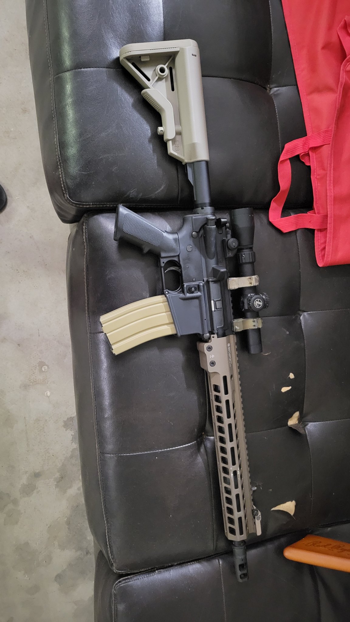

So there is a local guy who came recommended, has good reviews etc. to do a pin and weld job. Below is the end result on my brand new Noveske Afghan Stainless barrel. Not sure if it's totally ruined yet, going to try and get a bore scope in it a look for sugaring and discoloring inside the barrel.
I put about 30 rounds through it, it's holding accuracy thankfully but the integrity of the Barrel is what has me worried now.
There was some excess rocksett glue that dripped from the barrel threads when I had dropped it off to him. He claims a lot of the dark spots near the muzzle device are just burned rocksett.
The only photos I have of the inside are with my phone, luckily no holes or visible bubbling.
Moral of the story: Send your stuff to Arco or D. Wilson
What exactly did you pay him to do? Looking at the photos, did he do all the work seen in the photos? If so the weld and grinding/shaping doesn't look all that bad. All welding that isn't cleaned up looks similar. If he used gas slag will be on it as well.
"Finishing" is another story, did you pay him to refinish the muzzle device and barrel?
Are you the one who put Rocksett on the threads and then torqued it down and then took it to him in that condition and said "pin and weld it?" Rocksett should have never been used. I would have never expected a customer to have used Rocksett on a muzzle device/barrel he/she wanted pinned and welded. Did he even know there was Rocksett on the threads, or did he find out after he applied heat and it dripped down onto the barrel? Getting rid of the stuff is time consuming and wouldn't be part of a standard charge for pin and welding.
Either would refinishing. Refinishing would normally include cleaning up the part, removal of old finish, and refinishing. If the person doing the refinishing sees something that will take more time or not turn out right he'll call it to your attention and give you a quote for the extra work. Refinished properly you'd never know there was a problem.
Looking at this I suspect there is a gap between the gunsmith and the customer in what is being paid for and what you expected. Expectations need to be managed by both parties. At this point I'd take it to someone who can clean it up and reapply the desired finish, or use this misunderstanding 5o upgrade your finish.
Good luck with this.

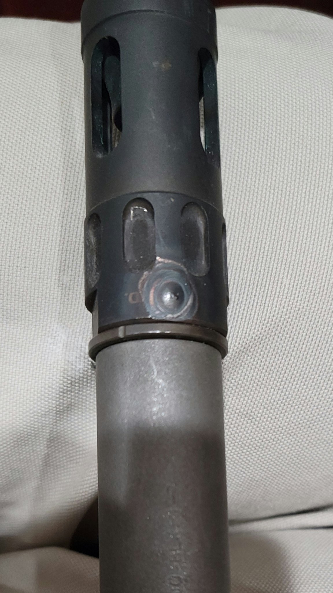

Here's my guy. Did fantastic.
@flyfisherman246 Is the fucking man. Misery Custom Rifles
14.5 Bartlein 223 wylde pin/weld Surefire SFMB. USMC sniper turned machinist/gunsmiff. Did some contractor shit with him overseas. Much Solid. So tactical. More gooder
Is that even a tig weld or is that a piece of mig wire sticking out? Or a piece of the, way to long, pin?
And why was there even rocksett on it at all? That shit should have been sparkling clean...
Welding dirty metal is a fools errand IMO... and the results speak as such.
Looks like a mig weld, he must of not known just to fill the hole for about a second. Its just a pin job , your not welding on an axle bracket.

To clarify, there is a gas relief port on the bottom of the muzzle brake to be used with the KAC can. The gas port on the barrel was never touched.
I agree however, a lot of this is on me for not knowing more about pin and weld jobs before trusting someone with my equipment. Lesson learned the hard way.

Edit: I just looked closer at pic #3… He clearly used way too much heat, but as long as it shoots fine, tell him to cover the cost of Cerakoting the whole thing and you should be gtg.

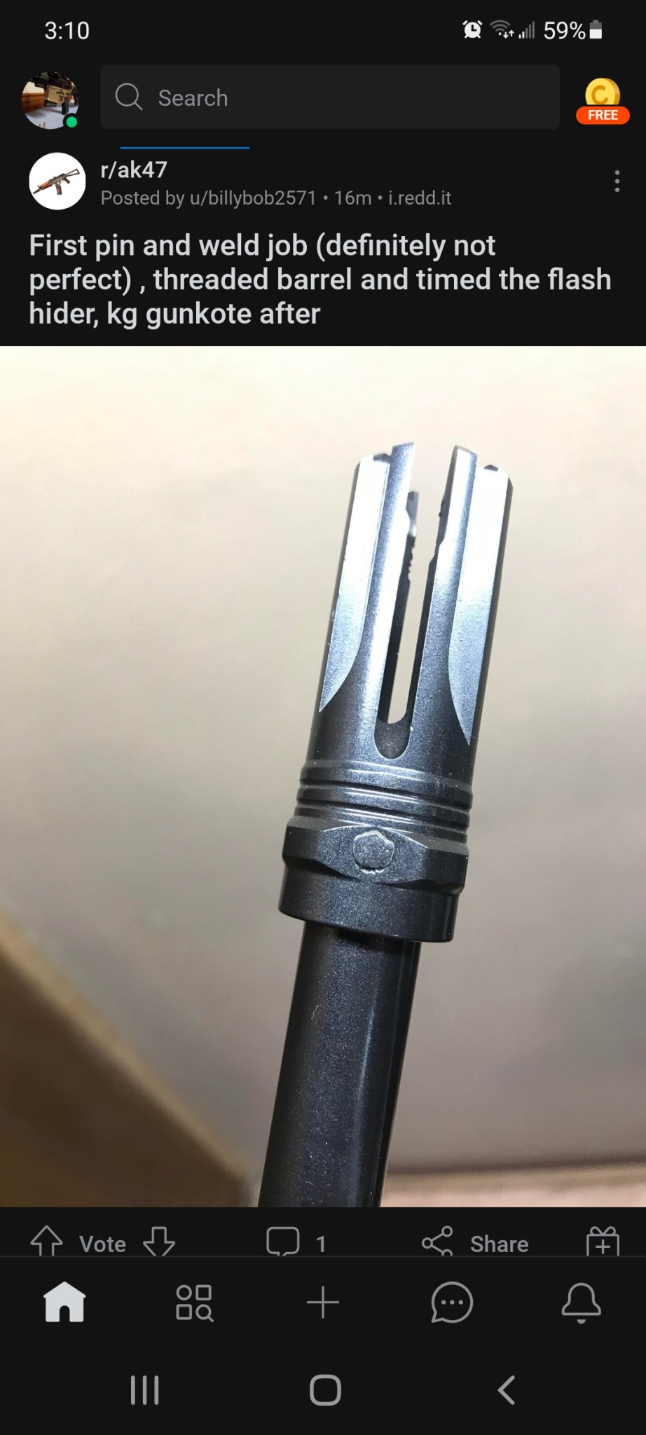

First pin weld job I'd done and I've never taken a welding class. I was pissed that there was some contamination in it. Could have massaged it, but I like it to be shallow enough to lightly grind and remove the accessory in the future.
This gun shot sub 3/4 moa at 100 w/ a 14.5" barrel after the pin job.
