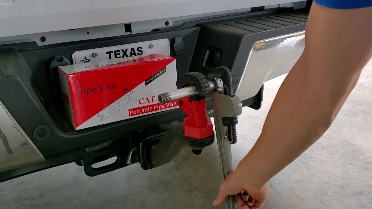

Serious question. In what hypothetical situation is an officer actually doing more than a visual inspection?
how are they testing it?
Do they carry a portable x ray machine or weld inspection tools?
Do they put it in a vise and try to crack it loose?
I don’t know if this is true at all!
I read an “opinion” that they put a wrench, essentially a hand tool only, on there and it must stay on.
My question is wouldn’t a warrant be required? If seen some pretty big wrenches so is there a limit?
Although this seems questionable.....
