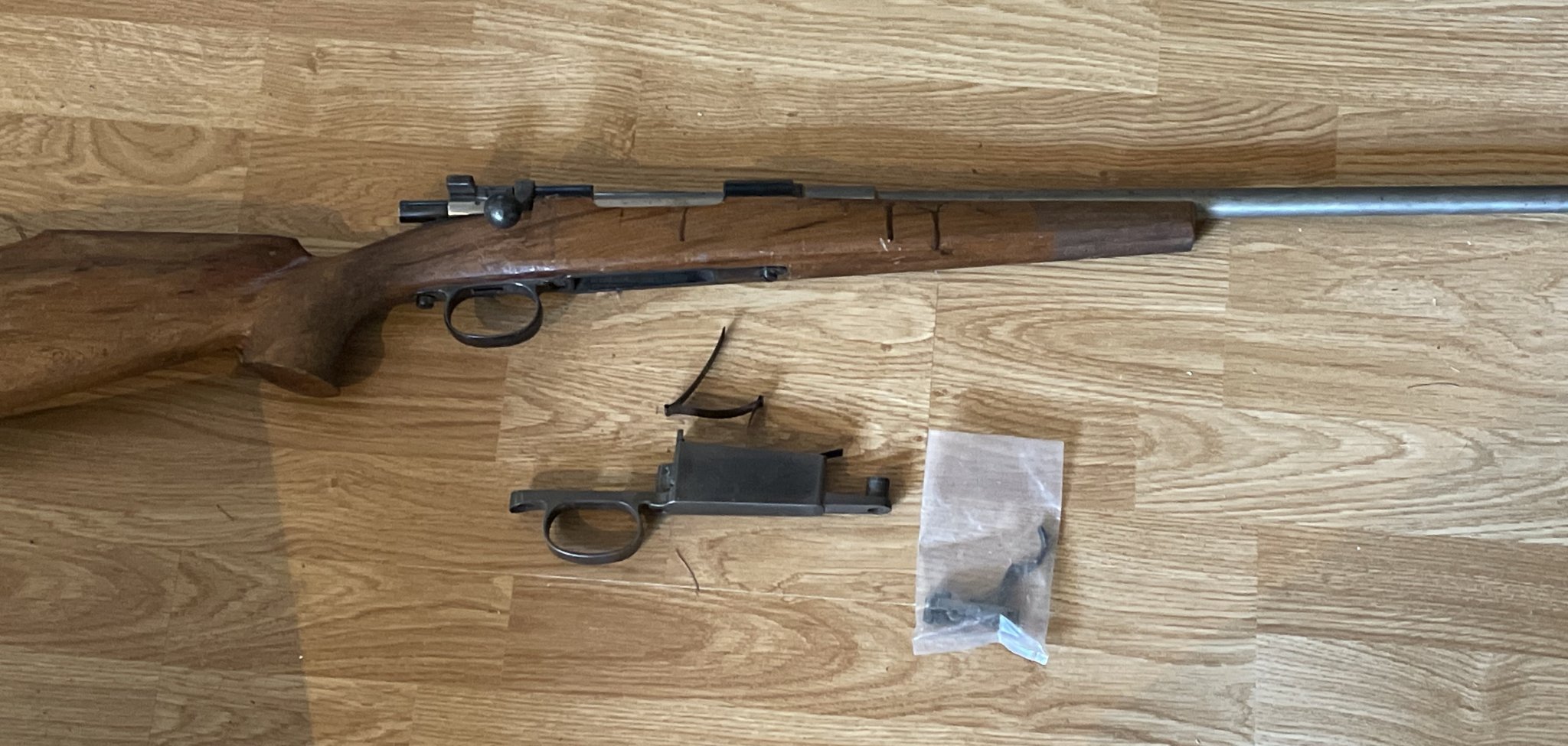

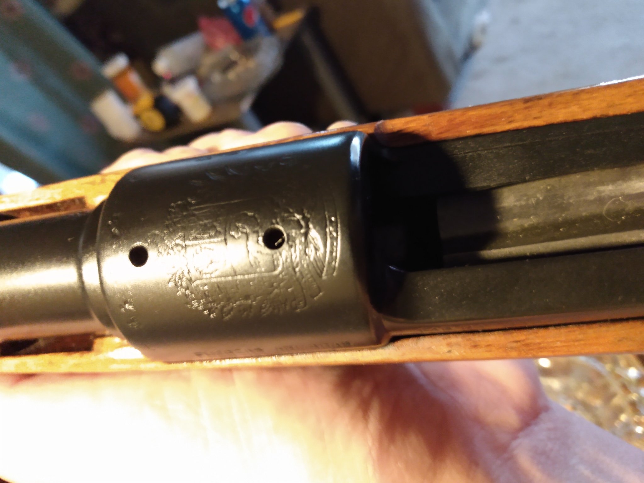

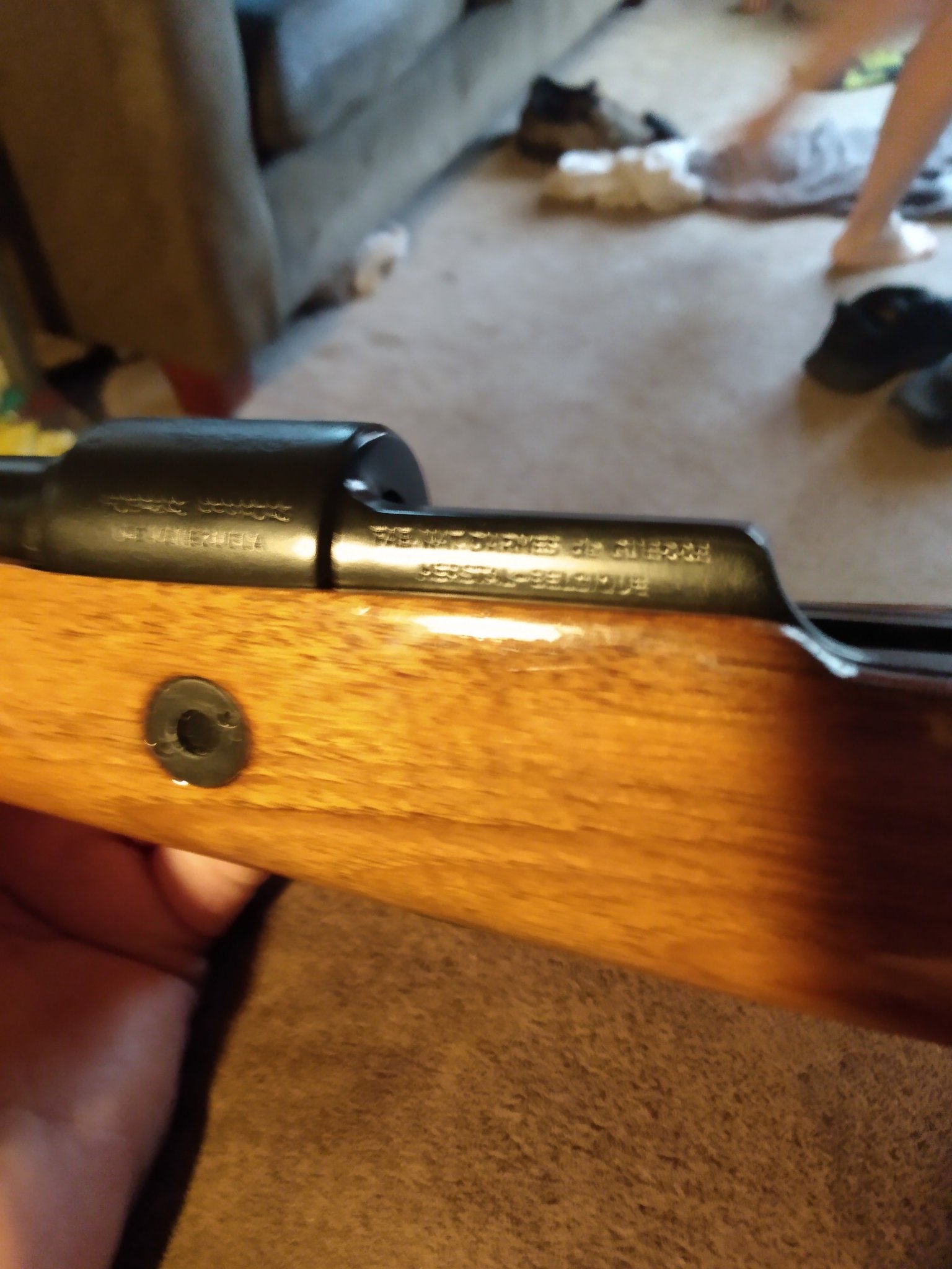

Great granddad's gun. I need to know model and possibly the caliber. IMG_20221107_093115830.jpg

Appears to be Belgium made at FN would be my guess. Made for Venezuela. Caliber? Good guess. Looks to be sporterized. Need more pics!
I don’t know what tools you have available to you but worse case scenario grab a 30 cal bullet, a 7mm bullet etc…see what won’t go into the barrel. That would at least give you an idea of the bore size.
Better yet get some cerrosafe from Brownells and do a chamber cast and up into the rifling. That would help a ton in identifying the caliber and cartridge.

Most Venezuelan Mausers I've seen are 7x57mm. Does it have a straight or bent bolt handle?
If you can measure the inside diameter of the muzzle with a dial caliper, it should be .284" if it's a 7mm.
Reactions: Huskydriver
I think FN M30 in 7 x 57mm , just one possibility .
Reactions: Bibskid
The handle is broke off. It's been sported already. Notch cut in stock so gonna say curved?? I've sent one bolt back to Numrich. Now I'm trying to find iron sights complete rear and complete front sights. Until bolt gets figured out by Numrich. Like to know if rifle can be converted to accept a clip with more rounds. Lots to do and figure out. Thanks everyone for tips and information.

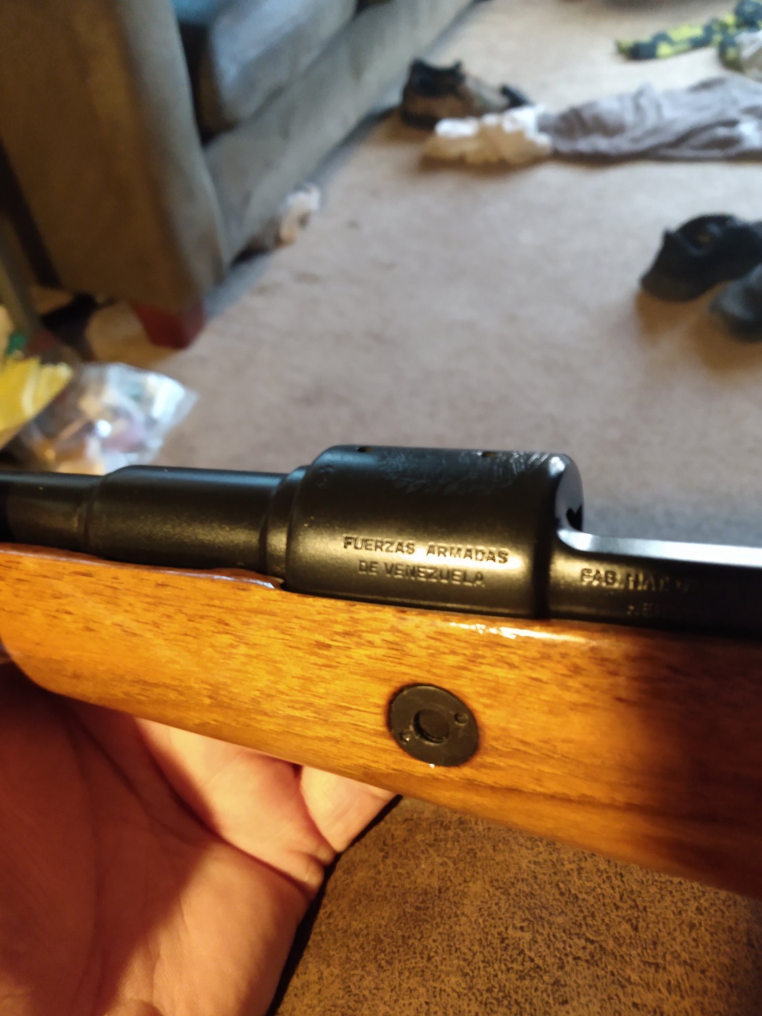

This thread went way off the rails, but fwiw, rifle is an FN-made Venezuelan Model 24/30. Three models were made during 1934-35. The book Mauser: Military Rifles of the World, by Robert W.D. Ball has the info:
24/30 Short Rifle: 23.19" barrel
24/30 Carbine: 17.63" barrel
24/30 Target Rifle: 29" barrel (not many were made, but were used for the Olympics. That rare version would have some decent value).
Caliber for all of those Venezuelan Mausers is 7 x57mm Mauser, which was popular in Latin American in early to mid-20th century.
Originals had bolts and receivers that were 'in the white' (silver). The pics showed a blued action and holes for a scope mount, so it's been sporterized at some point, and the barrel/caliber might have been changed too, but its impossible to say without a knowledgeable gunsmith carefully examining it.
