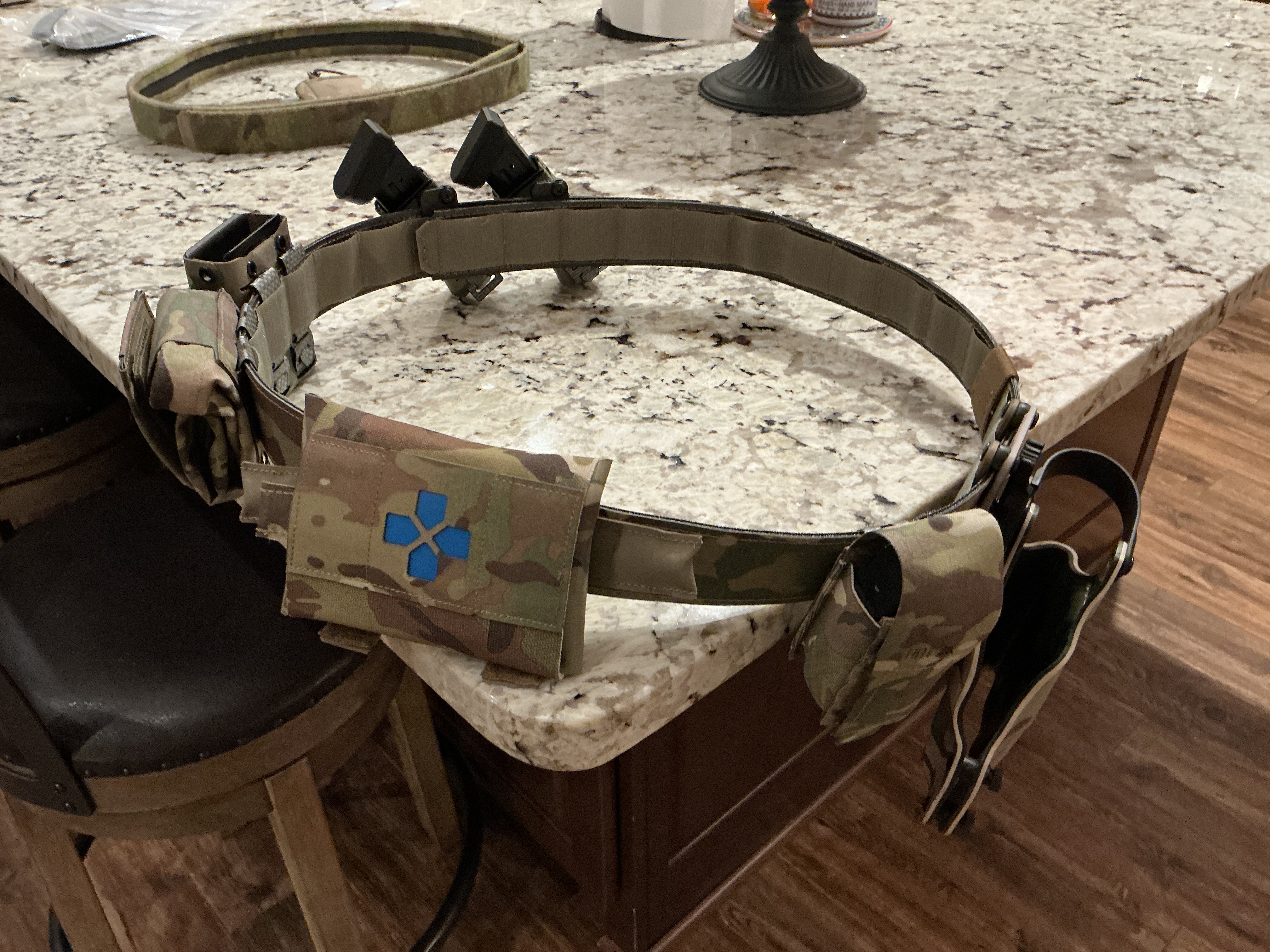

Bit of a thread necro, but after helping a couple of my younger shooting group prep for a “run and gun” event recently, what do y’all recommend for a minimalist med pack to go on a range belt?
I’m not talking about a full up kit, we have those in our vehicles, in packs, etc. I’m looking for ideas on the absolute minimum to have on you at all times when at the range, or when doing a competitive event where there will be a lot of movement over distance.
We put tourniquets all over our gear, and treat them more like part of our minimum gear load out like a weapon light or sling (and usually have at least two on us at all times), so I’m not counting those for this exercise, but here’s what I’ve started packing in those tiny flat pack med kits from BFG to go on the back of everyone’s gun belt:
- One set/pair of vented chest seals
- One flattened emergency dressing
- One quick clot bandage
- One pair of non-latex gloves
What else should I include? Thought about nasal tubes, trauma shears, etc. but again, this is a minimalist kit and trying to keep it very small so they don’t have any excuses to not to carry it at all times
Maybe an Israeli bandage in place of the two smaller bandages?
How do we feel about those rolled up compression/wrap tourniquets?
Edit: Everything has to fit in this pouch (or smaller):
Any input appreciated…
Trauma shears and at least 1 tourniquet (I like the SOFT T Wide) need to be on the list. A sharpie to mark the time a tourniquet is applied is highly recommended and won't take up much space. I keep a Blue Force Gear https://blueforcegear.com/micro-trauma-kit-plus with the advanced kit on me when I go to training classes as well in my vehicle glove box. I have a second tourniquet on my sun visor of each vehilce. I just recently picked up a Micro Trauma kit with the advanced kit https://blueforcegear.com/micro-trauma-kit and a Shear Hammock https://blueforcegear.com/shear-hammock. I replaced the quikclot in both kits with the LE quikclot that has an x-ray visible strip in it. The smaller size is a little more comfortable when riding in a vehicle but it is a tight fit getting everything inside the pouch. Ii am trained to use the decompression needle but mot the nasopharyngeal airway but it is still nice to have. Twice at work I have responded to either a crash or industrial accident where I was the first on scene with a volunteer ems right behind me in their personal vehicle with no equipment. Having the tools made a difference because the volunteer was able to provide care faster than just waiting for the ambulance to get there. My county is still an almost 100% volunteer fire/ems system. We have 3 paid ambulances and crew for the entire county. They are only in service Monday though Friday 0800-1600.
