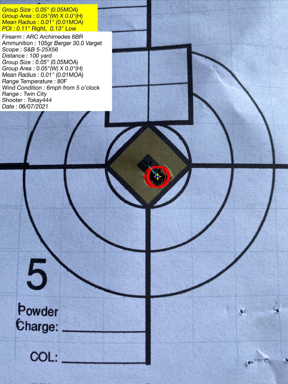

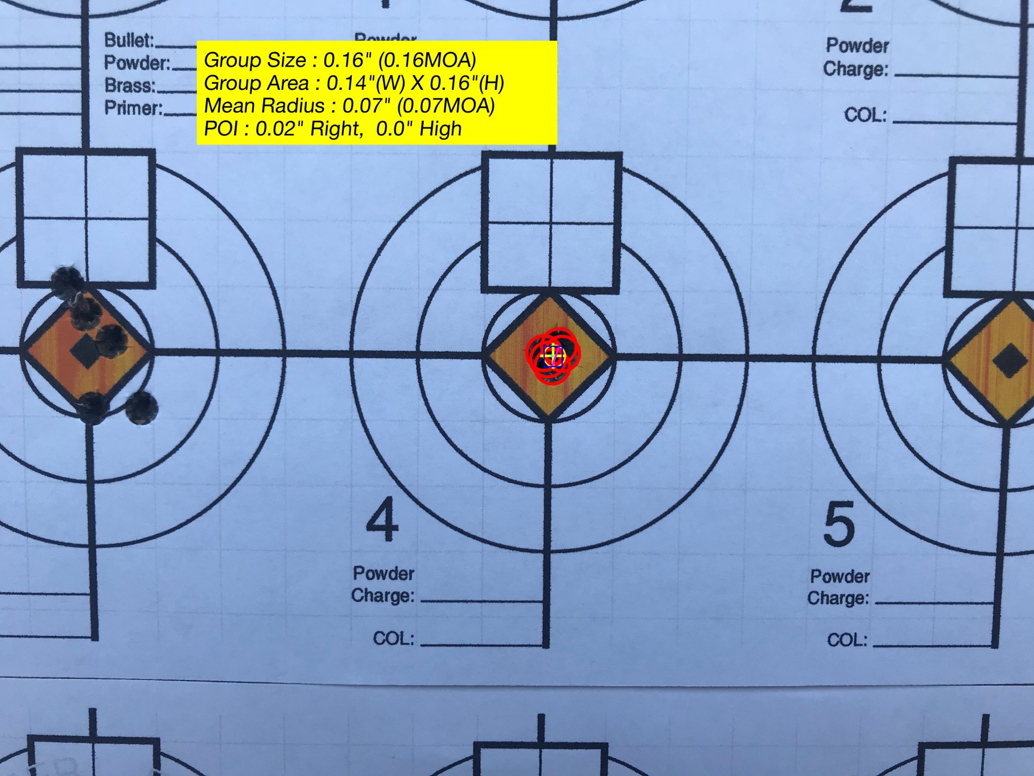

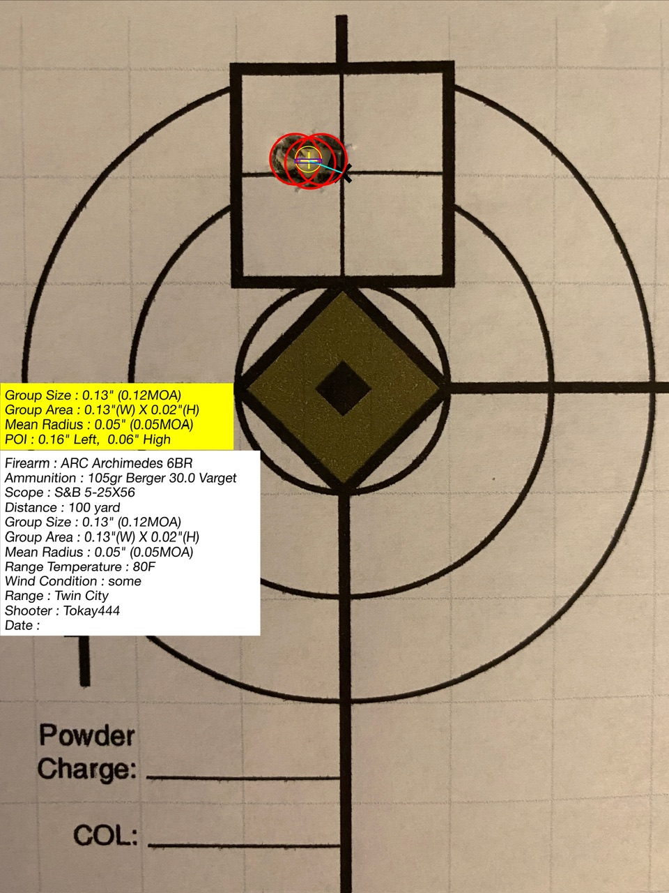

I didn’t take 30 anything for me to realize this load was a winner. Not 30 shots. Not thirty samples. And since then, it lines up with my ballistic calculator 100% and has yet to fail to put a first round shot on target out to a mile, in a 6BR.
Here’s another load developed in less than 30 samples that I have extreme confidence in. Different gun. Different components. Different cartridge. 6.5Creed.

How do you know for sure it’s a winner? Could you repeat that group over and over and over again with that load and that gun? Can you repeat this 20, 30 or even 40 times? And also how do you know it’s the load, and not the barrel? I know in many of my larger groups I could cherry pick 5 shots that look exactly like that, yet the group as a whole was kinda meh. I wouldn’t have known that till I added more shots to the group, or until I had been having trouble with hitting things as accurately as I expected.

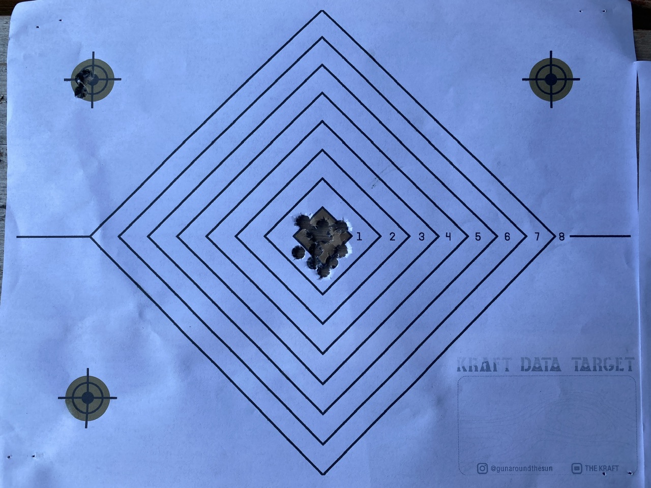

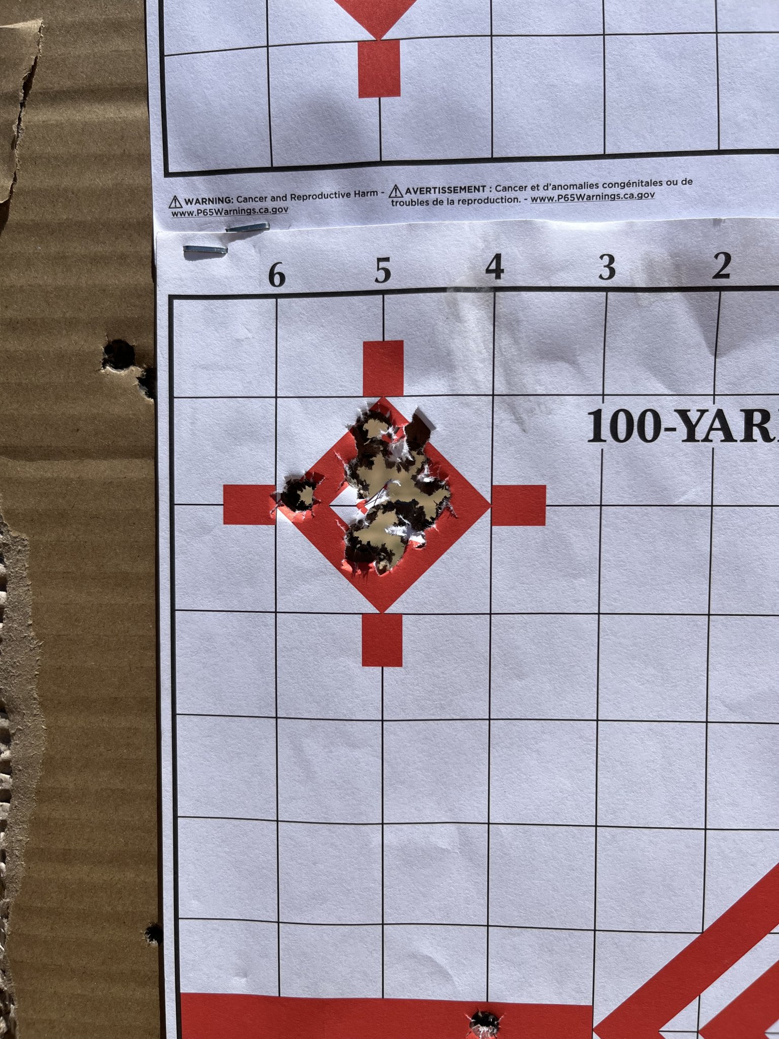

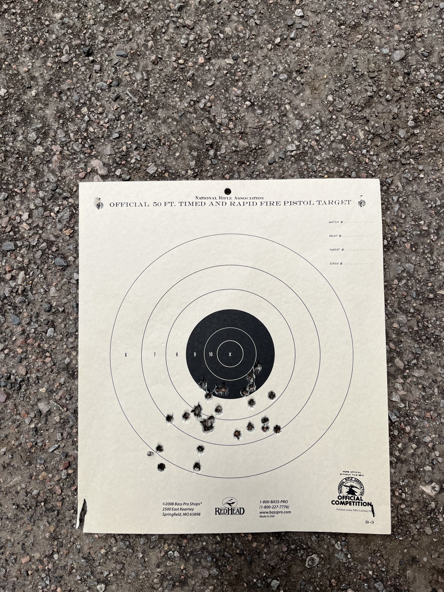

First couple pics don’t really say much, but the last pic with the larger group is pretty good. Though what does the larger group with more shots compare to your other loads? How do you know this is because it’s the load, or the barrel?
That’s a Kraft drill target. 1 shot from 4 positions, 3 times.

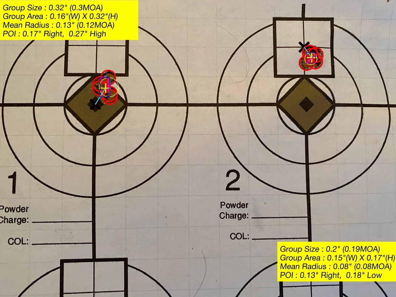

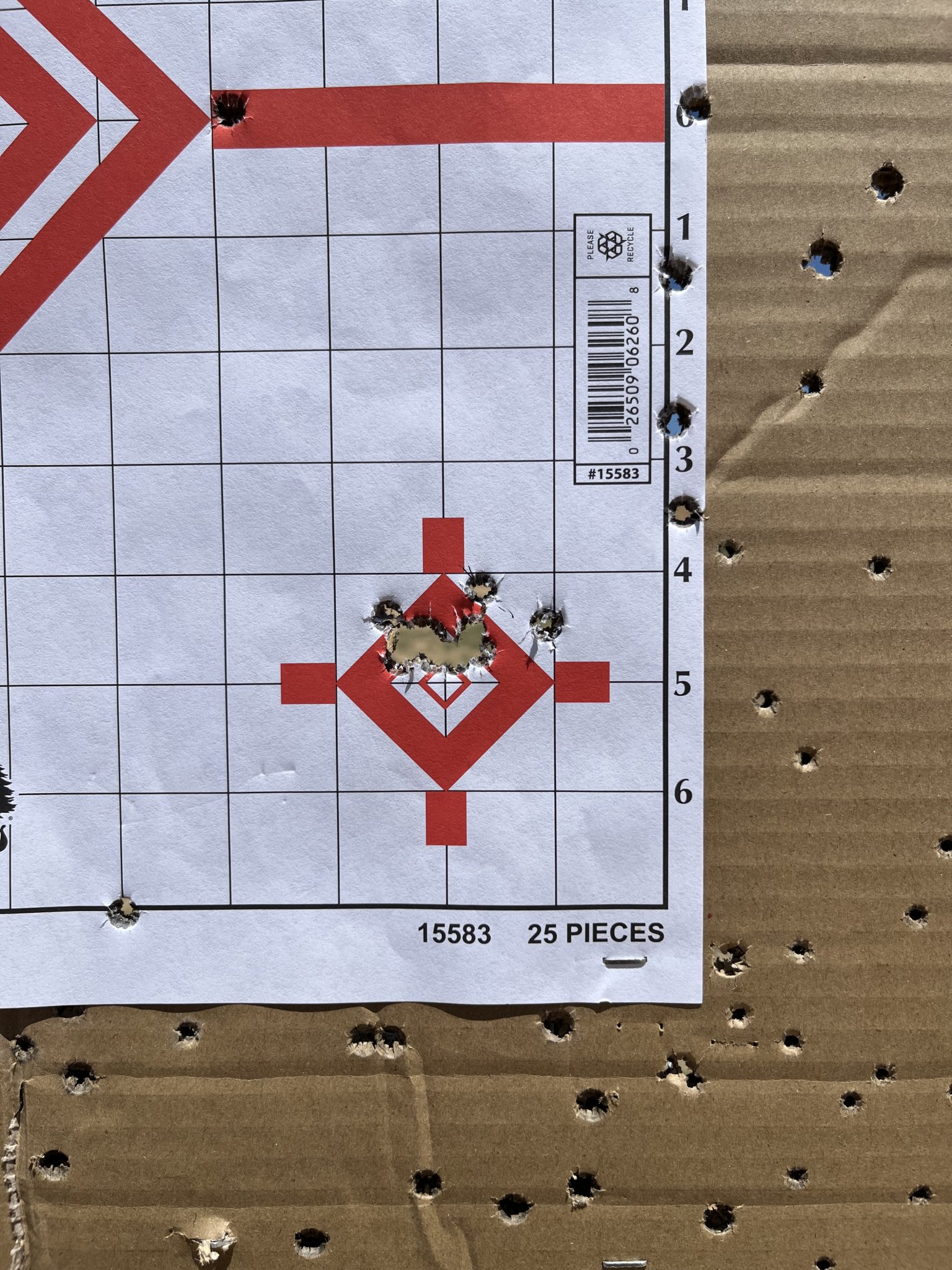

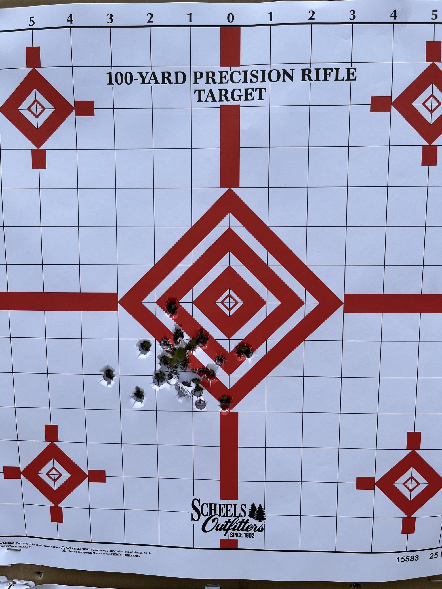

Could you post a couple pictures of your 30 round groups for a good load? TIA.
Reactions: memilanuk
Sure. Two of these are pretty good groups and the barrel I used was a pricey custom barrel. The other two look more like what I see out of standard priced barrels I’ve used.
Reactions: carbonbased
Kudos for actually shooting those, how many 30 round groups does it take you to do load development?
depends. I do a lot of research and modeling with GRT and quick load first so I can get a full understanding of velocity based on powder. Then I’ll do a ladder to check if that velocity model is accurate or not. I then load 30 to the target velocity and shoot a group. Most of the time I can get groups that are within my acceptance criteria first try. But sometimes it’s not that great and I may drop the speeds once or twice before trying a new powder bullet combo in the barrel depending on how bad the group is. I’ve definitely seen that the combo has a much larger effect on group size then powder amount and oal. (Not that those don’t have an effect, just not nearly as much as the combo). The powders and bullets that don’t do so well I use in other combos or just for practice. Best case scenario I have something I’m very confident in with 40 shots. Worst case scenario it may be about 100 shots to either find something I like or throw out that combo.

So I did do exactly that awhile ago. And I ended noticing when I plotted these group sizes and velocity distributions, that the 5 round groups were just noise. I didn’t see any trends, and I didn’t see any meaningful outcomes from the data. So even though there were so many different 5 round group loads, it didn’t really help, and actually ended up leading me down the wrong path to accuracy in some cases. So I decided to run some tests with a “known load” I had come up with using the 5 round groups, using larger groups like 30 round groups, and what I was finding was a couple things. First, the groups that I had thought were “accurate” were either exactly the same or slightly worse then the actual best group I had tested with using 30 round groups. And by exactly the same I mean that almost every group I tested using seating depth and powder charge for this particular caliber bullet barrel powder combination, we’re all statistically exactly the same. Second, that small changes in seating depth or powder amount changed things so little that the noise produced by other variables completely outweighed any benefit that those two things provided. And finally after going through like 2000 rounds for these tests I decided that that was an absurd amount of testing, for minute changes, that was completely unnecessary. If your doing benchrest or f class and you want to squeek every ounce of accuracy out of your rifle, then yah the small changes matter and the testing helps. But if your me, and I do prs sometimes, then that doesn’t really matter enough to spend that much money for testing. And I can use less bullets, and get similar outcomes as long as I use enough rounds per group
