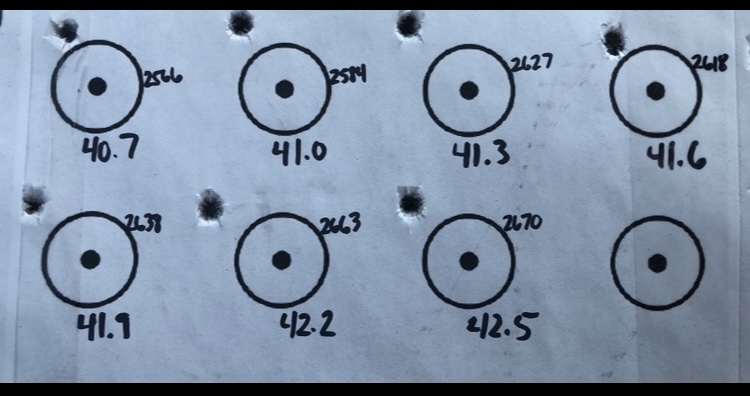

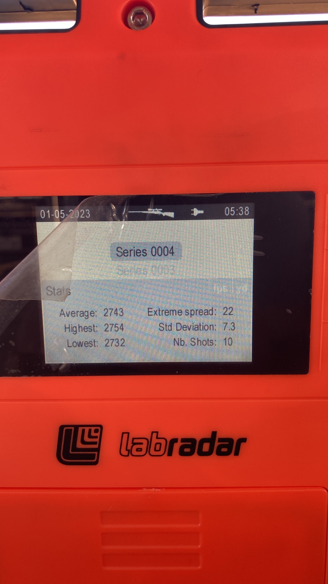

So I tested this stuff this weekend just to see if theres something to it. I dont think I learned anything just burned 60 rounds of components. Two 30 shot groups. I guess I should have shot 50 round groups then thy would open up. 100 yards 6 dasher hawk hill heavy comp.
Doesn’t this fit with the points about sample size? You and your rifle are clearly in the consistent 1/2 MOA group size. If you had only fired 3, 5, or 10 rounds you’re groups might be even smaller (i.e., 0.4, 0.3, 0.25, etc.) but statistically speaking that wouldn’t be a true representation of the load or rifle.
The images you posted include any variance that exists and therefore you could say those 0.6 and 0.5 MOA groups are the true capability of the load/rifle/shooter on average. Maybe this is where you were going. Anyways, nice shooting 👍🏼

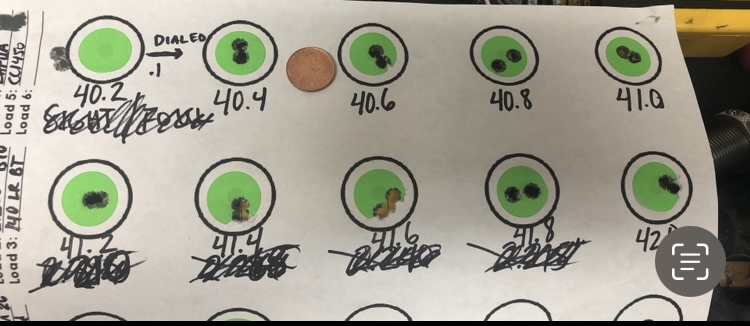

Here was my success story, I was loading for the Valkyrie, I knew I needed speed so I loaded it for 2950+ and by chance landed right at 3025fps with an SD of 5....

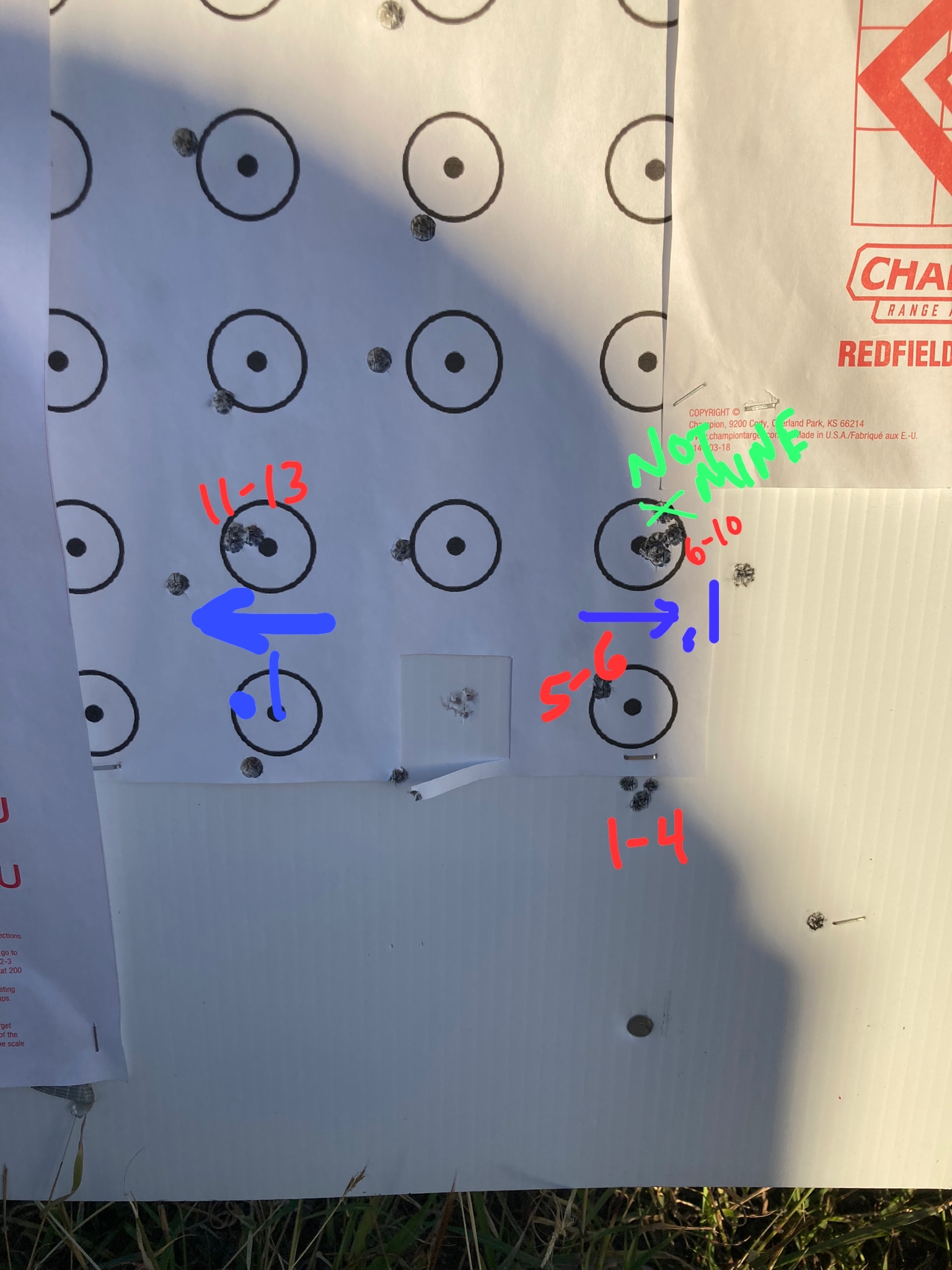

They lumped BR and F-class guys into the mix on the first podcast and in the second they clarified they were talking about steel plate shooters.
These large volume tests are seen across the country, every weekend, in BR and F-class. (Maybe I should go watch some time so I'm not assuming). Is the score board full of people with good luck? Are they playing stupid games filled with delusion?
What are they doing differently than we are when it comes to barrels, brass, bullets, powder etc.. ?

100 yd BR specifically because at 100 yds is where most people are doing their load test so most applicable to this discussion...they have very specialized equipment...wind flags...adjusting aim/firing cycles based on conditions...some change loads constantly on the fly to achieve the results for that one single time frame...etc
they are doing a whole variety of things to achieve what they do, that ive never seen anyone doing a load work up @ 100 yds do outside of the BR arena, and arent even feasible for a field shooter to apply
and once you add shooter adjusting for guesstimated conditions, the best results are no longer laid solely on the rifle/load...its who had a good enough load and handled the conditions the best
Bartlein Frank laid out results from the higher end of BR matches in some above posts...those are the results for having every possible advantage tilted in favor of accuracy...start removing those things...flags, reloading prep, highest end rifles, experienced shooters, etc...the best expected results are only going to get worse and worse

I have so many random images on my phone from years ago can’t remember what all is from what lol but these are 2 examples I could recognize
These are from when I was still testing random stuff, before I finally settled in on the 10 shots/0.5gr apart method I mentioned above that I have been using ever since…but they’re similar enough to it...these were part of the steps that lead me to that
Pic isn’t labeled but I can tell from the charge/velocity range this was a .308 175 Berger in lapua brass, most likely varget…probably a Krieger barrel

Green dots pic is a test of a new (at the time) 6.5creed, 140 Berger long range target, .050” off lands (picked randomly), lapua brass, and h4350…a bartlein barrel
August 2020
Both sets are approx 2 grain spread…if I would have aimed all the top pic rounds at the same dot…it’d be a tiny 7 round group
Bottom pic I’m pretty sure those green dots are 3/4” iirc…20 rounds, 2 grain spread, never would have missed it minus the zero offset from the 130 hybrids I was zero’d for to start…account for the 0.1 I dialed after the first 2 rounds, how small would that 20 round group be? I’d be fine with it
I don’t remember what I loaded on the 308 because I don’t have that barrel anymore, but the 6.5creed, it’s still on that rifle and I just shot it yesterday…had to rezero because I removed the brake that was on previously and replaced it with a can…I’ve been runnin 41.7 grains because that put me right at the 2750 fps I like to run a 140 from a 6.5creed
All Rounds are numbered in the order I shot them (6-10, should be 7-10, marked it up wrong)…turned the chrono on after the first 3 shots because barrel was clean/oiled, been sitting in the safe
Both rifle and ammo haven’t been fired in ~2 yrs before yesterday, ammo has been loaded the whole time on the shelf
And of course, my zero is right in between 2 clicks lol screw it
In case anyone wonders, I was just using someone else’s old target they left up so we didn’t have to call the range cold for me to go put up my own, I knew I was only adjusting my zero for the can and wouldn’t be there long …that why it’s stapled over and has someone else’s Dot drill practice all over it, blue writing are the windage adjustments I made between dots
