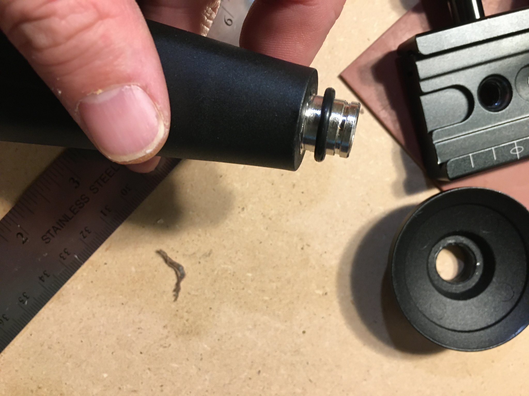

So a cheap and quick mod to help the head be more useable is to remove the handle (requires removing the little clip seen in the photo) then place a #8 O-ring over the shaft and reattach the handle. I just left the retaining clip off. While this doesn’t make everything “ball bearing” smooth, it does improve the head by providing the ability to apply levels of friction to the movemeNt of the head before locking it down.

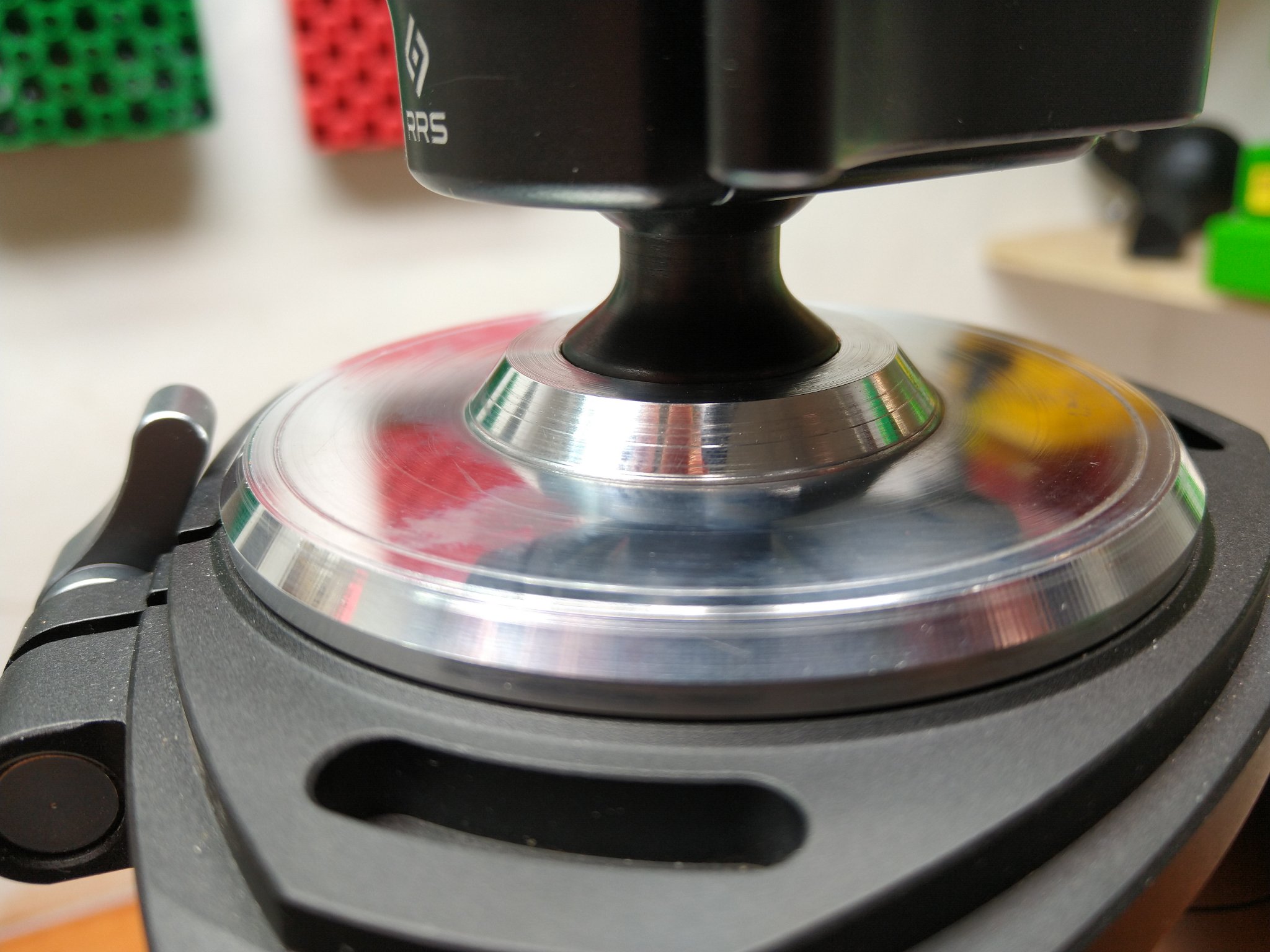

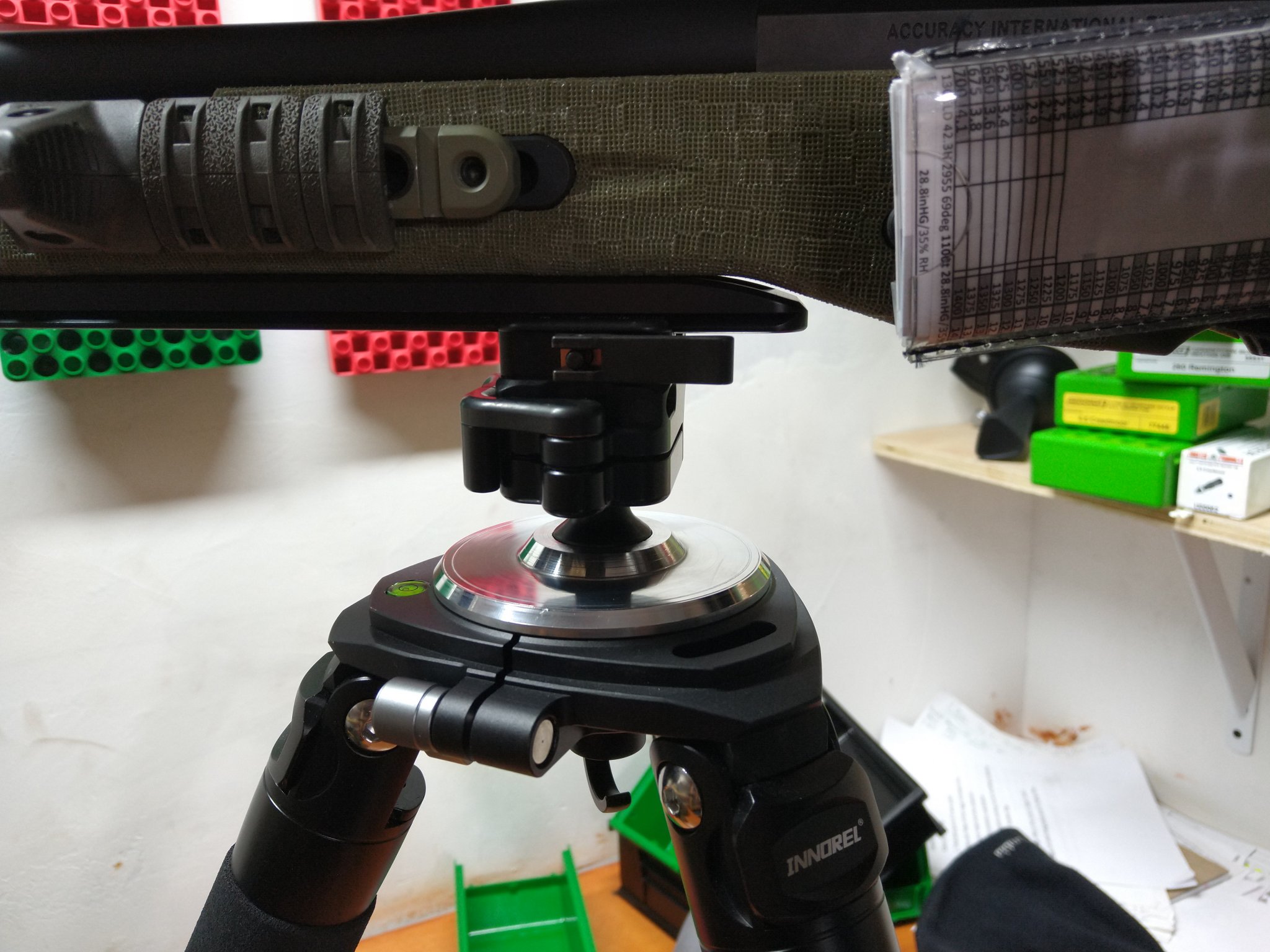

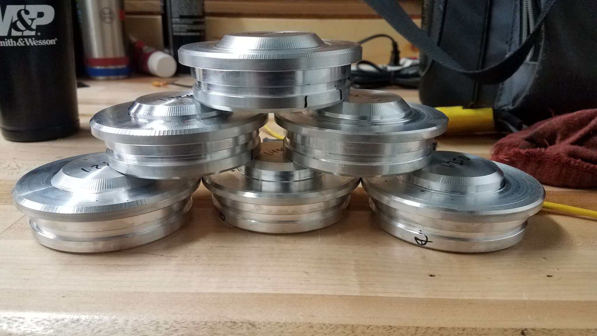

@cdeiglmeier You have two options for using the Anvil with the RT90C/Comp 40/40 Mike Mike:
1. Thread the Anvil onto the standard plate with loctite and hope for the best when panning counterclockwise because you could end up loosening the Anvil. It's not like you're damaging anything. You'll just have to tighten the Anvil back down and maybe apply another drop of loctite, but if it happens during a match, you're essentially stuck with it until you can fix it.
2. Buy the plate from Midwestoffroad, tighten the Anvil down onto the plate so that one of the holes on the Anvil base aligns with the holes in the plate, toss a set screw in, and now your Anvil is securely fastened to the base without any concern that it'll break loose

The current batch of Anvil Adapters have been spoken for via going threw my old messages. And individuals have been contacted.
Thank you
Bnanaphone
LA260
Canezach
Cdeilgmeier
Greyswandlr
Waiting on Russ for the last confirmation. But there ready to go F&F PayPal or can add fees 80$ raw with hardware or 90$ carakoted black ( delays shipping)

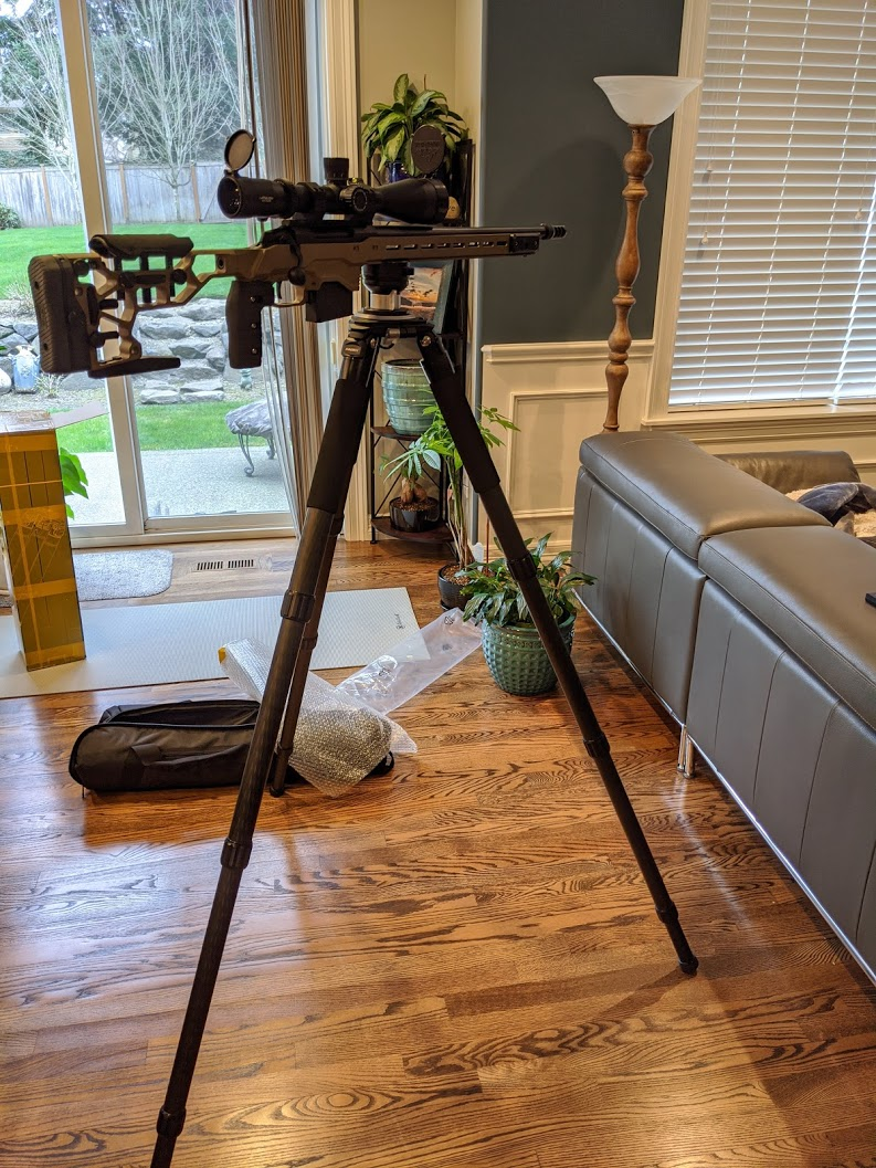

Weight of Tripod + The center piece w/ hook = 5.8 lbs. Weight of RRS-TA-2U-LB = .75 lbs. Total weight 6.55 lbs.

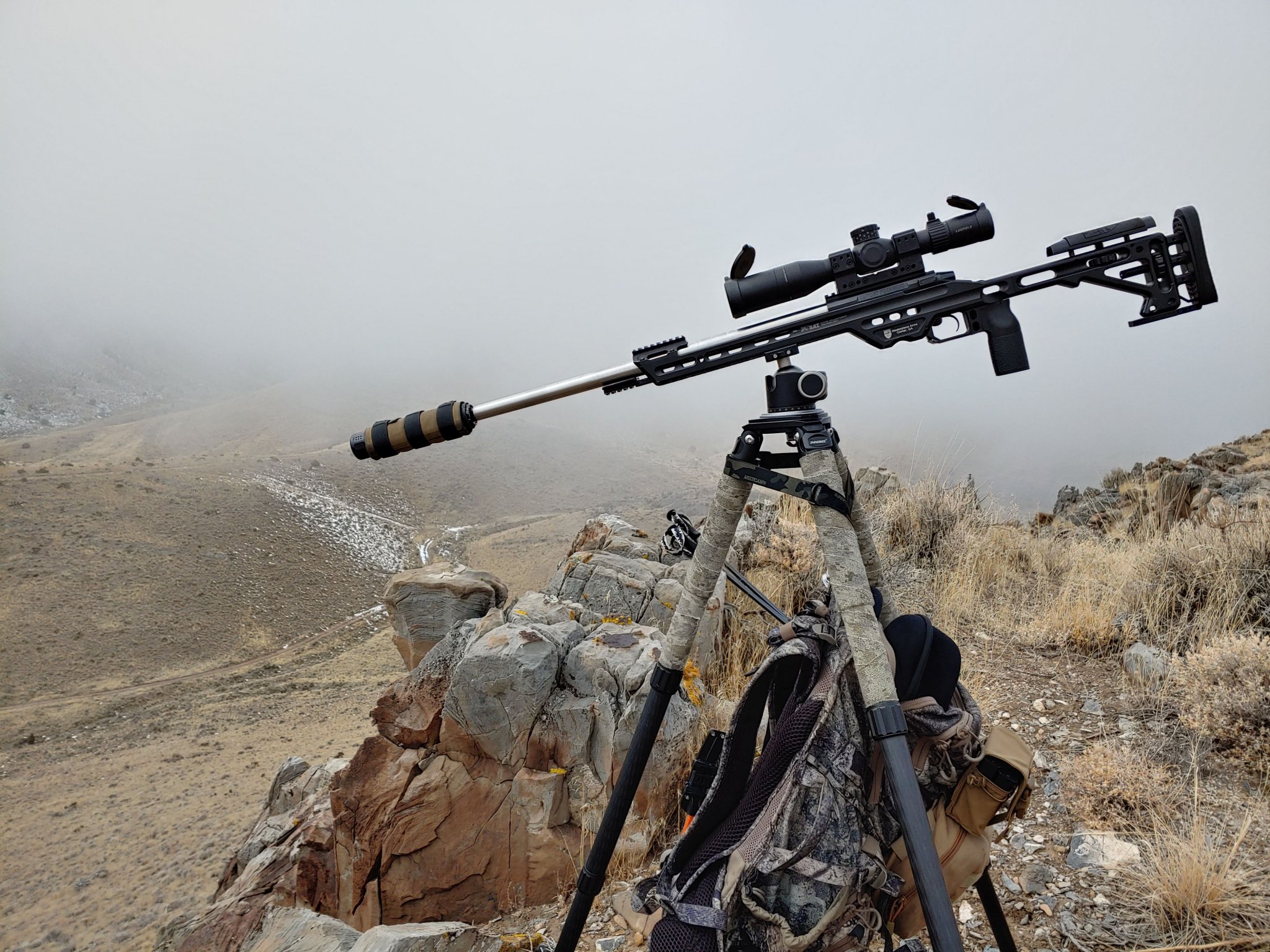

I've had my RT90C and Desmond DLOW-55 for 5 months now. I've used it at least twice a week in the field since I bought it. I thought I would just update the group that it's been working w/o any issues. Each time it is used, the legs are extended and collapsed and I haven't experienced any slipping at all. So far so good.

This thing is Solid! Fits better than the factory plate. Verry happy with the plate. Awesome job @midwestoffroad !!
