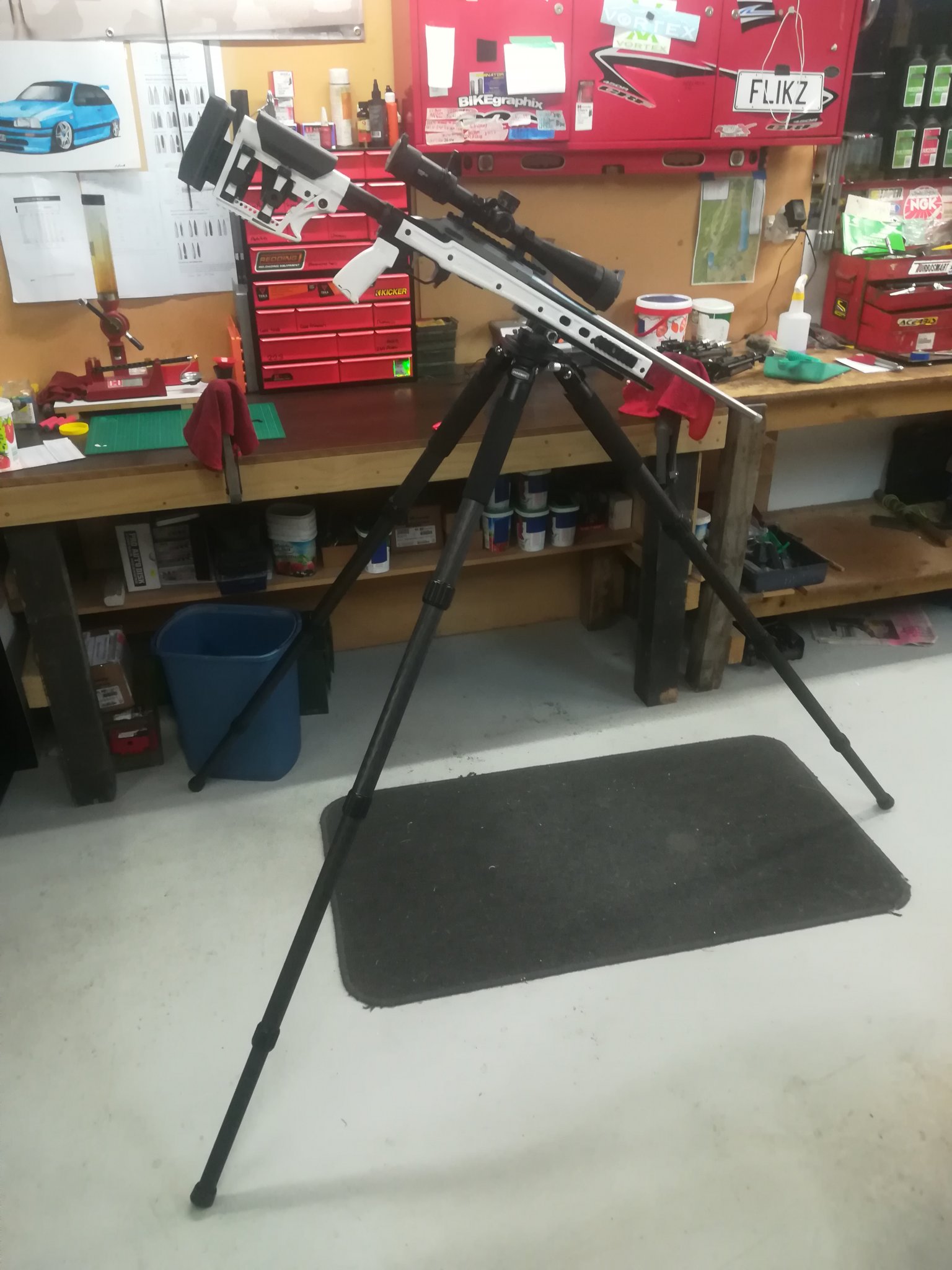

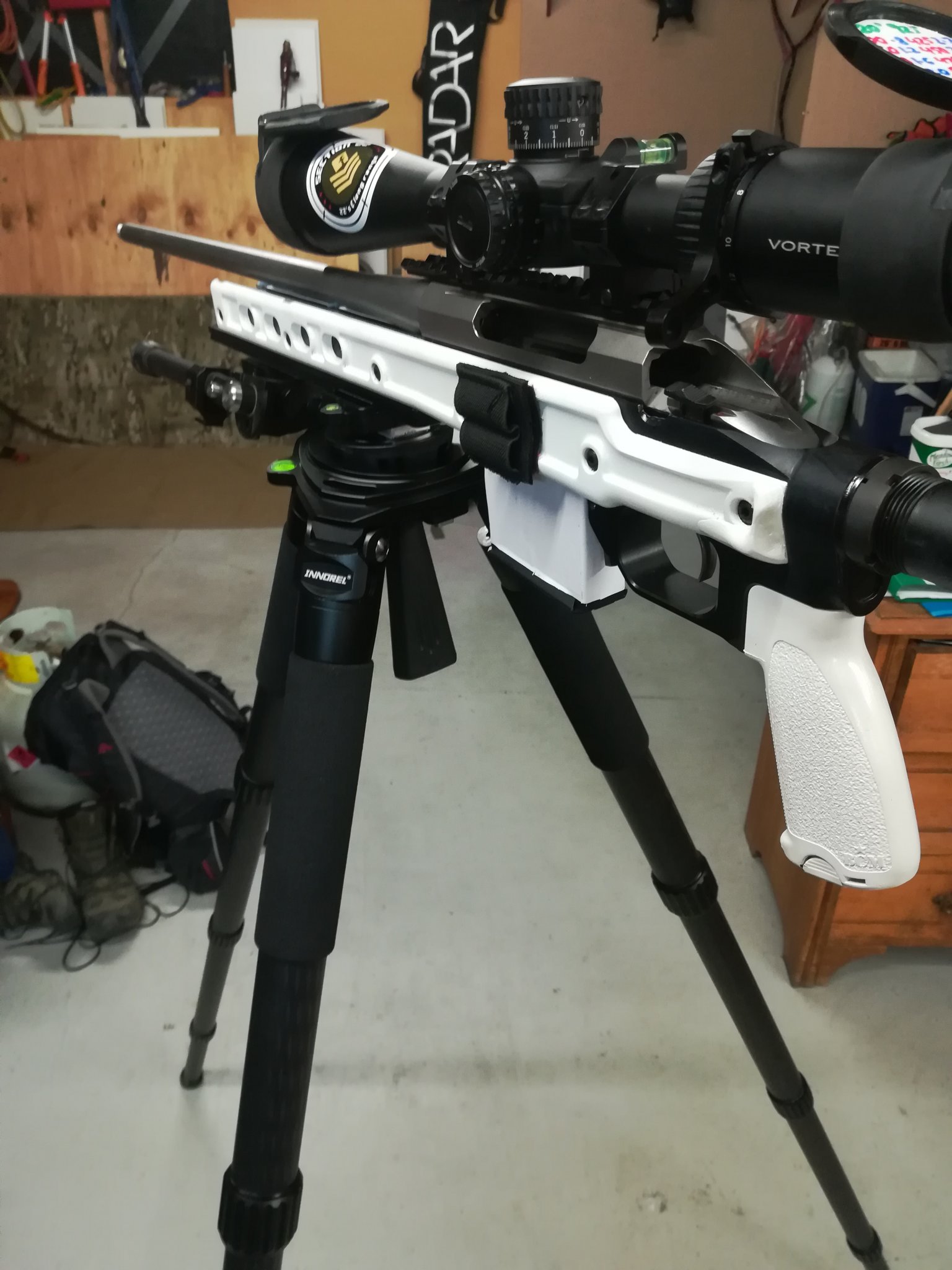

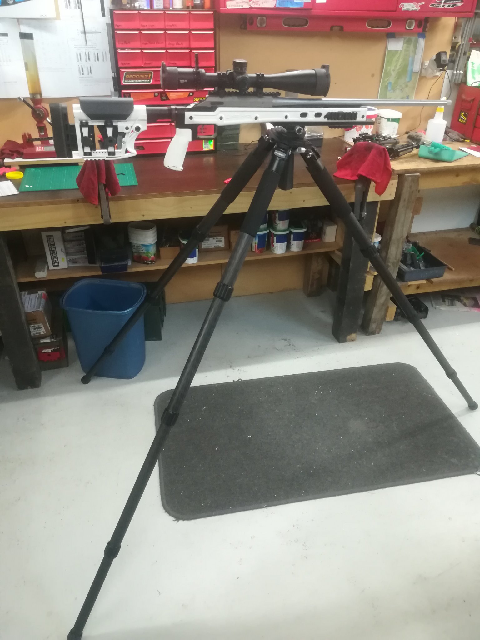

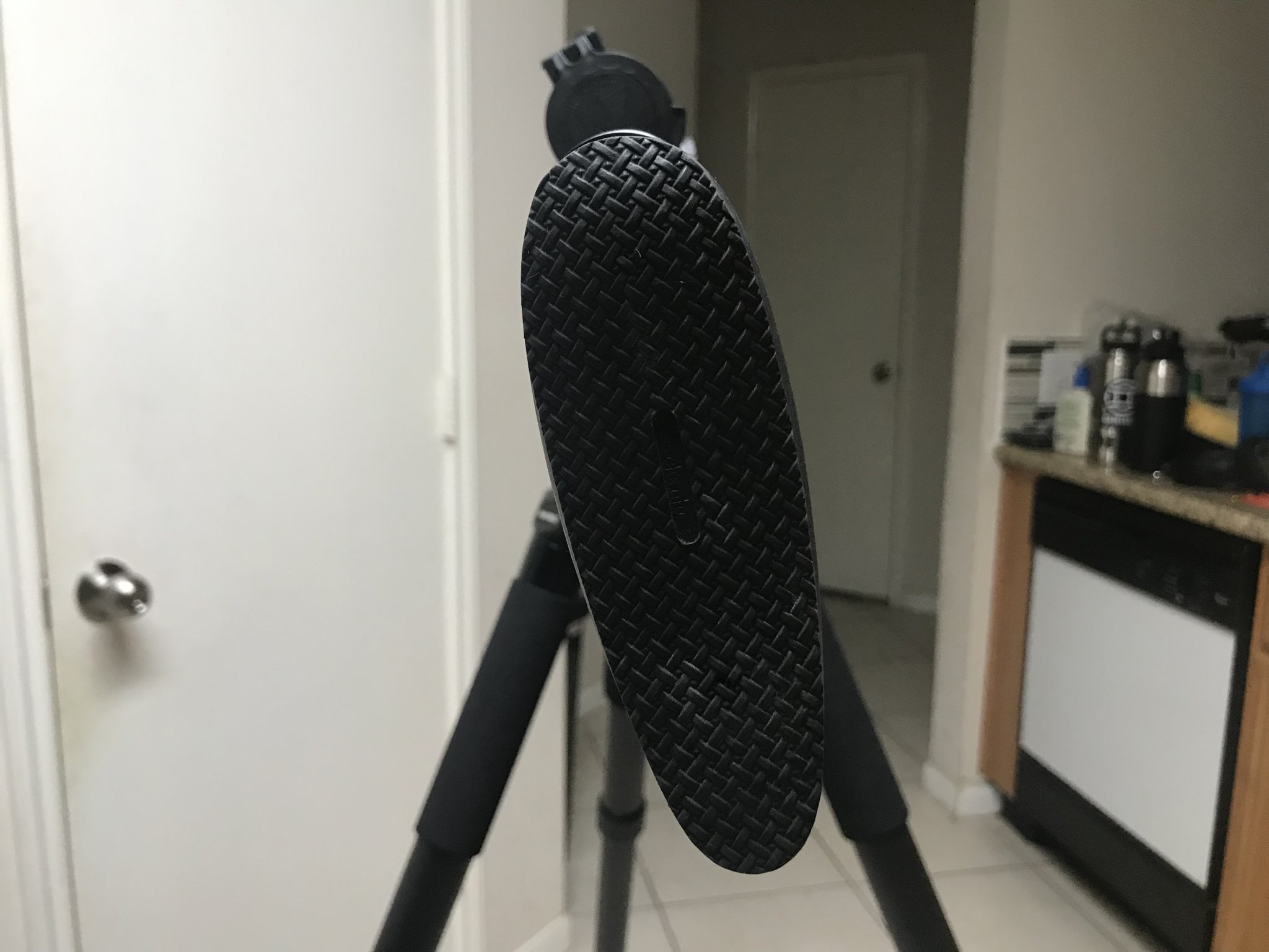

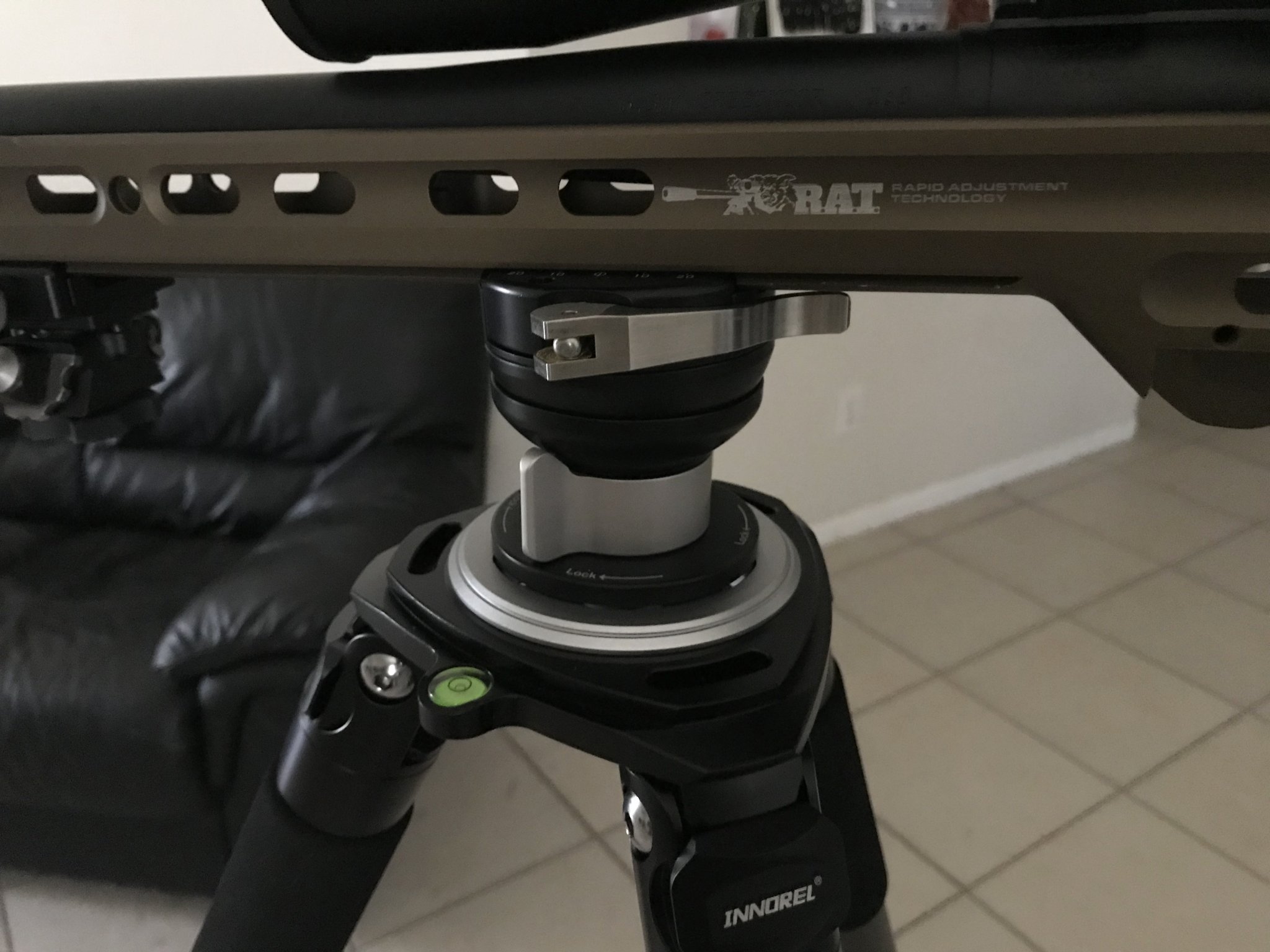

Couple of pics of the rifle setup on rt90c. One pic with the front leg out longer for more downward adjustment. Can sit at 0deg down to about 28deg just buy pushing front leg out and makes for a wider footprint.

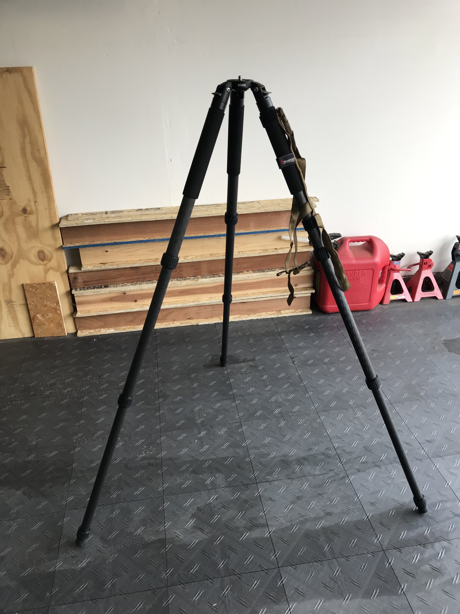

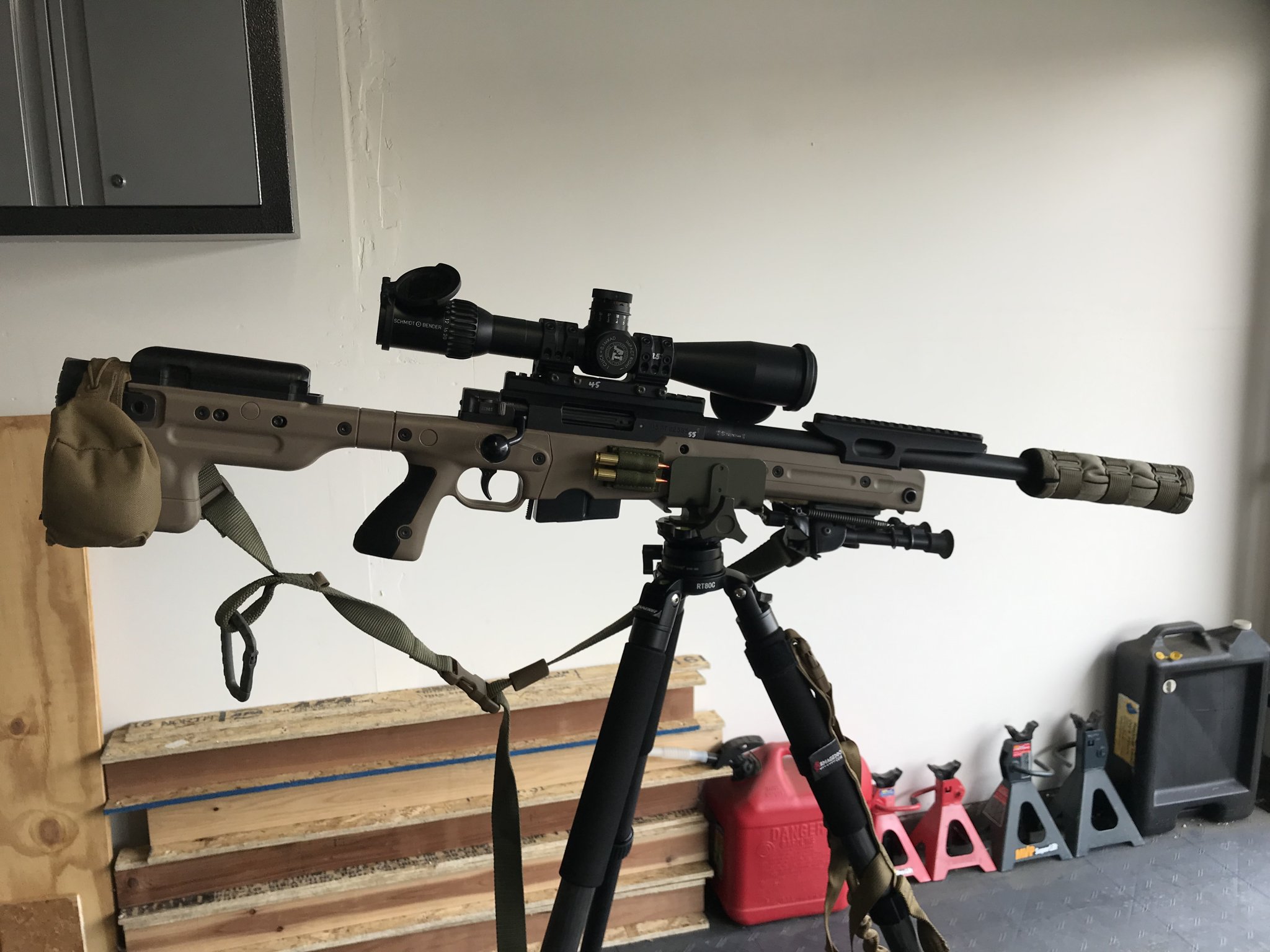

I am using the RT80C For glassing out of my front porch and its working quite well. I built a rifle vice for it, once we get some warm weather i'll give it a run.
So i've been running a Manfrotto 055XPROB aluminum tripod and XPRO ballhead for a few years, PIG saddle to hold the rifle. Application is usually event overwatch from rooftops holding a 19 pound AIAT rifle. The Manfrotto tripod and ballhead weighed 6.4 pounds and I felt the ballhead was costing me some stability. I wanted to try to save some weight and go to a leveling base for more stability.

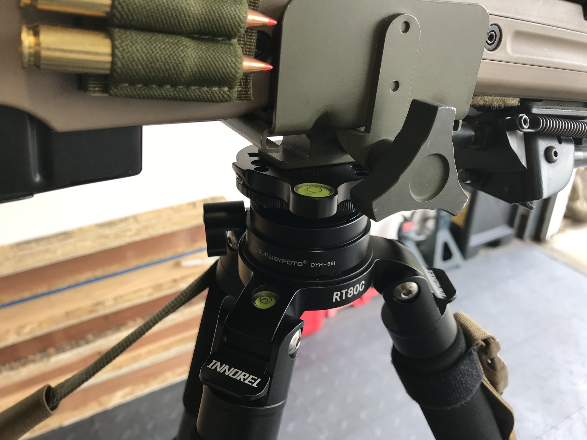

The Innorel RT80C and Sunwayfoto DYH-66i leveling base is at 4.3 pounds, saving 2.1 pounds. This is a pretty budget setup for $189 tripod and $80 leveling base. I think the RT80C is good to go. Legs lock up tight with a quarter to half turn. The two top sections extended is a perfect height for 5'8" me to shoot at a slight downward angle. Tripod is very stable and I've put my entire weight on it with no problem.
I'm not quite happy with the sunwayfoto leveling base, however. The panning is good, but lockup requires cranking down the knob really hard.
With the imported CF tripods, you can definitely save some money and not give much up. I'll probably end up going RRS for the leveling base eventually.

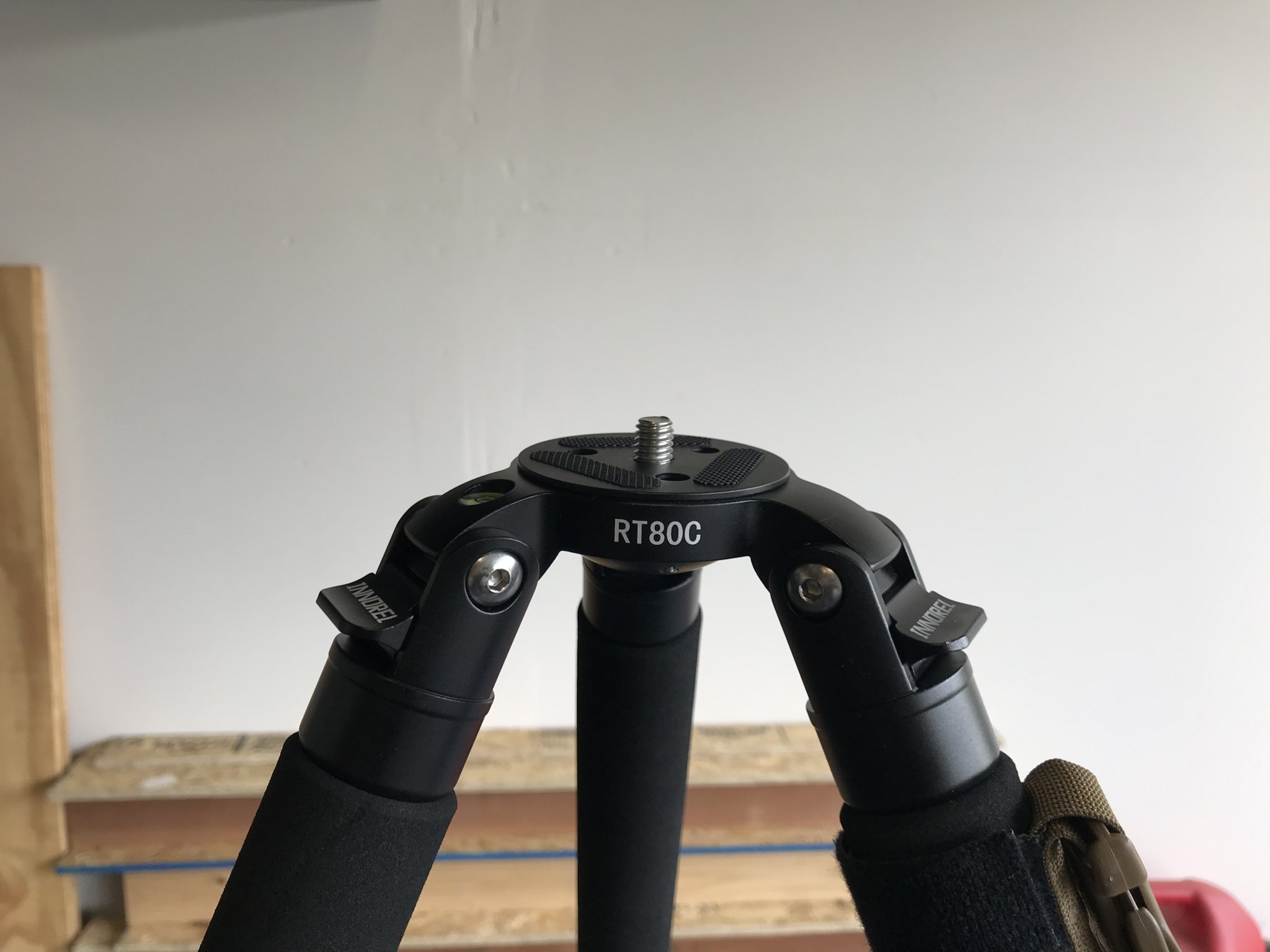

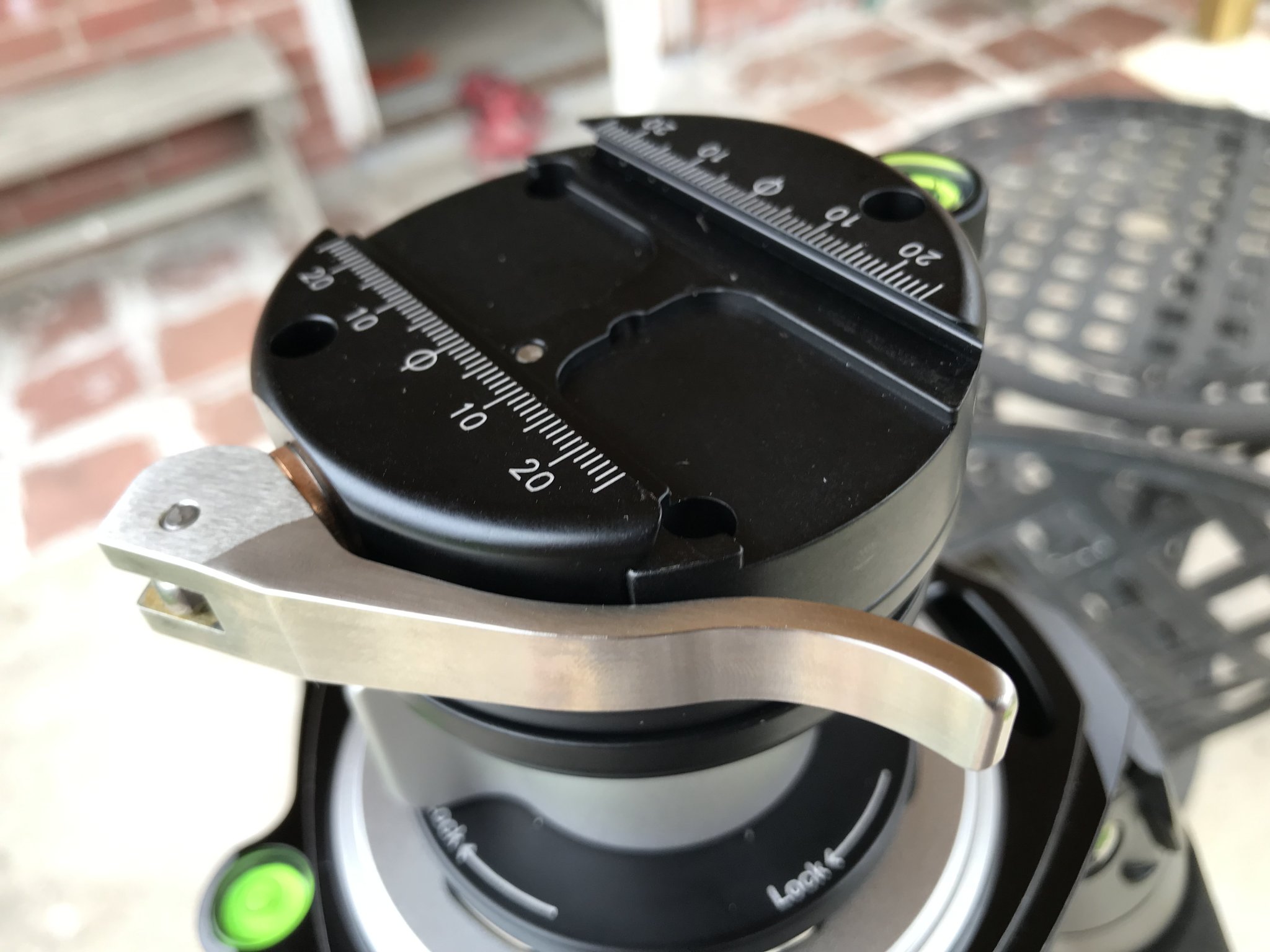

I bit the bullet and tried the 80C, arrived yesterday. The legs do feel pretty thin compared to some of the more expensive carbon tripods I've used but again it's $180 too. It was actually lighter with a bit larger diameter legs than I expected, pretty impressed with it overall. Time will tell, I'm sure it won't take abuse like some of the beefier models costing 5x as much, but I don't need a camera/spotting scope tripod to take much abuse. It's quite tall, if I was to shoot off it I doubt I would even need the thinnest leg section extended. If I was going to shoot off of it I'd probably want a third leg position, as this only has 2, but not an issue for my use. Legs seem to slide easily, and loosen/lock with one twist.
I also was not impressed with the included leveling base, at least on mine it's either locked up, or too loose. Doesn't seem to have a good middle ground for tension, however I've never used a leveling plate before so maybe that's par for the course. I expected (again perhaps wrongly) that the better ones could be set with a tension to hold the item in place but still move smoothly much like a ball head. This one definitely will not do that and to be honest I didn't expect it to. It would be interesting to see how well it would perform with a Anvil-30 on it and the fixed plate.

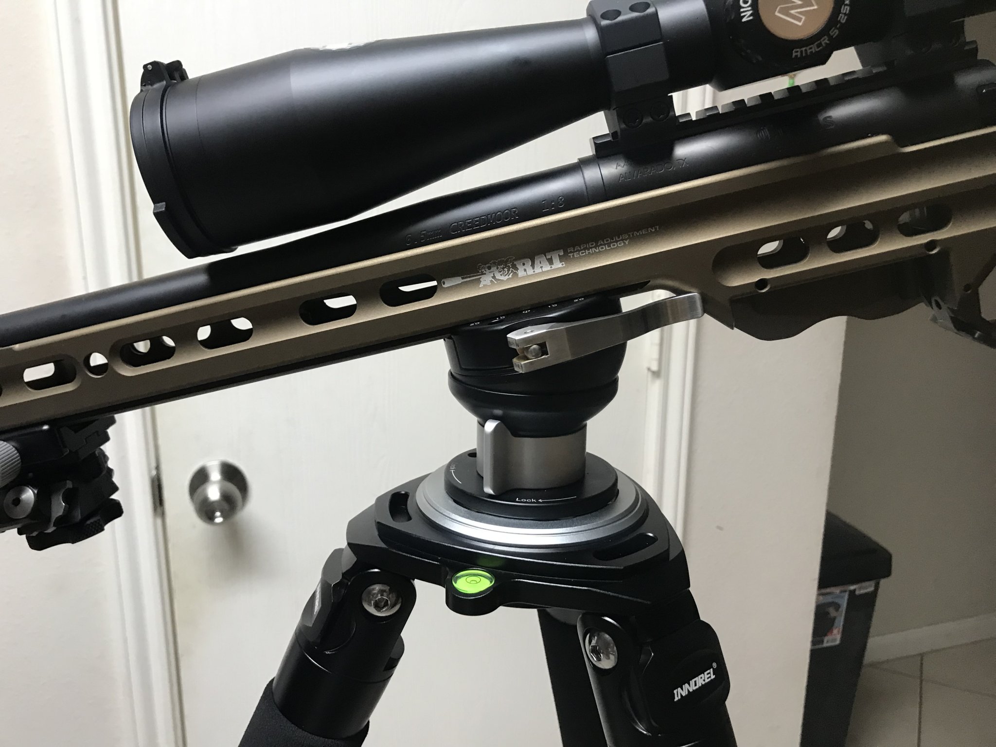

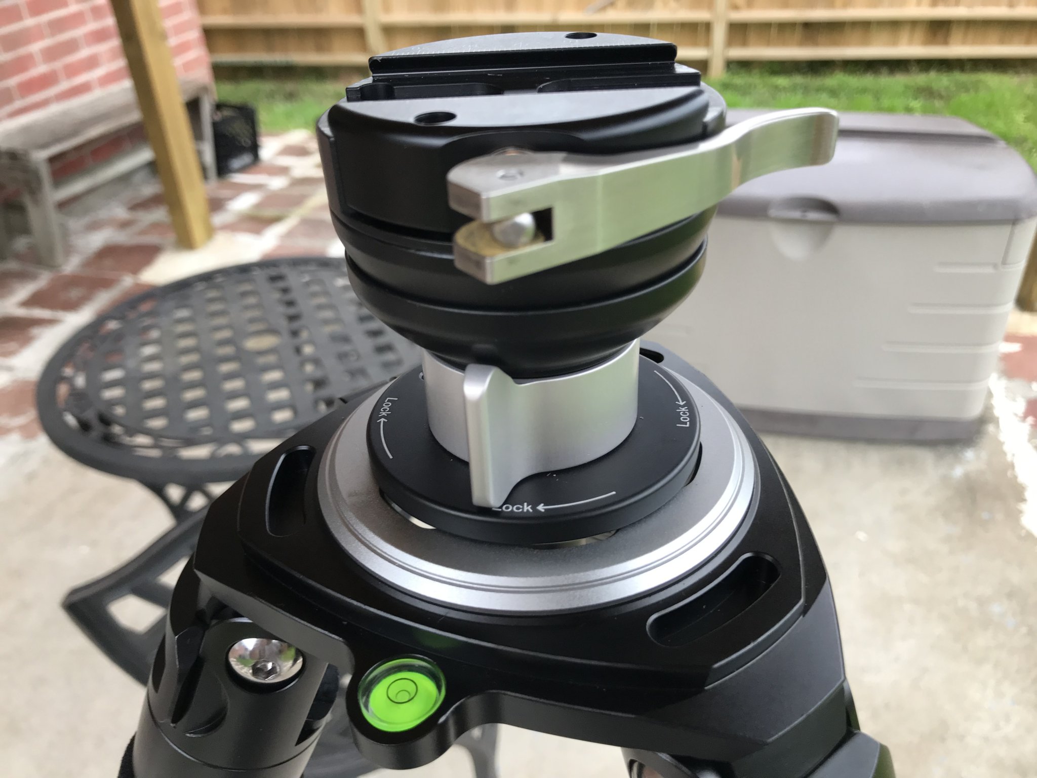

Got the RRS universal leveling base in and installed it on the RT90. The set screw on the RRS didn’t match up with the RT90 base so I had to use the two set screws on the RT90 base and drill two dimples with a drill press in the bottom of the RRS leveling base because the timing was slightly off from contacting the RRS base(it’s milled out on the bottom) when you screwed it all the way down, so it is backed off probably 1/10th of a turn from all the way tight, no wobble. Other than that it works and functions good.
Can you post a pic of the two dimples you drilled? I'd hate to bugger up a $300 base. Do you even need the set screws?
I’ll get to tomorrow evening. All I did was screw down the leveling base as tight as possible then back(time it) it off until you can screw in the set screws and it will contact the bottom of the leveling base, because the bottom of that base is milled out. When you screw in the two set screws provided with the RTC90 they will leave a mark in the bottom of the leveling base so you have reference where to drill the two dimples. Remove the leveling base when you drill the dimples so you don’t damage the threads of the RTC90 base. I used a little bit bigger bit than the size of the set screws. You Just drill enough depth so the set screws can go deep enough to bite into the leveling base, just don’t go to deep to where you don’t have much of the set screw left in the RTC90 for strength. This prevents the base from unscrewing when you tighten and loosen the tension throw. Make since?

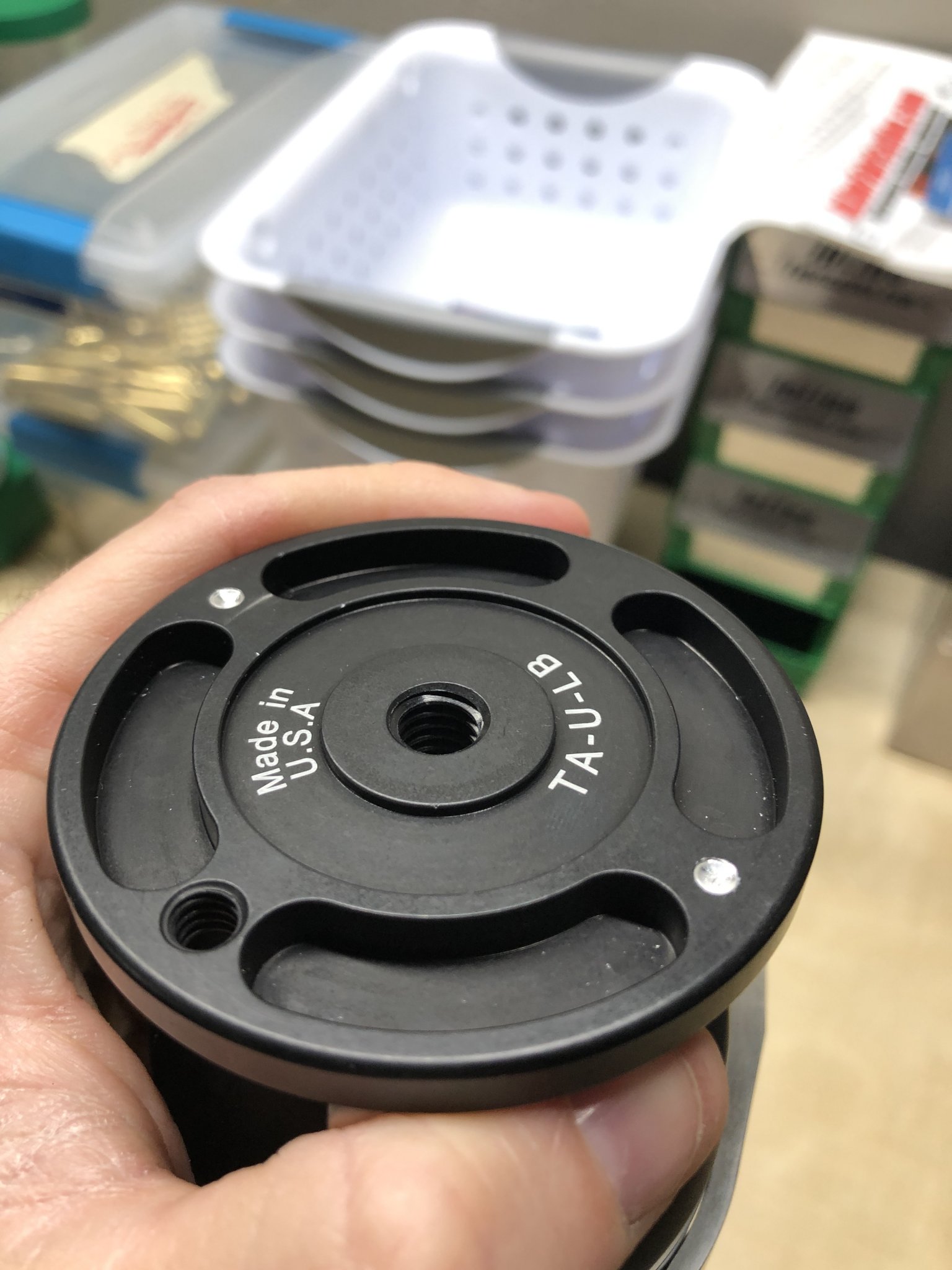

Found a used "condition 10" TA-U-LC at B&H for $239 shipped. Hard to pass up on that price when they are $300 new. I hope their inventory is accurate because there was only one available. I'll update..
Edited: Their inventory was accurate. I got what they had on the shelf. Should be arriving Thurs.

The “condition 10” rated used RRS base came in. It looks brand spanking new. Could have easily passed as new.
