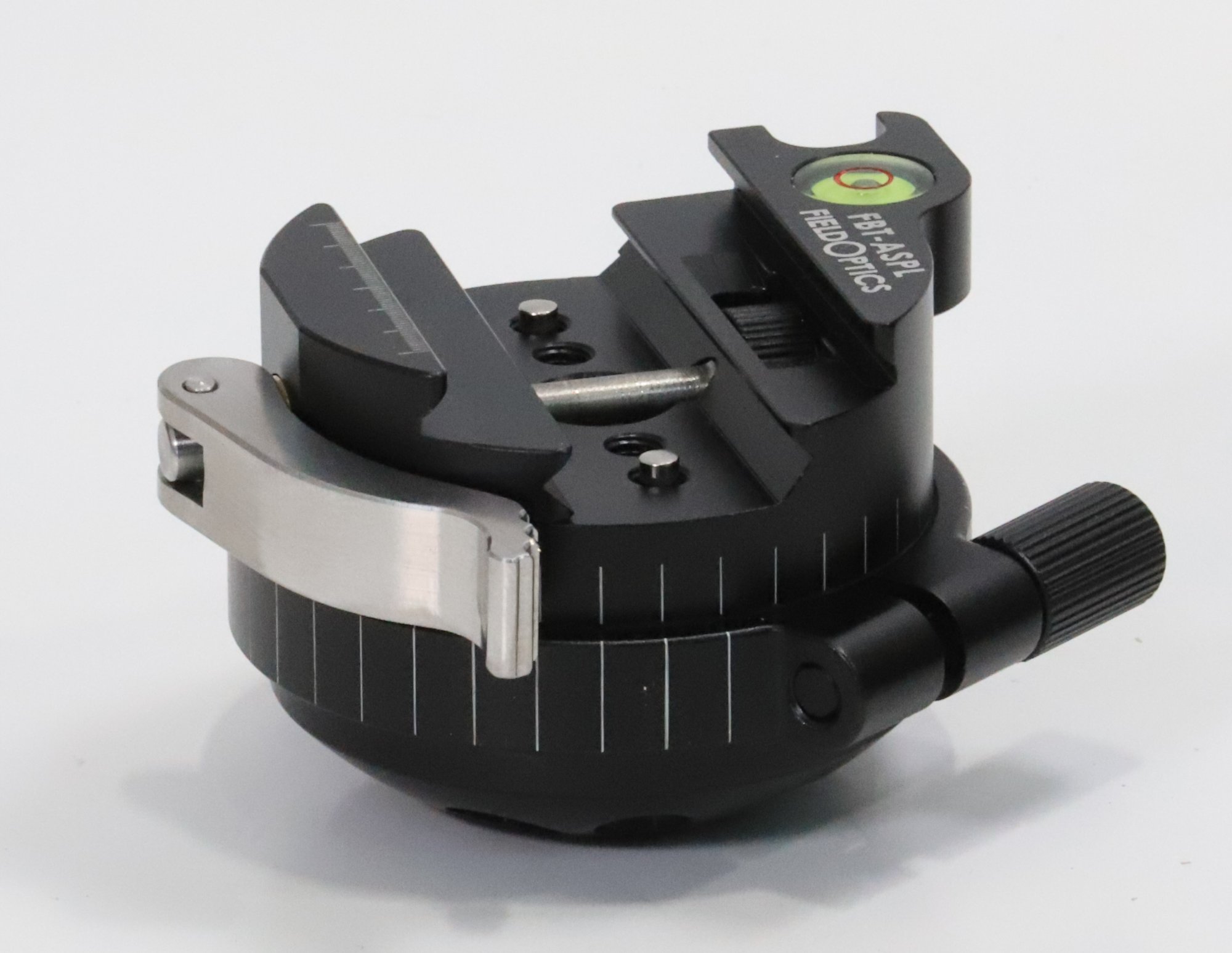

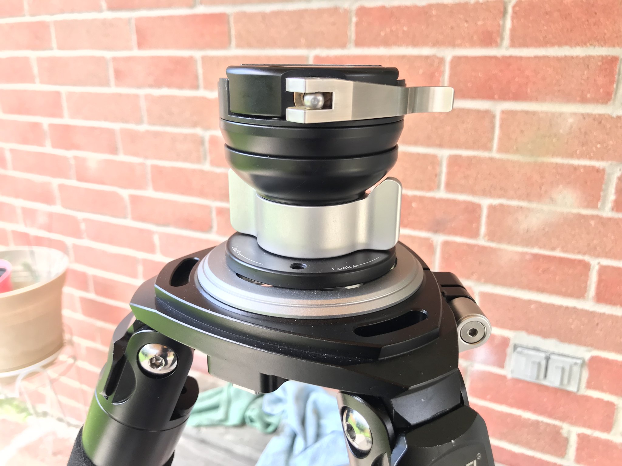

I’ve got a rt-90 on the way. I was wondering has anyone tried a ARCA SWISS-PICATINNY LEVER CLAMP WITH PAN AXIS from field optics? Do you think this will work with the 90? 960DE21A-E718-4FCB-9DAD-0FF07622CE85.jpeg

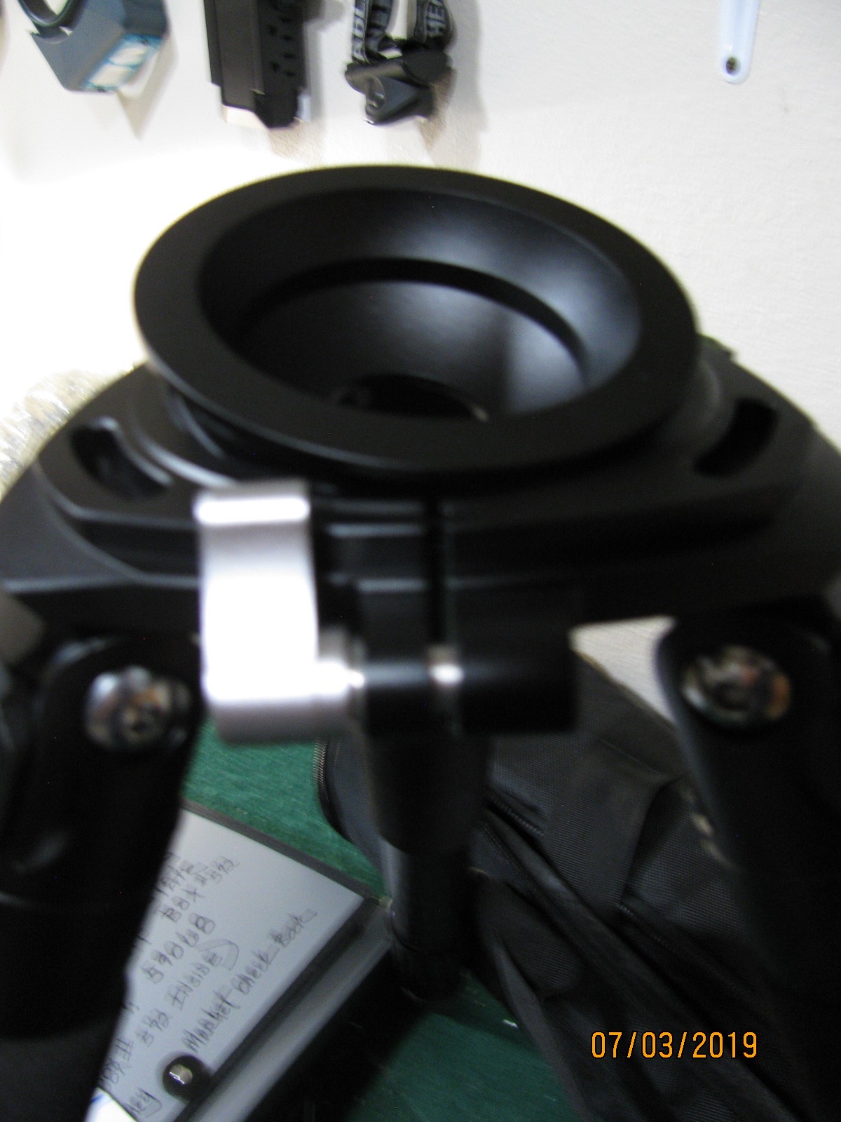

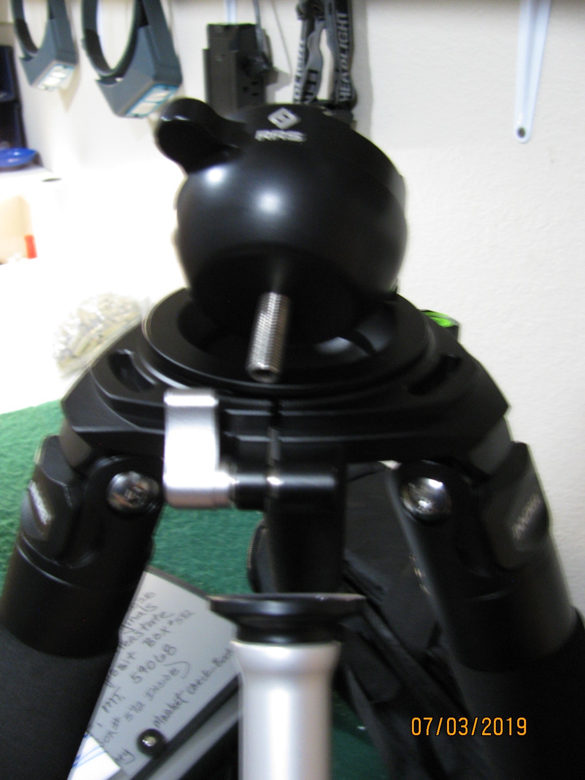

So I messed with the video bowl that came with the Rt90c. I don't know a damn thing about any of this video equipment terminology up front. The assembly is basically a handle with a long screw running through the center that applies pressure when tightened to the bowl insert on top, and the cup on the bottom half, compressing both pieces in to the bowl to tighten, then by loosening the tension on the handle, allows movement. I just sprayed a little dry lube in both halves and the difference was pretty impressive. There is actually a middle ground between locked and unlocked now. I would even consider it to be usable if it weren't for the fact I don't want to have to relube this thing every other use. The cups are not concentric. After sitting around for an hour playing with it, there's uneven wear. Also, the coarse threads on the center screw probably weren't the best choice for anything capable of fine tuning. This weekend I'm going to try rethreading the bottom half of that center screw to a very fine thread, and putting a different insert in to the tension handle, as well as a rubber spacer to try to create some way to manage to supply a little pressure to this assembly without locking it

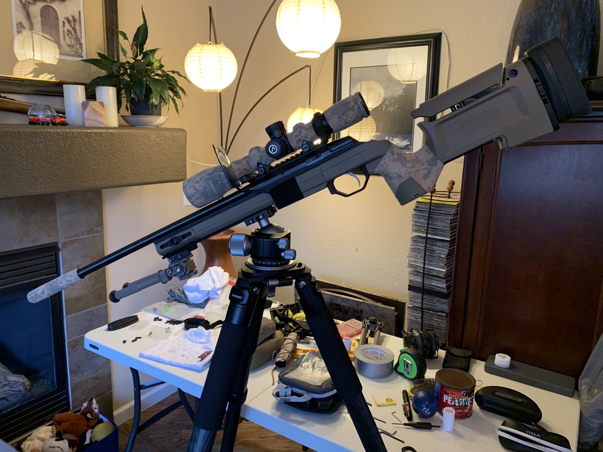

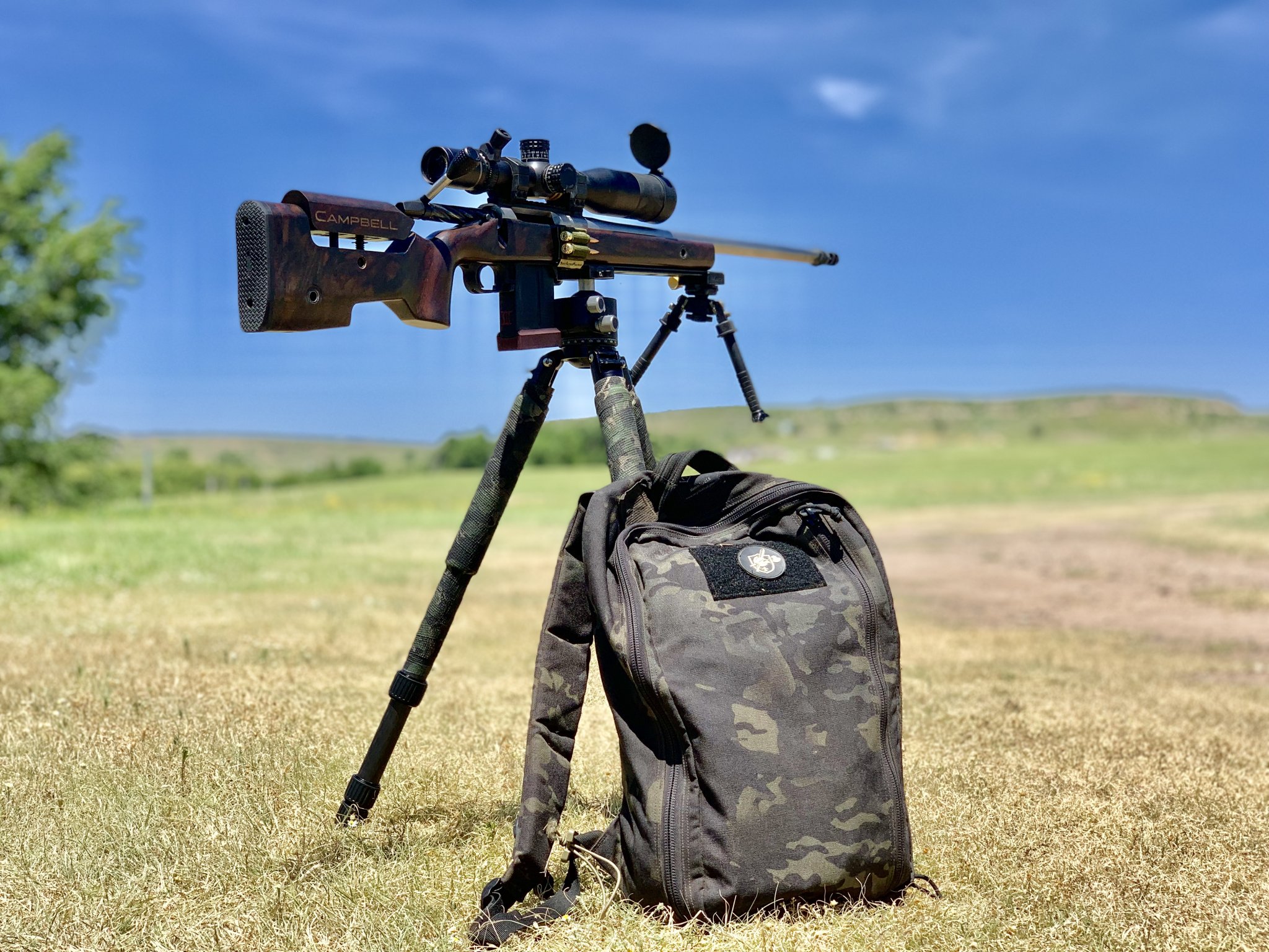

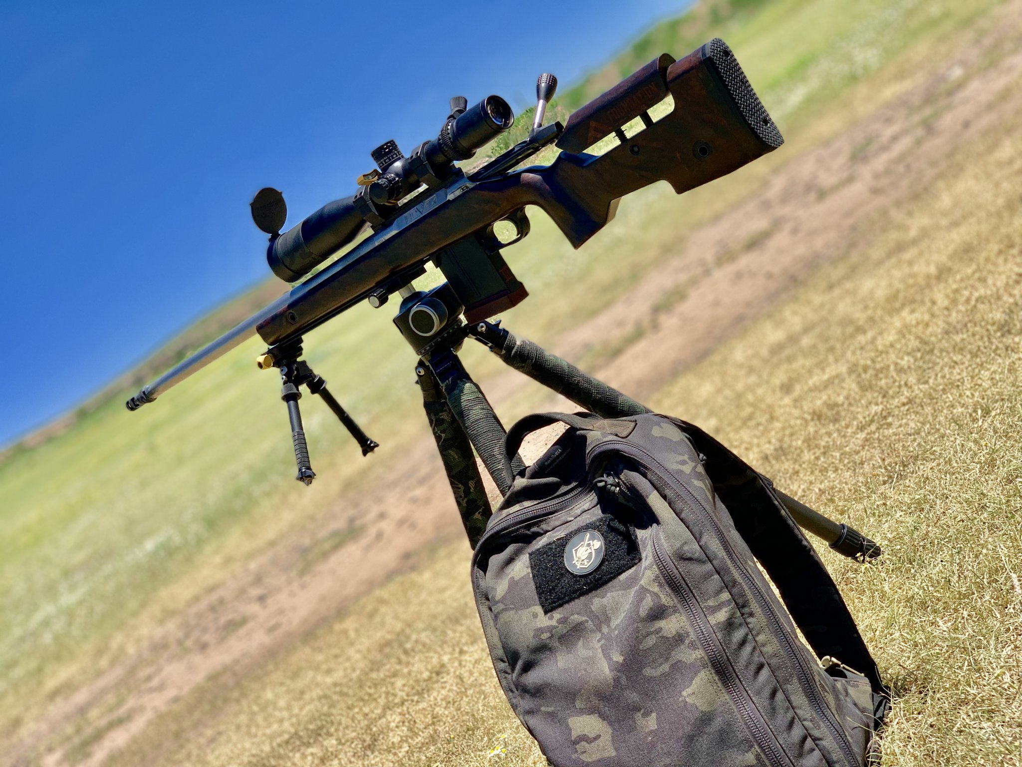

Got the RT80c and DLOW-55 yesterday. Took them out to 530y today. Worked well, still need lots of practice. Can’t upload the videos.

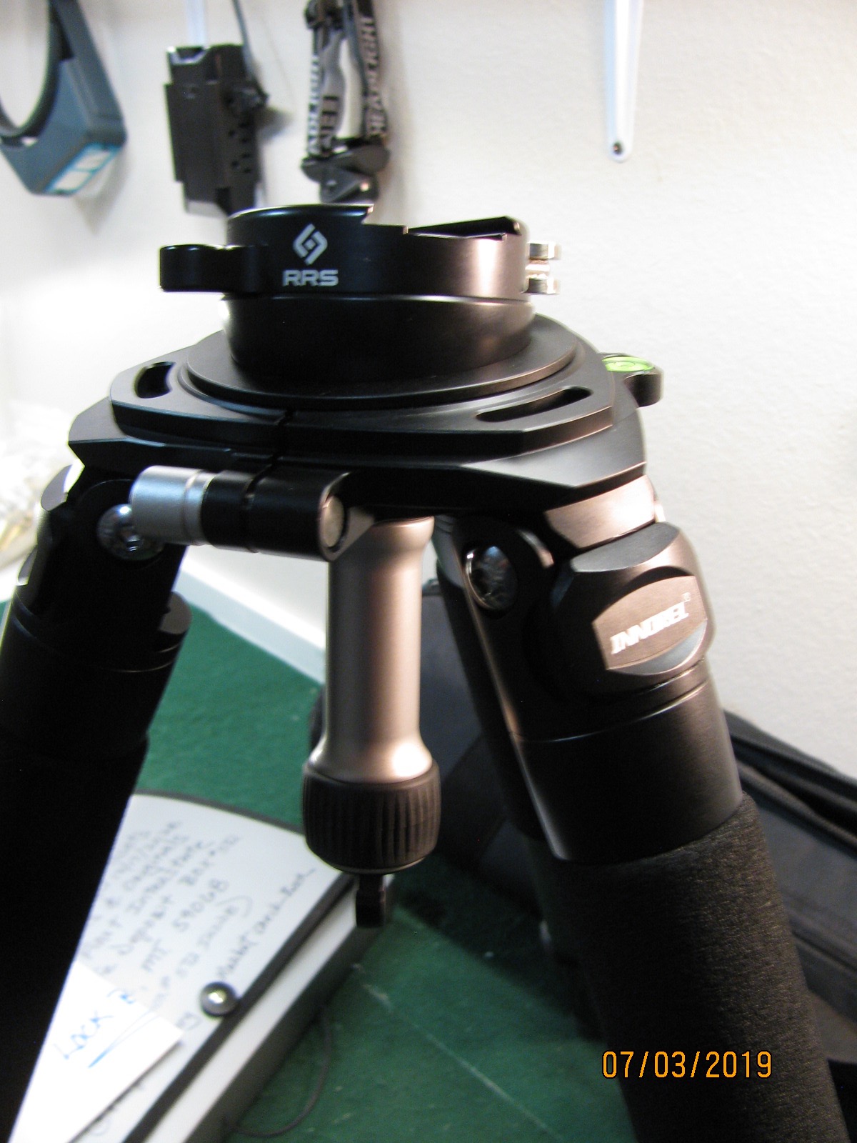

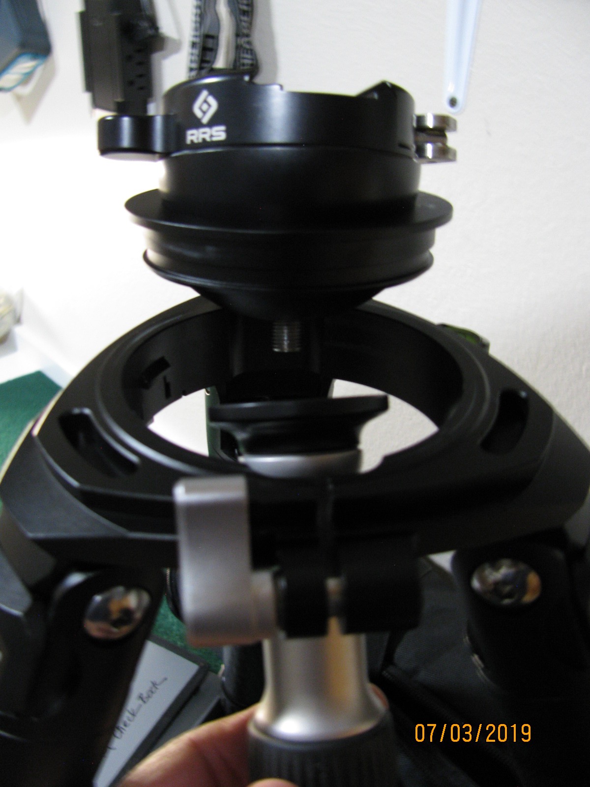

I have a RT90C and use a RRS TA-3 leveling base with it. Much better than the one that comes included. You use the include RT90C adapter so that the TA-3 works in the apex opening. This gives you the more refined control provided by the TA-3.

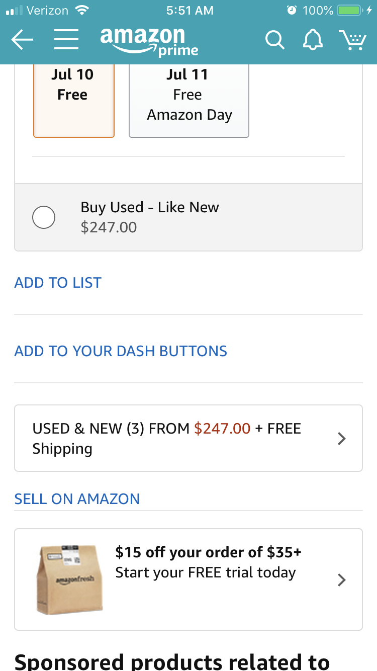

Carbon Fiber Bowl Tripod,INNOREL RT-90C Professional Heavy Duty Camera Tripod Ultra Stable Top-Level Birdwatching Camera Stand 40mm Leg Tube Max Load 88pounds/40kg with 75mm Bowl and Bowl Adapter https://www.amazon.com/dp/B07J3BCFQ9/ref=cm_sw_r_cp_api_i_siXiDbZQVASYG
It says ships from China on the used one but I emailed and he assured its shipping from the us warehouse.

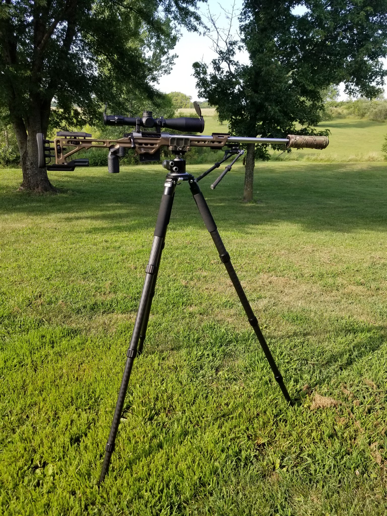

I used my RT80c and Desmond D-LOW55 at the Sporting Rifle Match in Raton, NM yesterday. It was solid holding up my 18# rifle and I was able to hit 6/6 targets from 205y to 540y. The target sizes are a little more forgiving on that stage since it must be shot from tripod/bipod, or anything other than prone.
But overall I'm pleased with it, I don't regret not going with the 90c, yet anyways.

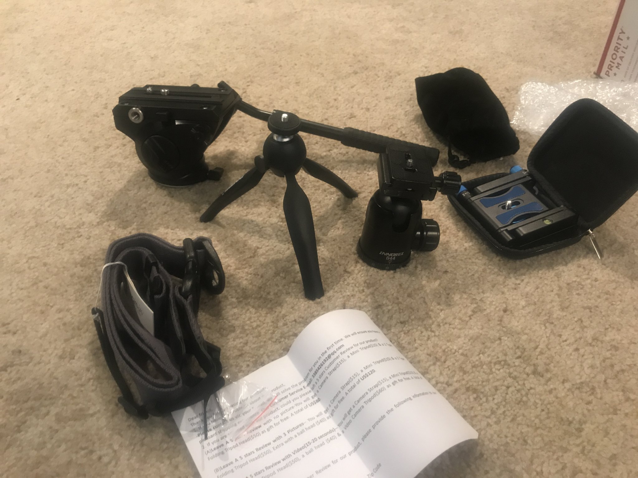

Got my Rt90c ordered last night on Amazon for $282 shipped (there was a surprise $15 coupon attached to the ad). I also bought a leofoto NB-46 ball head for $99 shipped. I wanted the 55mm ball, but this 46mm one shows a higher weight limit and was less than half the price. Im into the set for $381otd

Would the RRS TA-4 work on the RT90C? It does say it's compatible with 75mm and 100mm bowl, so curious if anyone has tried it.
I'm curious about this too. The TA-4 also gives you 20 degrees of travel, and a higher weight rating. The downside is that it's heavier, but for PRS or long range shooting, that doesn't matter to me. I have a lighter tripod I could use if needed.
I think I'm going to buy the RT90C and try the TA-4. If the TA-4 doesn't work I'll just buy a RRS Anvil-30, and just the screw attachment method.

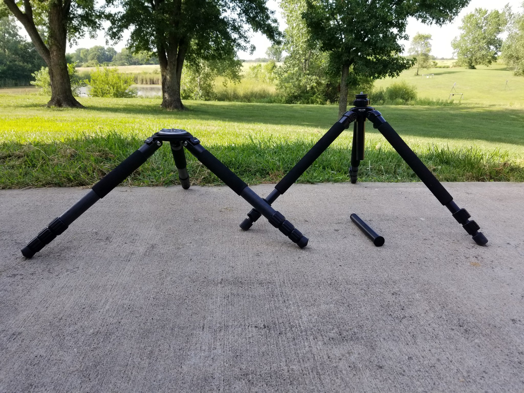

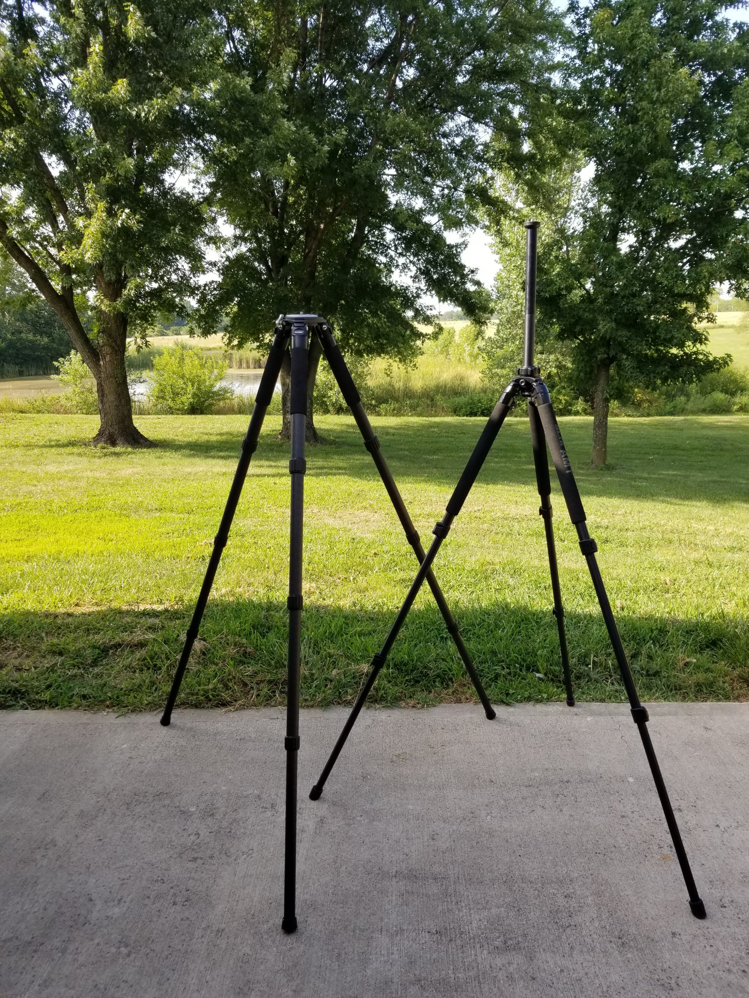

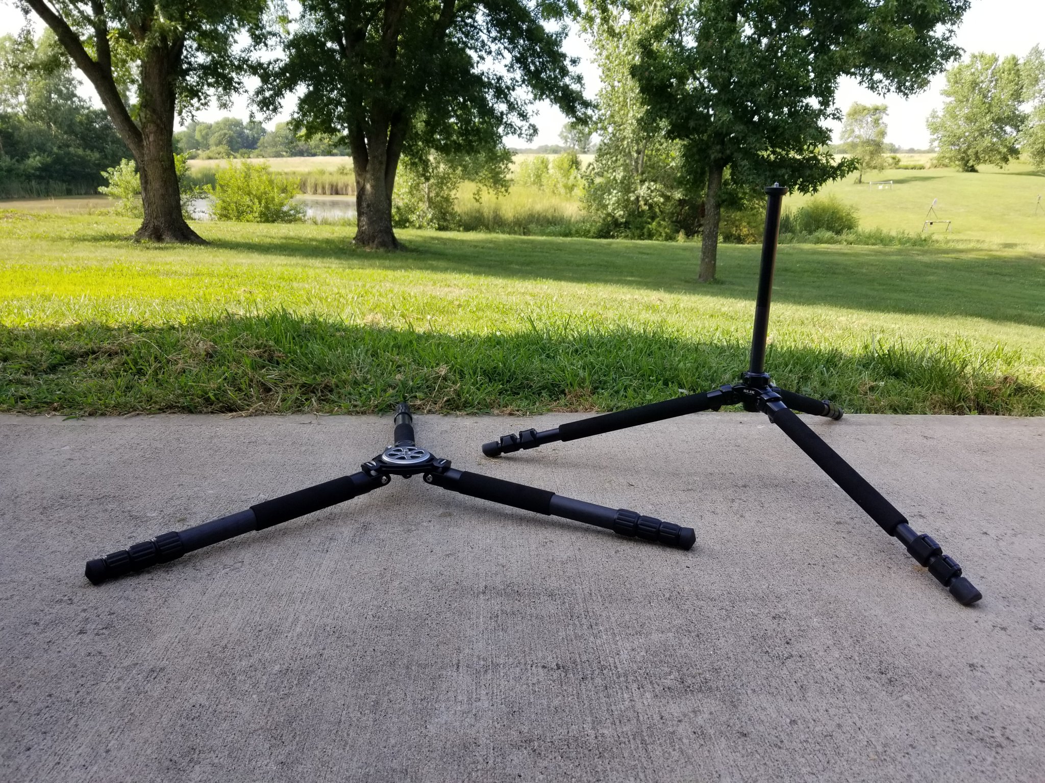

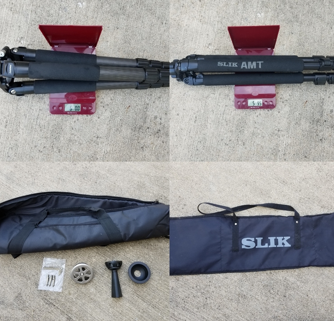

Last week I decided to replace my Slik 700 tripod for a carbon fiber tripod. While searching instunbled across the Innorel RT-90C. I found one on Amazon for $257 shipped. 6 days later it shows up. Included with a 75mm bowl, 75mm half ball adapter, aluminum flat top plate, spiked feet, Allen wrenches and a nice padded, zippered carrying case that has room to leave the ball head and hog saddle attached.
The finish on the metal looks nice and even (no this spots) the carbon fiber has a nice "weave" pattern and the legs operate smoothly. The legs have a 40mm diameter and the total capacity of the unit claims 88lbs. My 40lb daughter was hanging from the top plate. The tripod didn't seem to even notice.
Overall, I'm pleased with the purchase. I will say, the short time I spent with the bowl/half ball adapter it not very smooth. Perhaps with time it will break in but for now I'm going to use the Desmond db-55 ball head with andoer QD clamp/ Hog Saddle combo.
The RT-90C is on the left
