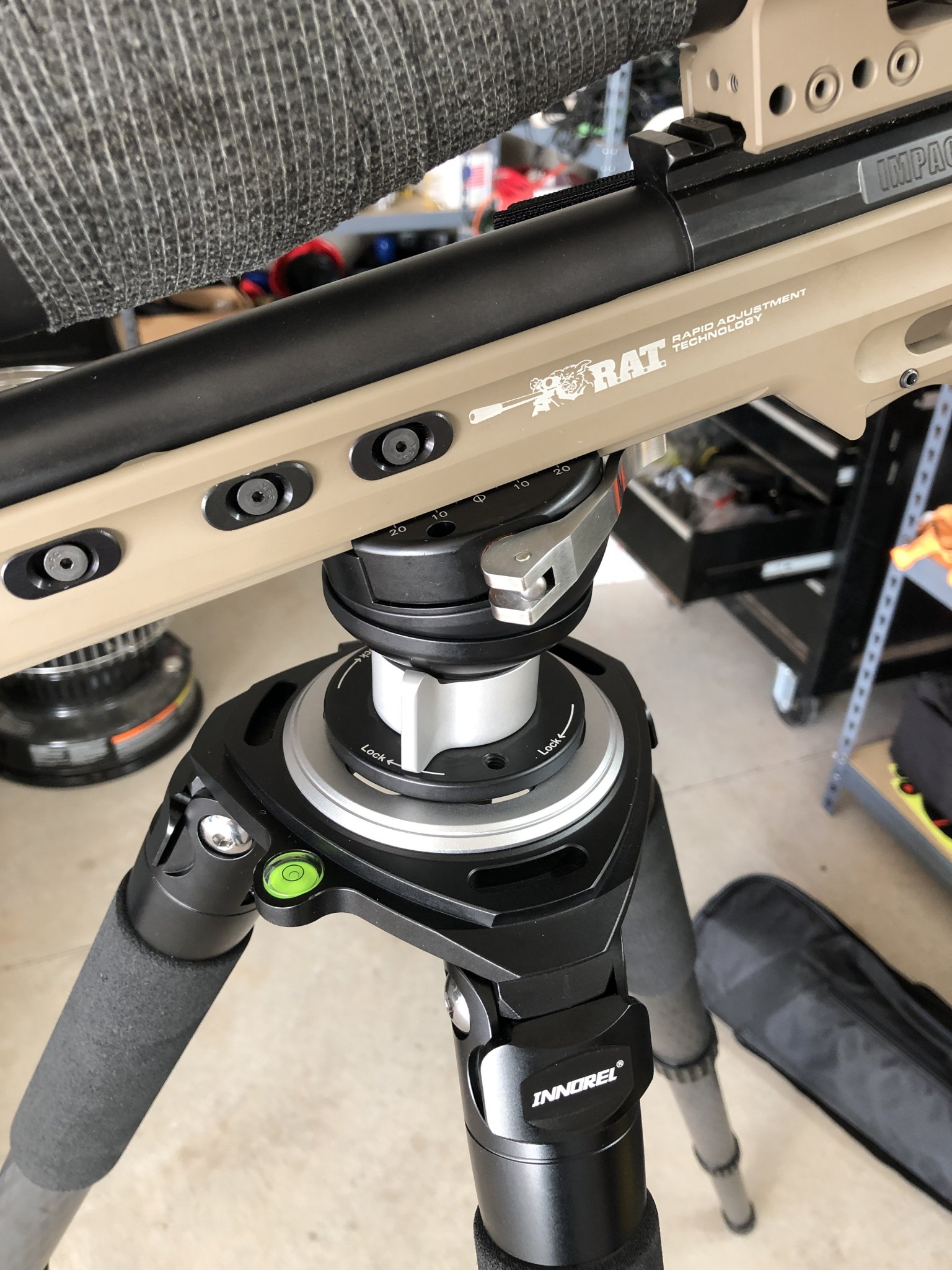

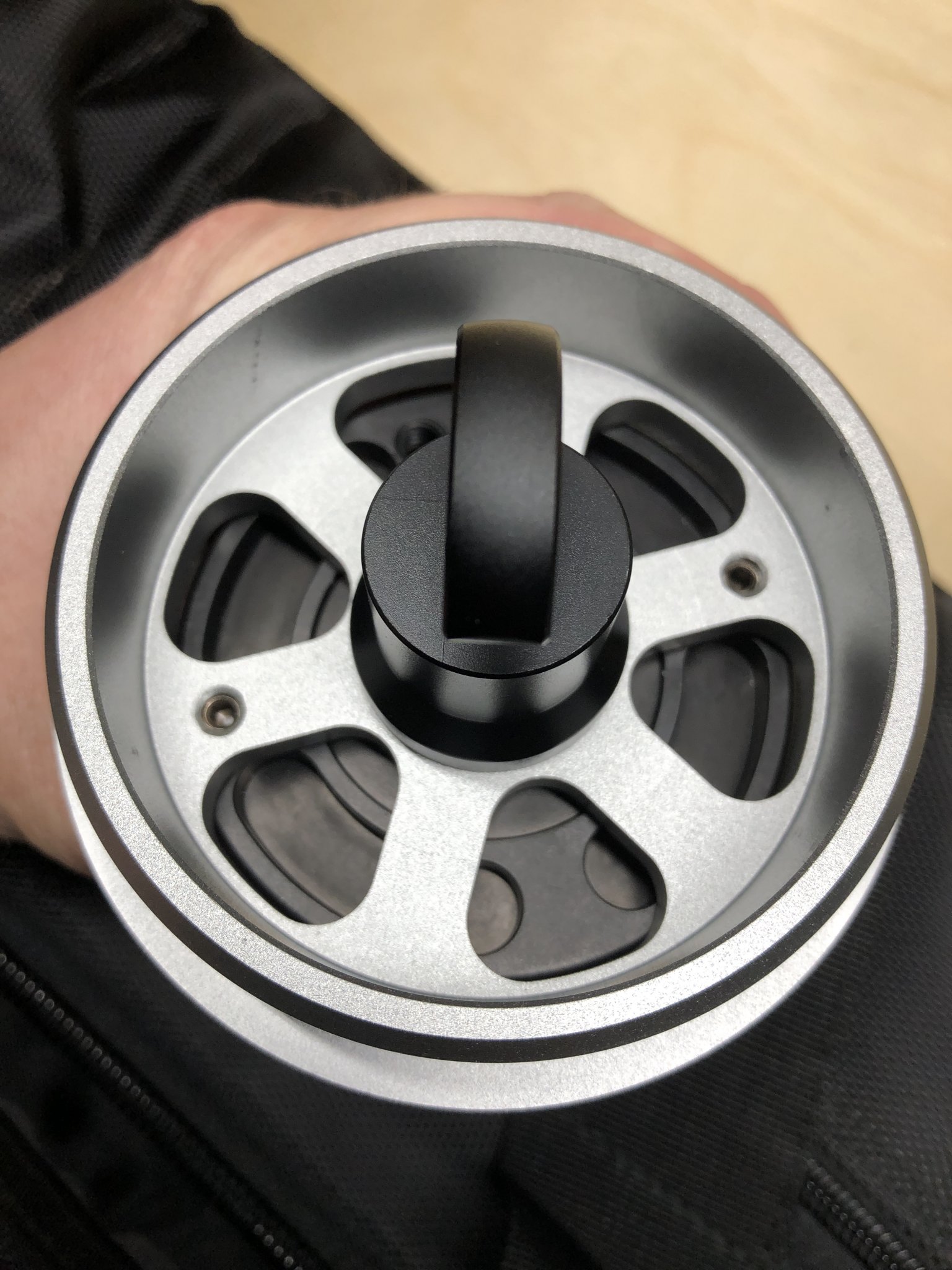

Update on RRS TA-3 capability with the RT90;
I finally took my tripod to my buddie who has the TA-3 to see if the RT90 75mm video bowl works with it. Yes it does BUT... you do not have the same amount of travel when you put the TA-3 in the RT90 video bowl as you would if you left the TA-3 in the bowl it came with. And the TA-3 video bowl will not fit the RT90. Something about the way it sits not sure why you lose travel. This being said I am purchasing the RRS universal leveling base instead of the TA-3.

As Nomadic3599 stated above the RT90C and the TA-3 are not a perfect match, I have both items. The RRS TA-3 leveling base comes with it's own 75mm video bowl. This base drops directly into many of the tripods out there. However, the apex opening in the RT90C is too large for the TA-3. To use this base you need to remove the video bowl that it comes with. Then you replace the TA-3 video bowl with the one piece video bowl/adapter that is supplied with the RT90C. This is very simple and designed to work this way. However, as stated above you lose a small amount of the 15 degree movement and I feel there is a small reduction in how smoothly the unit moves. There is nothing wrong with this combination just not perfect.
So the Anvil 30 will drop right in, huh? That was my 2nd option, just very costly.
the anvil will mount to most any tripod with a 3/8 inch screw/stud. so will the universal leveling base. The TA-3 is different and made to mount to tripods that use a 75mm bowl. The ta3 and universal leveling base are similar in function, but different in how they mount.

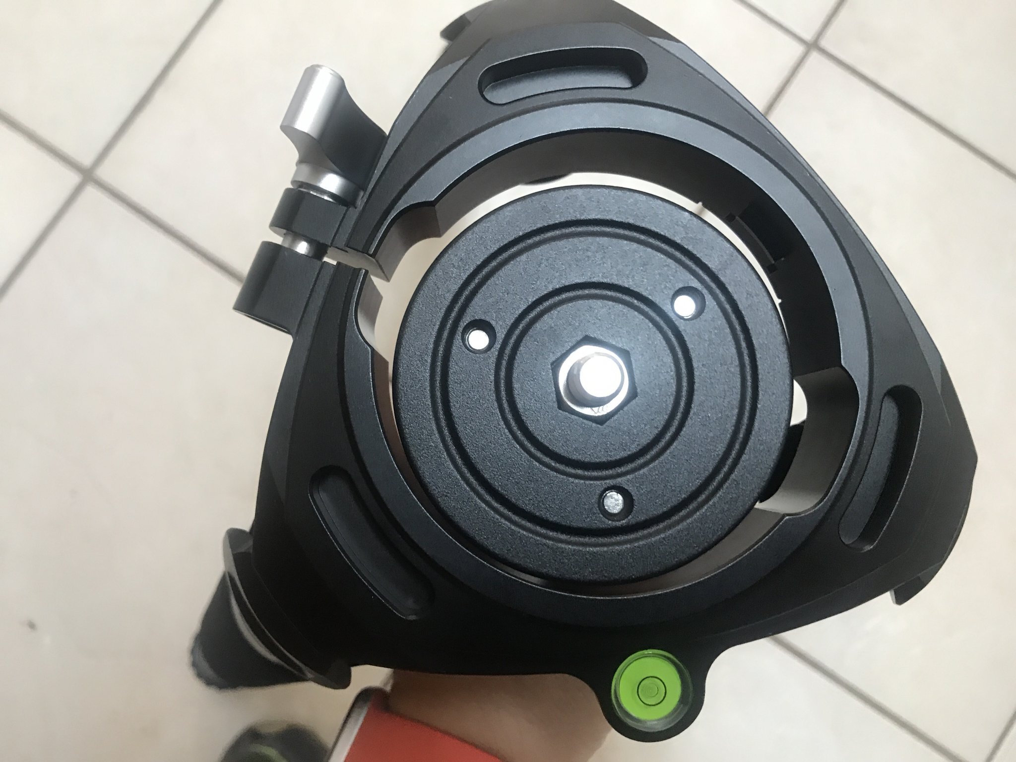

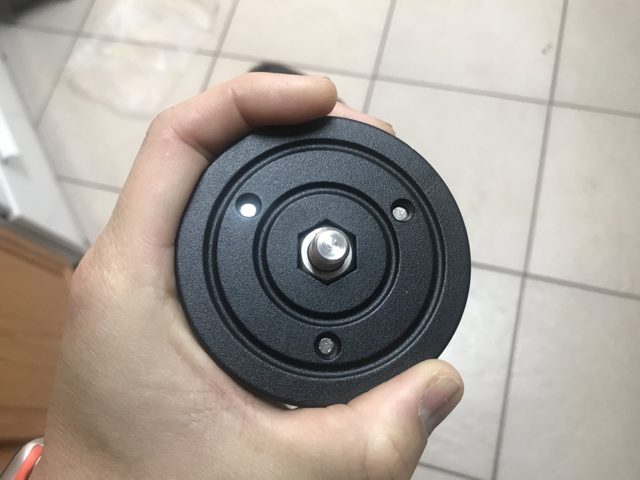

Got the RRS universal leveling base in and installed it on the RT90. The set screw on the RRS didn’t match up with the RT90 base so I had to use the two set screws on the RT90 base and drill two dimples with a drill press in the bottom of the RRS leveling base because the timing was slightly off from contacting the RRS base(it’s milled out on the bottom) when you screwed it all the way down, so it is backed off probably 1/10th of a turn from all the way tight, no wobble. Other than that it works and functions good.

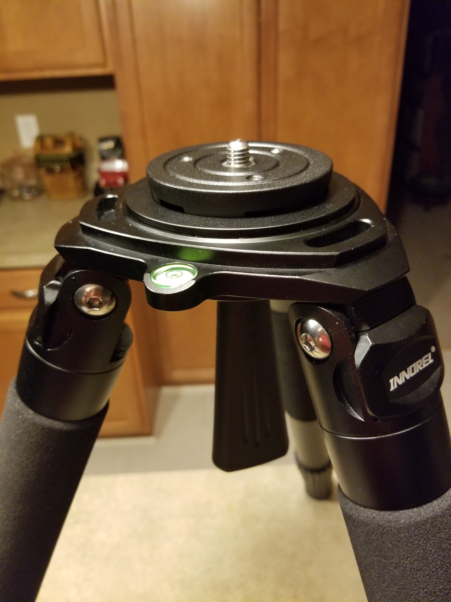

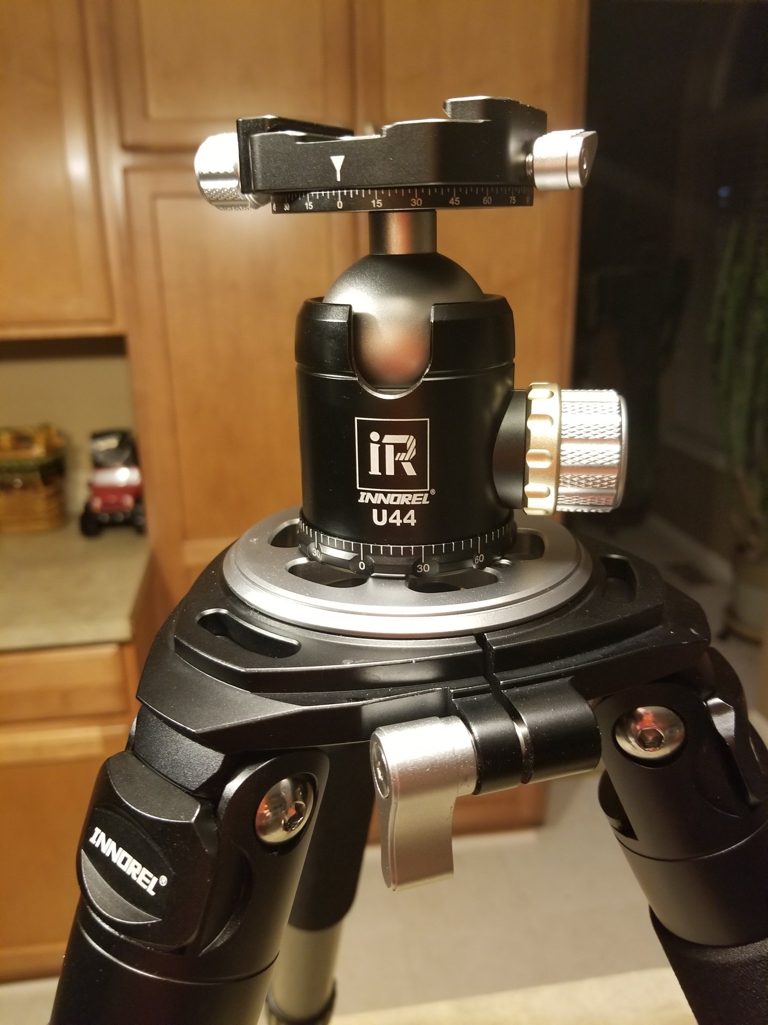

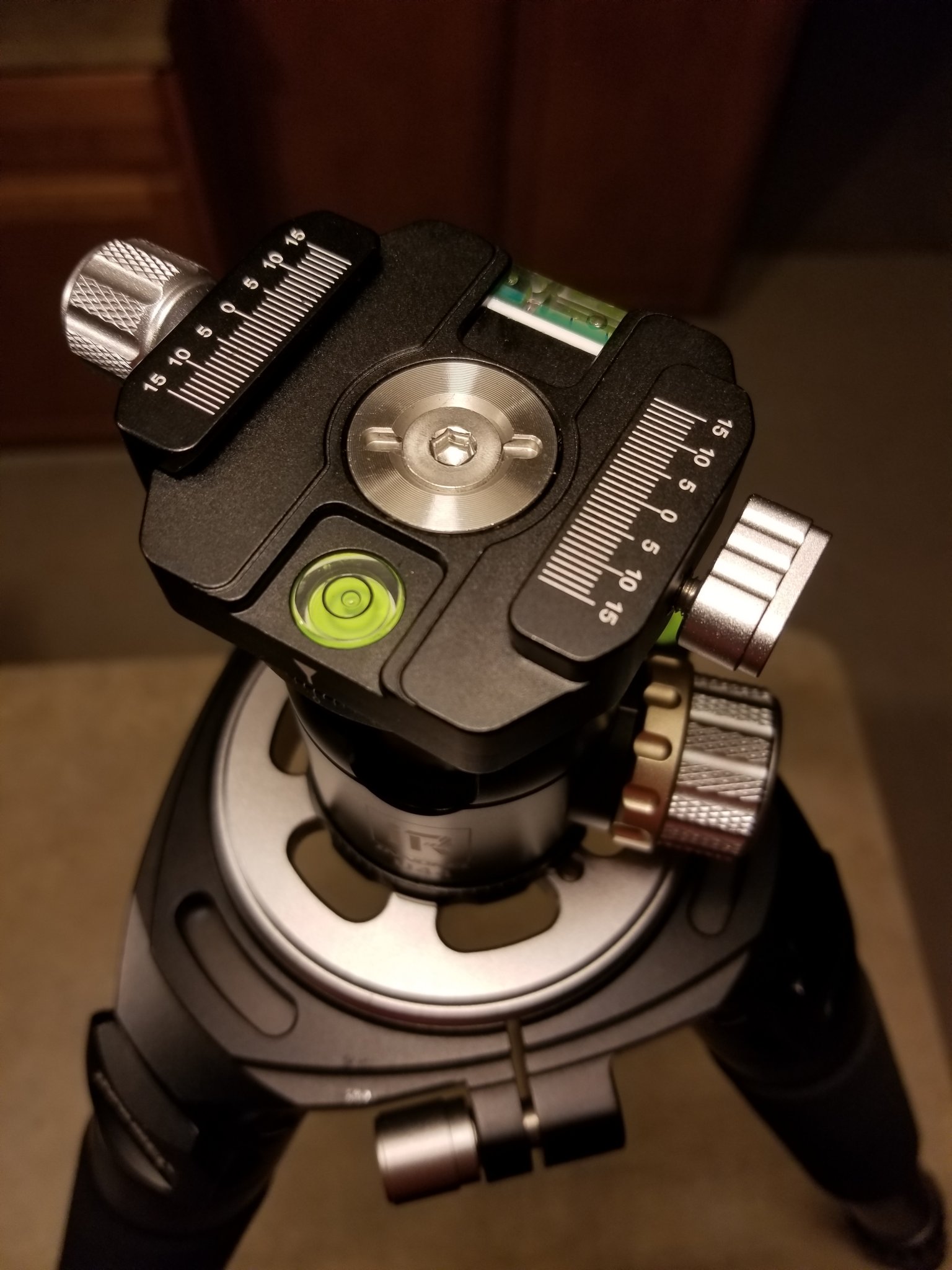

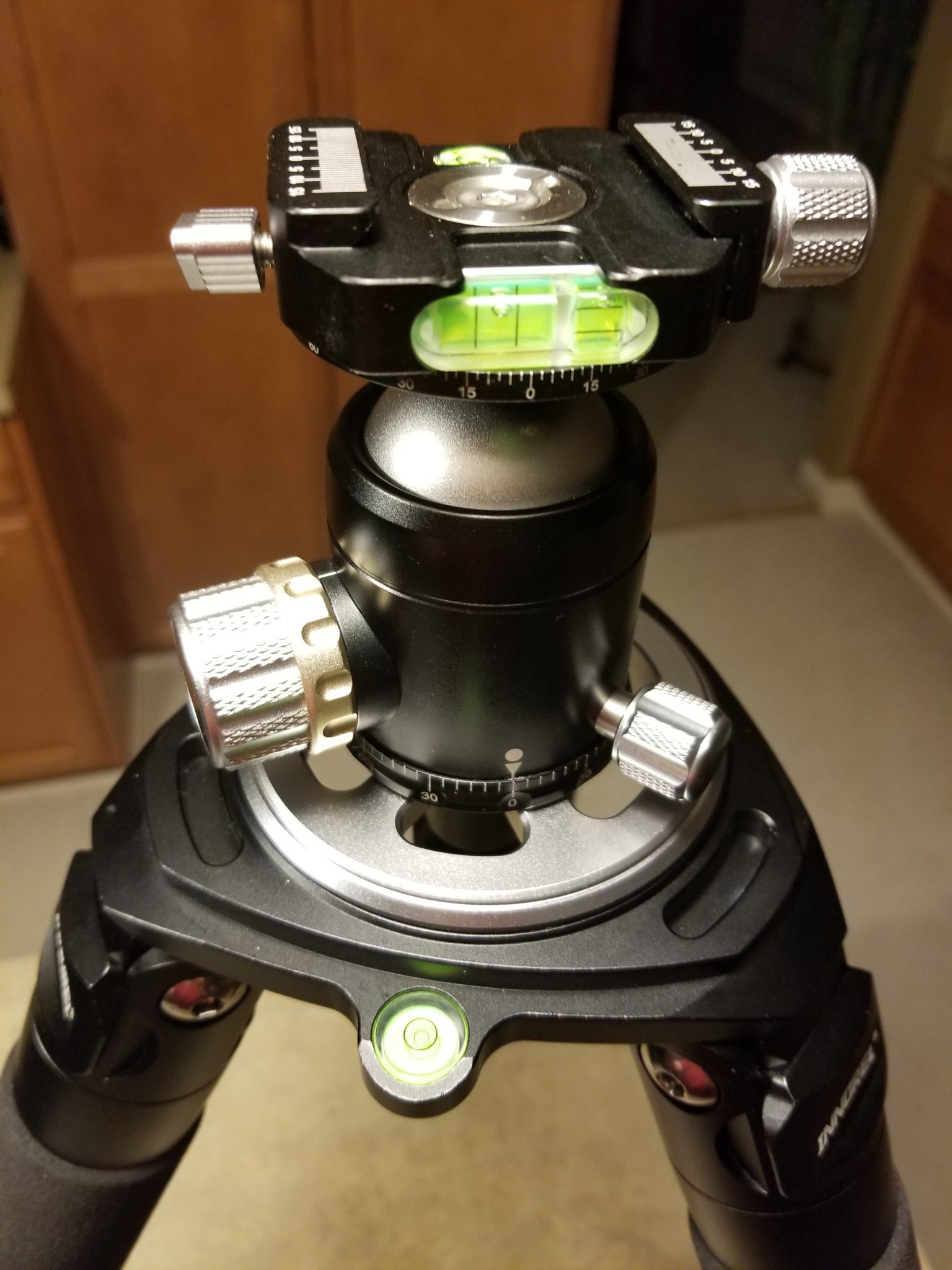

Received my RT90C today with their ball head and leveling base. The leveling base is ok, but I like their ballhead and will keep that on the tripod. As for the tripod it exceeded my expectations. Very sturdy, well made and excellent ginish and quality. Here are some pics...
