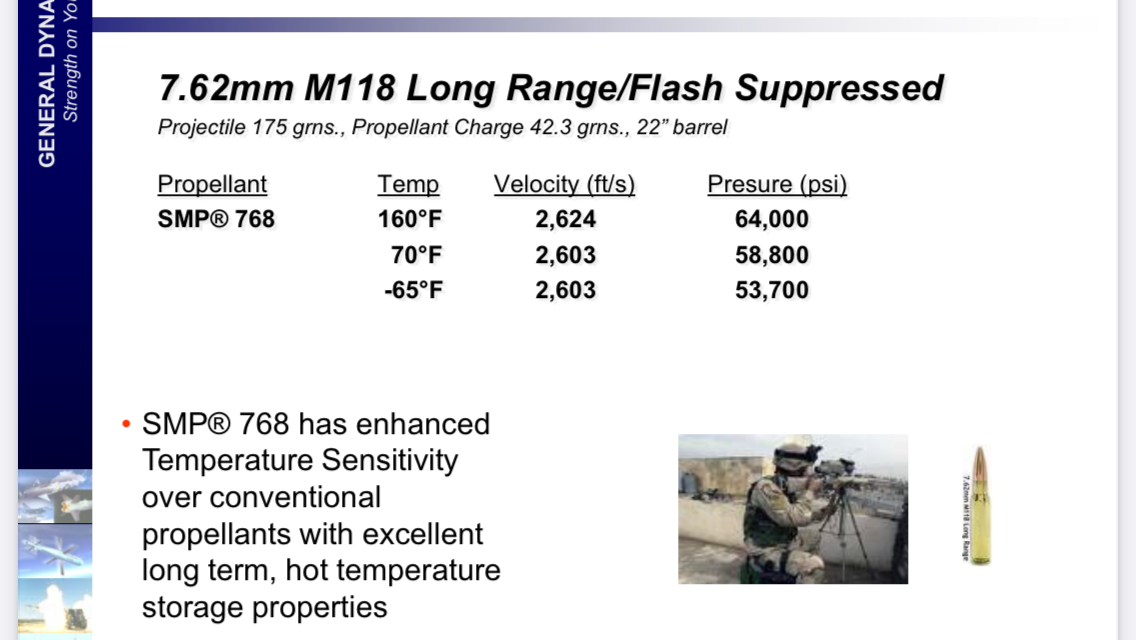

According to this, M118LR uses SMP768 powder:
Interesting. It looks like General Dynamics / Saint Marks' proposal, vice what's in production. M118 LR's original powder (before RL-15) was W750 (now SMP-750).
The next slide shows M118 LR as the base line:
Your right, it’s probably a proposal. I’ve been trying to get some of that 768 but St. Marks claims it doesn’t exist. So maybe the military rejected the idea and the project was scrapped. And the powder never went into production. Who knows.
