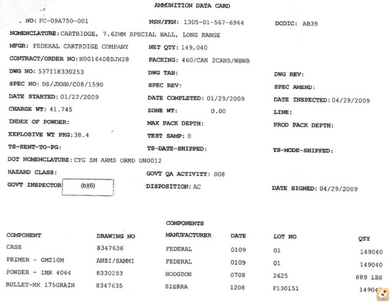

The military went from Reloader 15 to IMR 4064 because RL 15 was not stable at Afghanistan temps. with the 175 MK. Also the loads were hot and made for bolt actions and gas guns were introduced are brought back in service.
Also Fed who makes the ammo uses IMR 4064 in their Gold Medal Match Ammo in 308 Win.
FC military brass
41.745 of IMR 4064
fed 210 Match Primer
175 Sierra MK

Like others said Federal uses IMR 4064 in their Gold Medal Match ammo.
Now the military uses IMR 4064 in their M118LR ammo at 41.475 with 175 Sierra MK with Fed 210M primer in FC military brass.
Reloader 15 was discontinued in the military.

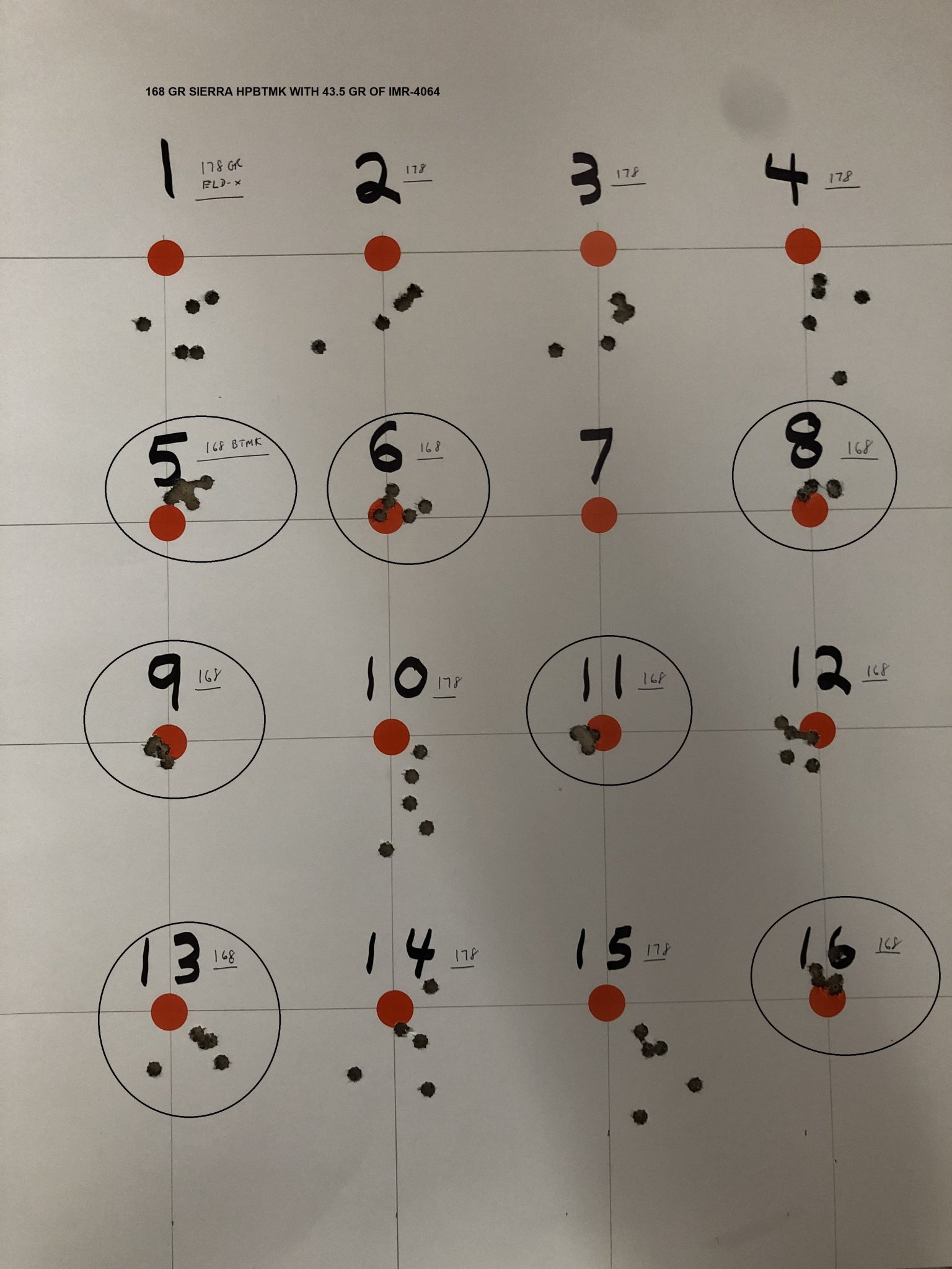

Not having much luck with the 178 ELD-X in the Remington TAC 21 20" 1 in 10 using 42 and 42.5 GR of 4064 with the 178GR. I am however having good results with 43.5GR of 4064 with when shooting the 168GR. It has been suggested I try the 43.5 - 44 GR of 4064 with the 178 GR. Anyone that can give some input would be great. These red pasty's are .750". I do not have a chronograph so I have no clue what my MV's are. I just need to shoot good groups at 100 so I can feel good about it not being the gun if and when I miss as greater distances. I'm hoping this statement means ( knot cutting combination) [ all in the same hole ] at 100 yards with ~44 gr of IMR-4064 as I have read elsewhere. Sure wish when people made these claims they show photo's of their actual accomplishments.
Well, according to this I'm using the correct powder and primers but the wrong bullet. I stayed away from the Sierra 175 GR HPBTMK because I want the same or better ballistics but wanted expansion in the end. I guess I just need to find the correct powder load. I did load up a few with 43.5 GR and 44.0 GR. We shall see how these two loads work. I see the charge weight is 41.745 GR and that is slightly over minimum charge of 40 GR where these bullet would only be traveling about 2,500 FPS.
Am I reading this correctly and my assumptions correct?
Am I reading this correctly and my assumptions correct? Have you actually loaded this cartridge and tested it for accuracy? Do you have any photo's to post?
