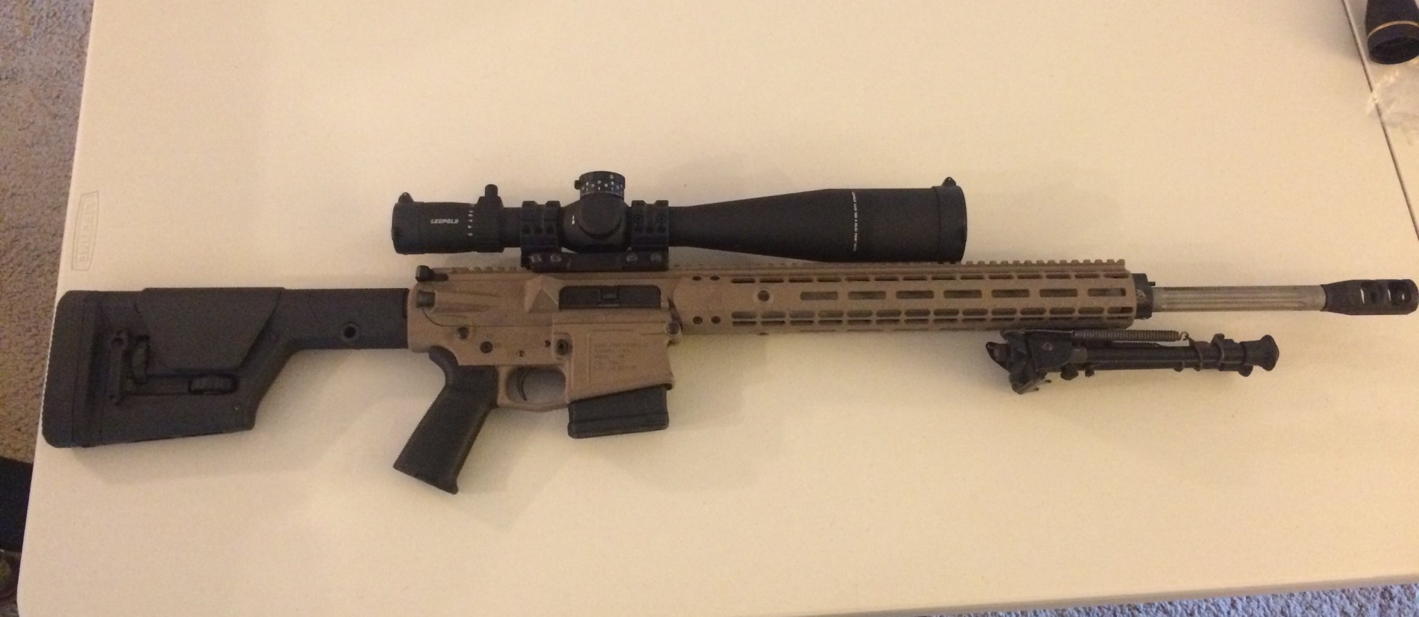

Pretty darn happy with my AR10 build:
Aero precision receiver set and hand guard
Rainier Ultramatch barrel 22” 6.5 creed
JP internals
Delivers consistent results out to 1098 yds so far...
JP internals
Delivers consistent results out to 1098 yds so far...View attachment 7037855

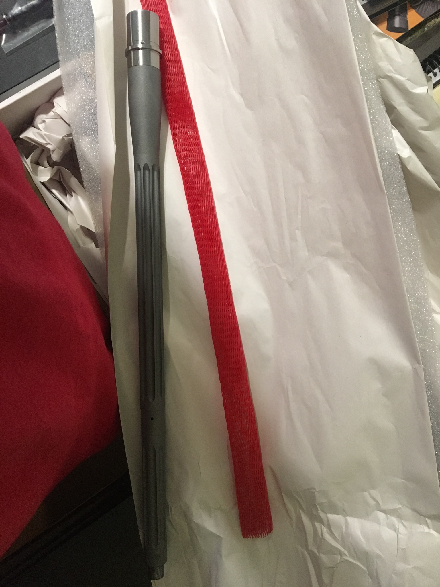

Talked to GAP yesterday. They are flexible on the stock and the trigger. The barrel they want to put in is exactly the same barrel I want (bartlein #13 20 inch with slr agb). They are also flexible on the trigger.

My latest barrel was done by Craddock precision. If u send him the upper and bolt you are using you will get a perfect fit. I’m beyond impressed with what they did with my 260 bartlein
Reactions: wigwamitus
If I do a build, Craddock P. is in my plan to provide the barrel ...
I haven't called them yet, so I didn't know about sending them the upper. Other's I've talked to wanted you to send them the upper (or the receiver if bolt) so I'm not surprised.

Looks really nice !
He doesn’t need the upper but I recommend sending it (do not send lower, he is not FFL) because with the lack of AR 10 standard, some are tighter than others. The Zev this is going in was extremely tight as it was designed for a thermal fit. The aero may vary. But he will need the bolt. This will ensure your chamber to bolt fit is perfect. I used the JP enhanced bolt.
