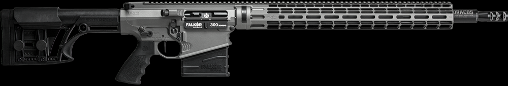

I just think its so pretty FALKOR PETRA 300 WIN MAG
7038246
the price is a tad high yet for me .

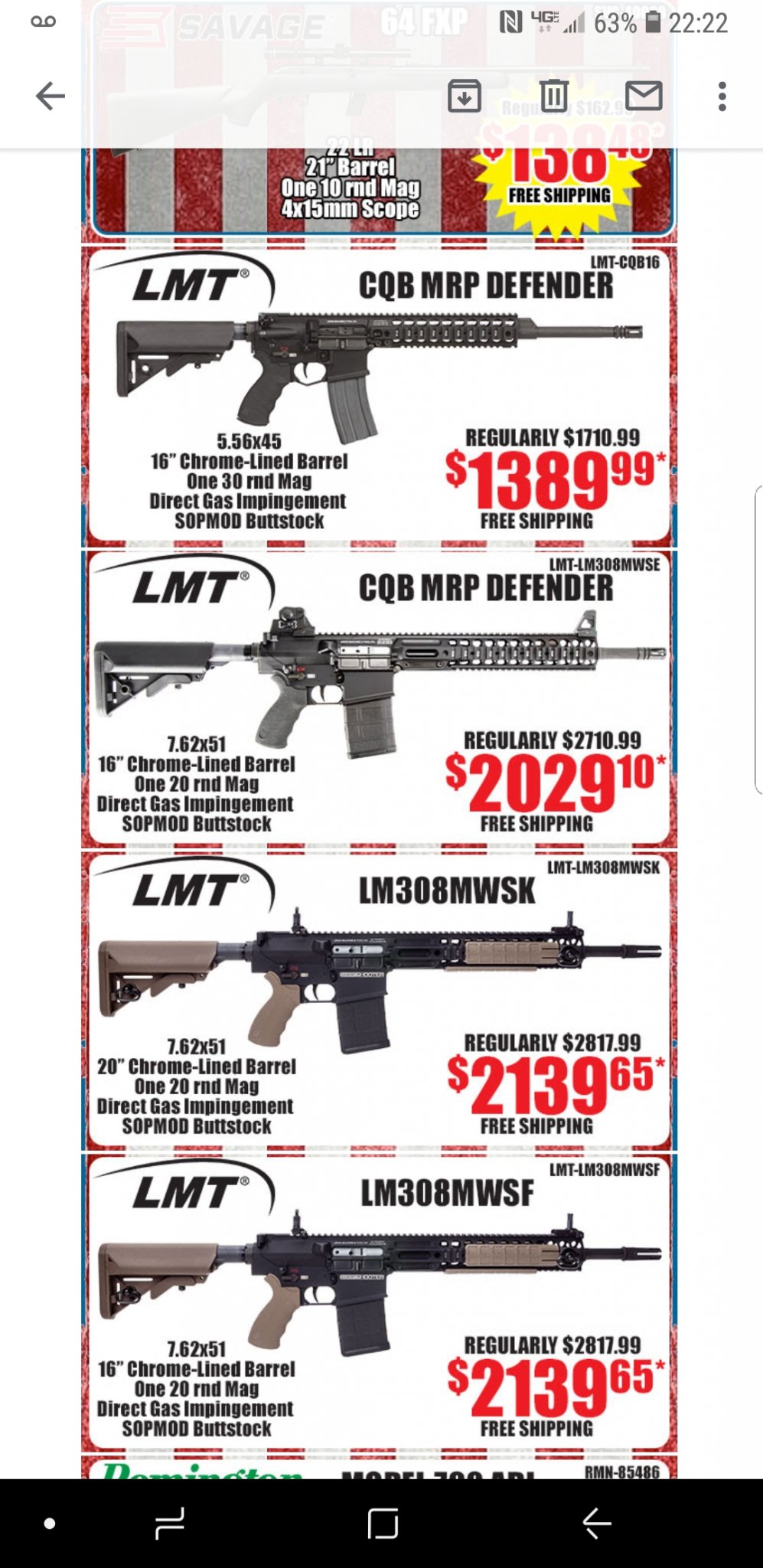

KY Gun co. is running a sale. They are back ordered though. Should be able to call and place an order.
Reactions: Jsp556
Looked on their site and didn’t see that sale. Link?
That was a screen shot of their Tax Time Sale email flyer. Looking on their site and even clicking on the link online I don't see them listed. Maybe they withdrew them from the sale.
Gotcha. I already have one but my brother in law is in the market. Thanks any way bud.
