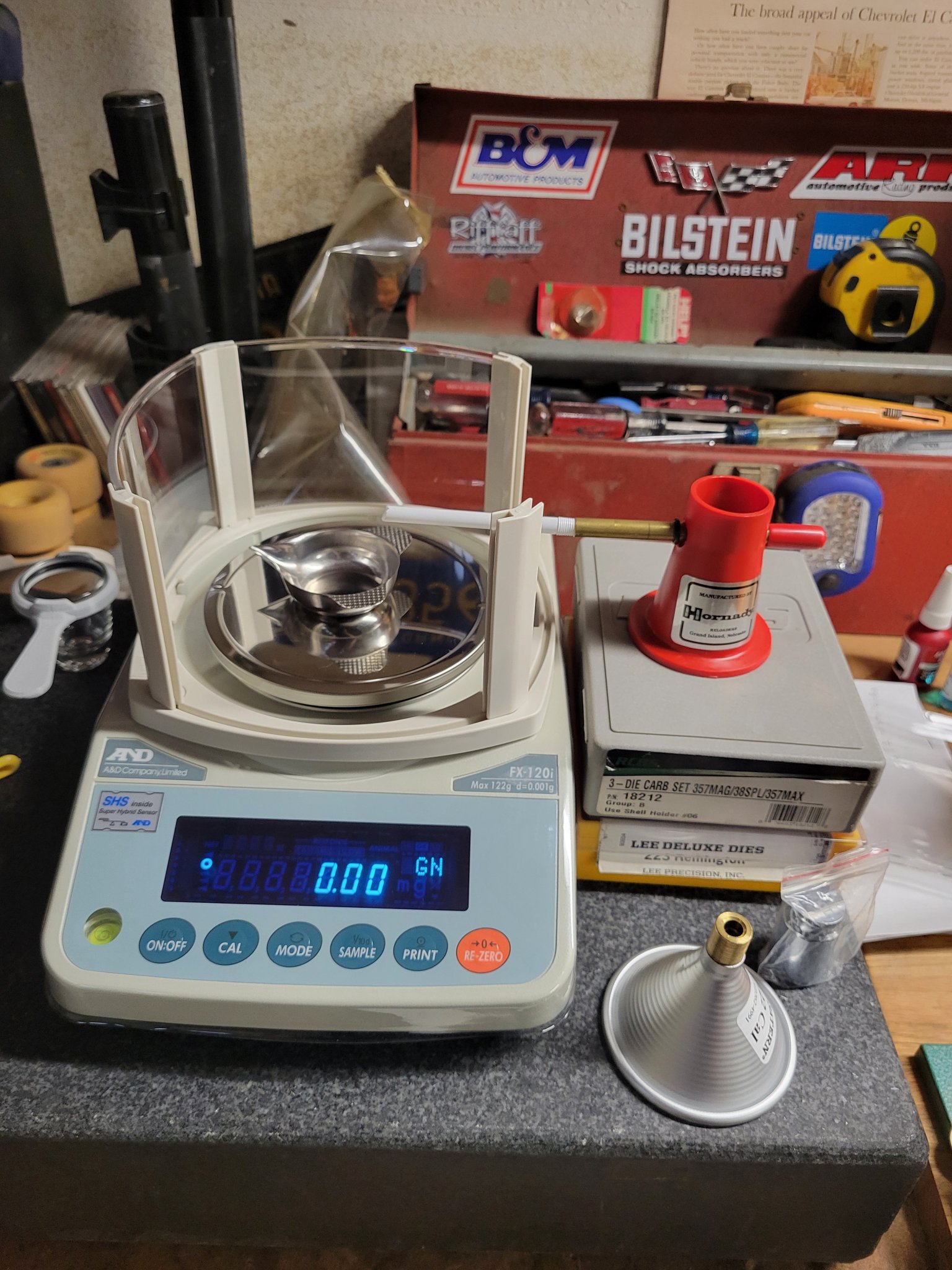

Just out here sweating my ass off for 50 rounds. I will say the A&D is pretty sweet though.

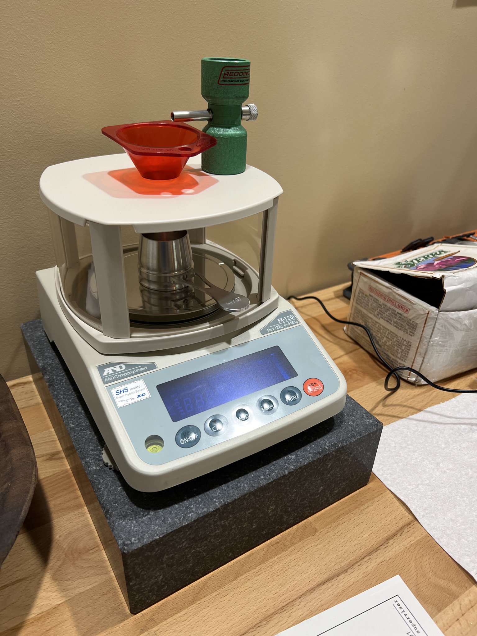

Real talk: Excited for this product for shrinking my workspace, the analog input, and a high potential of not having to constantly clean out and recalibrate due to bouncing kernels.

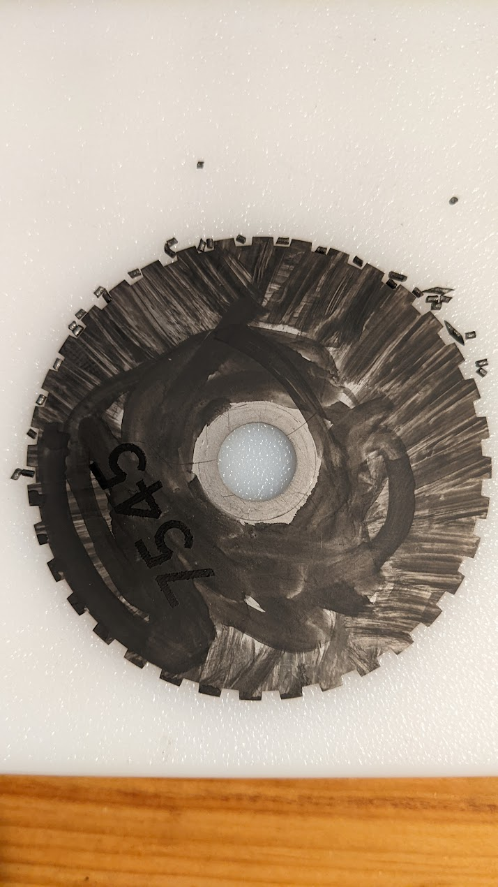

Anyone know or have experience finding the best disks for 223 extruded powders like 8208 XBR or AR comp. I seem to recall varget's disk was usable, but its maybe not the ideal, since two disks were listed in the settings/manual.
XBR 8208 works perfectly with the recommended 7545 disk for me. What issues are you seeing?
Use some kernels and place them inside the notches of the disk to evaluate. If you want to use 1 disk for both 8208xbr and AR COMP, use 7545. It'll be more precise.

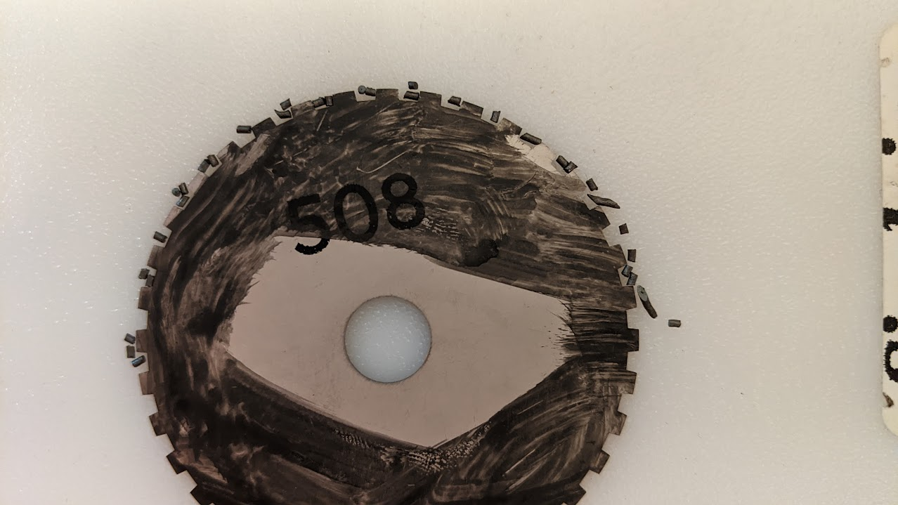

Pics of AR Comp. I use 508 (for AR Comp) because it has slightly deeper notches than 7545, which allows for perpendicular orientation of the short length kernels (2 per notch) or parallel orientation of medium length kernel (1 per notch) of AR Comp. There will still be the occasional kernel that is too long for either disk.
If your lot of powder on average has longer cut kernels go with the 508. If they trend on the shorter length, go with 7545.

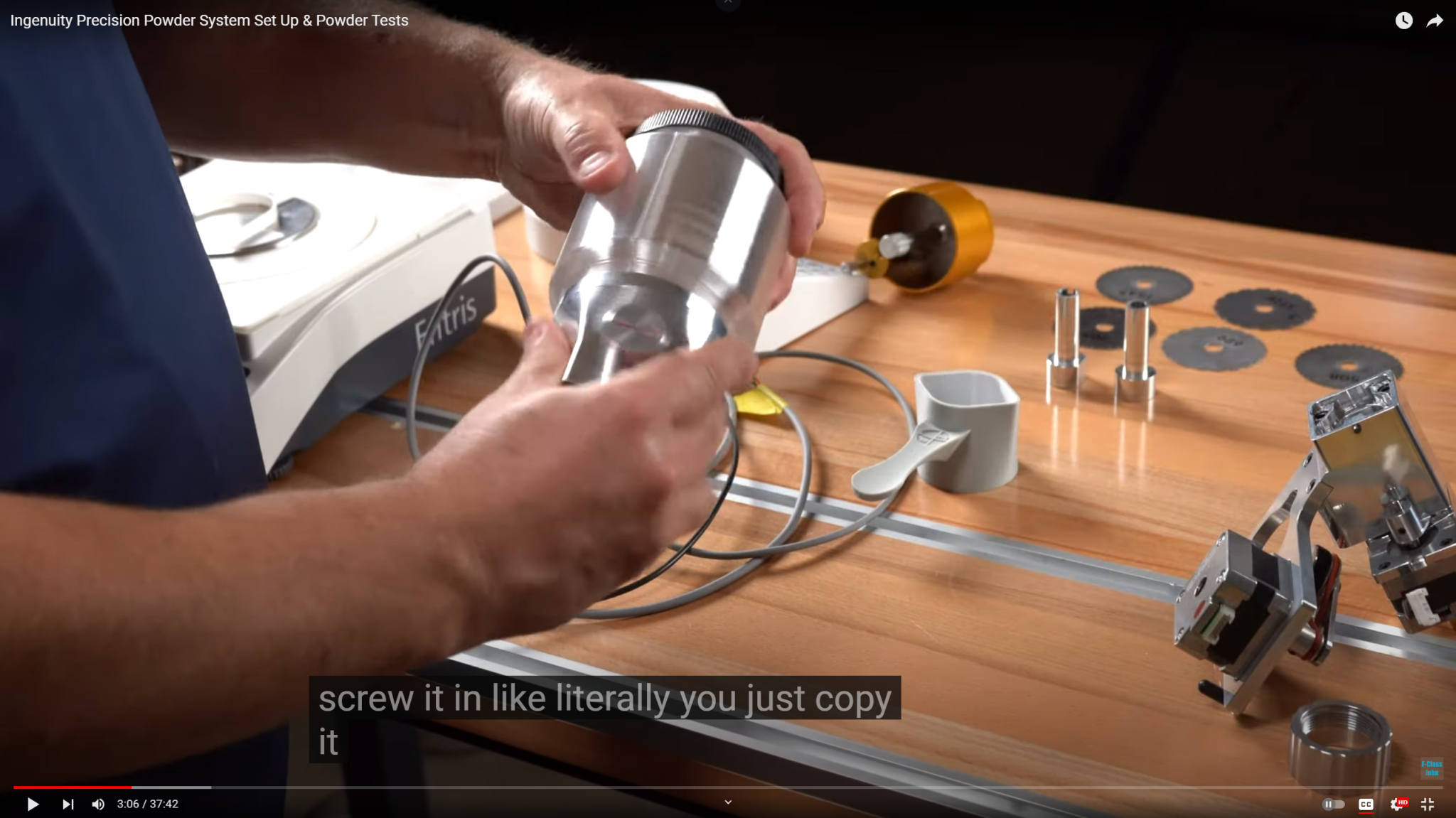

Are we getting close? F-Class John has a nice video!
Look...I appreciate any info on this powder measure system...even from F-class John. I'm in the pre-order and I'm really hoping this pans out as it looks outstanding.
But that video is like 37 minutes of one of the most annoying infomercials I have ever viewed. I just find his voice and presentation manner annoying.

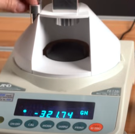

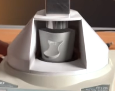

Initial thoughts on the whole video: the hopper system looks good to go. There looks like alot of quality in the metal/machining to hold the thrower and the trickler. The trickler concept is already proven and works great (certain edge cases nothwithstanding...etc).
The housing looks like WIP, but is definitely "gen 2" levels of sophistication. This is good, but its also true that after gen1 (alpha) testing comes gen2 (beta) testing...ie the problems for beta testing is things get more subtle and may not be so ovbious.
Lets say you get a couple stray kernels outside of that cup, the are they sitting on the (grey!) platen outside the cup. The super low profile of the cup window appears to have very little light (unlike the perspec a&d windscreen + stainless platen cover). Can you see them? How? What if they are behind the cup? Theres no natural light, its dark, and theres no 360˚ inspection ability....ie the area is very closed off...!
Take a look...
I feel like you could throw 50 charges and never know 2-3 kernels are not in the cup.
I understand the engineering of the cup etc to avoid spills, but FCJ talks about how he has had "loose change" leak once during the initial fill, and this whole scenario seems to bee pretty common on powder throwers in general. This is something that definitely happens occasionally, with various tricklers (including hand tricklers, and the AT+IP old school setup.
OK. Please tell me I'm crazy...:LOL::ROFLMAO:
The IP self zeros before the next throw, so I wouldn't worry too much.
Having said that, I had a buddy 3D print me a shot glass holder and cup and it is by far the best cup I have ever used in years. I have not see one kernel splash among N565, Varget, H4350, etc... interested to see how the IP holds up.
Take a look...
You’re crazy. Powder is not going to bounce out of the cup and if it does the platen is made so any stray kernels roll off the sides and not sit there where you might not see them.
I understand thats the design principle, I'm asking more about the real world.
As mentioned in my post and by FCJ in the video, spilling powder during dispensing is not the only time it may get contaminated. There is also setup/teardown of the shield or hopper, eg when changing powders.
The v1 unit when used with manual throwing is sensitive to platen contamination, and the zero process between throws is manual and less elegant than the automated system.
Personally don't believe any design is infallible. That's why having risk mitigations (zero'ing between throws) is a good step by the designer.
