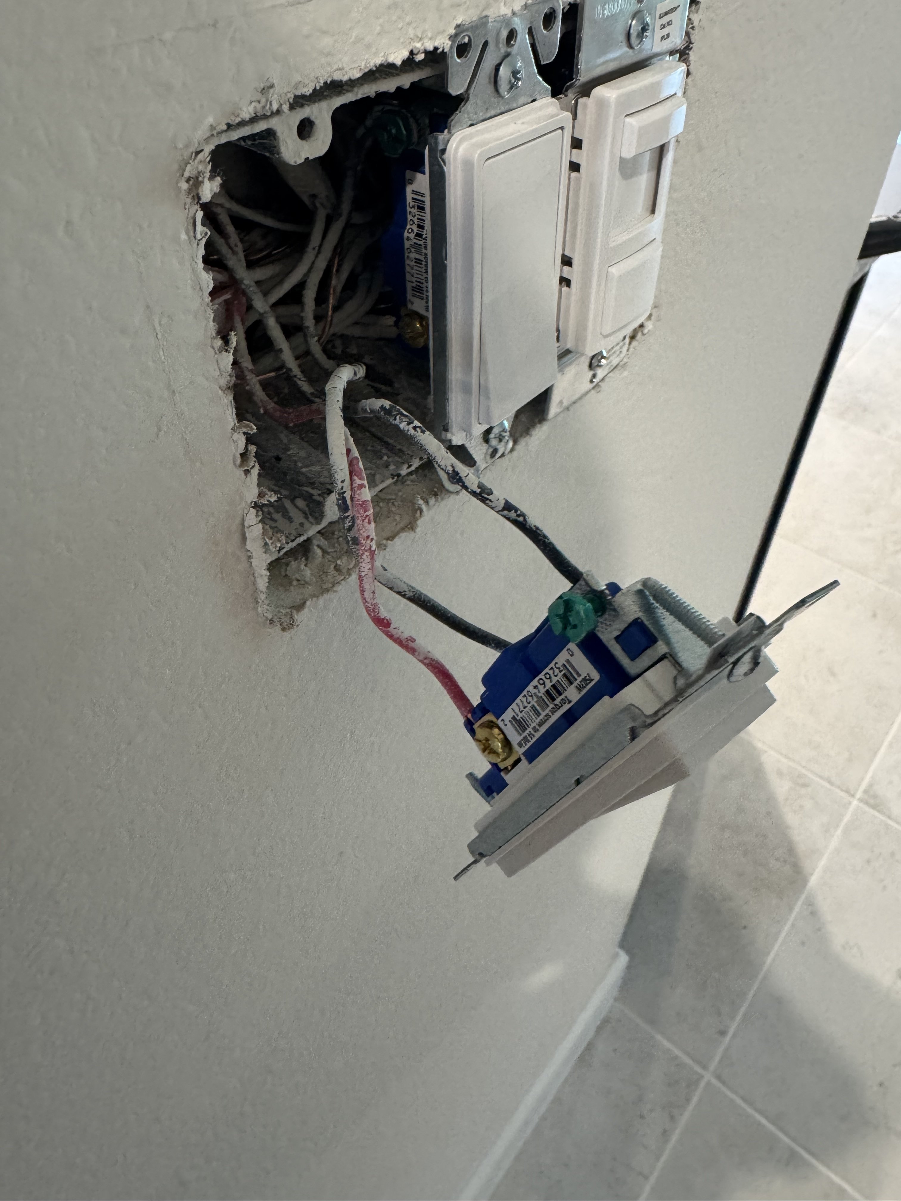

    I'm wanting to install a dimmer on a three pole switch but when I opened the switch cover and pulled the switch, there is not a ground wire attached. This in a multiple switch box.
    Any help would be appreciated.
    Pics-
    Current switch

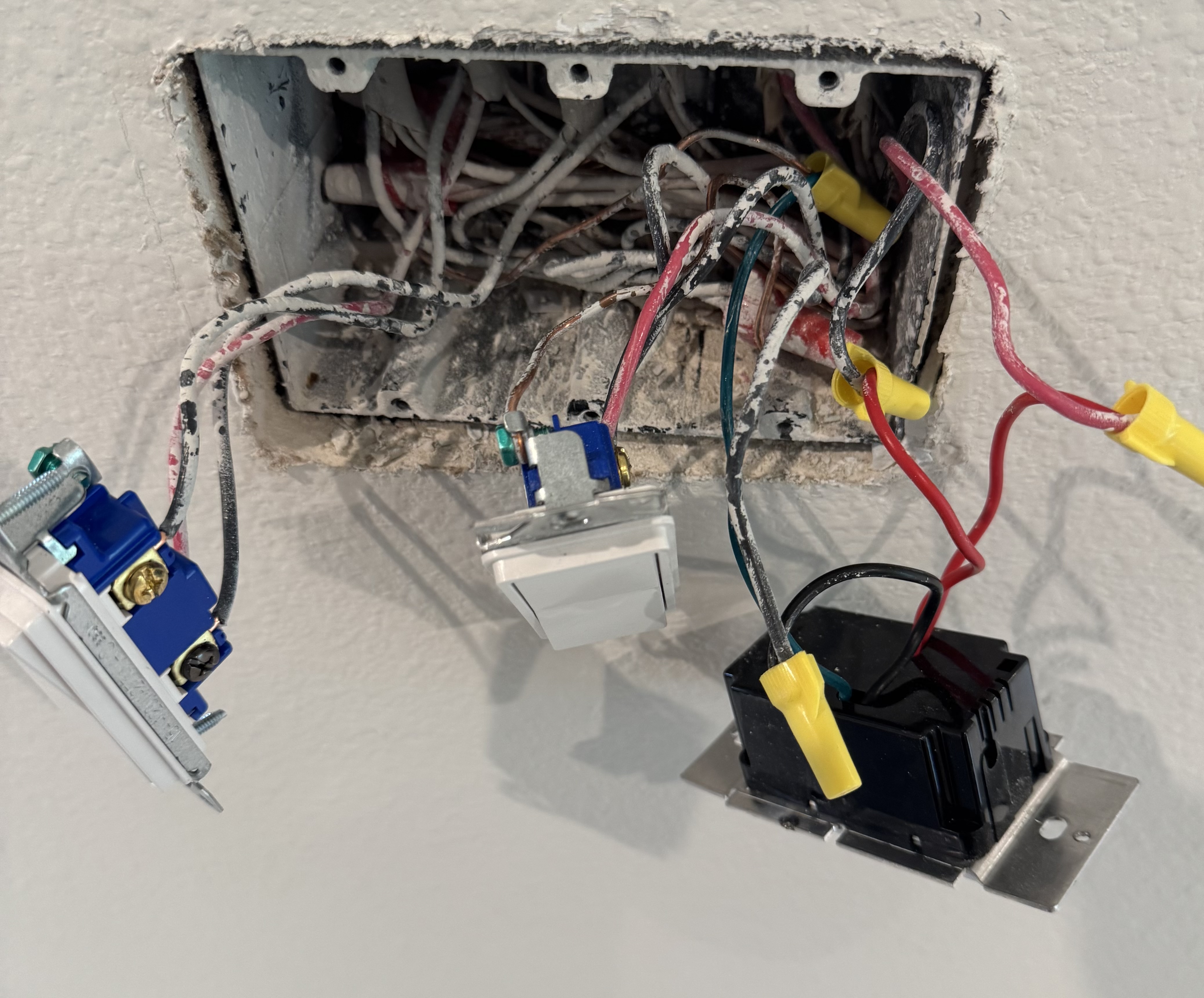

    Edit: added pic of entire box exposed. The green on the other dimmer is connected to a bare ground wire.

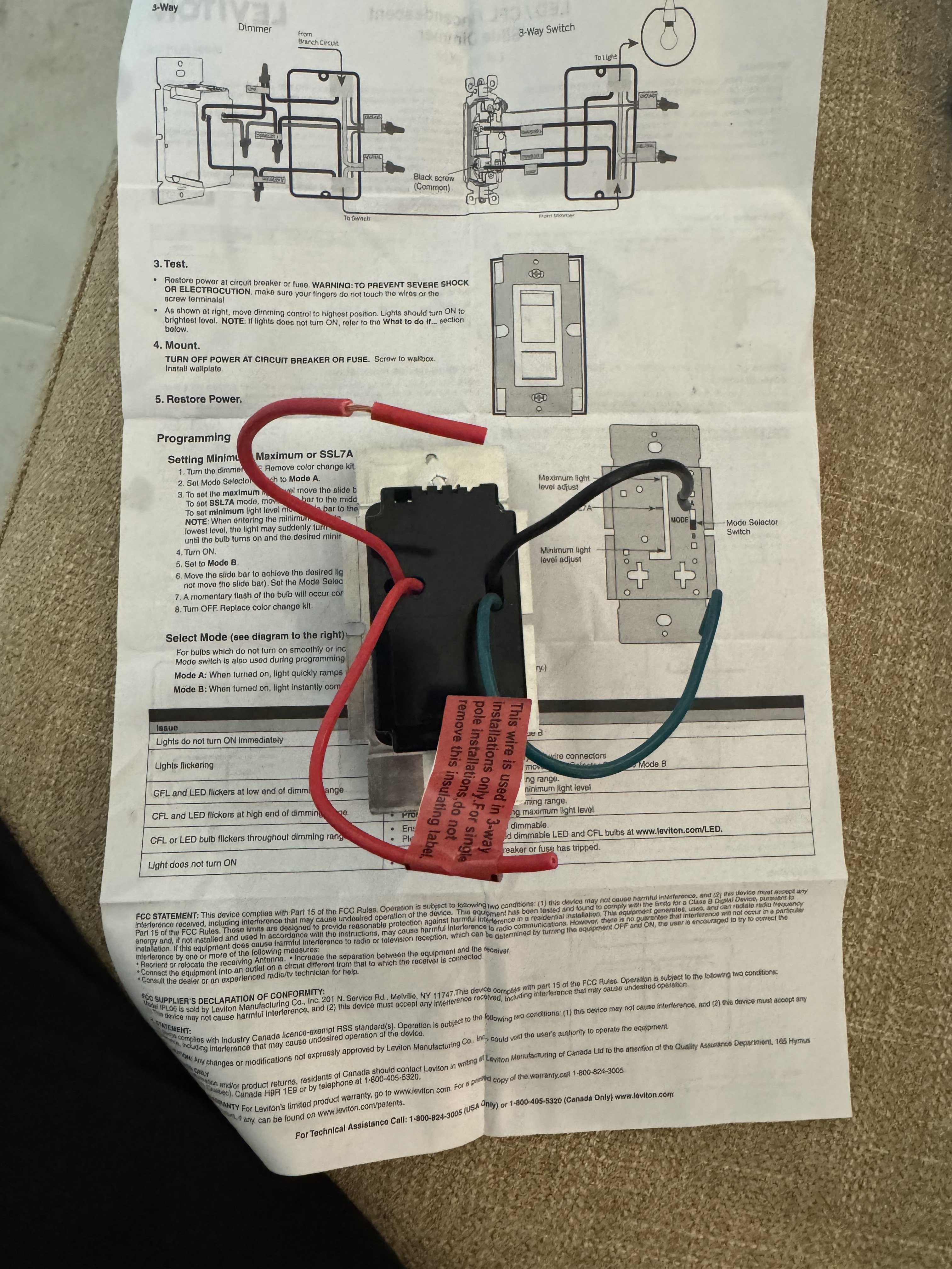

    New dimmer. Same manufacturer as the current switches.

    I was able to figure it out. I pulled a ground from a bundle of grounds twisted together and pretty much followed the directions from there.

    So if that was done this past march April that is some pretty shoddy work. My first thought was and older house before they worried so much about grounding. Sounds like you did it correctly based on the pics, add a pigtail into the wire bundle in the box and ground the switch.
