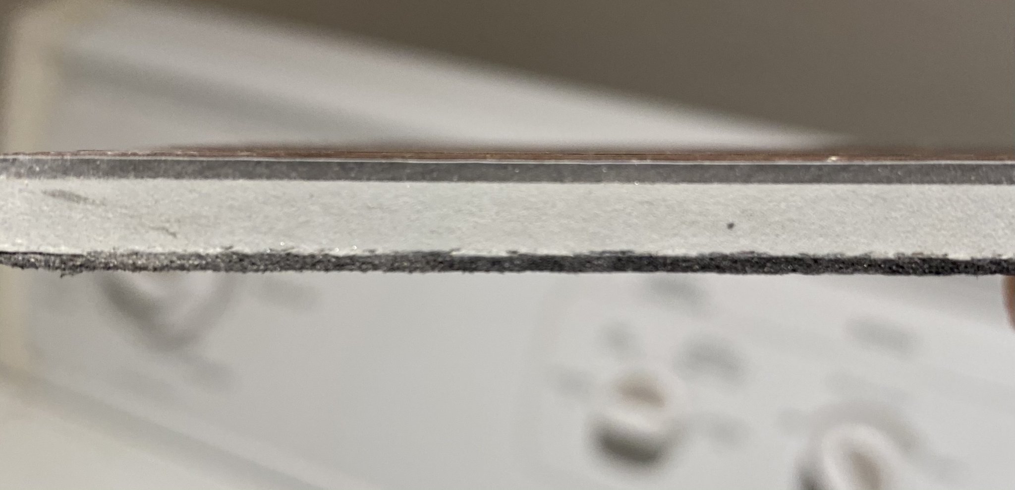

Pretty well thus far. Very snug fit. Some of the lesser expensive flooring I’ve installed were less so, which caused slight gapping between pieces as time passed. Try not to go too cheap. It shows in the long run. Not saying you need to break the bank either...

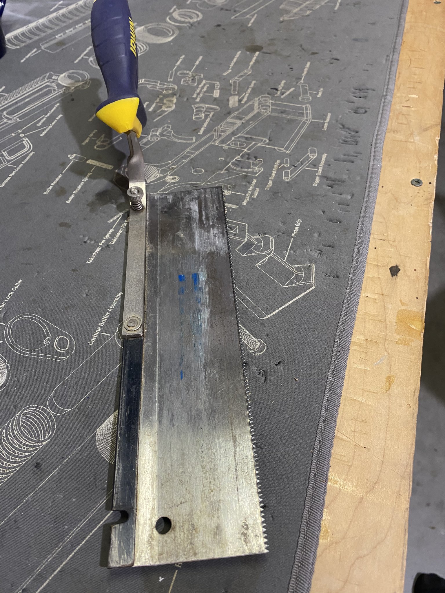

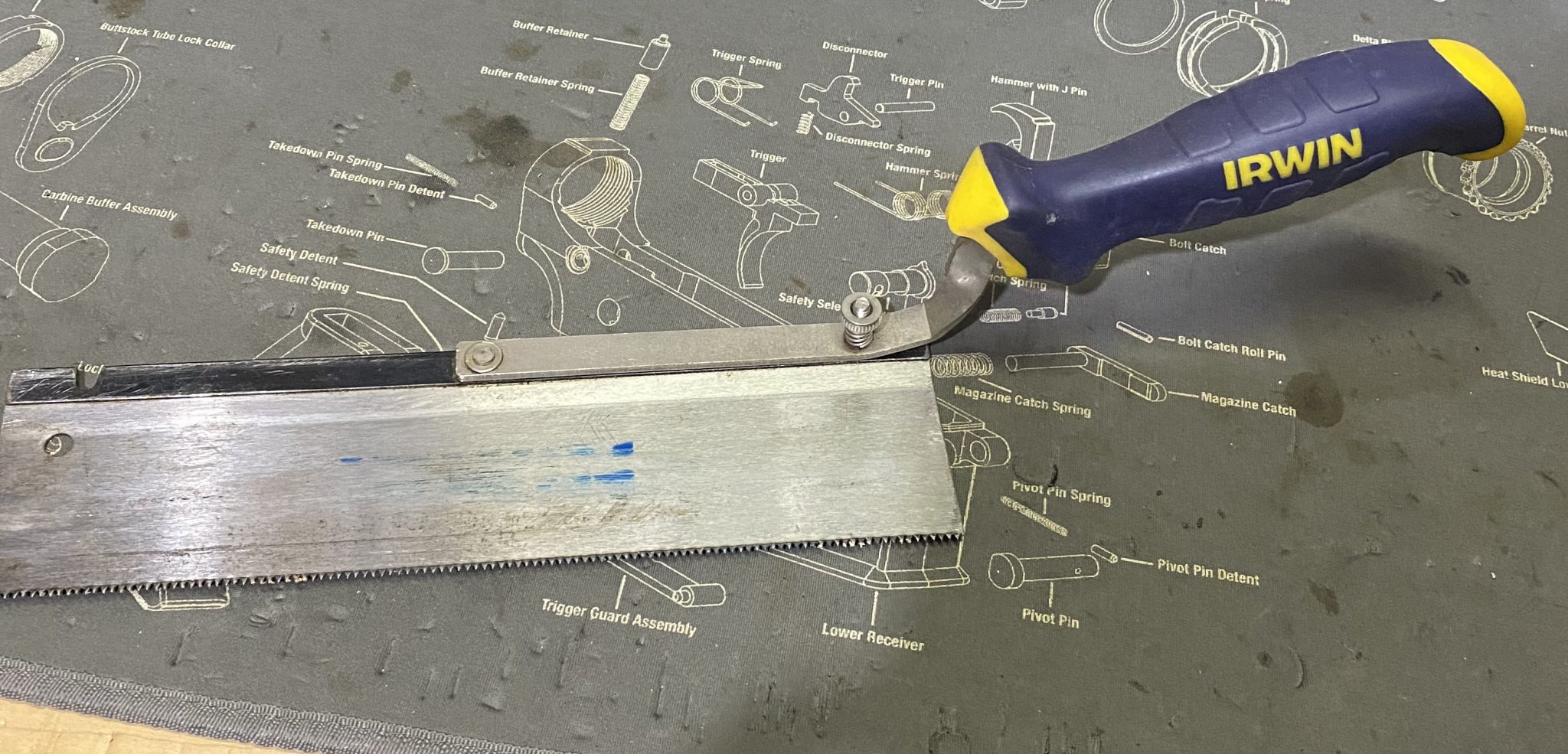

As mentioned previously, cut door jambs so the flooring slides underneath. A scrap piece of flooring will allow you to rest your jamb saw on top as you cut, giving the correct height. Keep your blade straight. I use a hand saw with a reversible blade to allow for easier cutting depending on the direction/hand you’re using.
Included more pics of the flooring, scrap piece I used, and my inexpensive hand powered jamb saw. You can get an electric one as well if your job is a large one.

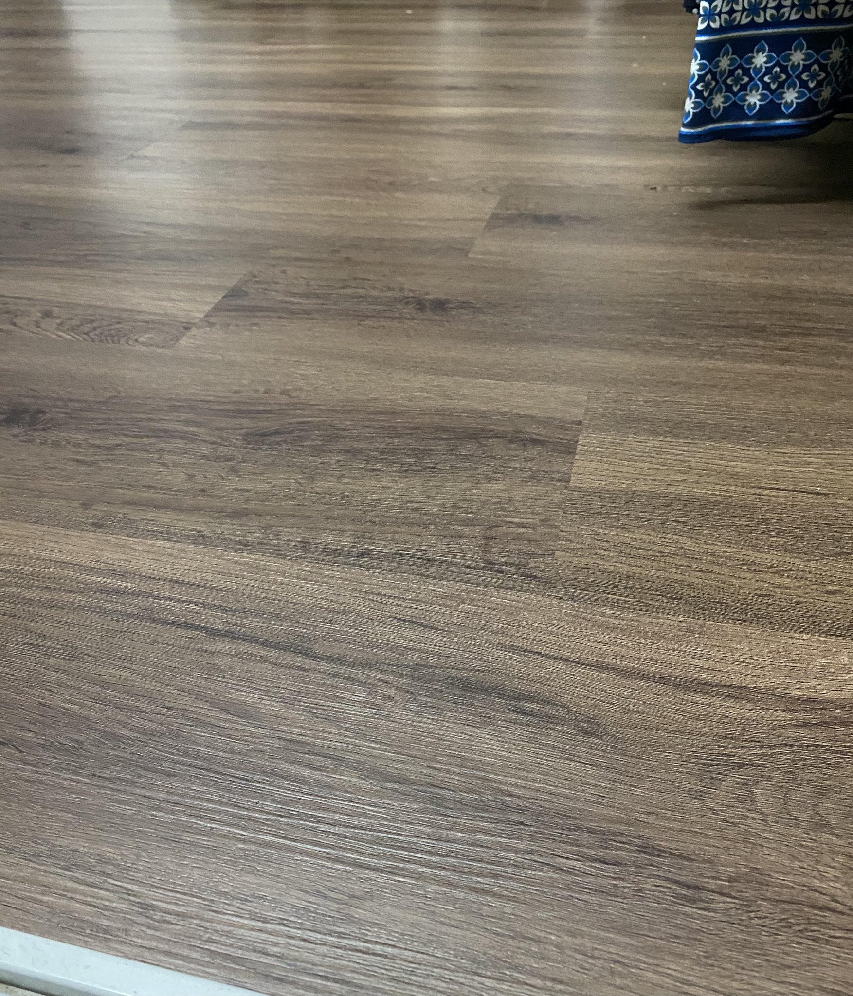

Looks great. One of plank samples my wife picked out looks pretty close to that color. Going to paint the trim white to play off the darker floor.
