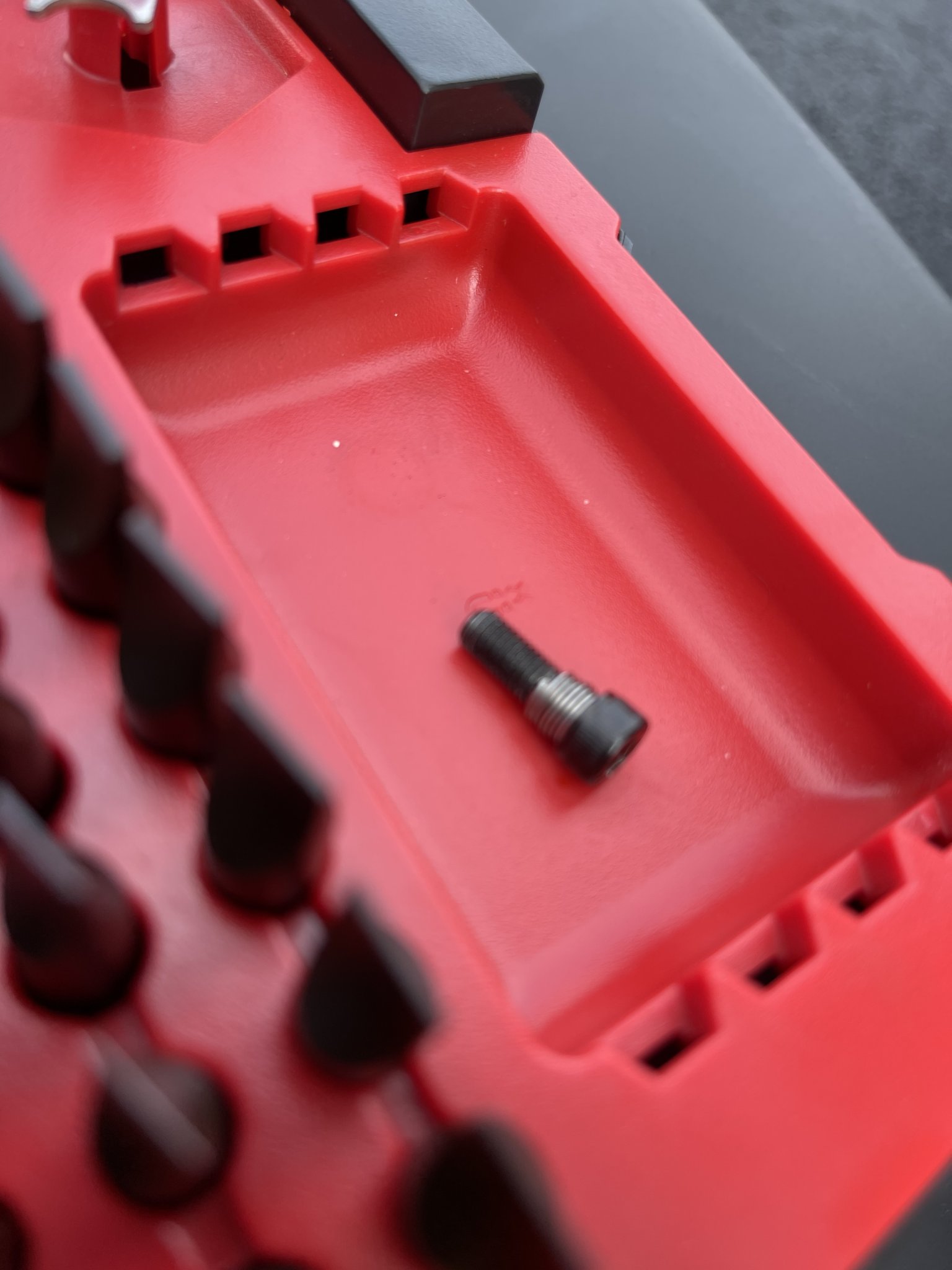

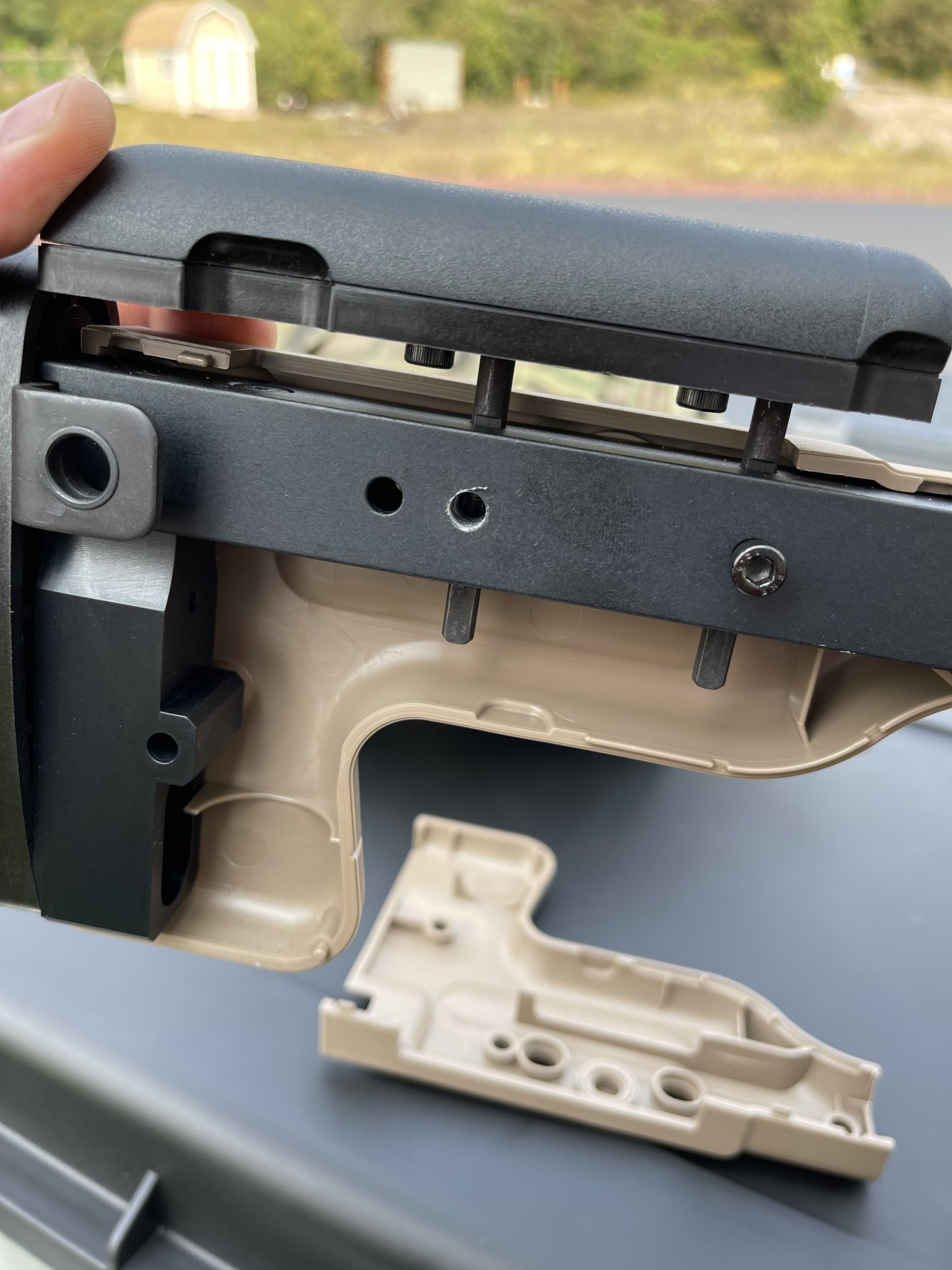

Hey everyone! Tried finding a solid answer and I can’t seem to looking around. If it’s on here and I missed it, I’m sorry. Also if this is in the wrong spot to ask, I’m also sorry (I’m new here). So I bought a few Accuracy International AT rifles with a folding stock in 6.5 Creedmoor. Love them by the way, but sadly this is the second one I’m having issues with. Today when I brought my newest one out, I went to loosen the cheek riser screw on the one side, and the whole screw and threaded insert just fell right out. Being I already sent one back with a defect and is currently there, I don’t want to send this back. Is it difficult to install a new rear chassis to the folding adapter? I’d rather install a new chassis piece myself if they are willing to send it. Here’s what I’m working with. Again, If this is already out there, I’m sorry. I just can’t locate it. Help lol

It's not the easily thing in the world to do because the AI stock assemblies are epoxied in but it's doable. That being said that issue with the screw is pretty easy to fix with basic tools without having to replace the whole stock assembly.
Dang, even the hinge pins are epoxied too? What kind of fix can I do? So far this has me interested!
To me it looks like a helicoil came out with the bolt, you might be able to clean up the threads in the stock assembly with a tap and install a new helicoil. Alternatively, there are self locking threaded inserts that you could use that could also work. The bubba-est of solutions that could also work is one that I've had to use on a project when my minions managed to drill holes off center in aluminum angle. In that case I plugged the holes with steel putty so they could be drilled and tapped again.
Now that I’m staring at it (wanted a closer look again), it looks exactly like a helicoil. That looks to be exactly like what’s wrapped around the screw. I’ll have to monkey around with something. Just kinda sucks since I JUST bought it. Oh well. I also just sent an email to AI just to see what they say about it.

If you fix it yourself use a time cert thread repair not a helicoil.
Just take that to a machine shop. They can put a new insert in it for you. There are different types and will be better than a helicoil.

It's a helicoil. There's no sense in trying to replace the entire $300+ buttstock assembly instead of a $1 helicoil.
Like others have said, you can try to simply put in a new helicoil with Loctite, upsize the helicoil and re-tap if possible, or fill the hole with epoxy and re-tap it.
I believe those are standard M5x.8 screws.

Also, if the threads on the chassis are now boogered up from the helicoil coming out and require the hole be drilled and tapped larger, rather than replacing the helicoil with a twinsert to get back down to the original bolt size I'd recommend replacing it with a timesert or keensert instead. A keensert would be a little cheaper than a timesert as you don't need to buy the timesert installation and swaging tool, after drilling and tapping with an STI tap you can simply tap in the locking keys of the keensert carefully with a flat faced punch and small hammer.
