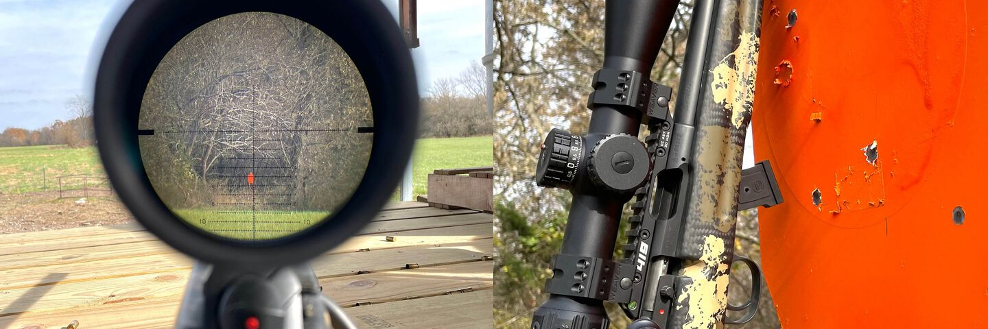

300 shouldn't be too tough. I've got the MPED on a 419 30 MOA base on my 457 and I've been going to 500 on a 2/3 IPSC regularly without issue, I am using about 5 MRAD of reticle to get there though.
