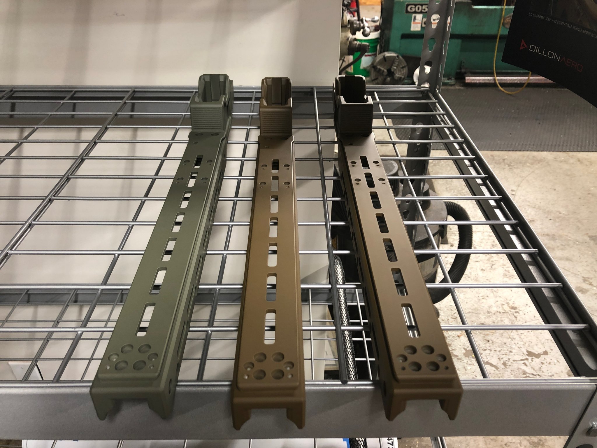

Understood. Unfortunately a large percentage of the past year has been tied up in getting quotes and machining. I don’t want to promise anything I can’t deliver. Especially when money starts to exchange hands. No money has exchanged hands so far, other than from mine to the machine shop for the prototypes. Which have been out for testing for the past few months, no strings attached, as to hopefully get the most impartial feedback possible.
I wish I had a CNC in my possession, or owned my own machine shop. I don’t, so in many ways I’m at the mercy of how busy good machine shops are.
A big reason for the pre-order is to get a real number of interested parties so I can get the correct order in, and also to help fund a large order. Unless someone swoops in at the last minute, I’ve done the whole project on my own, funding and all.

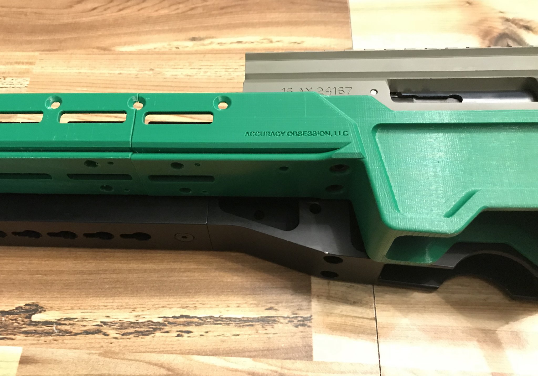

All I will say is when I got my AX three years ago, I had some truly crazy ideas in mind to make it what eventually evolved into the Obsession chassis. I’m talking taking a brand new $6500 AX under the knife and machining it WAY past the point of no return. I didn’t end up doing it, but all those late nights proved somewhat worth it to stop that madness and move on to a different kind haha.

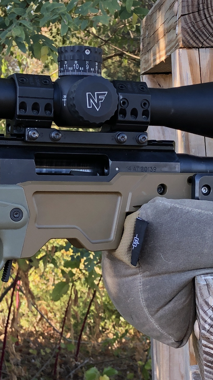

Time after time, match after match, I came back to the fact that I just couldn’t get the “hump” of the dang AT or AX out of the way to really dominate shooting off of props. Even when I shot well, trying a buddy’s MPA or even AR showcased how a flat forend and low bore axis made such a big difference.

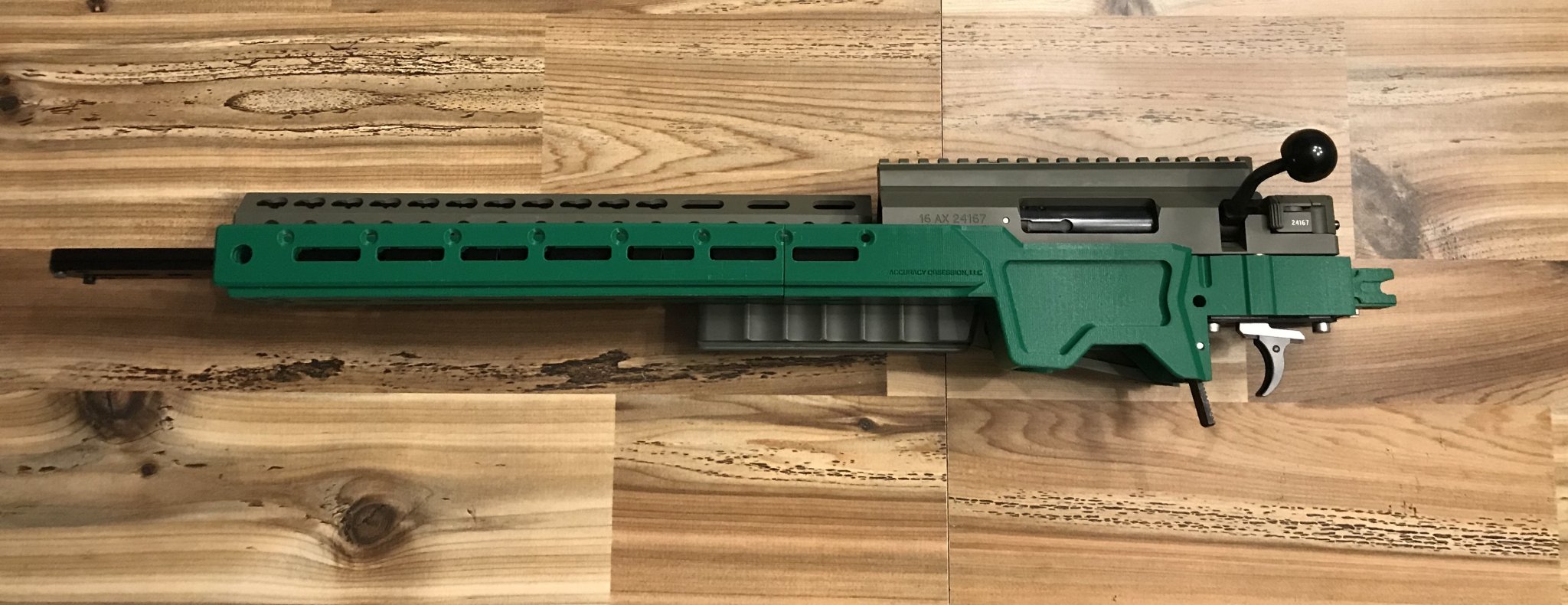

I think the shorter height of the AO chassis and how the rifle sits lower on a bag with the AO chassis it will be better over all for match use than an AX or AT.
ETA: Sam’s pictures above illustrate what I’m talking about.

I haven’t tested it, but it certainly could be done. The opinion of some knowledgeable AI shooters is that the bonding isn’t needed. However, I designed the action to chassis interface exactly as the AT and AX are from the factory, meaning the same clearances for use with the 4 brass washers and epoxy. I think if I wanted to have designed it without epoxy I would’ve changed some of the dimensions to optimize recoil lug contact, and remove the brass washers. I believe that’s what MPA did but I can’t confirm as I haven’t had one in hand (but I’ve seen some pictures).
